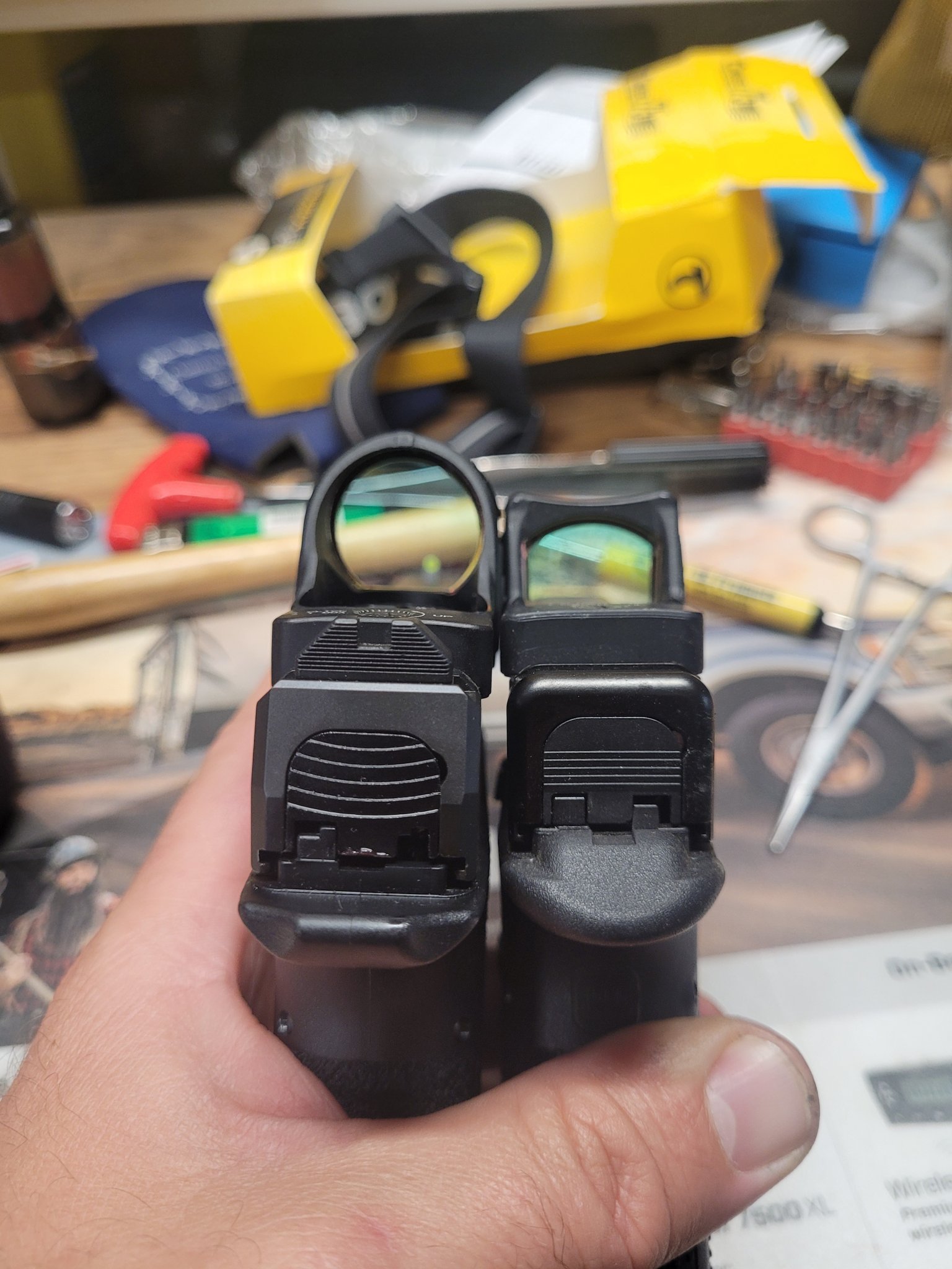

    I have the RMR and SRO. If I was going to war I would take the RMR. For anything else I'm using the SRO. The larger window is much more enjoyable.

    Just showing you what I'm talking about. I'm sure you can see the same thing with Google. After I made that post I realized the RMR is probably more manageable for everyday carry. I really didn't realize until I got home how damn big the SRO is.
    Ehhh it looks like a lot but my SRO carries no different than my RMR and that’s on a raised plate on a P01. This is appendix of course.
    In some ways, the rounded hood actually carries a bit better as it doesn’t protrude a sharp angle.
