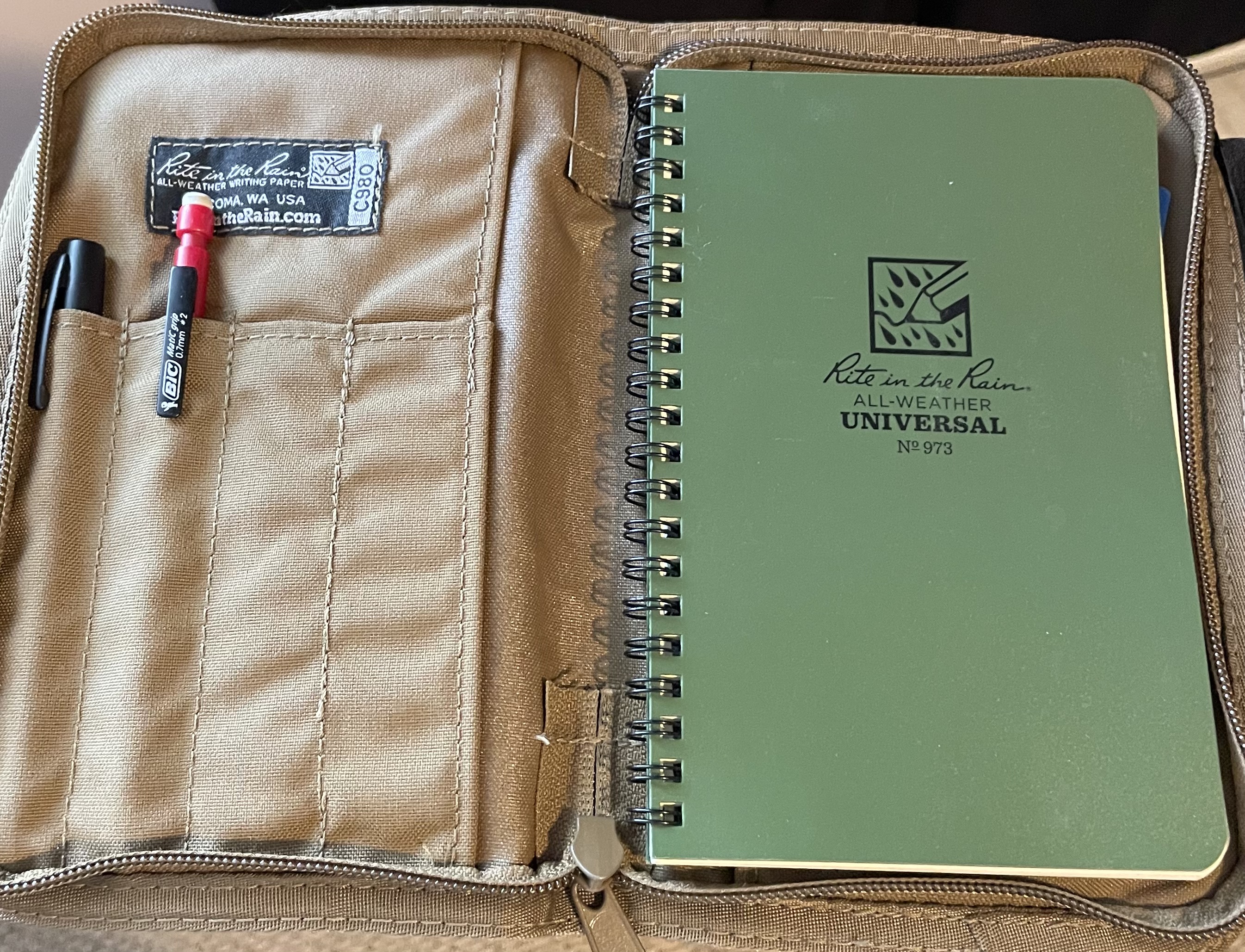

I make my range session notes in a "Rite in the Rain" folder with roughly 4x6" pages. I record rifle info (which one), environment info, session goal(s), ammo data, scope elevation settings for various ranges, and whatever other notes that come to mind. This usually takes no more than a couple of inches a the page.
Then I transpose that info to 8.5x11" pages in a loose-leaf binder specific to a given rifle. I also keep some targets, annotated CoF pages from matches, last-cleaned date, and, above all, session and total-life round count on the current barrel.
For a new rifle or barrel, the first loose-leaf page will contain unchanging info like length and twist rate and sorta-transient info like cartridge length to lands and load-to CBTO info for fully-developed loads.
For me, the most valuable info is barrel round count, final "developed load" data for a given bullet/powder/primer/brass/CBTO combination, and tables of "bullet speaks" elevation data compared to ballistic solver solutions for ranges 100-1000 yards. I also note when I clean the firearm - it's really easy to track round count since the last cleaning.

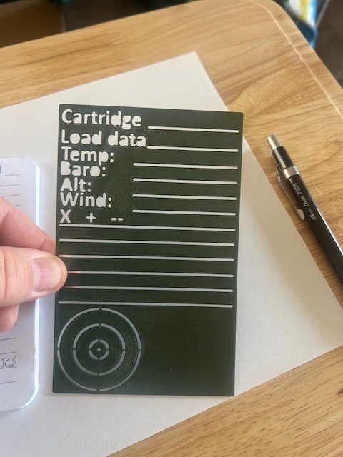

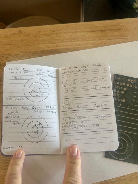

I went down the path of making a 3d printed template that I could use on some cheap moleskin type notebooks, with some titles and a target I could transfer to and then write in my data. lots of good looking books out there though.

I made it. Its not too difficult with fusion360, just a matter of making the openings thick enough for a mechanical pencil to fit through easily.
Happy to offer the file is anyone wants to 3d print their own. Could also made modifications and send the stl file to you if you wanted it more customized, its an "in progress" project for sure. I made it to fit a 3.5x5.5 notebook so it could be kept inside it, but its all adjustable.
