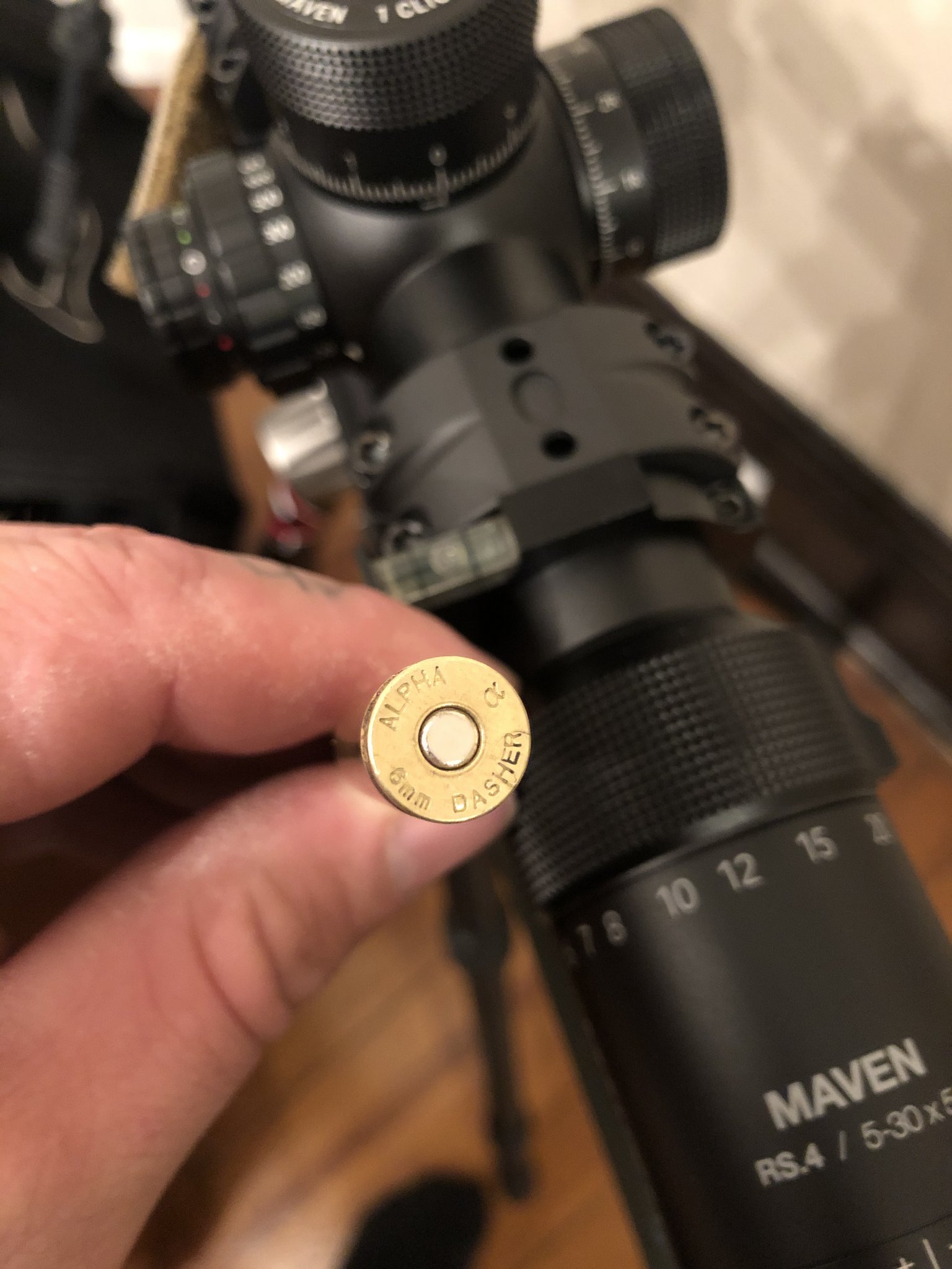

    I was curious if anyone has had a chance to run the new dasher brass from Peterson and give some feedback. Also let’s hear some of everyone’s favorite dasher loads!
    Here is my current dasher load from a 26” proof prefit for a TL3 (origin with a machined lug)
    Alpha brass
    Fed 205m
    Shooters world precision 31.5gr
    115dtac jump .020”
    2775fps SD of 4
    I did get 2 stuck cases and steering away from the dtac. 105berg/109berg or 108 ELDs, maybe 110SMKs I cannot decide

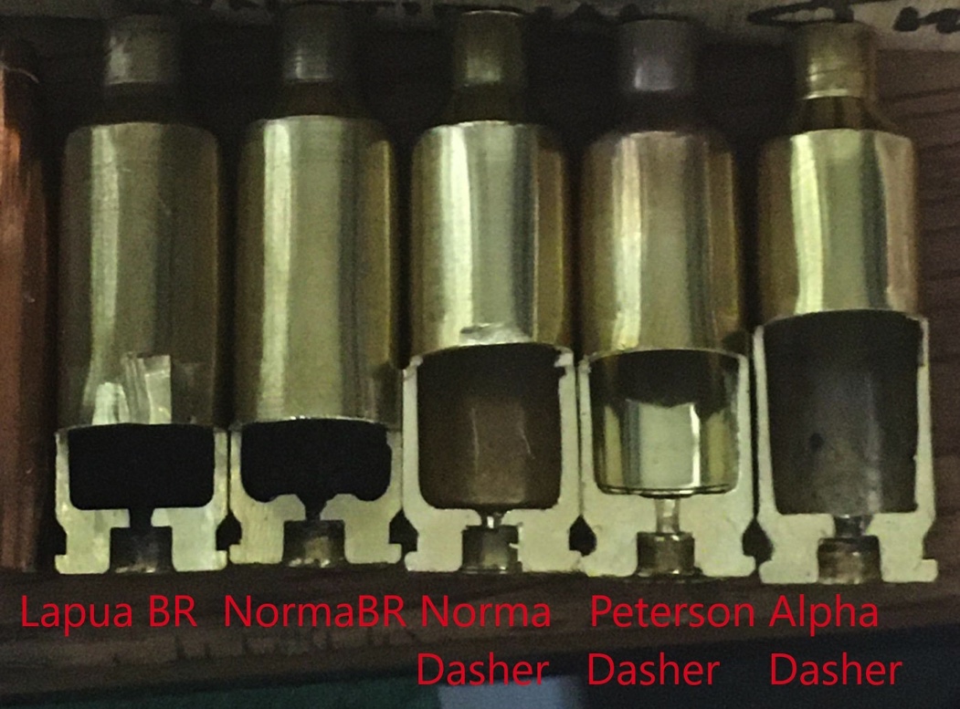

    Does anyone know what loaded neck thickness is on the Peterson BR/Dasher brass?
    Dimensionally Lapua & Peterson br/dasher brass are very similar, at least the latest lot that I just received is. Just use your standard reamer. The Peterson 6x47 brass I have has slightly thicker necks than Lapua, and wants a .274-.275 neck reamer. No need to weight sort brass either for any of them, they are all extremely consistent within the same lot.
    Edit: Peterson is measuring .271 at the neck, and Lapua is .269.
    Reactions: Hoyt7mm
    Not necessarily true. The properly formed Lapua and Peterson 6 Dasher brass may have very similar external dimensions but you must be aware Peterson is a bit heavier and, upon seeing a cross sectioned Peterson next to Lapua, I can say Peterson has a much thicker case head than ANY of the others out there.
    I have shot Lapua hydro-formed for many years and still do in the BR guns but I have Alpha current in use in my Terminus Zeus with good results so far. Also I have 100 Peterson 6 Dasher on the bench and will be starting load work up with them soon.
    this is what i’m getting
    peterson loaded round = .271
    Lapua FF loaded round = .268
    no too big a deal, either neck turn or run a reamer designed for alpha brass

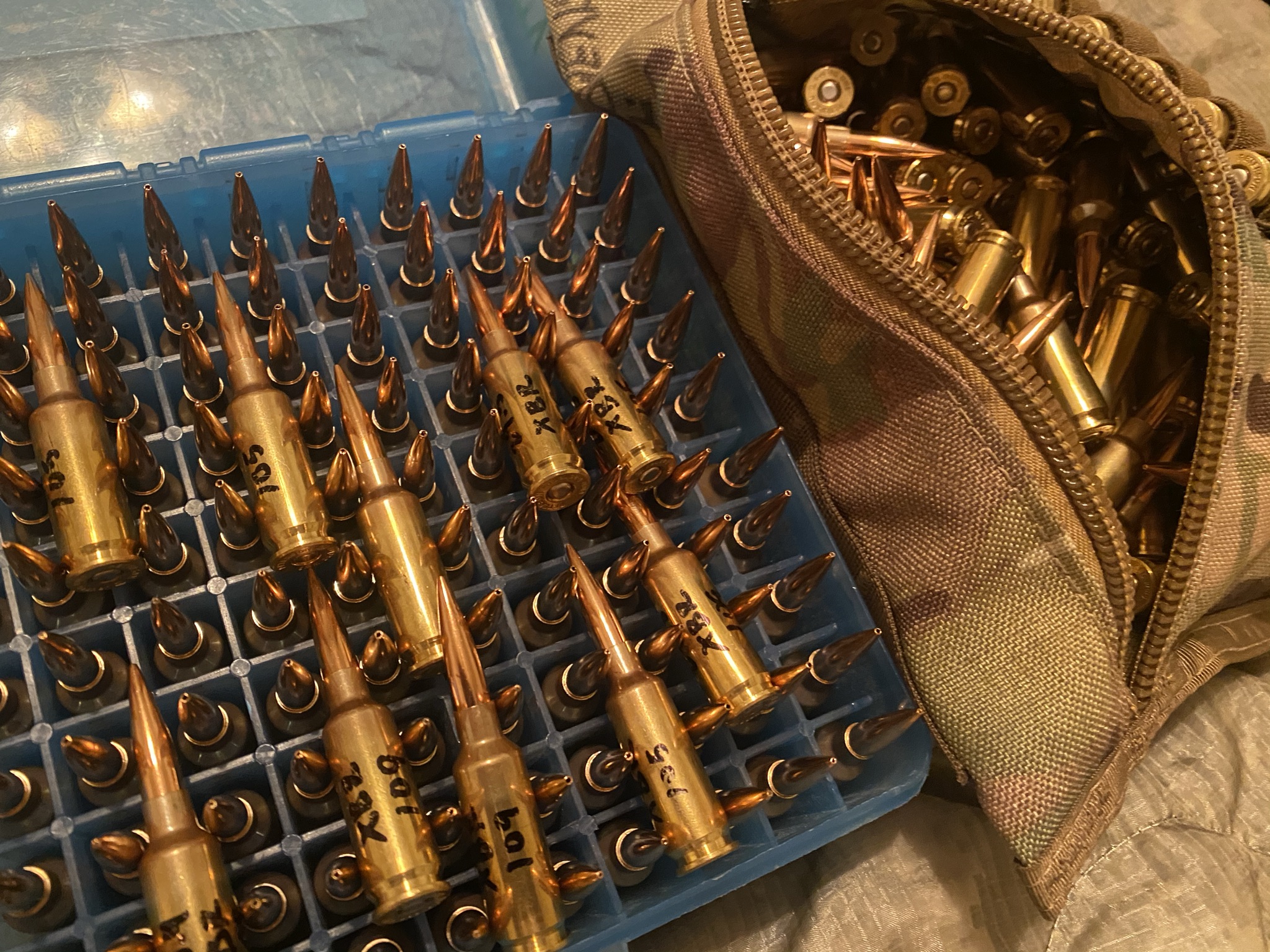

    I have Peterson dasher brass... loaded up 200 break in rounds and have 110 rounds of ladder testing.
    5 powders and 2 bullets
    Berger 105 and 109’s
    N140
    Varget
    4451
    8208
    4350
    Should have results end of the week or next week sometime.

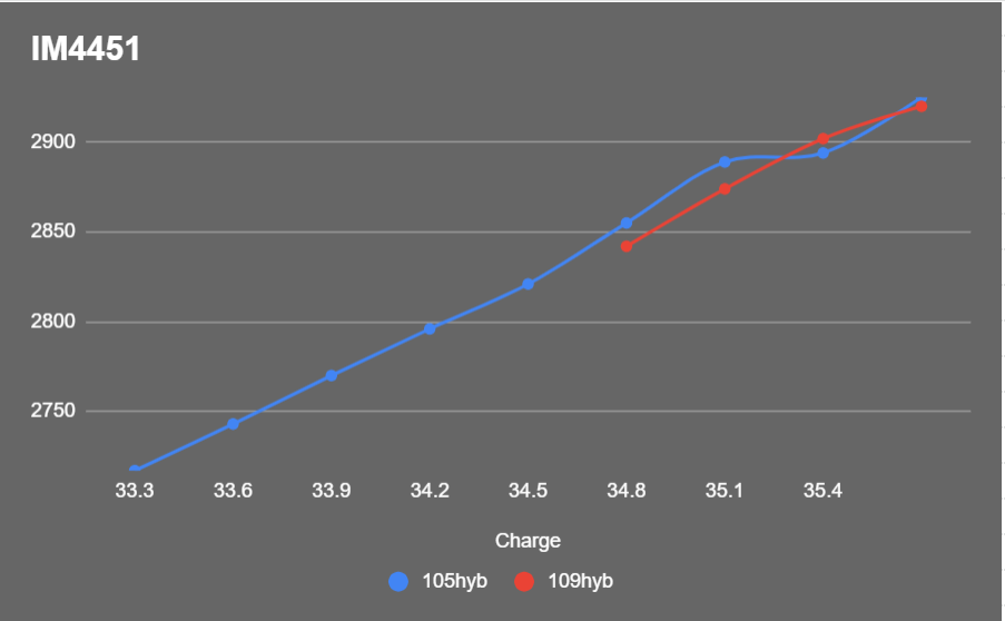

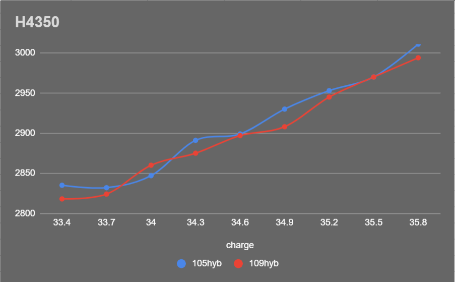

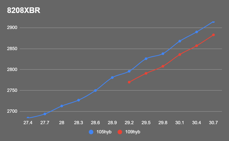

    So I heard a rumor peterson brass was "soft" i did load test today with a bunch of powders and couple bullets. im going to post results below to use at your own risk.**** DISCLAIMER **** I am a novice reloader with help of more experienced people helping me out. this was my test and these are my results.
    Brand new peterson brass
    cci450 primers
    21st century expander mandrel .002 neck tension
    loaded .010 off my lands in my barrel Loaded with Arbor press
    Brand new Dasher barrel broken in at 150 rounds.... stripped and cleaned 5 fouling rounds before test. was conducted in a 100 yrd indoor range climate controlled. used a thermal pyrometer to keep a eye on barrel temp min was 65* max was 85* over length of this test.
    First i shot all of my 105's because i knew they would fly the fastest and only shot my 109's around the speed i am wanting between 2850-2950
    i shot both of the 4350 because i have plenty of that and only a single pound of the others

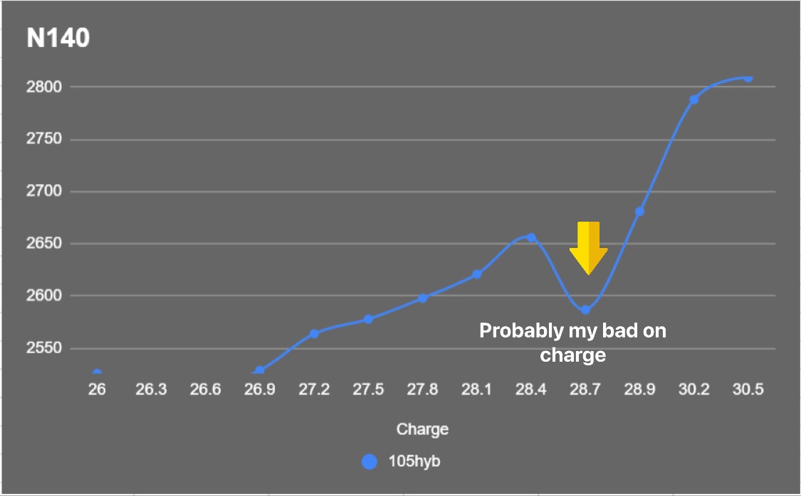

    looking at the N140 it should be noted on their website they do not have data for a dasher so i used the BR load data and obviously.... was pretty slow so i didnt even bother shooting the 109's i will pull them and dump powder back and probably start at about 30.5

    so ive not seen the pressure issues with peterson and i normally run on the warm side but peterson is about a grain less internal capacity than lapua so i run a little more freebore to compensate for it.

    My Peterson dasher brass only has a case capacity of 39.2 (after firing) vs Lapua at 41.2. Definitely less capacity, but not necessarily a bad thing.
