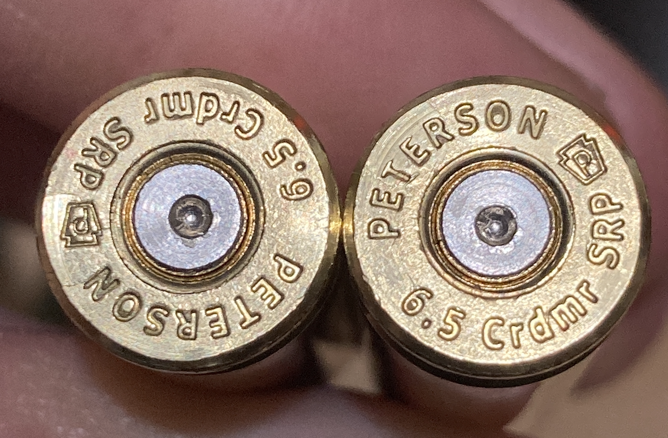

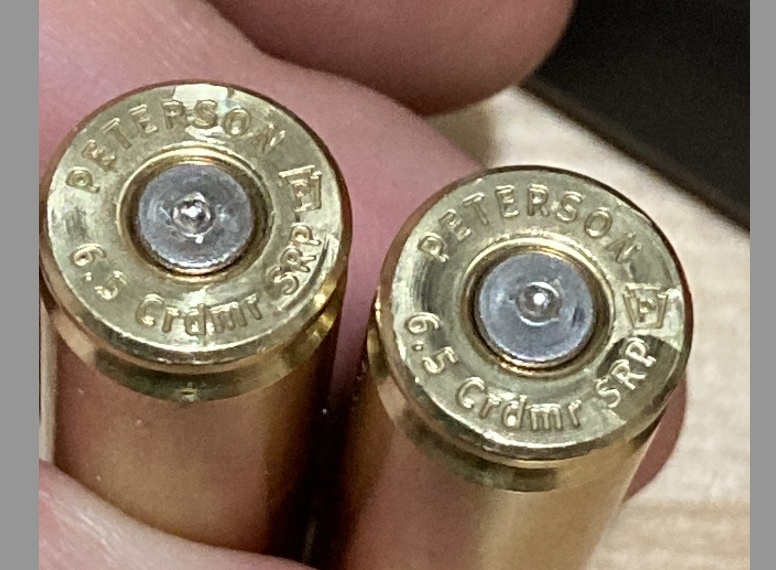

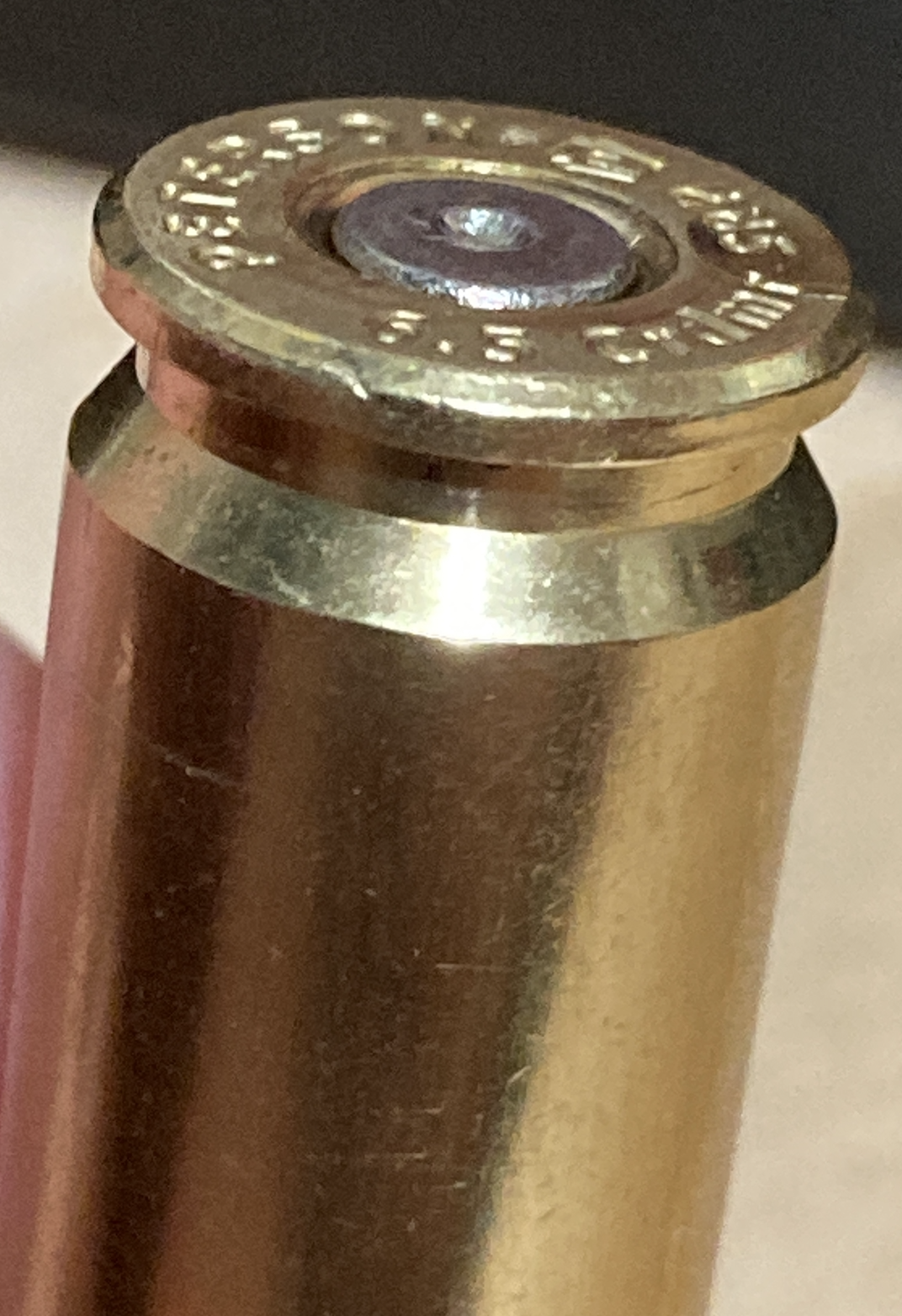

New to Peterson 6.5 Creedmoor SRP brass. Picked up a couple boxes and thought i'd fireform it first with some Hornady 140 gr i have available.
I shot 10 and started seeing what looked like pressure signs, though I could be wrong (first time trying Peterson brass). I stopped after these initial firings just to be sure, and inspect.
Shoulders grew 0.004
Gordon Reloading Tool warns of pressure >40 grains.
My question is: has anyone experienced similar results using Peterson brass, or with virgin brass? I plan on dropping the charge on the remaining cases and seeing how they do.
Details:
Brass: (0x fired - Virgin) Peterson 6.5 CM SRP
Powder: 38 gr H4350
Bullet: 140 ELD-M Hornady
Primer: Federal 205
COAL: 2.838
CBTO: 2.203
Case length average: 1.912
Peterson reported average case volume (H2O): 50.6 grains
Brass Prep:
Tumbled
FL resized to fix necks (no change to shoulder)
Chamfered & deburred

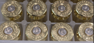

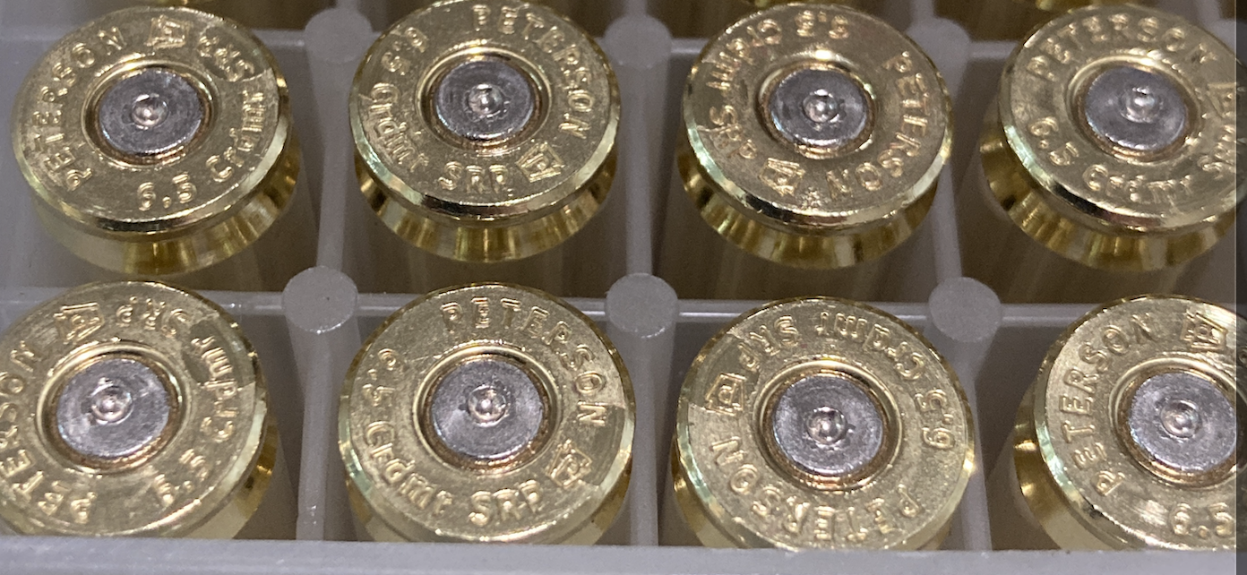

Any sticky bolt lifts? What’s the diameter of the case web now vs before firing? More than .001 expansion is a sign of overpressure but I don’t see anything alarming on your case heads….how did those rounds print? shoulders growing .004 is no big deal. Just set your fl sizing die so it bumps them back .002

That's good data to help diagnose what might be going one, except velocity with barrel length would be really helpful too.
That 38 grs of H4350 shouldn't be giving you anywhere near any pressure signs, though the pictures of the head suggest your close. But that might be because you need a little more powder since you're loading a bit long???
I have loaded Peterson 6.5CM for several years now. After adjusting the charge for the slightly less case capacity I landed on a charge of 41.6 gns of H4350 with a 140 eldm on top and have never seen pressure from that load. That said had a friend go through the same process and have similar reaults as you, but it was not pressure. He shoots an RPR and ended up that his presumed cratering was from a sloppy bolt face and firing pin fitment. He had it busched and all of the supposed cratering went away. YMMV
Get some CCI 450’s SRMagnum primers. The cups are thicker. Or. Go back to LRP brass or get the bolt bushed. Had one doing the same thing. Swapped back to LRP brass and primers and good to go.
.004 from the cases being that much short on the first firing is what is causing the ejector marks. When the case head accelerates backwards after being driven forward by the firing pin. Make the cases a crush fit on the first firing will stop the ejector marks and possibly the primer cratering. Expand the necks to 7mm then run them in your sizing die and create a false shoulder for the first firing.
Reactions: High Desert duck
Screw your sizing die out so it doesn’t push the shoulder back and try to chamber it. When it sizes the body it will push the shoulder forward. Then screw the die down until it chambers with a little resistance. That will be your cartridge base to shoulder datum length. Check that against your virgin brass and that’s the difference in length. Your virgin brass will not be completely fire formed on the first firing. Especially not at 38 grns unless you are jamming your bullets.
I cant recall any sticky bolt. Biggest concern I had was when looking at the case heads and seeing the ejector marks, but also from these old eyes, the primers looked slightly cratered+flattened.
Forgot to mention in the brass prep that after tumbling, and before chamfer/deburr, I ran all the brass through a FL resizer just to get the necks concentric (edited now). No change in shoulder in doing this.
Thank you for suggesting to measure the case web. Unfortunately, I already ran them through a FL sizing die. For what it's worth, even through already FL resized, looks like the case web grew by 0.002 consistently across those fired (new out of box = 0.4675)
Bushing the bolt and switching to 450's won't fix the ejector swipes.
@FNG1001 bump 2.00 grains up and reshoot.

I was thinking it might be due to it being it's first firing, but i have never had these marks show up with similar loads on Hornady or Norma brass.
This was my thought too, that the 0.004 might be a bit much of a gap in the chamber. I'll be shooting the rest today (slowly). Will update once i have more data.
The.004 was after firing if I read it right. The cases grew .004 in length to the shoulder on the first firing shooting 38 grns of H4350. The cases did not fully fire form to chamber dimensions on the first firing with that load. Cases are likely.006-.008. shorter than the chamber when unfired. The OP could try neck sizing only the once fired brass and then he would have a closer representation of his actual chamber length. Also a good call on the neck clearance.

Shot the remaining 50 rds. I got the same plunger marks on all case heads, however, no other signs of pressure and the bolt throw/lift was normal.

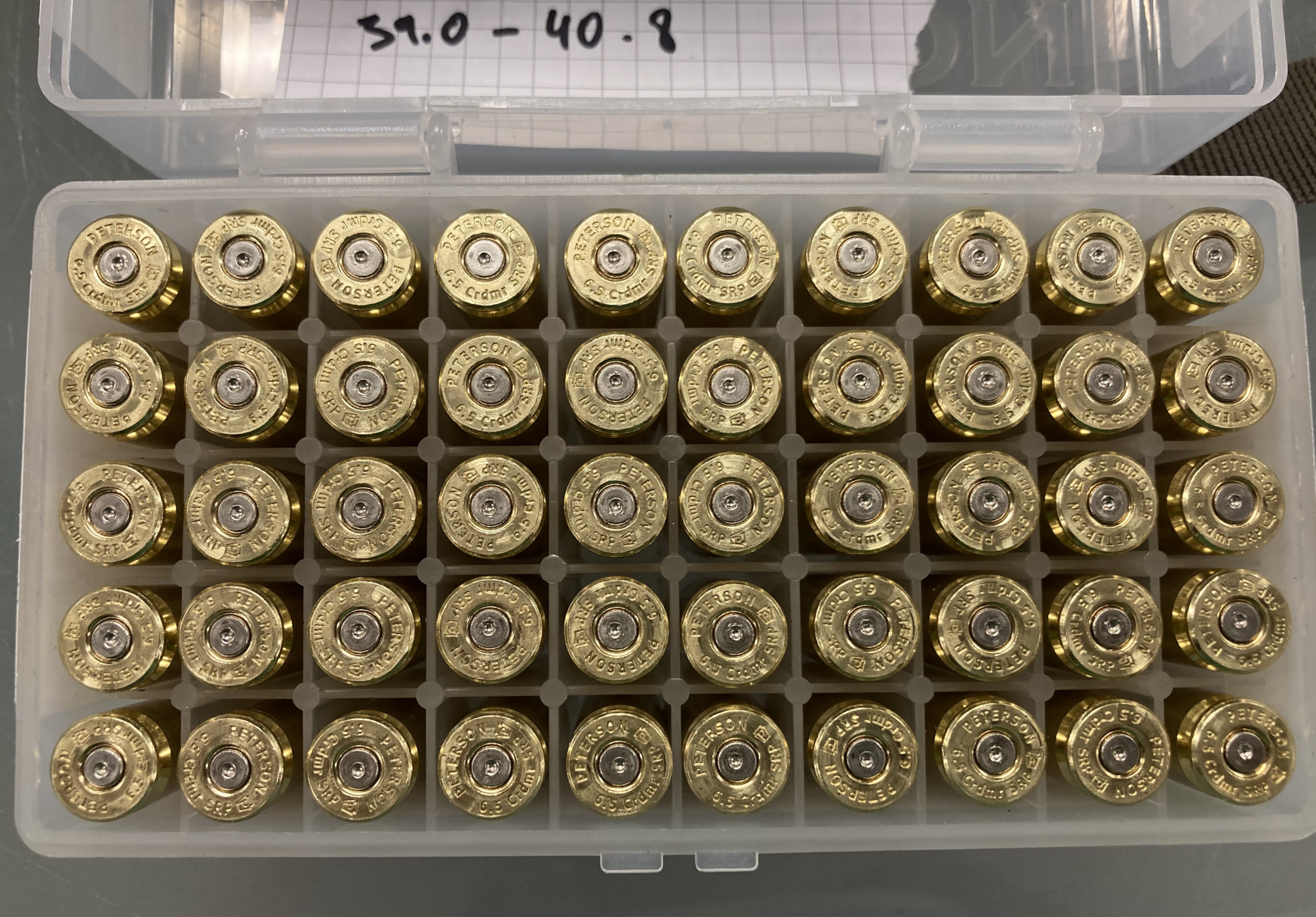

I went ahead and reloaded another set of 50: 10 strings of 5 rounds from 39.0 - 40.8 grains of H4350.
My brass prep was the normal:
  • tumble
  • anneal (2 sacrificial Peterson brass gave me 146 and 147 AZTEC code on the AMP),
  • FL resize (0.002),
  • trim to size (1.910),
  • powder+seat bullet (COAL = 2.8380, CBTO = 2.2170).
Looking at the heads, same marks, but operating the bolt felt smooth. A close up of the case heads' (max charge 40.8 grains) primers doesn't show any flattening. I'm starting to think the ejector marks aren't a concern (please correct if you think otherwise), and could just be a combination of my bolt with this brass.
Average speed of x1 fired: 2608 - 2739 fps (39.0 - 40.8 grains H4350)
I still have a couple of unfired boxes of this brass that i can compare measurements to with x1 and x2 fired.
Where did you read that? .006-.008 seems like pure speculation, also .006-.008 proabay isn't going to produce ejectors marks either. The cases I have seen it on have been belted mags growing in the .015+ area anyway.

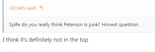

I dunno about Peterson = junk.

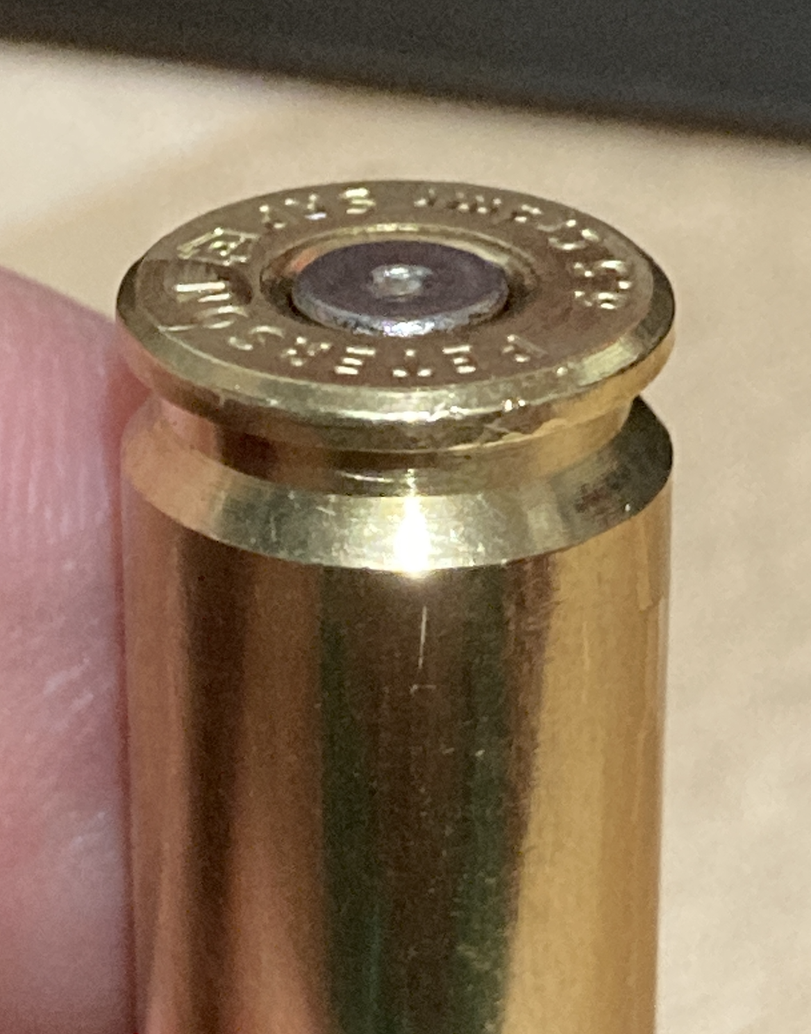

Its junk because they cant hold primer pocket depths to within a thousandth and they also cant control neck thickness to less than a thousandth.
Nevermind the fact that under 40 gr in a creed leaves my pockets loose at only five firings.
At least they have learned to center up the flash holes now.

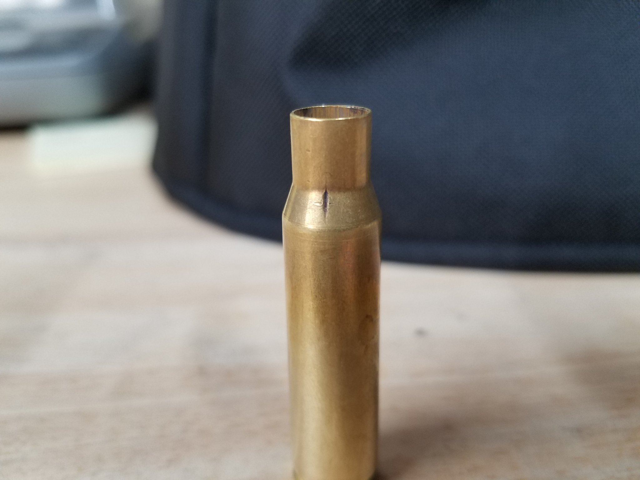

I don't generally make claims I can't support, see above. I've posted the picture here before and got more than a few me too's.
That is one folded neck. your statement made it sound like its a matter of business practice. What you could have said to avoid confusion would have been, "I got a piece with a folded neck once."
Granted, how i am supposed to know that is a piece of Lapau brass?

The worst Lapua brass I have had was a couple hundred pieces of Lapua Gold Box 243, and that was also "back in the day."
Of course they are not visually inspecting every peice they make and some bad pieces will get through. No body is, and everybody has some bad ones get through. I can say that is the first fold I have seen in Lapau brass. I have seen them in most other brands.
