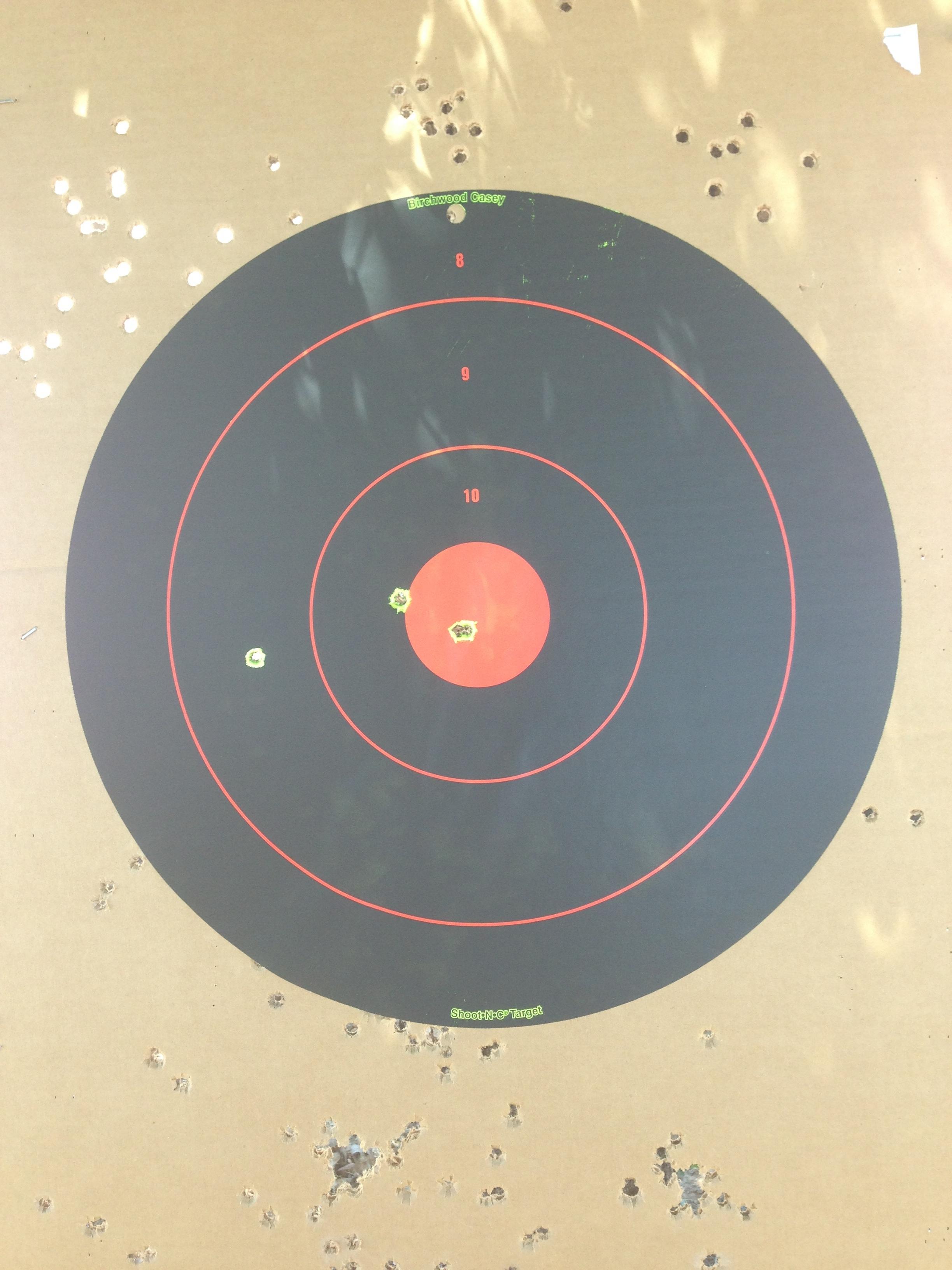

I finally got a chance to shoot my rifle from PCR and wanted to post up some results.
This is my 23'' .260 build which PCR completed in just a few weeks time. Great service and fantastic quality.
5 shot group at 100yrds.

Thanks! It's a laser! Still perfecting perfection but this is a peek. The two to the left are sighters for my new scope, the center is a 3 shot group at 100 believe it or not. That's about an 1/8th minute... Could have been a fluke but I'm going to try it again hopefully in the next few weeks. This thing is incredible!IMG_1505.jpg

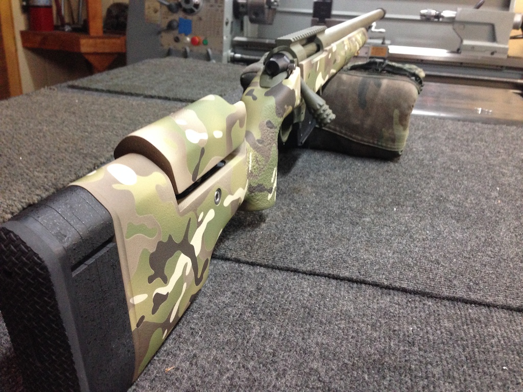

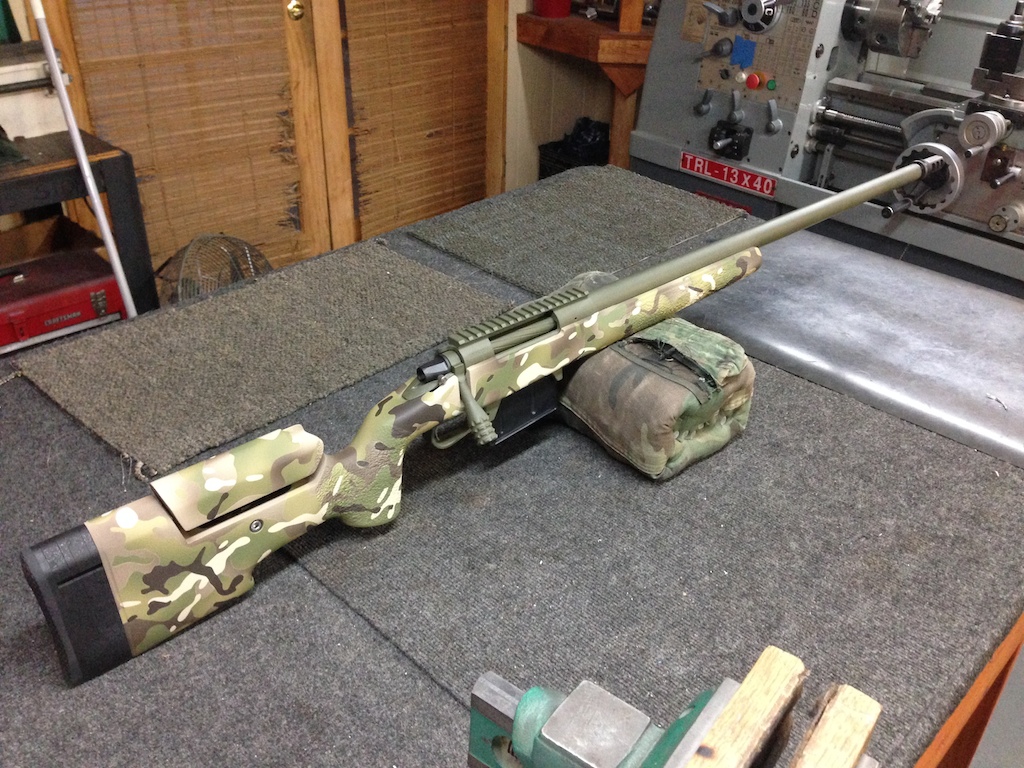

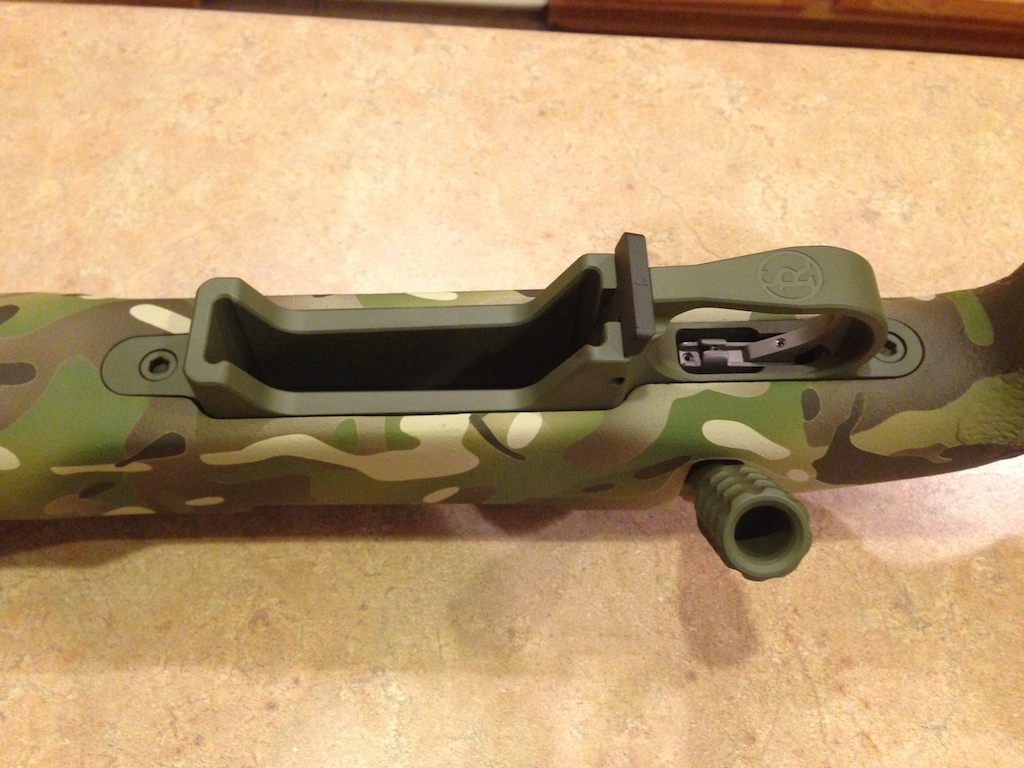

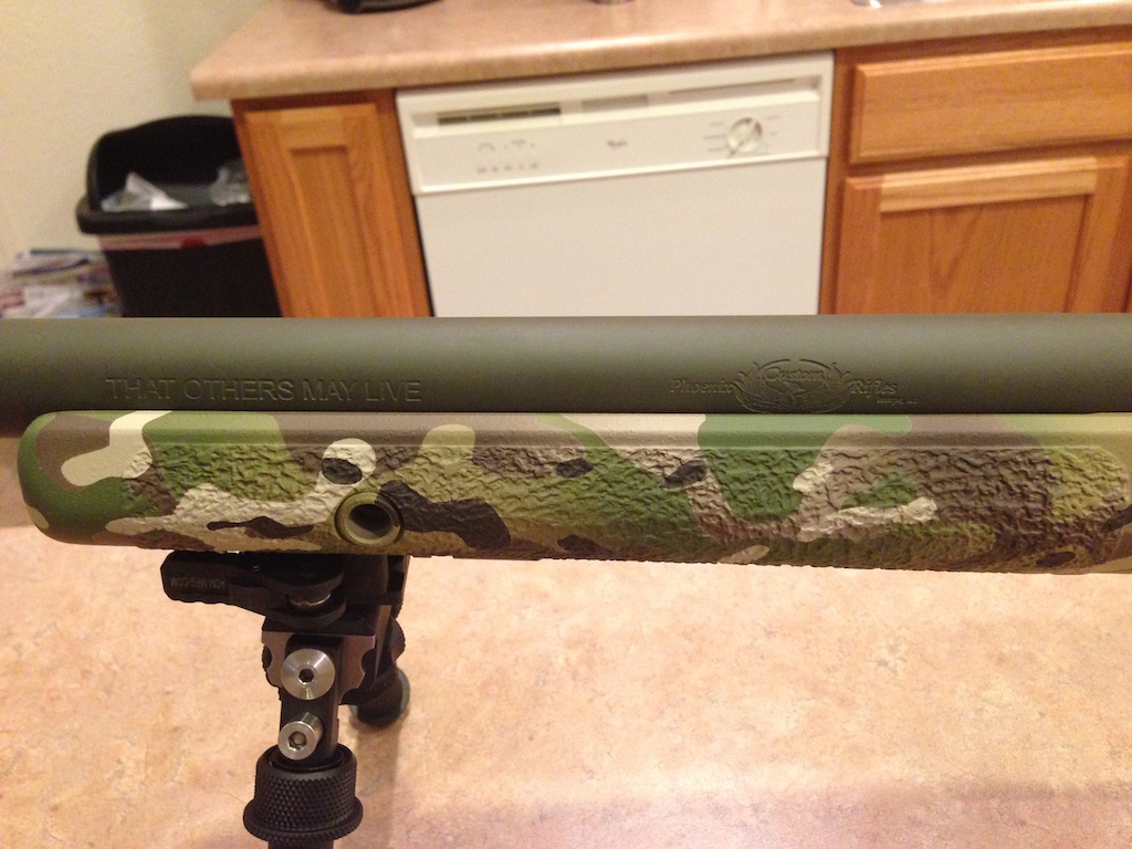

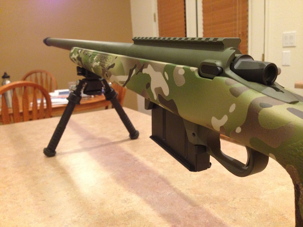

Spectre SA receiver, integral rail. pinned .300" lug
Brux 7.5tw, 6mm interrupted flute M40 barrel chambered in 6 Creedmoor
5/8"X24 class 3A muzzle threads/blended thread cap and 11 degree crown
Manners T4A (folder) with mini chassis
Jewel trigger set @ 12oz
"H" series FDE Cerakote
PCR hollow Phoenix bolt knob
TPS 34mm low rings
