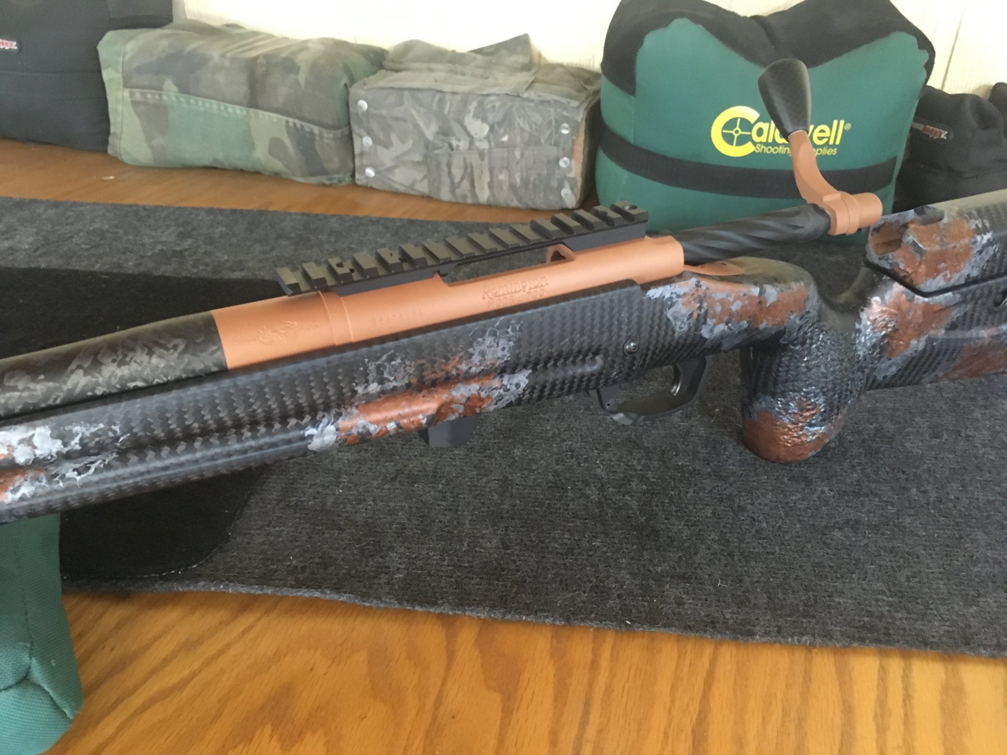

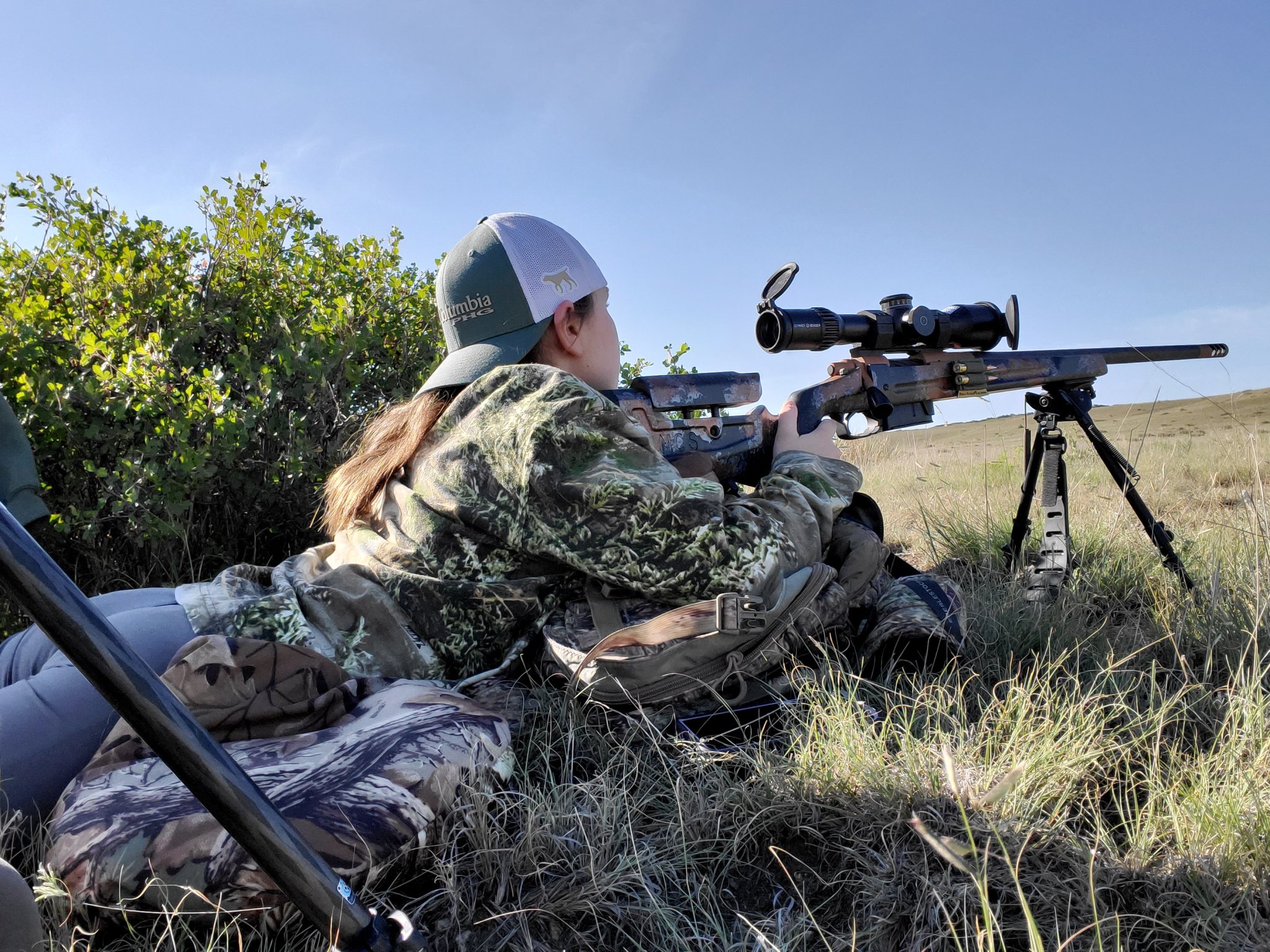

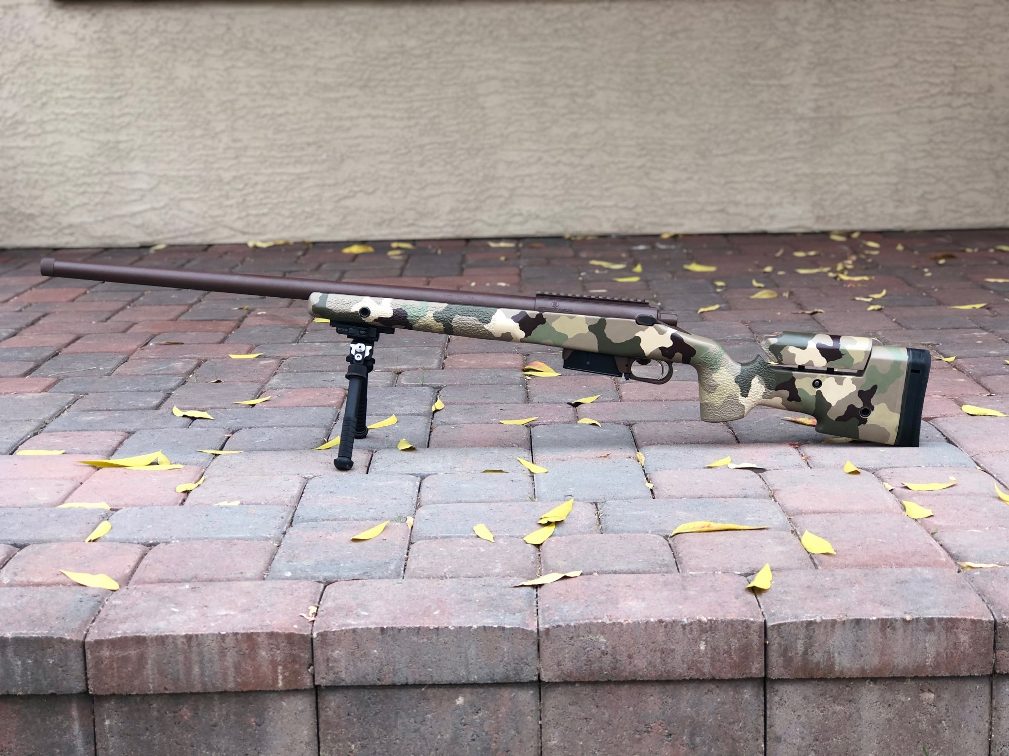

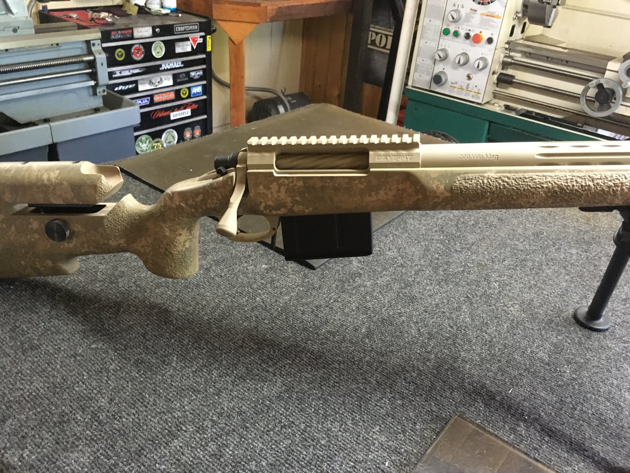

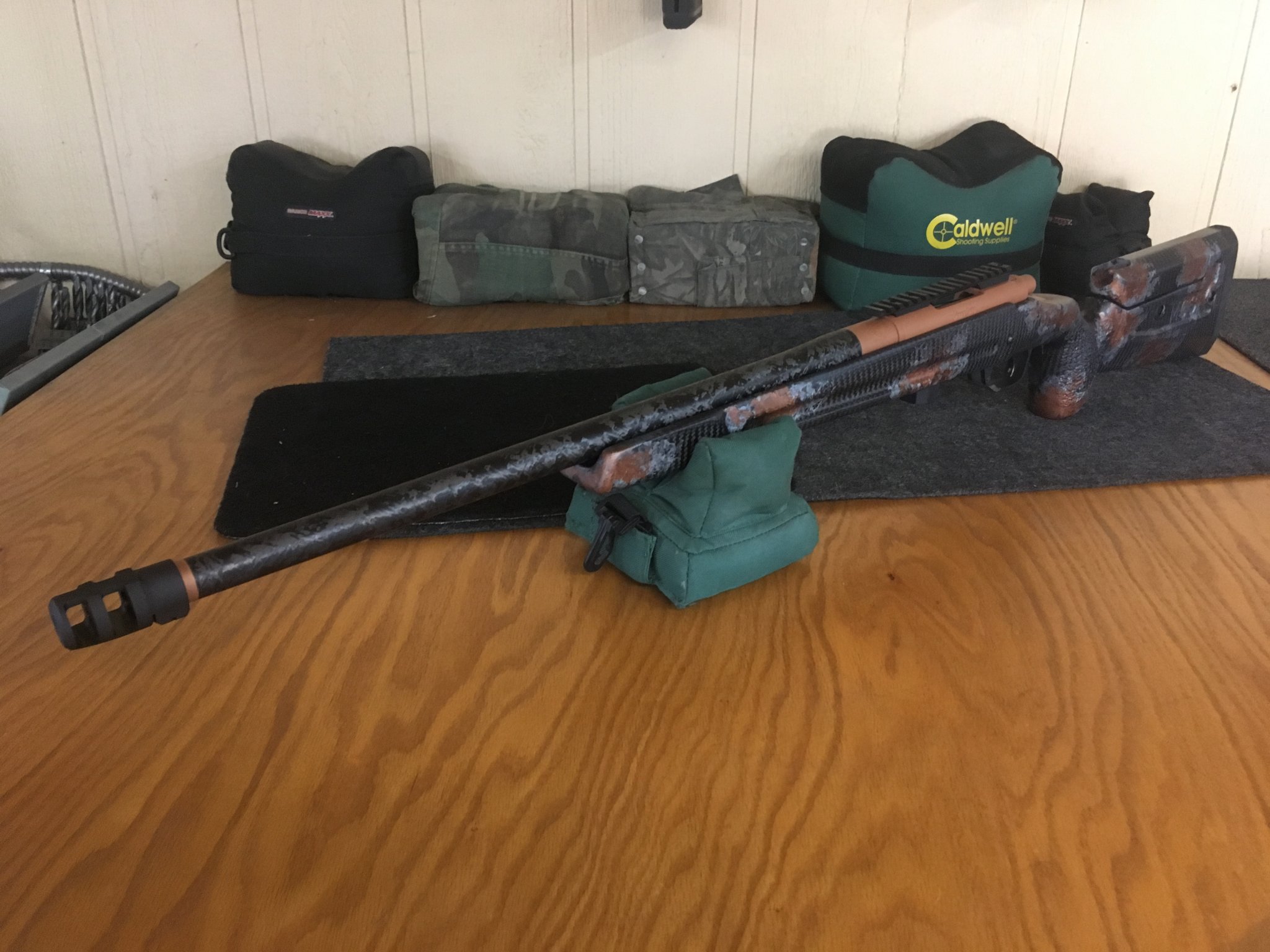

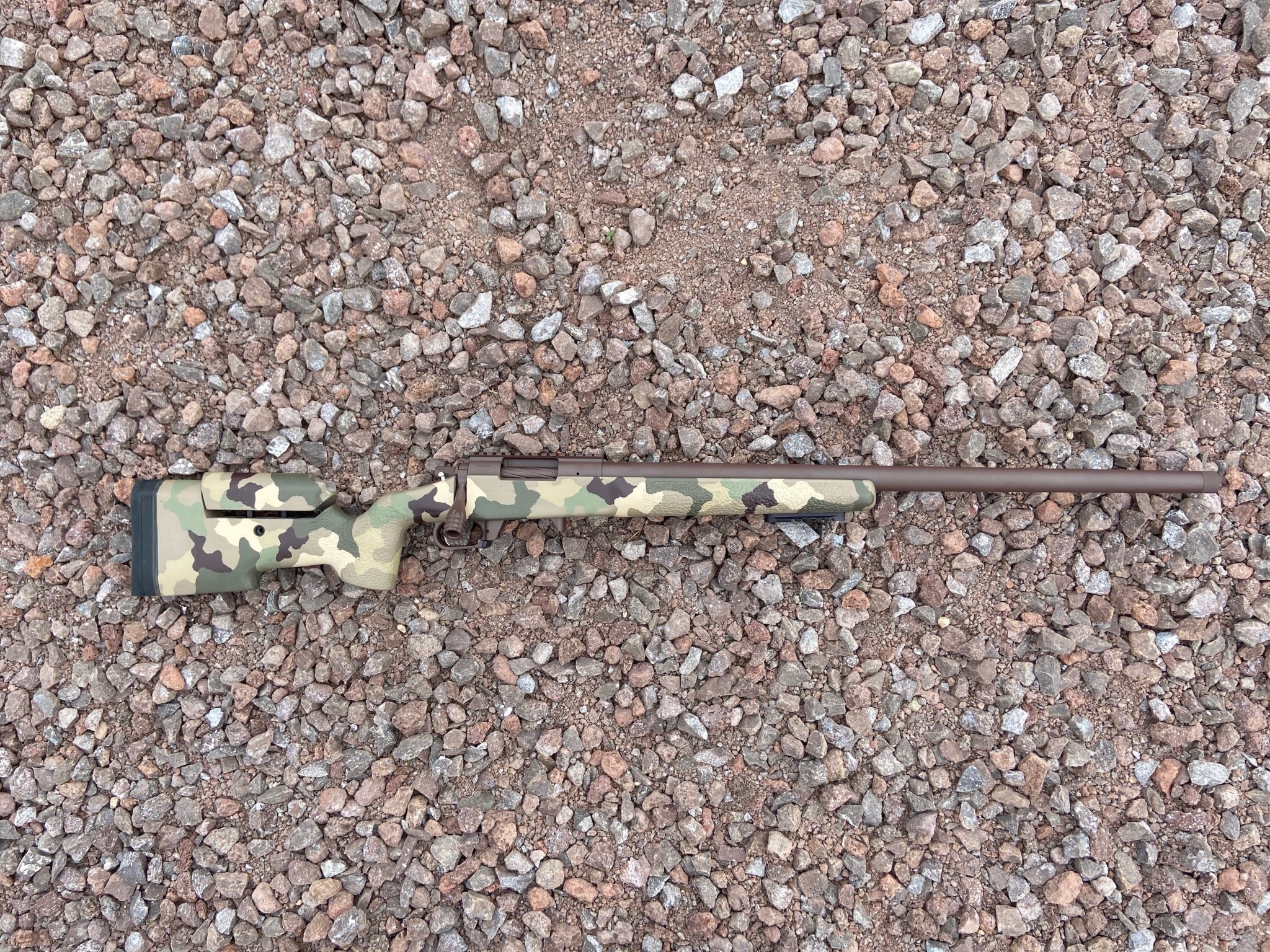

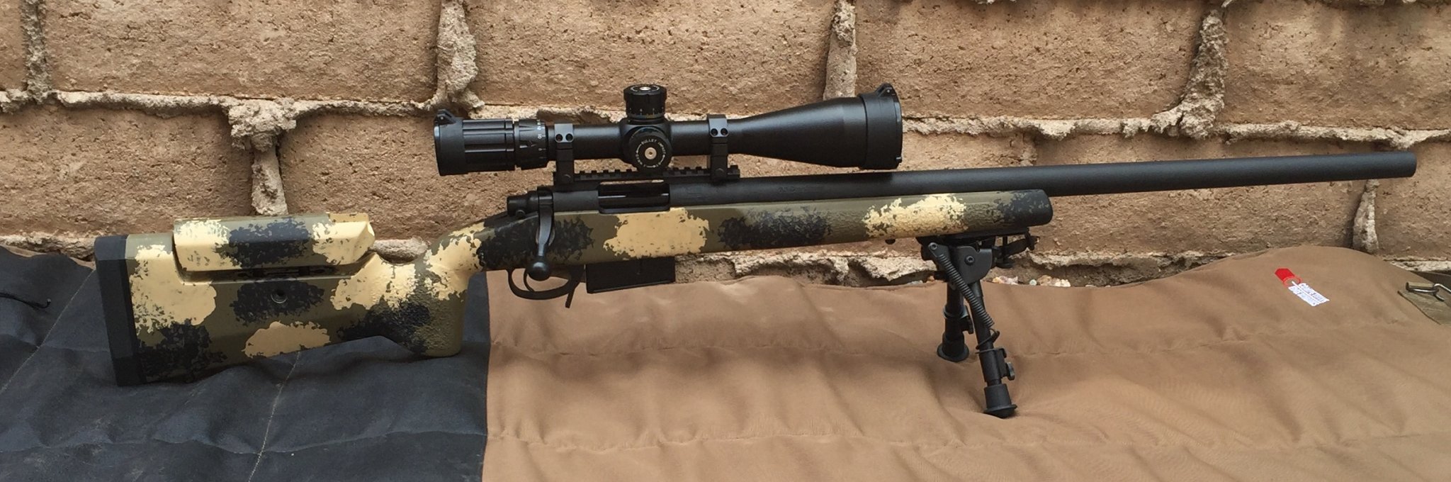

Nice 300WM just finished.
^^^^^ Don’t see the message from my post and wanted people in Phoenix to know that Keith did a fantastic job on my Lil Bastard brake. Do your yourself a favor if you need a brake and go see him?
7mm Mag, 168 gr Berger VLD on the lands, 3 shots 520 yards. Antelope don’t stand a chance...
Thanks again Keith!

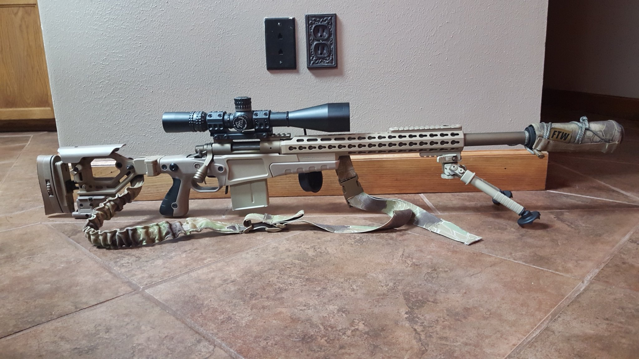

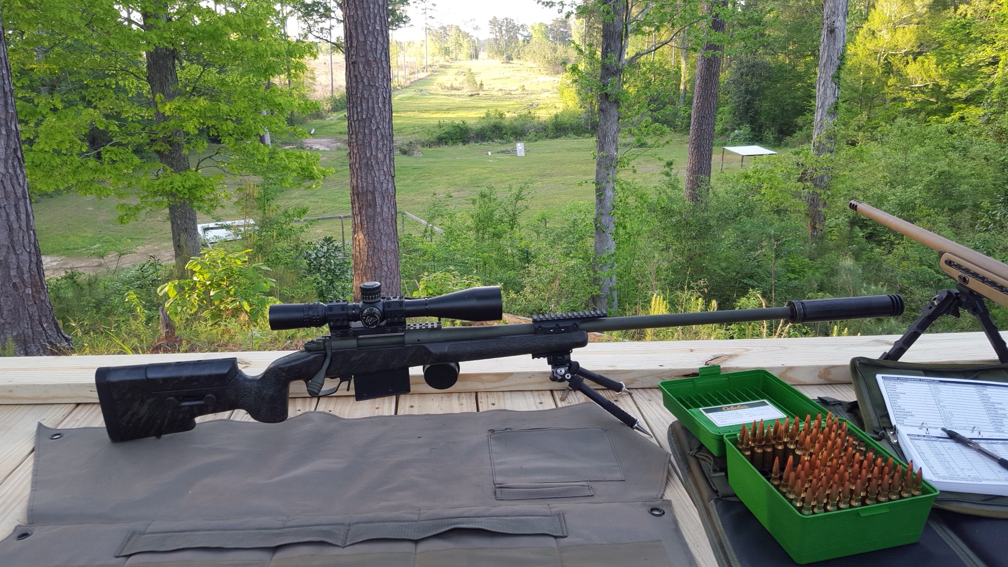

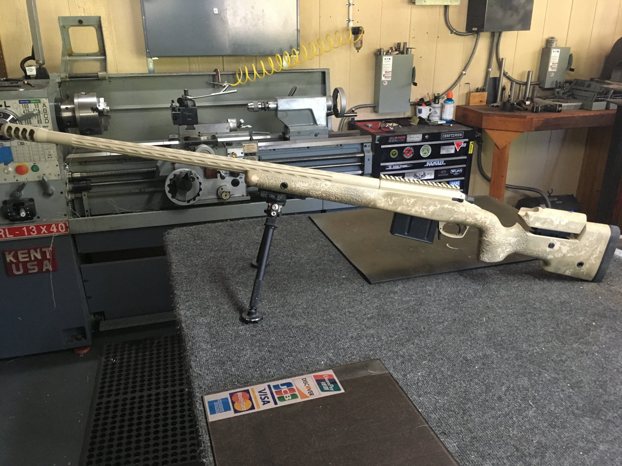

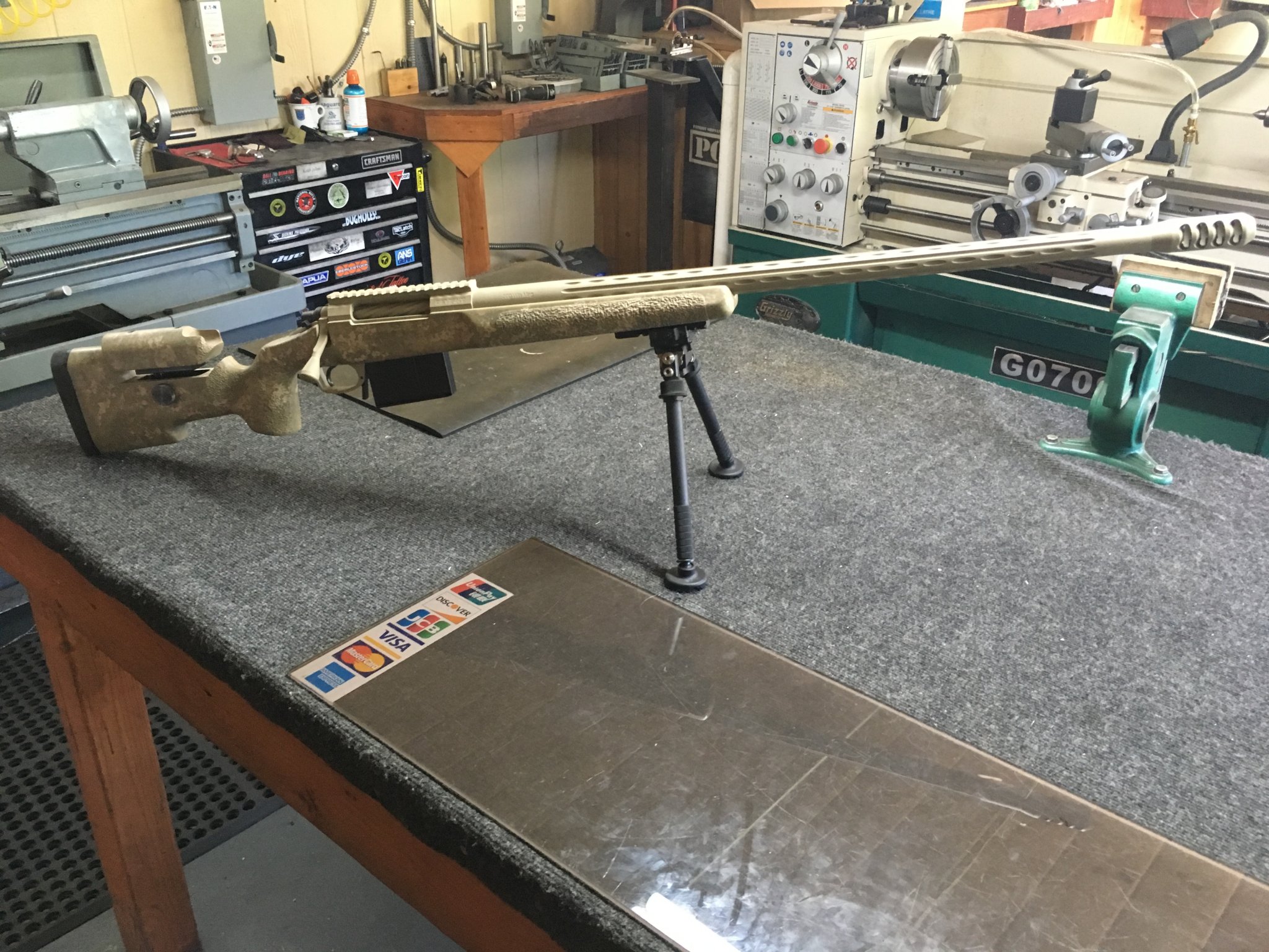

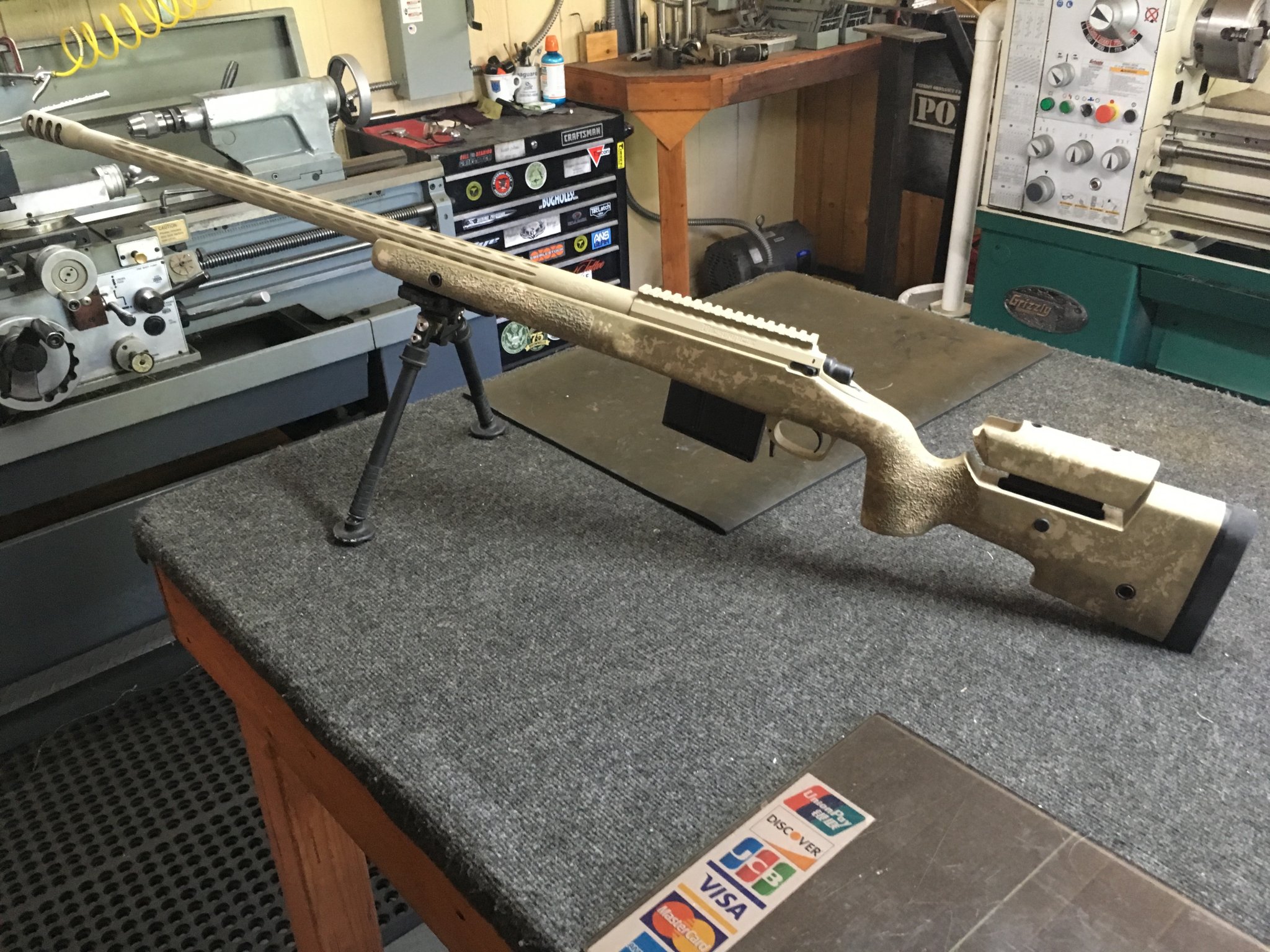

Here’s another shout out to Phoenix Custom Rifles. I received my complete rifle build from them last week and I’m thoroughly impressed. They completely exceeded my expectations. I can’t find a flaw or blemish anywhere on the rifle. It’s literally a work of art. And it shoots like a million bucks. I don’t like any of the new stuff, my tastes are about five years out of date. But PCR built exactly what I wanted. The rifle sits on my dinning room table and I stare at it for hours. Then my wife comes home and have to put it away.
Thanks Again Keith & Brad

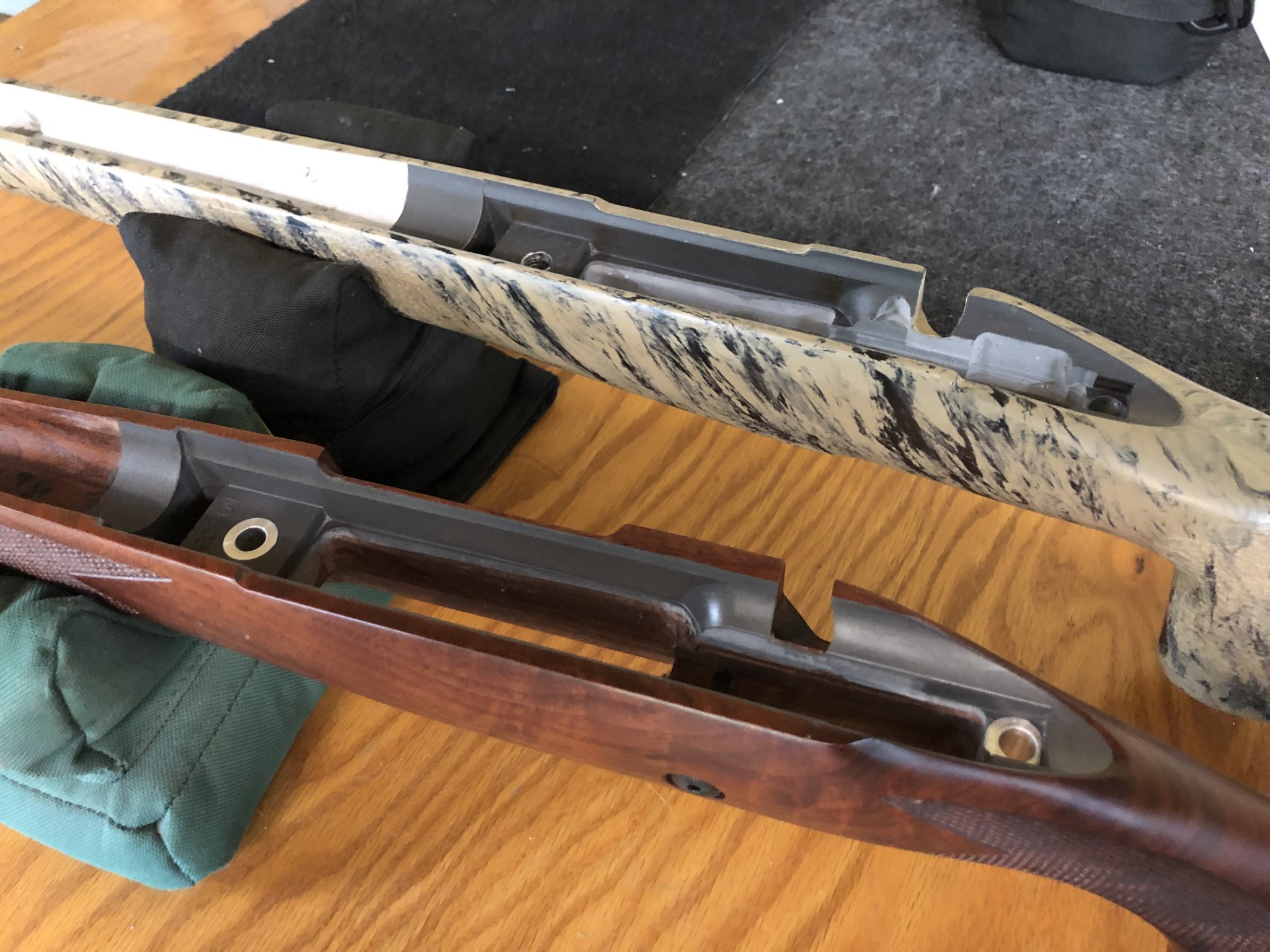

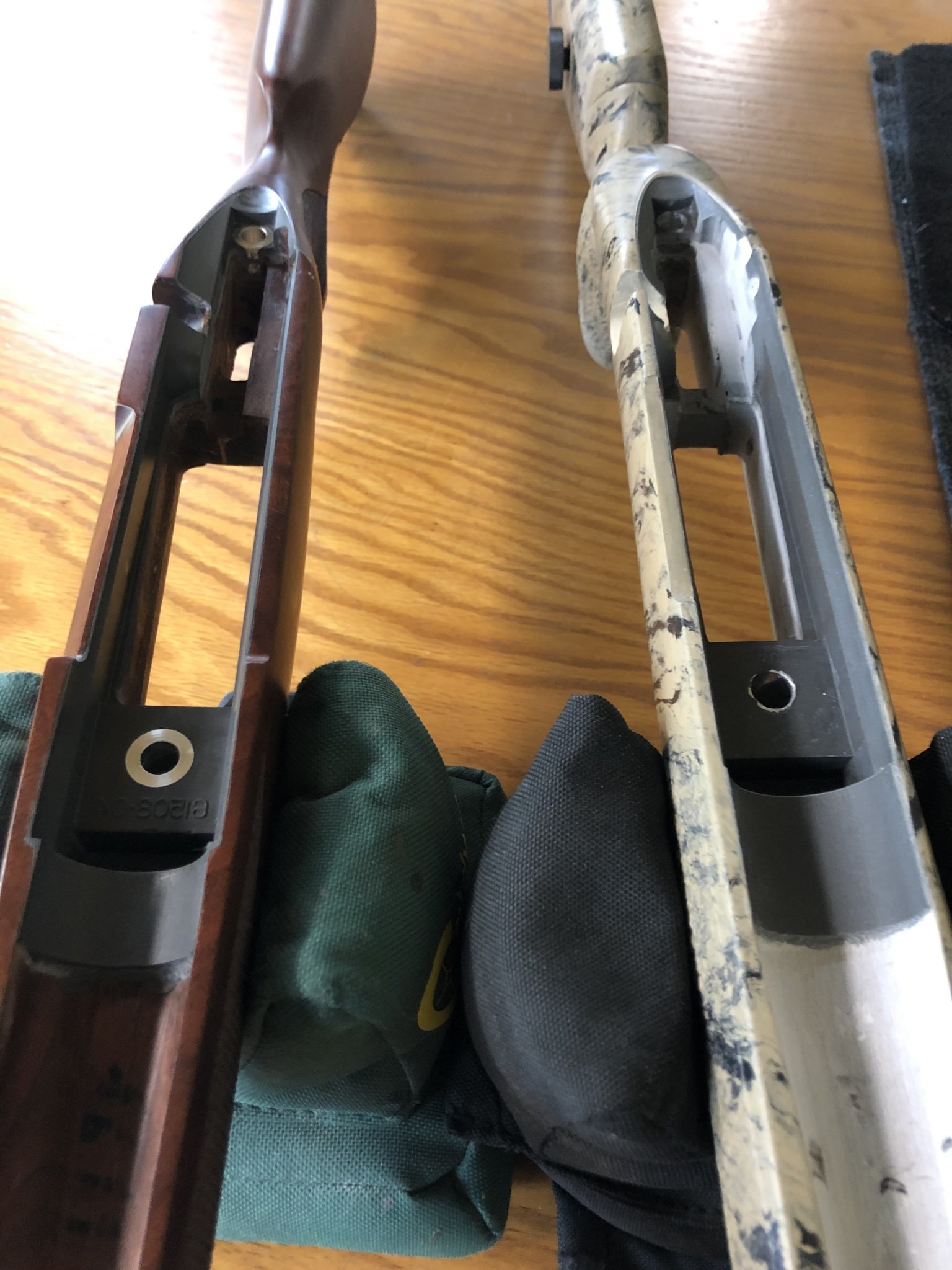

Something to be aware of...
Guys when you use a chassis system, the bottom metal or magazine holding portion isn’t moveable. It is fixed where it is and all one can do is alter the latch length to alter mag positioning.
Most of these chassis are designed for 700 actions. That’s a .696” diameter bolt. I’m seeing that when people run oversized bolts, which many aftermarket actions use, you can sometimes see magazine/bolt interference due to the larger bolt diameter coming down further in relation to the bottom of the receiver(since receiver diameter is unchanged).
So, good example I just ran in to is the manners minichassis with a BAT action(GREAT stock and GREAT actions). Inserting an AICS mag with the bolt closed is extremely hard. Pmags, forget about it.
You can insert both like butter with the bolt open, but then the bolt runs hard over the mag tops. The bolt is .720” in diameter.
Removing material off the latch(to lower the mag) is usually an option, but not always.
You won’t always see an issue with this topic but it’s something to consider if you think your barreled action will simply drop in to your chassis and be perfect every time.

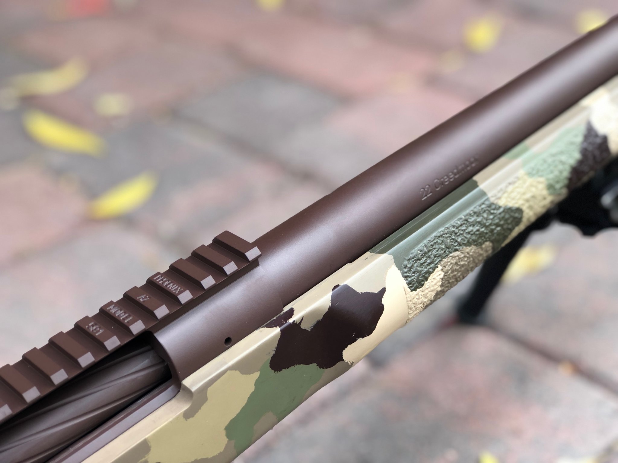

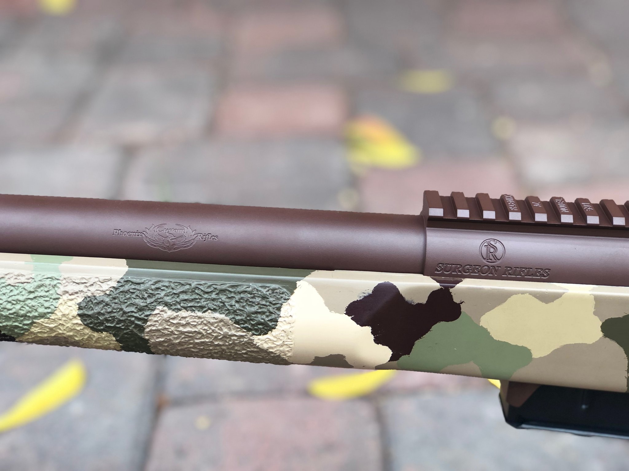

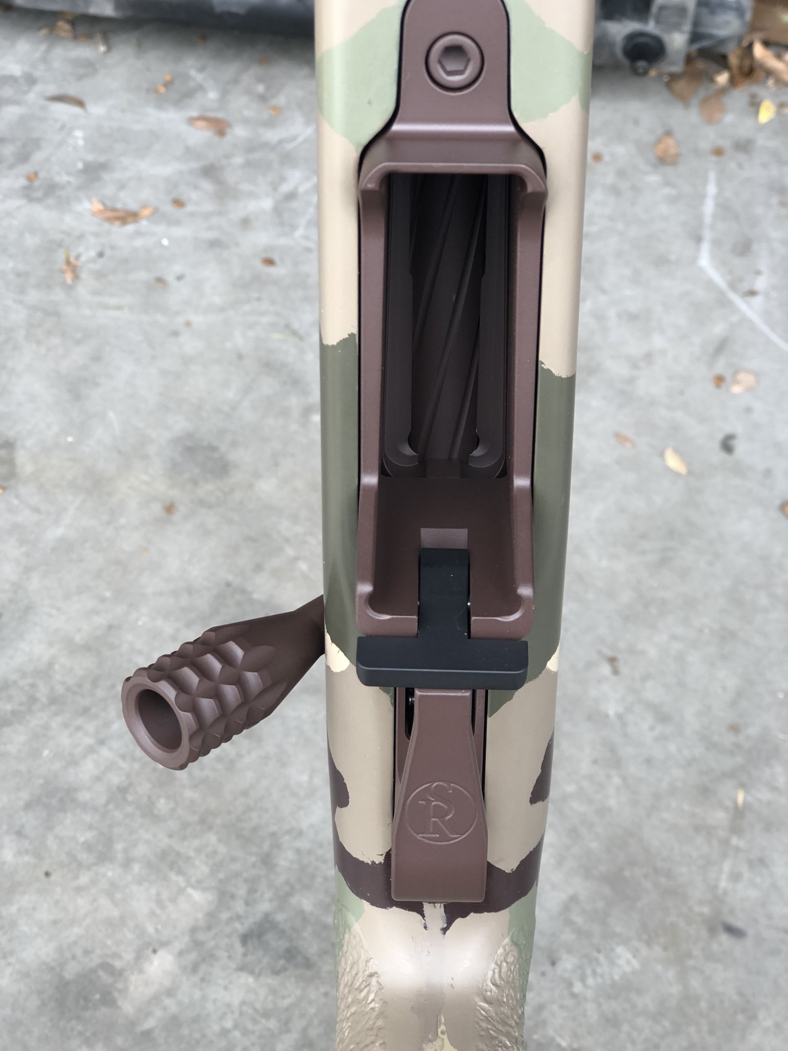

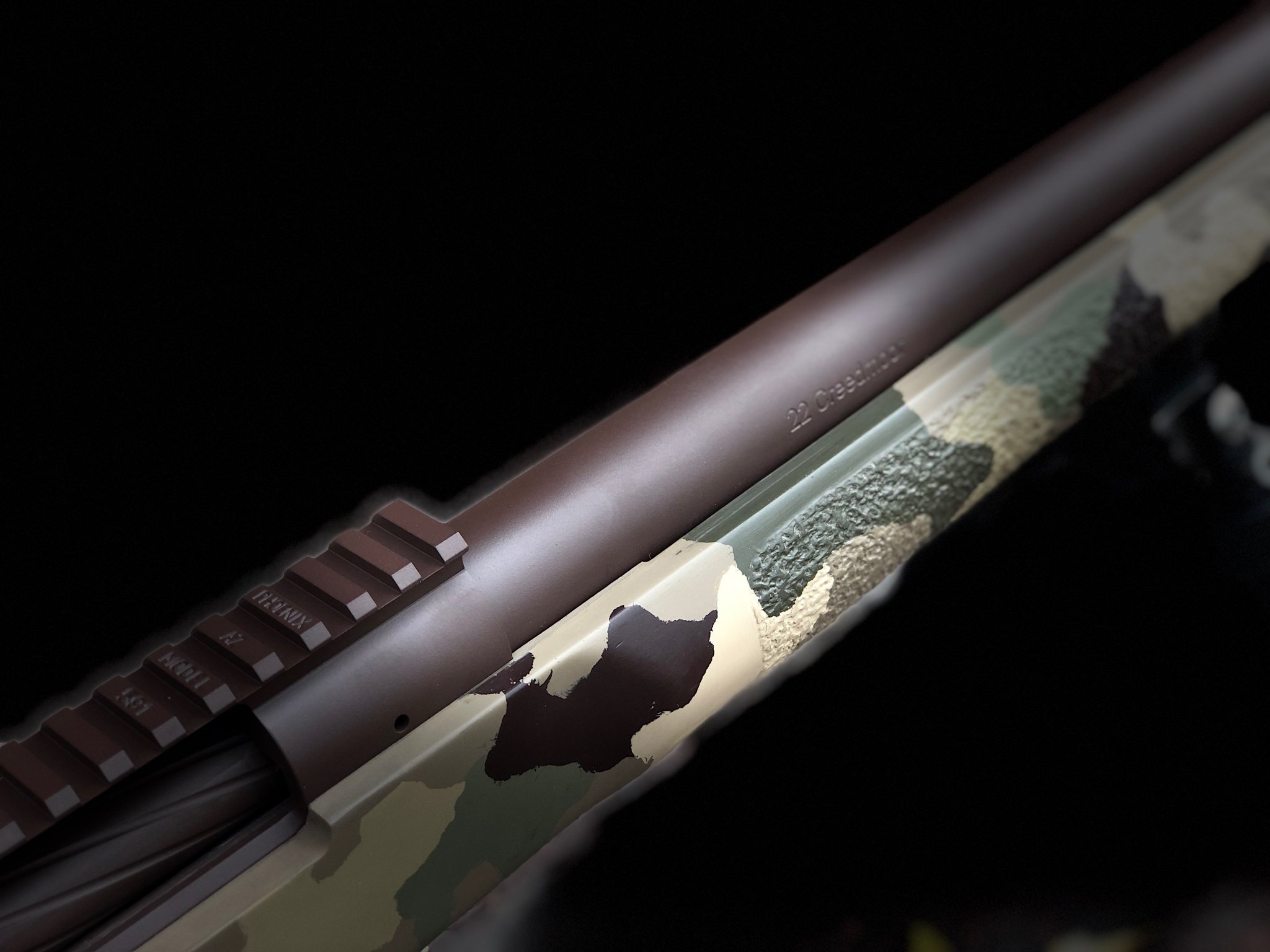

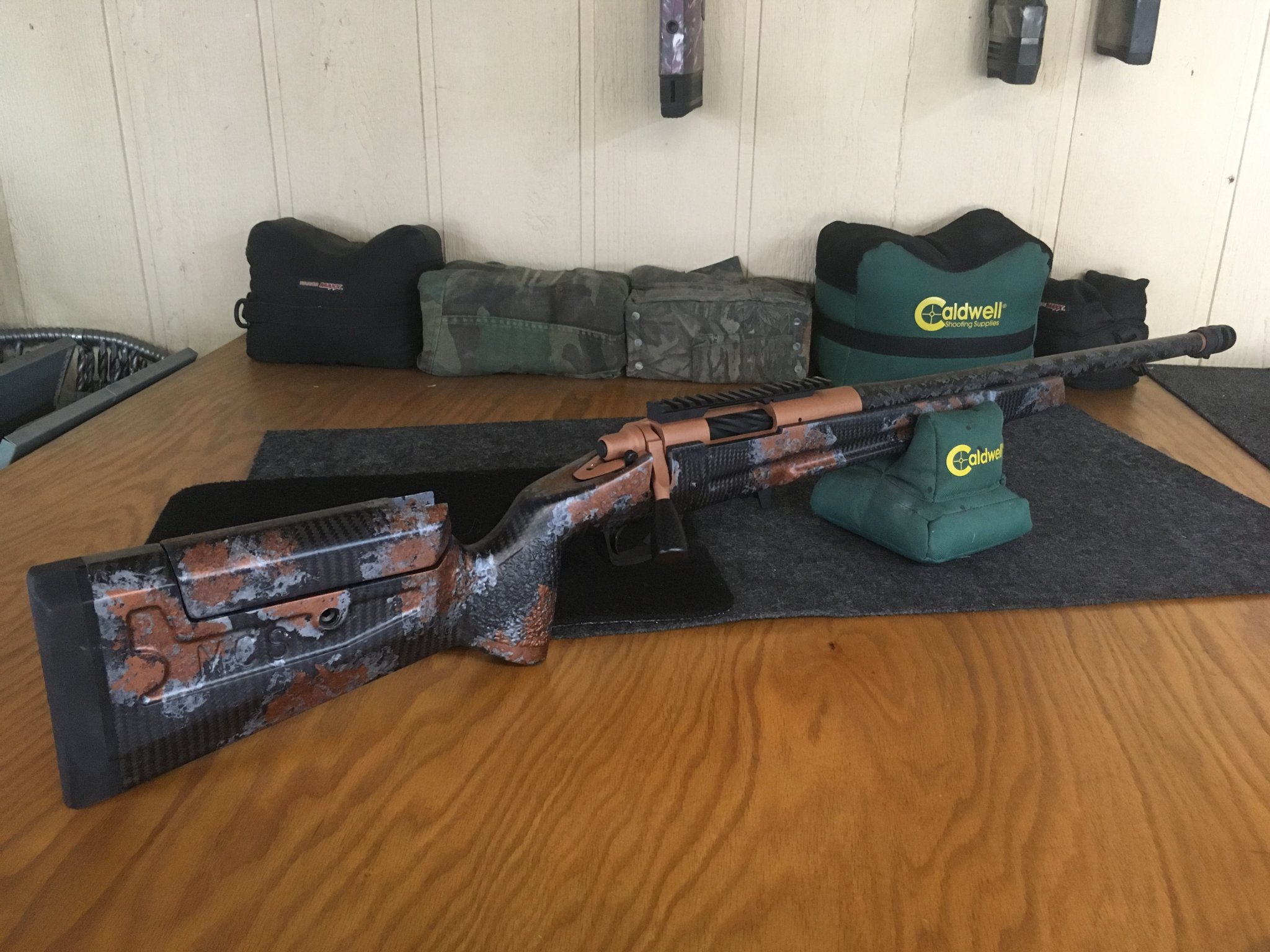

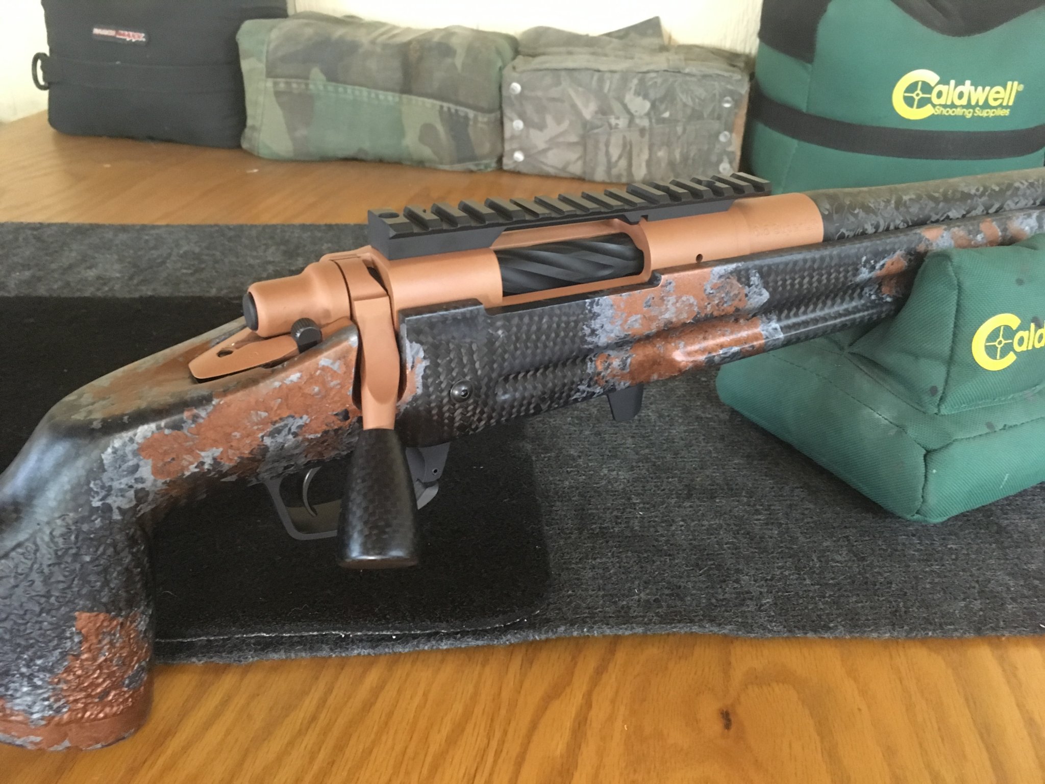

Copper color we came up with to match the Manners copper color.

Thanks for posting!

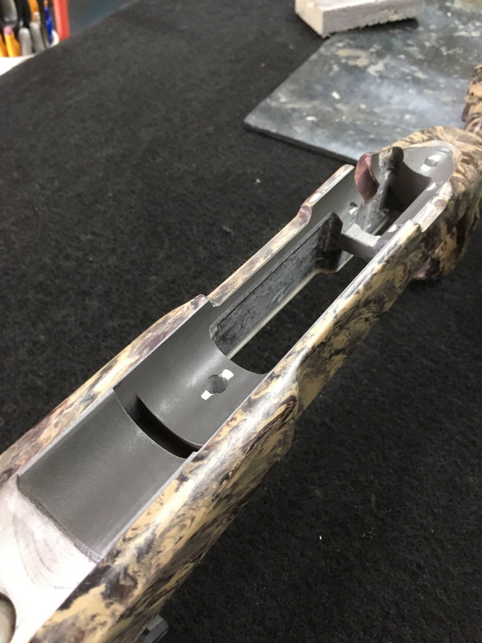

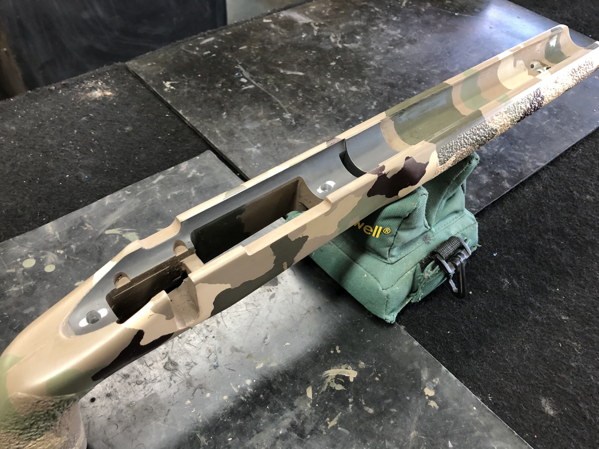

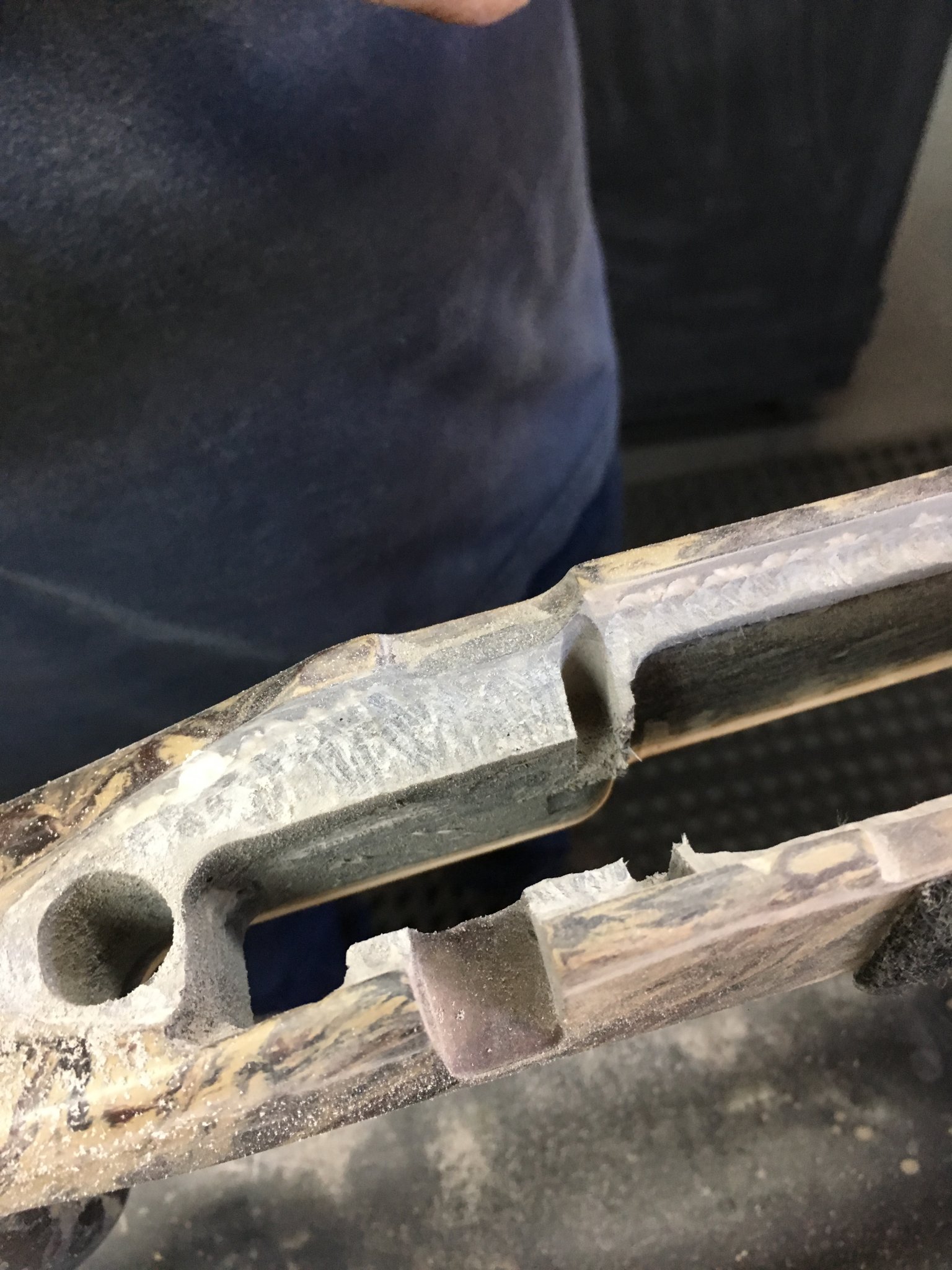

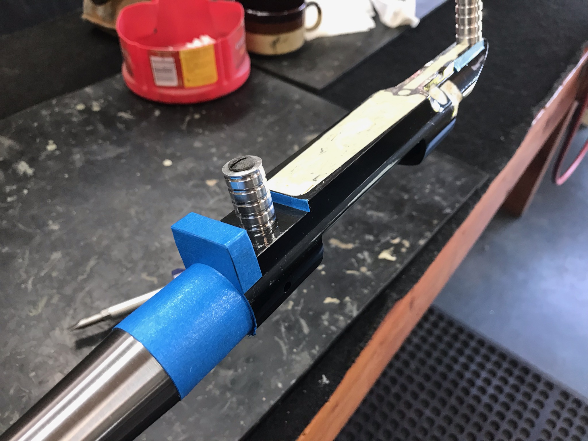

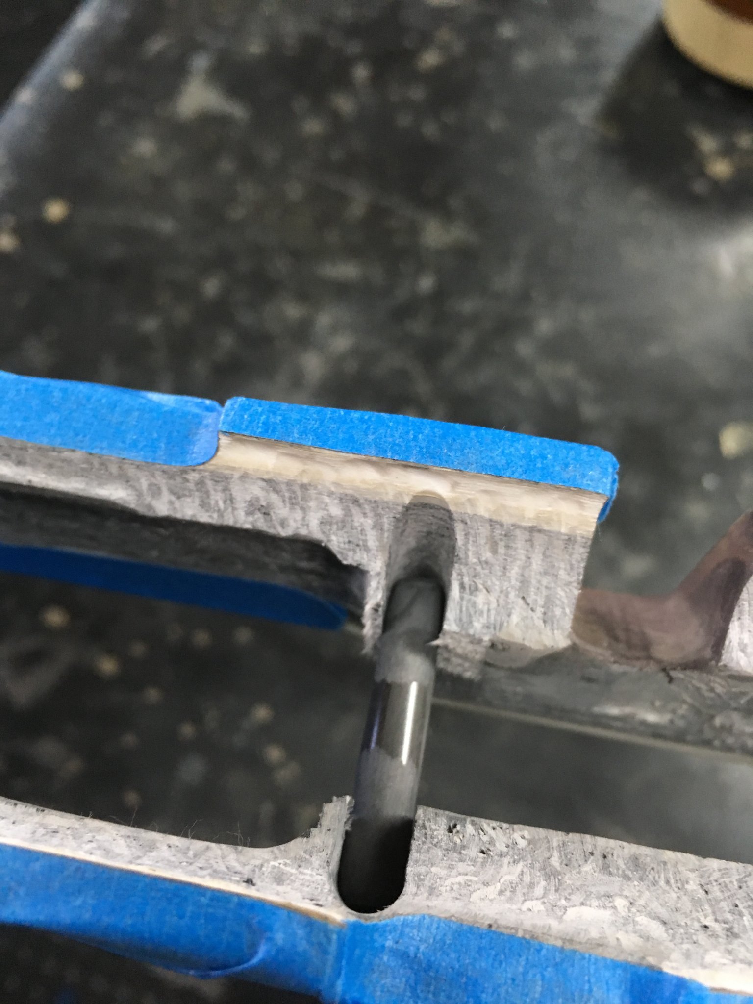

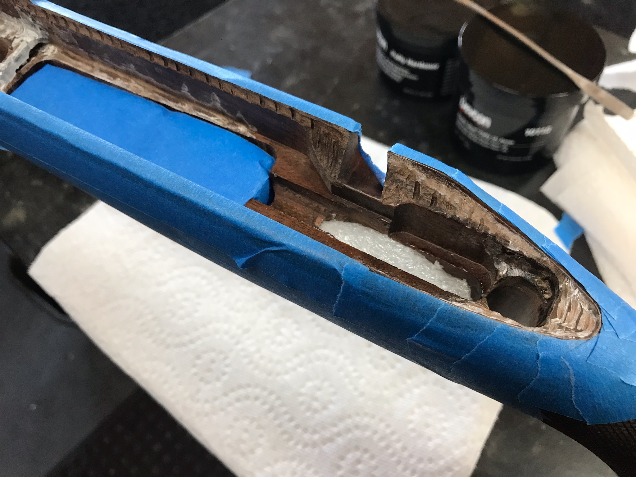

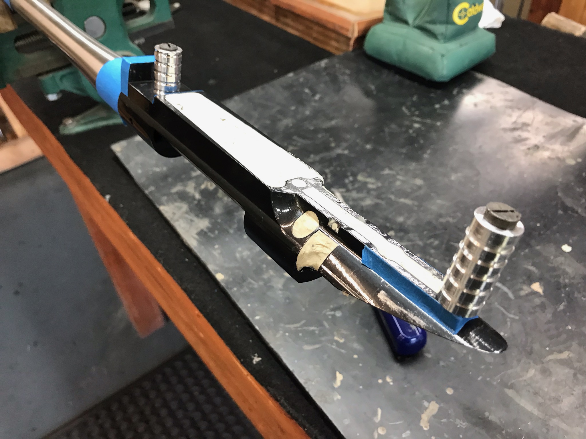

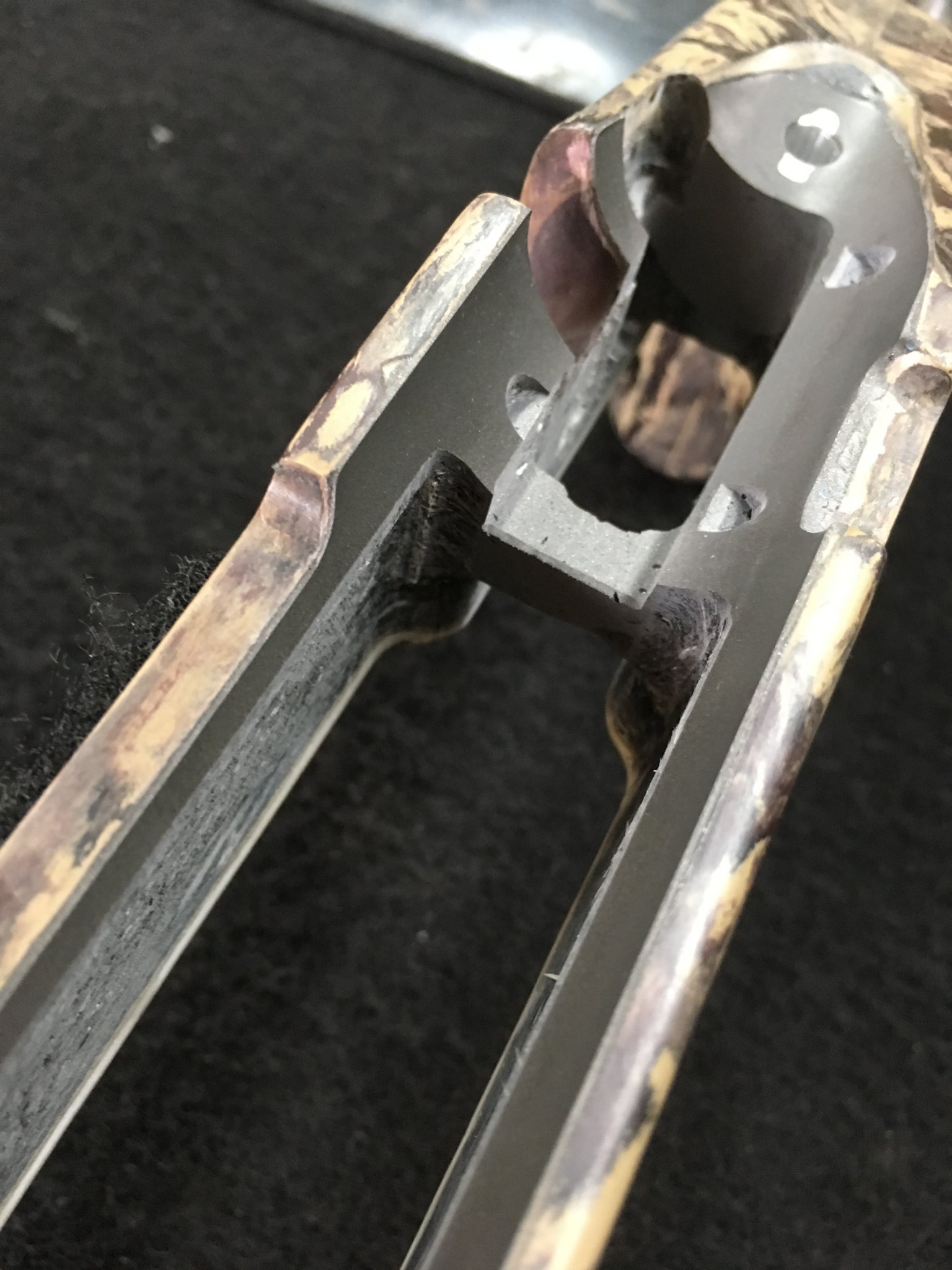

Here are some pics of the carbon cross bolts we use in some bed jobs. We do it when we feel it will help at all. And if you request it we will definitely do it.
I am also experimenting with a new type of front pillar someone designed and gave me a few to try. I won’t say much yet but it pillars the gap between the front pillar and the recoil lug. So that space isn’t just compressible fiberglass with a thin layer of epoxy behind the lug.
Now, that “thin” layer of epoxy behind the lug we have always thickened by about 1000%, but there is still an inch or so of fiberglass or wood behind that relatively still thin layer of epoxy.
We are working to eliminate all possible stock flex or compression within reason.

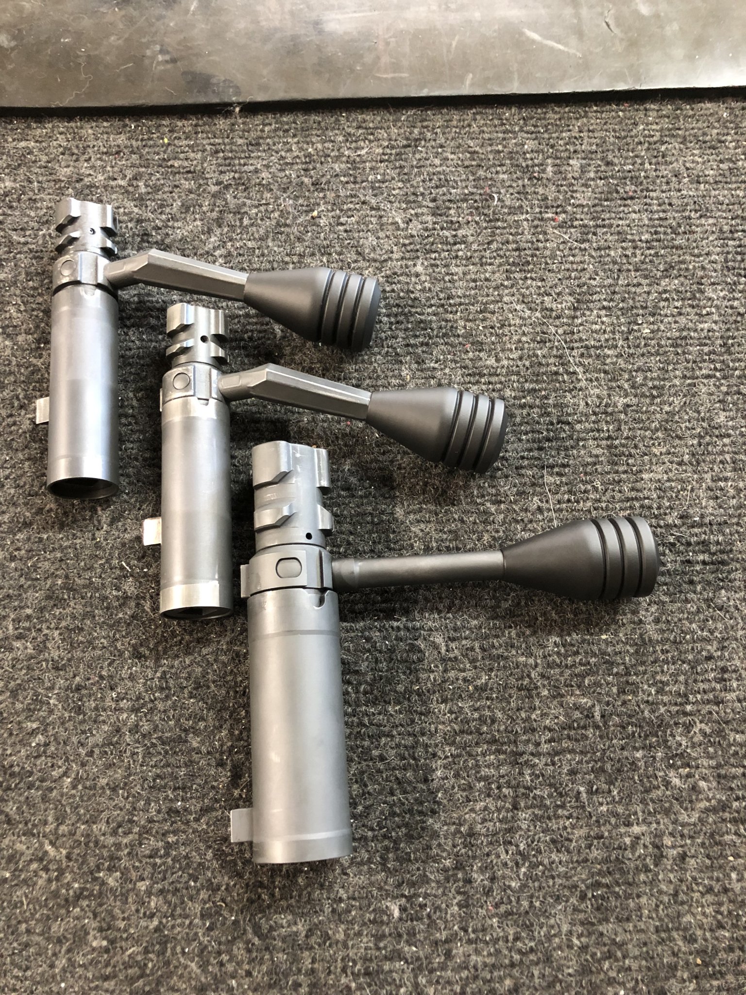

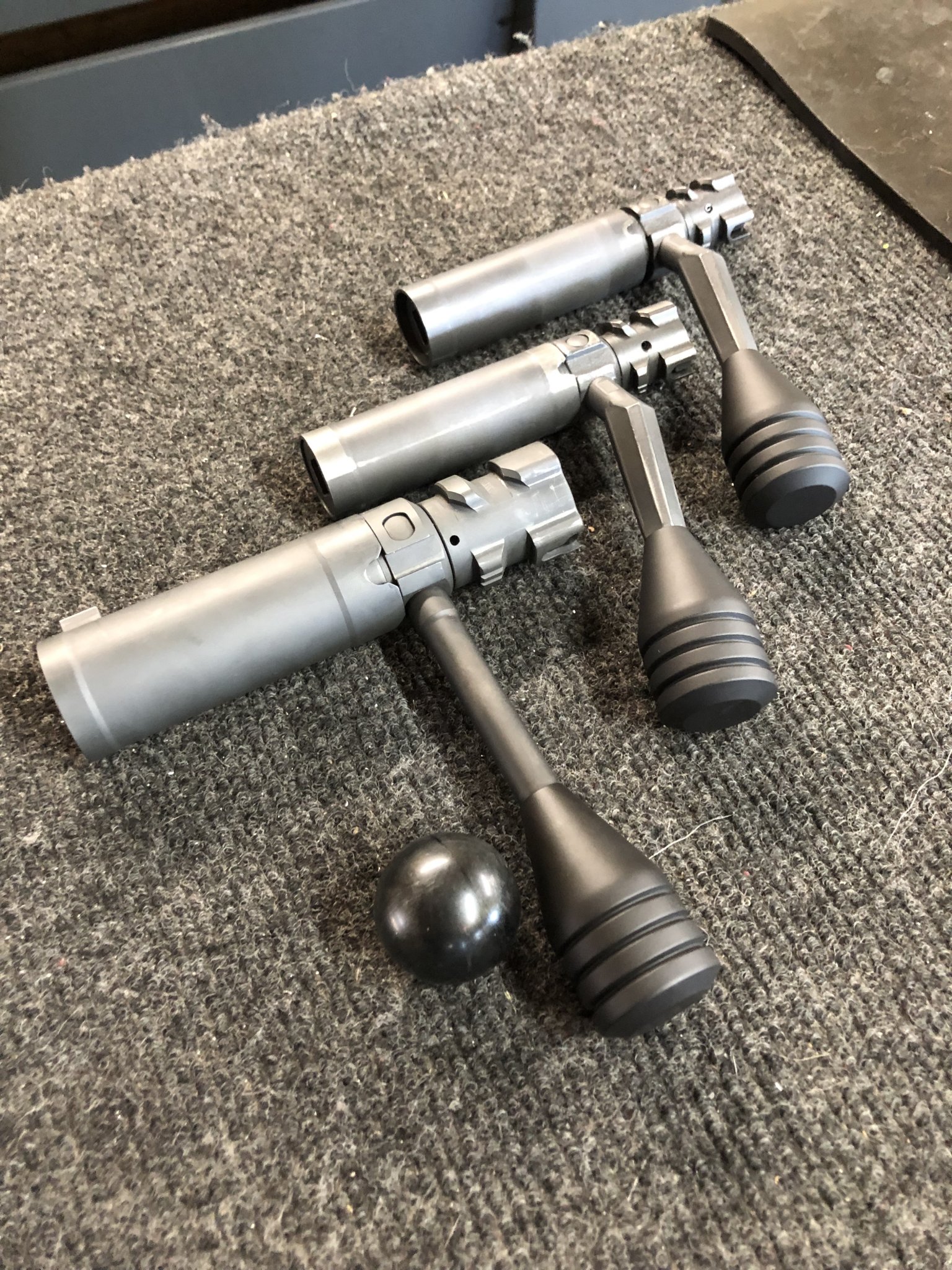

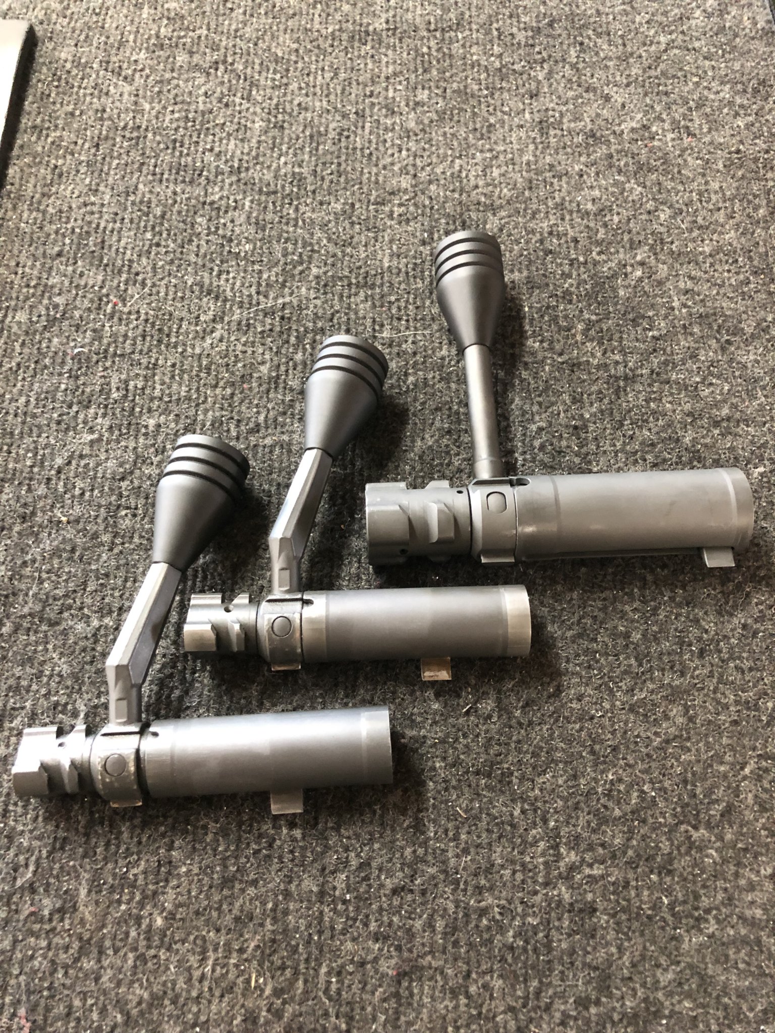

DTA bolt knobs

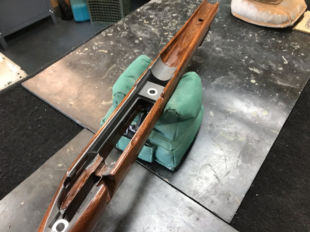

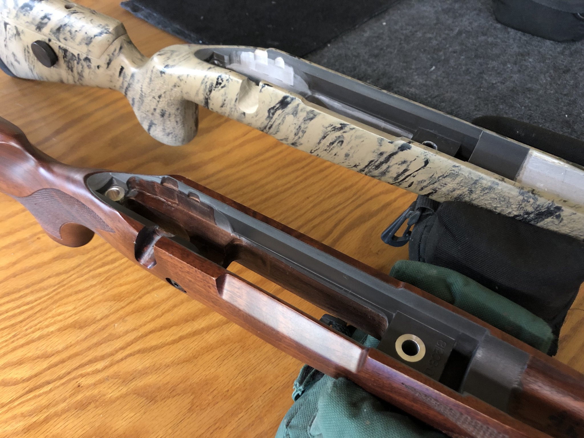

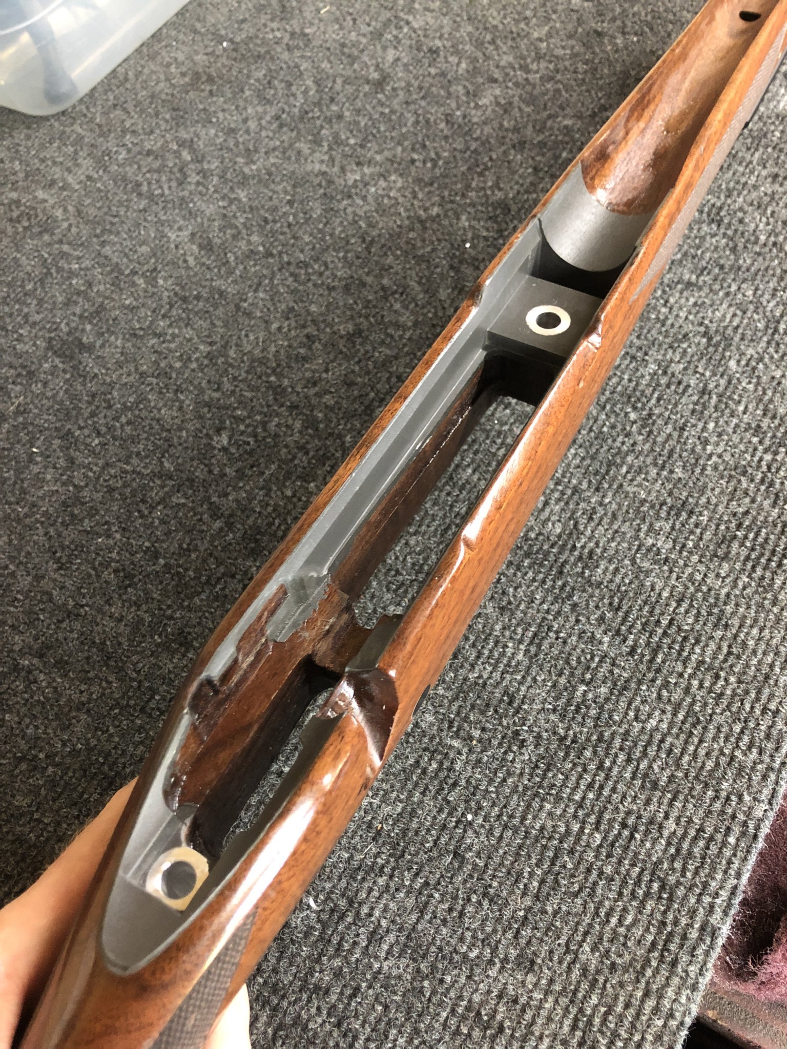

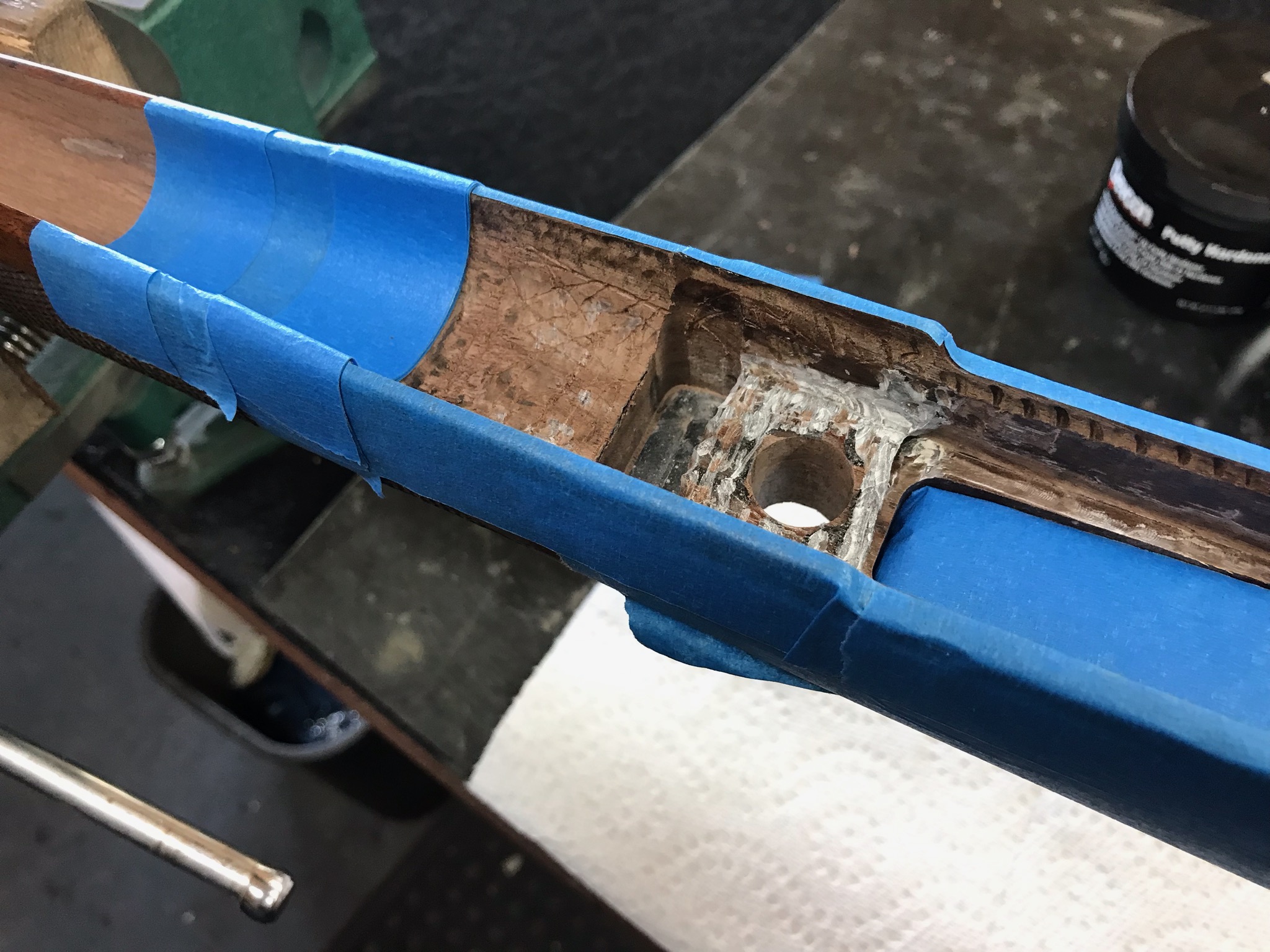

Three M70 bed jobs.
300PRC reamer should be in soon for those waiting. I’ll call JGS and get an update soon, I just don’t want to bug them.
Thanks guys!

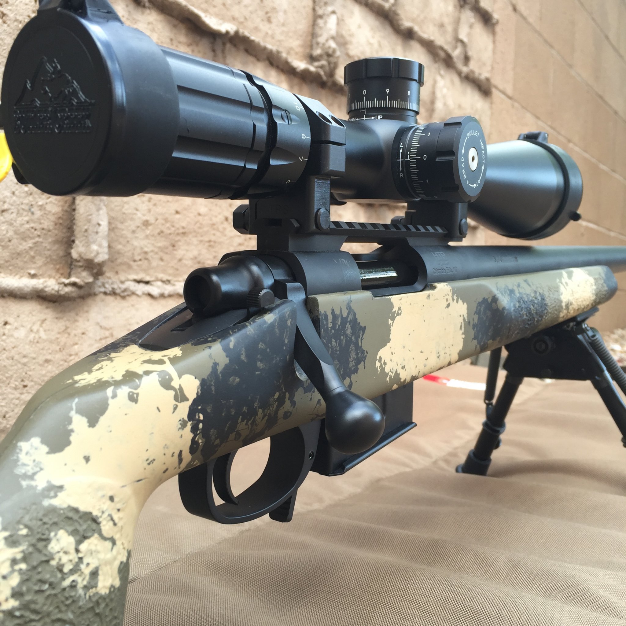

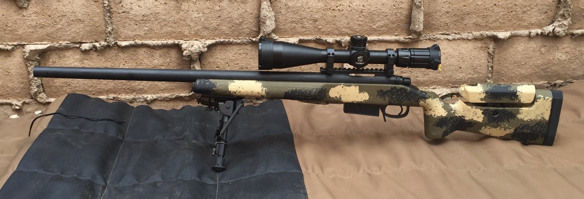

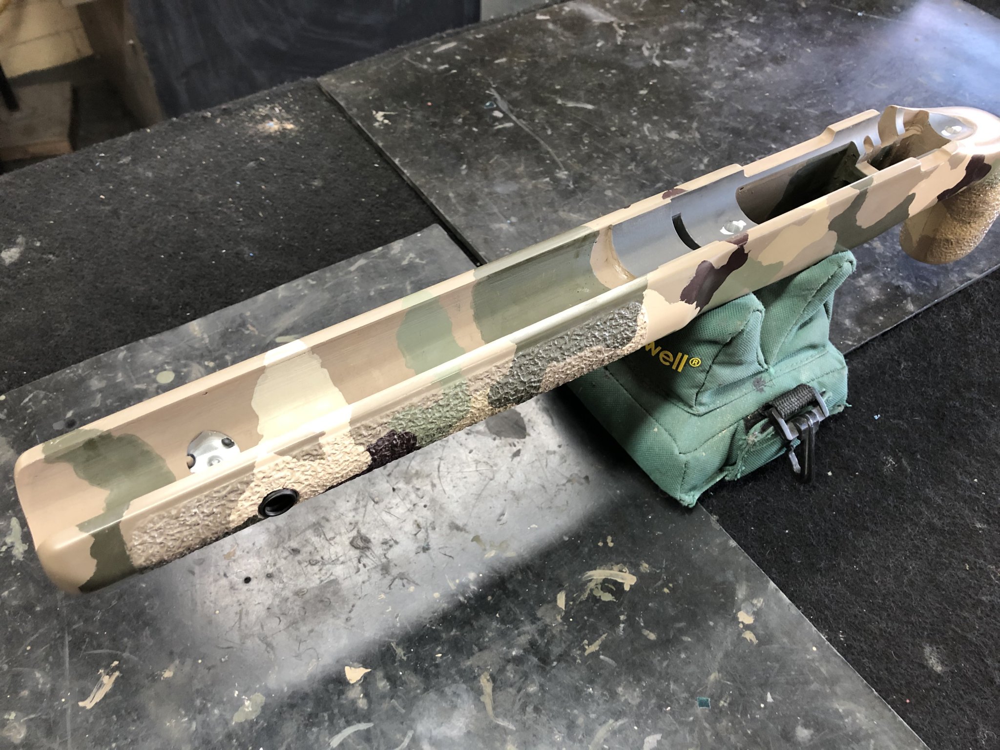

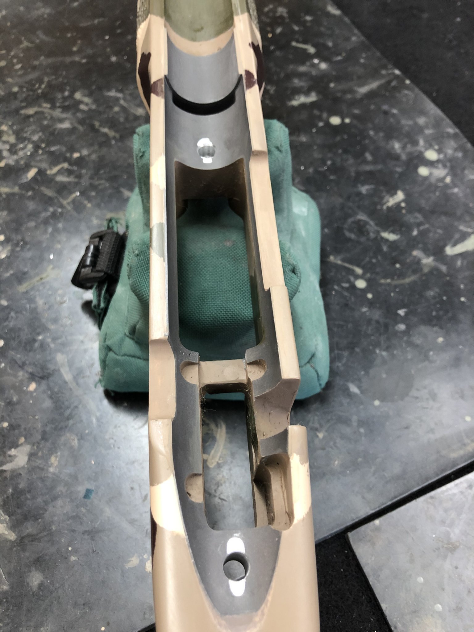

Phoenix Custom Rifles bed job and custom Cerakote color made to match Mcmillan maroon.
