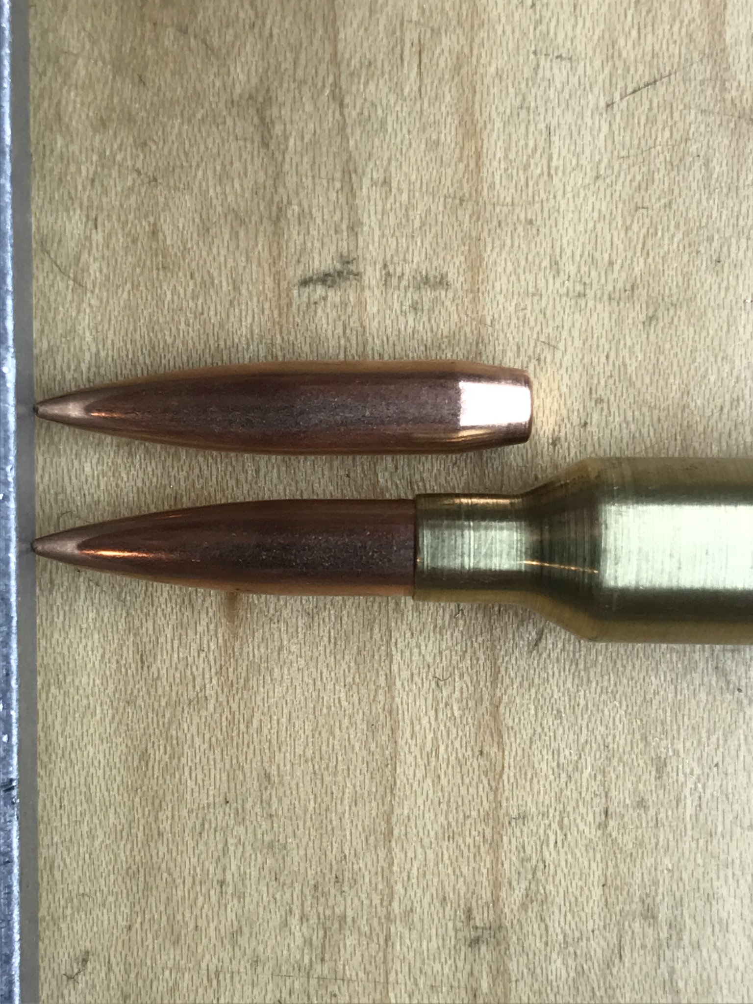

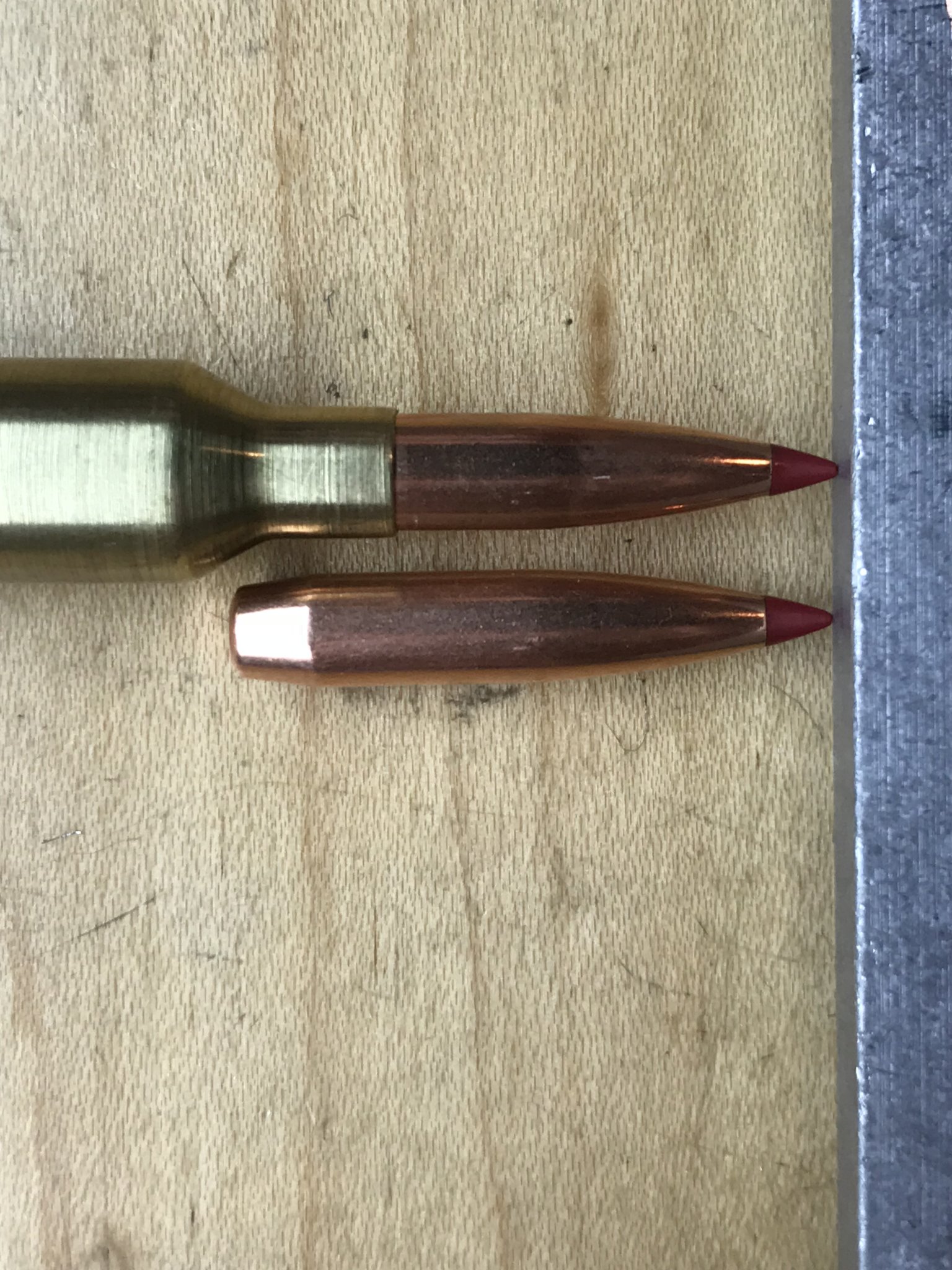

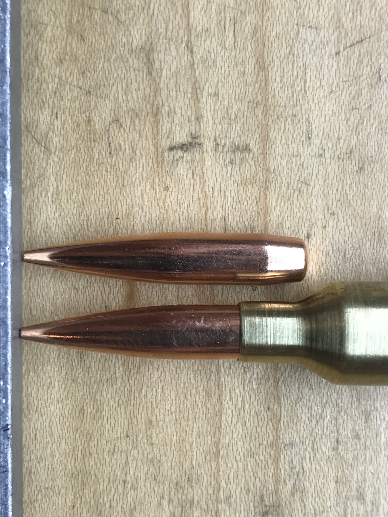

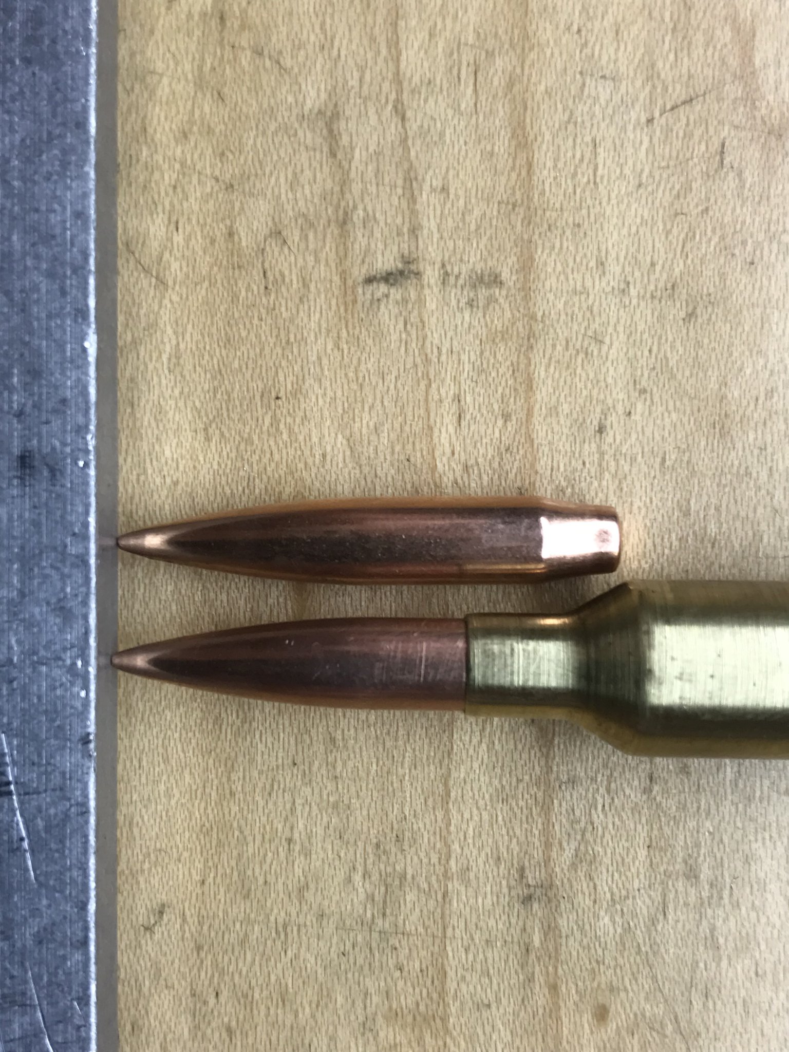

This is out of a sammi .183 chamber. I will do the same to my .136 chamber when it gets here
Top to bottom .
115 DTAC
105 HYBRID
108 ELDM
107 SMK
