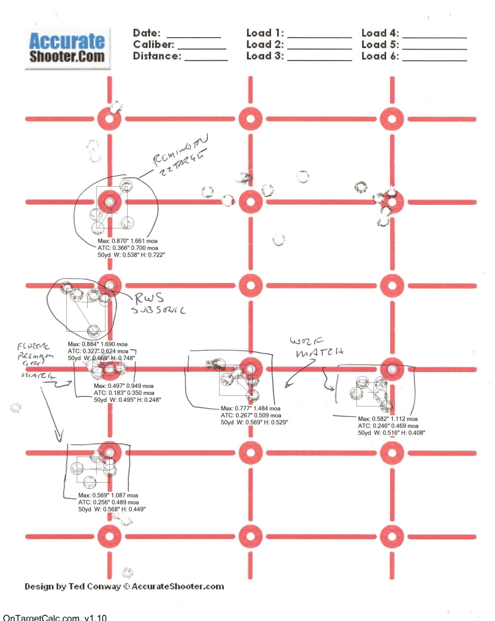

    Went to the range today. It was a little breezy but here is what my ammo sampling looks like. (I didn't bother with the crummy high velocity group.
    There are a few sighters in there, I went out to 100 yds and back once, nothing to show from out there. 2.4 mils will get you w/i a couple of clicks if you're doing it for the first time.
    That scattered group in the middle of the top target I actually cut a stick that was hanging down in front of the target. hit it once, actually cut it with a hollow point.

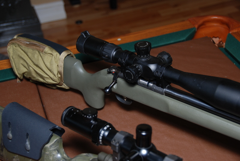

    The 453 has a long reach to the trigger whether it is the OEM stock or some other one. I like the longer reach as I have large hands and long fingers. I find that the standard configuration of most rifles including center fires is too short for me, but I make do because that's the way the world is built. I'm 6'4" and I'm accustomed to things not fitting, that said, the vertical grip makes the reach a tad long, even for me. It's probably way to long for the average shooter.
    I added 1/2 to the LOP with a spacer from Midway. It really helped make getting behind the scope comfortable.
    I added a Triad stock pack, and I've got a foam spacer under it from a neopreme comb riser that I use on my muzzle loader. The stock pack is great for keeping extra mags in and really makes the cheek wed comfortable and reproducible.
    As it stands now I really like it, but it's certainly not "off the shelf".
