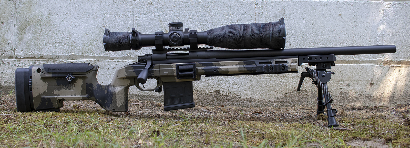

I'm running a Bravo with a Whiskey forend. I have my Harris with KMW Podloc mounted on a KRG full spigot with L3 rail using an ADM QD rail adapter. No interference as long as I mount the bipod far enough forward on the spigot. This pic should give you a decent idea of the clearance.

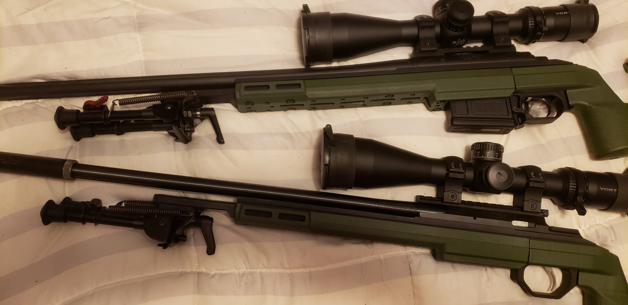

I ran into this problem last year - this is how I fixed it. Some time with a grinder, touch up paint, flipping the direct mount around, etc.
ok.....im game, i'll give this a shot tonight before i get pissed and just order a CAL and MPOD lol
It is an option to make what you currently have work. However, I will openly admit, I ordered a RRS arca/pic adapter and an Atlas a few weeks after doing this modification on my Harris. The Harris still works perfectly well on a hunting rifle.
Take a look at the link to the other thread in post #9 - there is no need to run the bipod backwards if you are willing to modify it slightly.
That did the trick! I cut the first one and then smoothed it...the 2nd i just used a sanding wheel on the dremel until it fit with just enough clearance.
Either way...simple solution and pushes the bipods even further forward!
