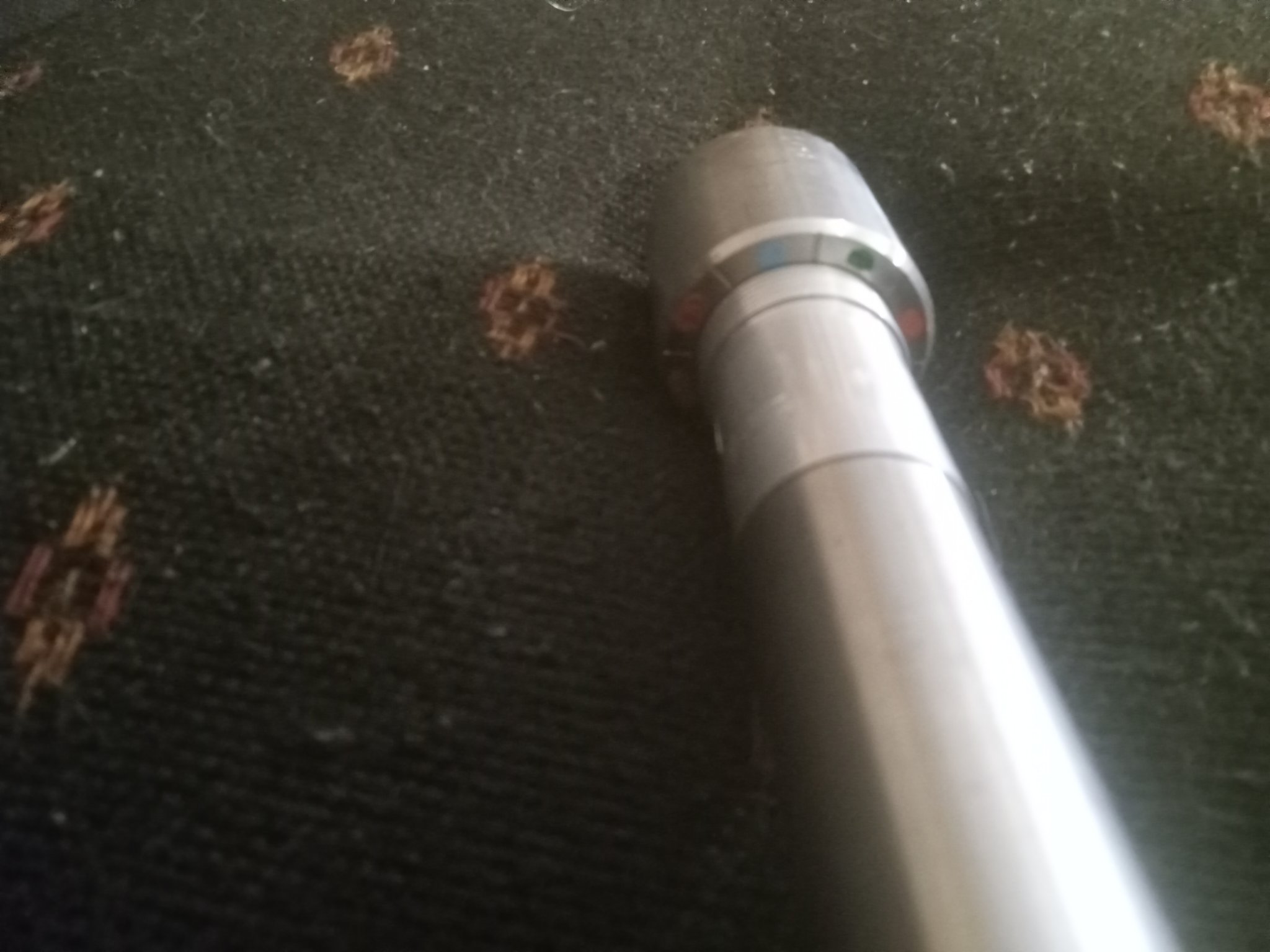

Now to those who want to actually give a tuner a try here is a picture of a Stiller tuner on a 6mm-06 with a 30 inch #17 contour barrel.
The tuner is only 6 ounces. The mounting tube has been extended to get the extra leverage needed because the tuner is on the lightside.
I took the picture from the back so you can see how it is marked with Testors model paint.
If you can expand the picture there are paint dots and lines.
There are 3 nodes between one dot and one line that will shrink and open up your groups.
If your moving the weight half an inch your shooting in the dark

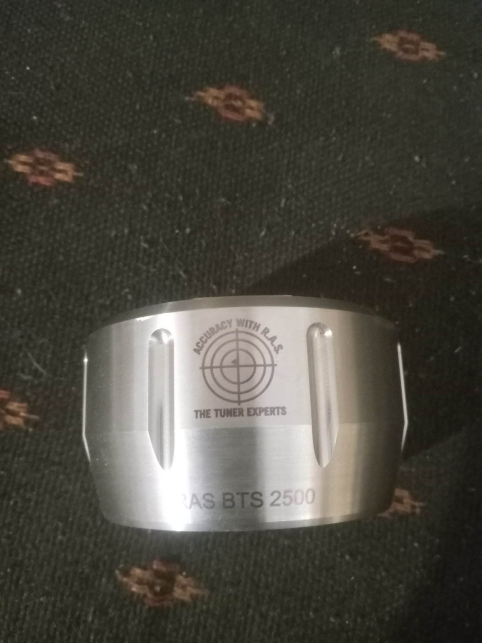

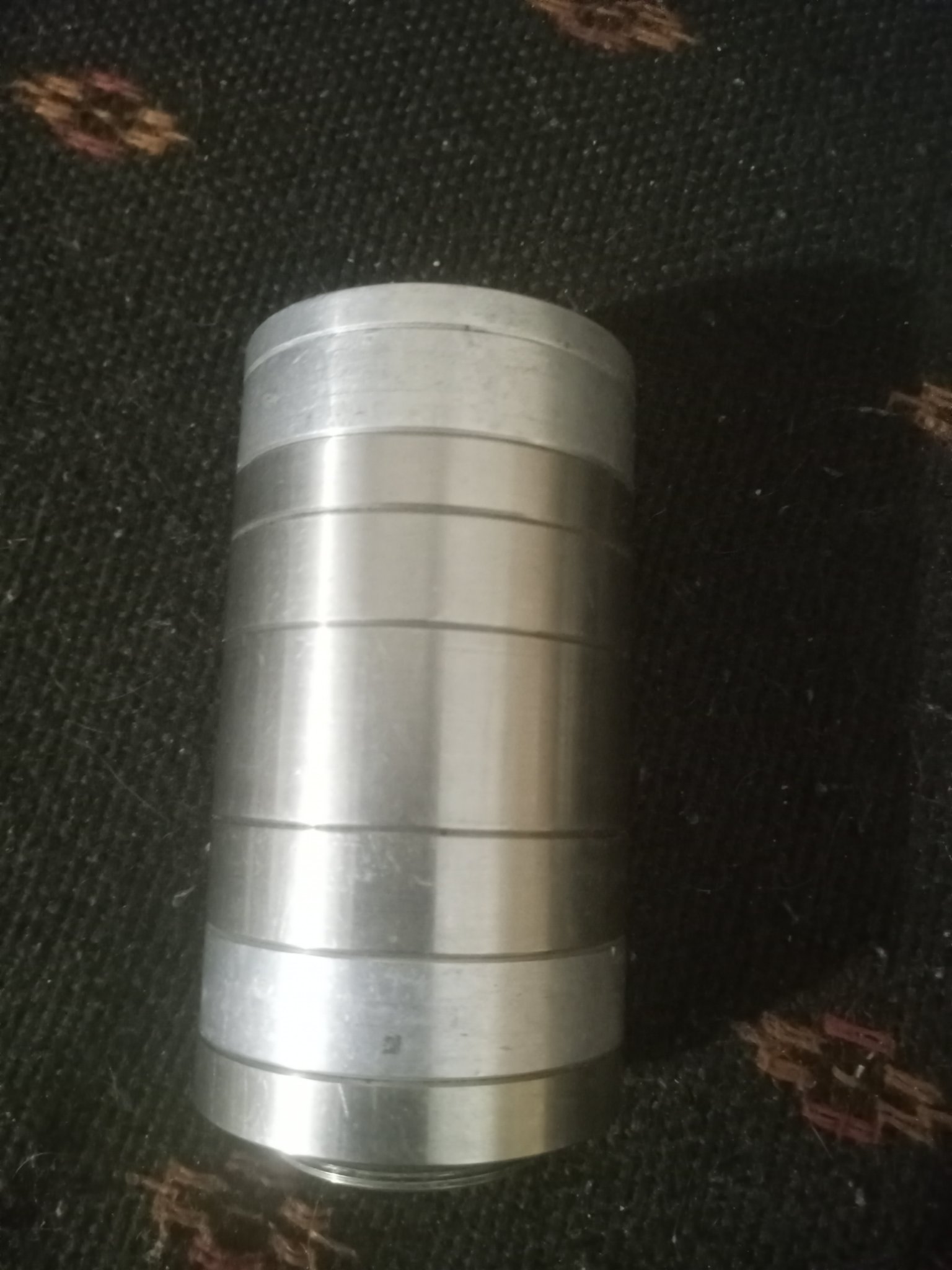

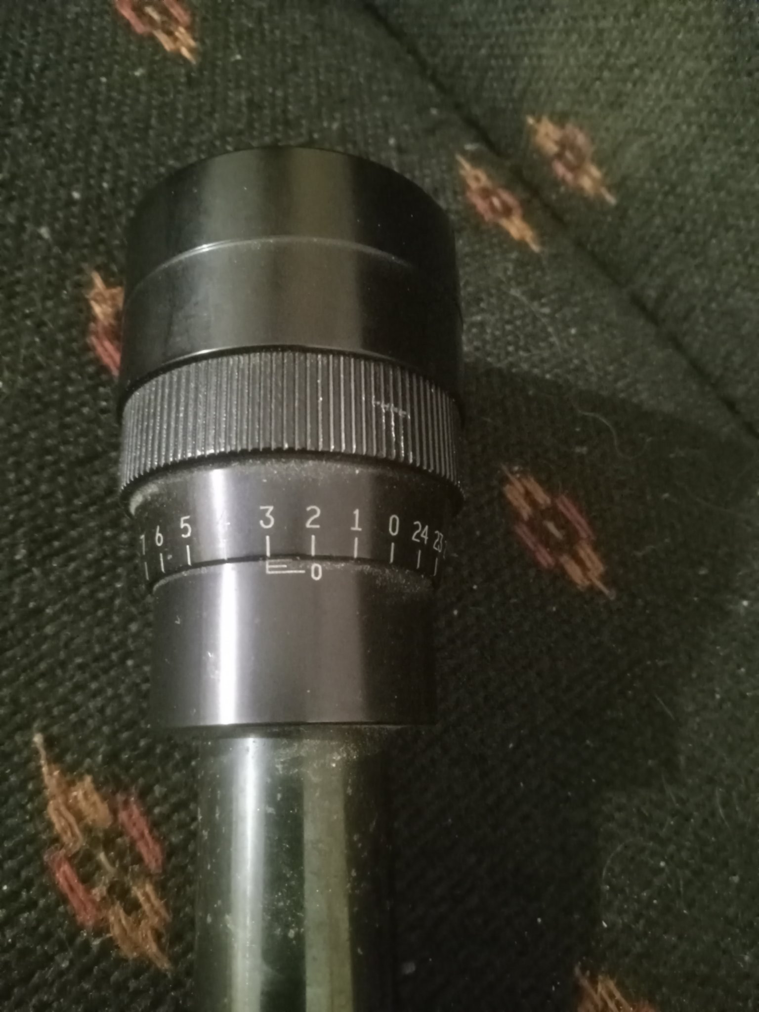

Now for those wanting to learn something here are 3 more tuner types.
The black tuner is a Harrells/Hoehn tuner most commonly seen on rimfires. They work well on centerfires but due to the click spacing they are harder to tune. The Stiller is held in place with an o-ring and the Harrell/Hoehn has a click detent so it's less precise.
Next is a VonAherns that is made of aluminum and stainless sections that are all interchangeable except the very front piece. It has thousands of possible combinations.
The 3rd tuner Is a patent pending RAS tuner for a 50BMG where the muzzlebrake sits out in front. It is infinitely adjustable but is to light for the 2 inch barrels seen on most 50 bench guns.
It works best for the lightgun class rifles.
