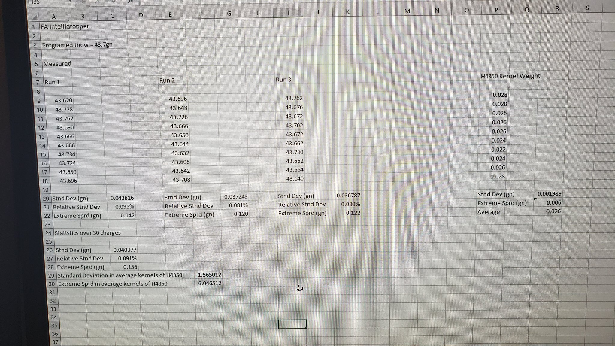

Some info I added to a guys post on facebook:
I just compared mine to a Sartorius 0.0001g scale. Long story short over 30 charges (set 43.7gn) the std dev was 0.04038 gn and the extreme spread was 0.156gn. Relative to the average weight of a kernel of H4350 this is a std dev of 1.56 kernels and extreme spread of 6.046 kernels
I was then asked to test with a flake powder so I retested using Titegroup @ 10.0gn
Statistics over 30 charges of Titegroup @ 10.0gn. Standard Deviation = 0.0358gn Relative Standard Deviation = 0.354% Extreme Spread = 0.132gn
