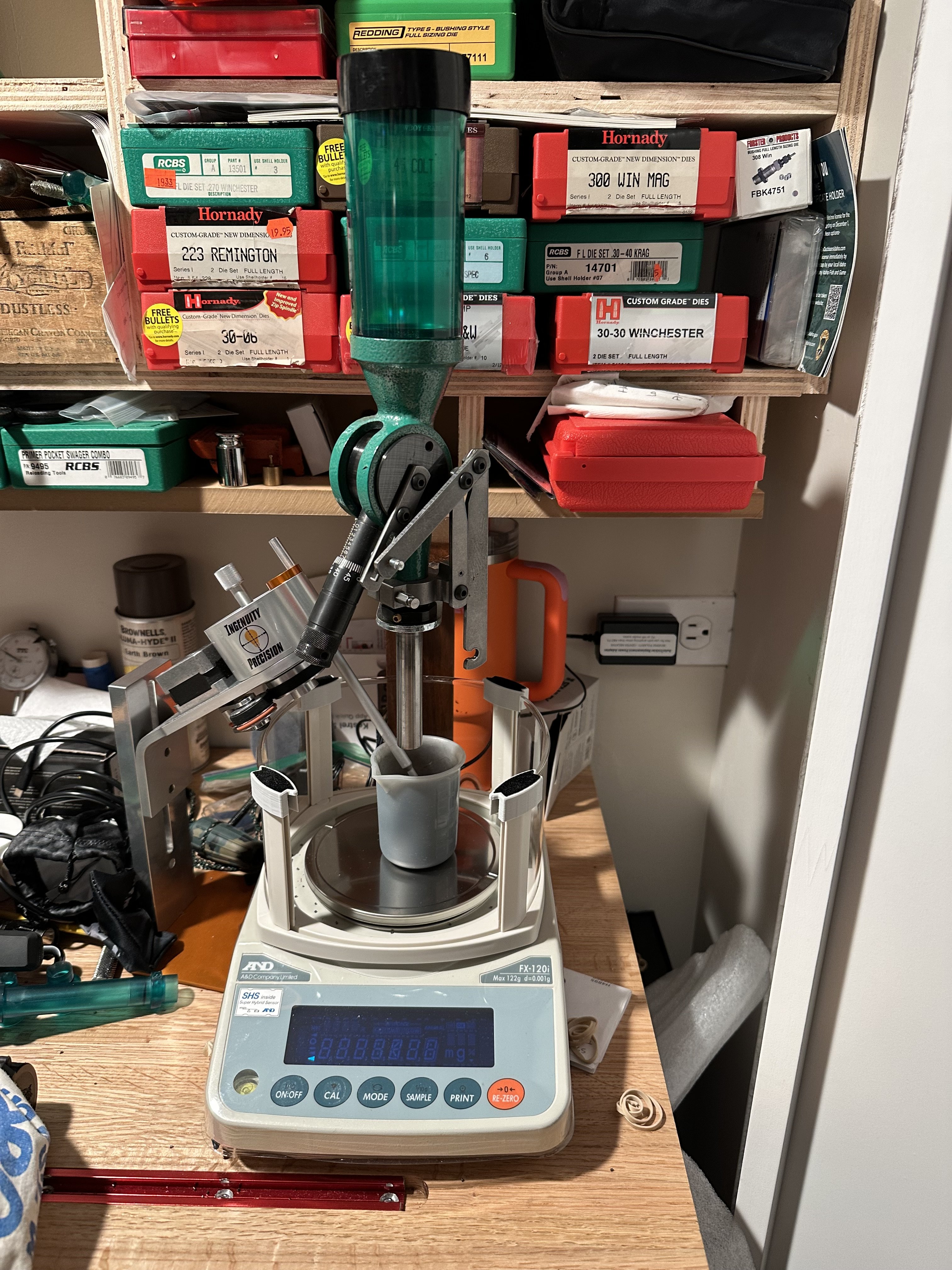

H1000 overthrows like a banshee for me
But it’s no match for H50BMG or n570. >25% overages completely unacceptable
With N570 I run the shims and tip with good luck. I usually leave the sliders in the middle but sometimes I bump them up and can run faster.
The emptying is kind of a learning curve but I rarely spill powder any more.
I don’t get any overages but I also let it take its time at the end and have it set so that it backs off the speed well before the set weight. I don’t mind this so much because I charge at the same time I seat a bullet so between lubing the bullet and pressing it I get a perfectly adequate cycle time.

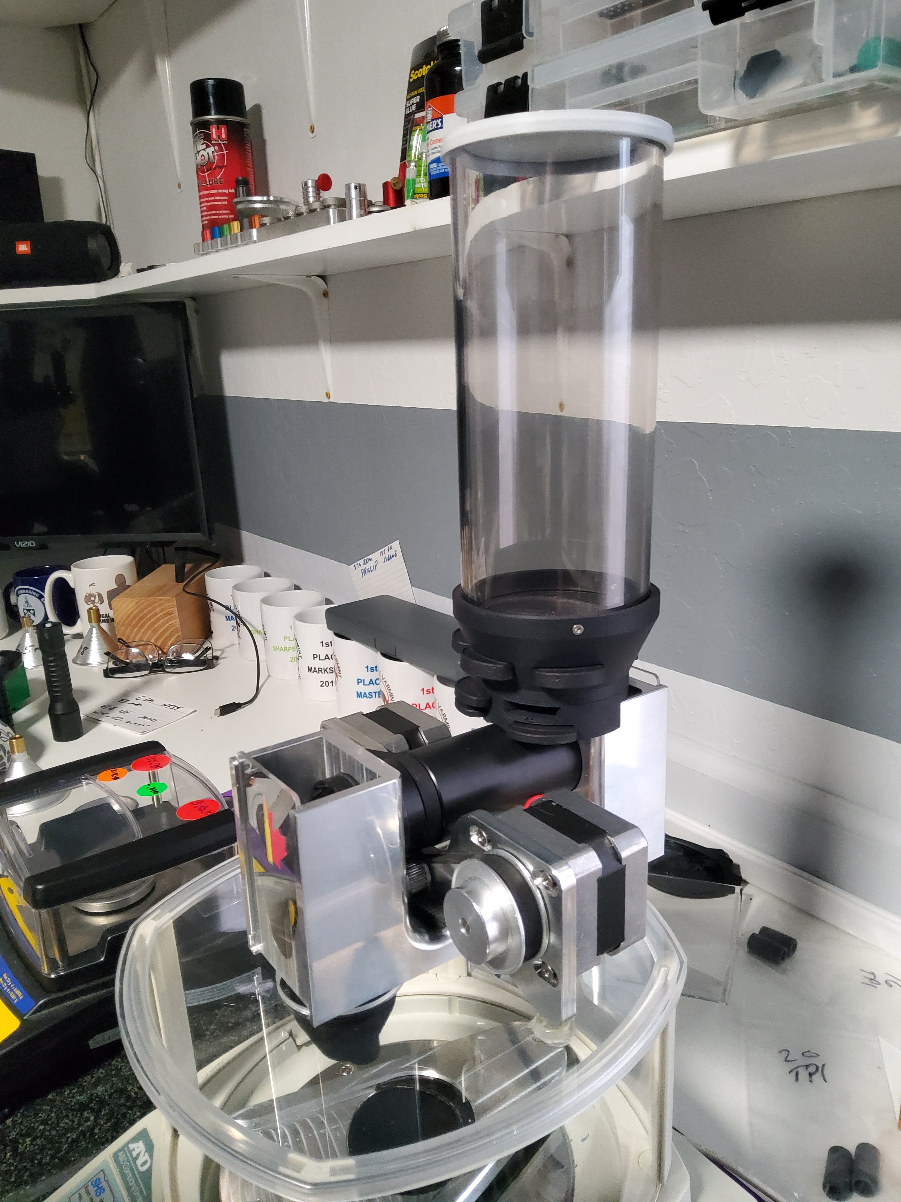

Idk if it's ever coming out lol but I can say tuning the v4 I loaded 180 rounds n568 87 grains took 1 hour 30 min to be done loading.

I'm trying to avoid disconnecting the wires. I'll figure it out. Thanks for the suggestions! This ATV4 is better than I gave it credit for the first time around. And I know MKM Tyler, he will hook me up.
There is no need to disconnect the wires, just like there is no need for shims/tips or other such nonsense... But that's just my opinion from using my V4 since 2022. .02 is generally one kernel of many powders and .04 is generally about 2, maybe 3 kernels. Well within my tolerance. A world more accurate than my Chargemaster 1500.
Reactions: secondofangle2
I'm sure it's possible to do it without removing the wires but seems like it would be more difficult.
one Kernel of N570 is .08gr, I think N560 is .04 so there's that.
It isn't really. I don't use the big bulky powders which is why I said many powders. Remove the hopper and place behind the rear window. Tip the V4 over the hopper and open the window. Give it a shake to empty the tubes and you are good to go. No need at all to disconnect the wire.
Reactions: Taylorbok
I'll try it next time. How ever disconnecting the wires is a non issue for me
