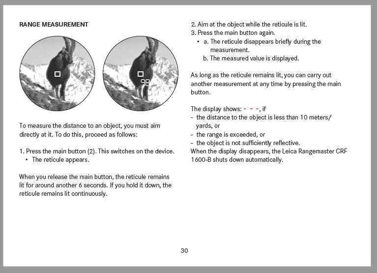

I don't have the manual with me now but I'm pretty sure it does mention the auto shutoff.
Well my reading comprehension may be failing but I read the damn thing over and over....
I've got my manual out in my car but if I remember correctly it says that it will automatically shutoff after a few seconds after taking a reading but I could be thinking of something else too.

Here is the page out of the manual for the Leica 1600B. See item #1 and last sentence on page (see page 44 of 2700-B manual),
