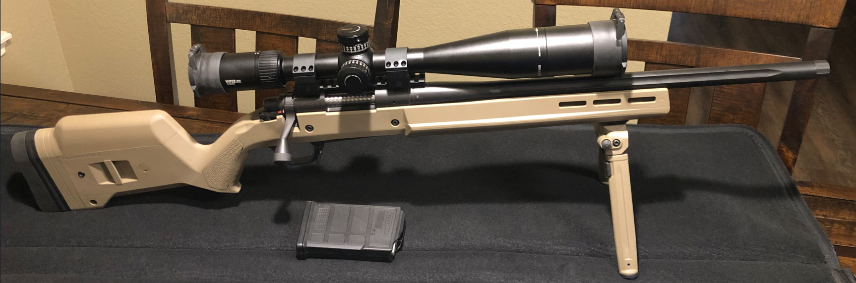

I have a new Remington 700 Magpul edition .308. Less than 100 rounds through it thus far - all on the range.
22" barrel, 1:10 twist rate
Vortex Viper PST II 5-25x 50mm Scope
ASR muzzle brake(not mounted when pic was taken), but no suppressor used this day.

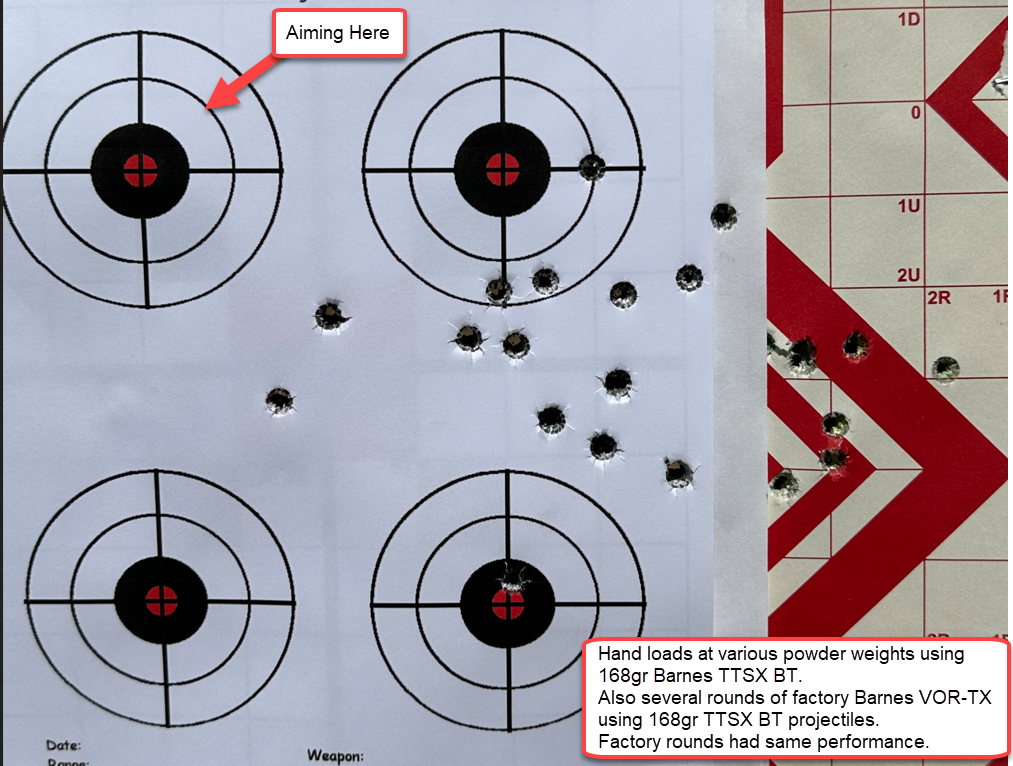

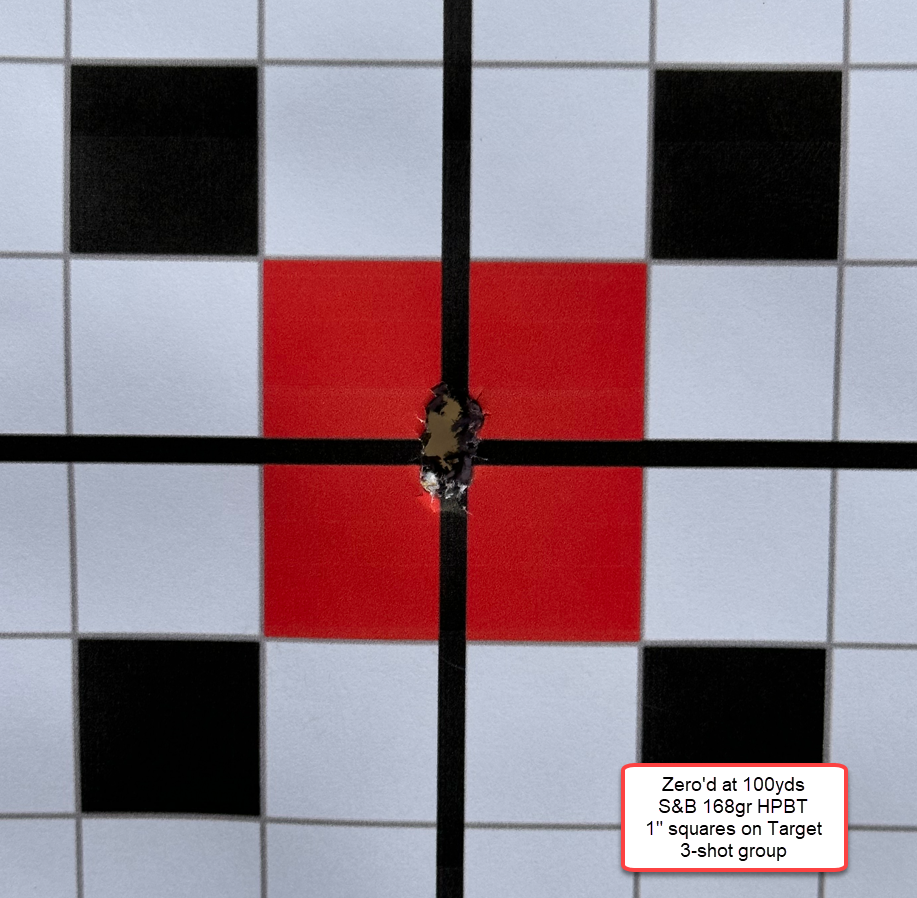

Went to the range, and proceeded with zeroing the scope. Was using factory S&B 168gr HPBT rounds for this. Everything was on point. You can see the final result of the zeroing. 3-shot group at 100yrds. So I was pretty happy with this.... then I switched over to test several small batches of some hand loads.
The hand loads use Barnes 168gr TTSX BT. The accuracy and precision was dreadfully bad, and after collecting the velocity data across several small batches, I just assumed that my hand loads were just garbage.
As such, I opened up a new factory box of Barnes VOR-TX 168gr TTSX BT. Put several rounds of that into this group and it performed just a poorly as my hand loads. Only commonality between the hand loads and the factory loads is the same projectile.

My guess would be something came loose. scope rail, scope rings, action from the chassis. Did the shots progressively walk from left to right? thats a pretty big spread.
Agreed... I did check all the screws/mounts, etc... nothing loose, no wiggles... even re-torqued to be safe...
No...the shots didn't progressively walk left to right... they were just all over the place... the shots did walk slightly upwards with each batch of the hand loads since the powder charge was increasing slightly with each set.
In hind sight, I should have used separate targets for each batch, but I was mainly interested in collecting the velocity data, and I just assumed the performance was due to that... I was a little shocked when the factory ammo did the same...

Some things to try:
0. Borrow a different stock with a bipod on it and swap the receiver/barrel scope into it and test.
1. Get a Harris bipod. Magpul bipods are bad. They are very unstable and will move when the recoil begins.
2. Make sure barrel is free floating
3. Make sure receiver is not moving in the stock. Make sure action screws are torqued right and stock mates up with recoil lugs.
4. Make sure pic rail and ring mount actually do not move.
5. See if scope is consistent.
6. Does the bolt move when you dry fire? Does it securely lock?
Some of these will require finding a buddy with a 308/scope to swap stuff to test. And/or get a laser boresight.
