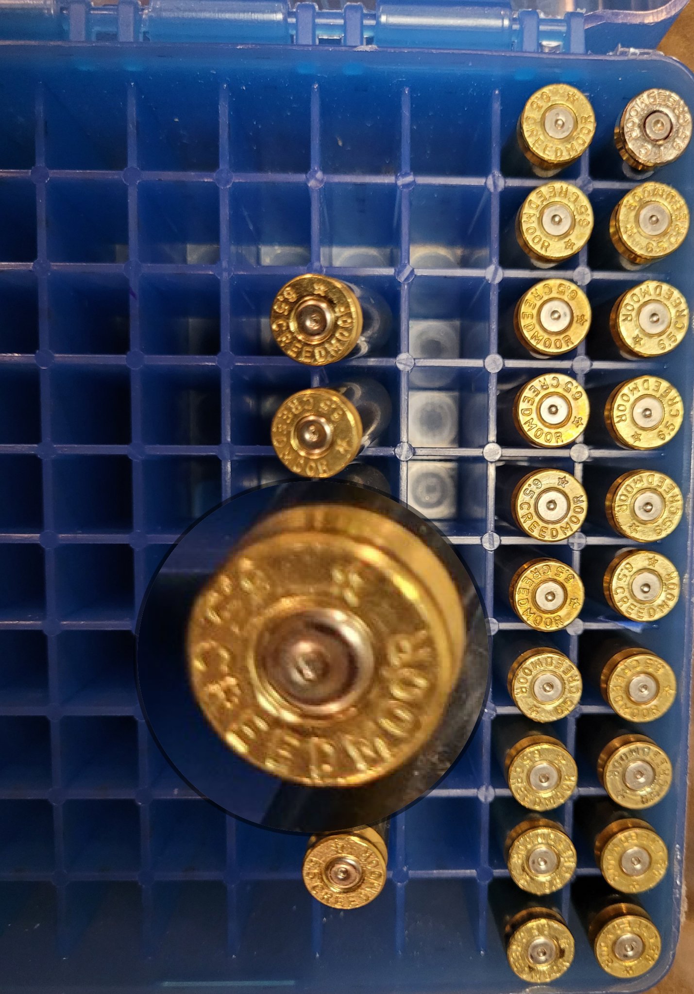

So, I just got back from @CR2 SS low light class (which was awesome, definitely would recommend, and I will definitely post about it in another thread), and I had a total of 6 primers out of right at 200 rounds that didn't go bang.
Main Question 1- I've never had a primer not go bang on hand loads, and only a handful of times with factory center fire loads over many many years. How is it that I had so many this time and how likely is it that this issue has infected my whole 1000 pack? Can I do anything about this going forward? Will manufacturer do anything?
Main Question 2- how risky is it for me to use an inertia puller to take the rounds apart and get my brass and maybe bullet back?
I have a really good firing pin mark on all of them, it's definitely not a light strike. These are not cheap primers or anything either (as if that even exists now days)
This is a bolt action if that matters in this situation. I can post pics of said rounds if need be also.

It’s far more likely that you just didn’t get them dried properly. You wet tumbled, and then some of them were found with moisture inside. Occam’s razor.
Drying your brass in the oven eliminates this issue. I set my oven to 225* (just over the 212* boiling point of water, but not remotely hot enough to damage brass) and leave them for an hour. Once the brass hits 225* there is no chance of water being in the cases any more.
The primers look like that because nothing ignited. They’re just dented from the firing pin. Whereas if they went off, then all of the pressure generated by the ignition would form them just like the other ones.
Wrong. Primer ignition does not cause the high peak pressure that a normal round sees, and does not form the primers to look like a normal round.
Instead, popping a primer with no powder (or wet powder) usually backs out the primer a bit and leaves a very rounded appearance, exactly as shown in the OP’s pics.

Not wrong. It happens in both scenarios. The next time you have a primer misfire look at it. It looks very similar to primers fired in subsonic loads. The reason that both look that way is because, like you said, they aren’t subjected to high peak pressures of an ignited full house round and aren’t explosively formed against the bolt face and firing pin hole etc.
But I digress. Sounds like he had wet powder.
Not wrong. It happens in both scenarios. The next time you have a primer misfire look at it. It looks very similar to primers fired in subsonic loads. The reason that both look that way is because, like you said, they aren’t subjected to high peak pressures of an ignited full house round and therefore are explosively formed against the bolt face and firing pin hole etc.
No, you’re still wrong, and now pretending you didn’t say what you said.
Primer misfires don’t look the same as a primer fired with no/bad powder. Look at them yourself. Fired primers without case pressure stand proud of the case head, misfires don’t and are usually just dented inward.

You can see it in post #11 before he figured out it was moisture, I was thinking the primers weren’t fully seated. You can see it is now sitting proud from the picture. Primer fired at least partially and pushed out. I’ve fired primers in empty cases just to compare and don’t remember them pushing out since there was nothing in the bore, but with a squib it makes perfect sense that the primer will push out to the extent of head space clearance.

I'm betting on wet powder, and made the mistake once when I started ultrasonic cleaning. I pulled the bullet and the powder came out a little bit clumpy.
The inside of the case looked dry but I think there was a droplet in the primer pocket. When I was checking my next batch of loads I saw the issue and have since changed the way I dry cases.

That's right. I knew as soon as I emptied the first cases the powder didn't look right and that it had to be moisture. I just don't know where it came from. I did have some cases that I cleaned in the ultrasonic, but these aren't them. These were wet tumbled and dried in a dehydrator, and then sat for another week before they got loaded. Had to be something splash , or my dog licked them, or kids juice, or kid put in mouth (this is more likely than you may think). I can't figure out how just 6 of them had this issue. It's about 230 rounds total that loaded in that 3 or 4 days and just this 6 rounds had issues. I won't ever know and it's bugs the crap out of me
You are oversizing your brass, the fact that the primers have backed out on the duds shows this, as does the severely flattened primers on the fired cases

There are a couple things that I changed since then. When rinsing the brass, I make sure I get ALL the soap/cleaning chemical off the brass. It takes much longer to dry if there is any soap left on the brass.
The other thing is to dry tumble in corncob media with polish after washing. This goes against the wet tumbling method of not having to deal with more media but it adds a bit of polish to the squeaky clean brass, and the media absorbs any moisture that could still be on the brass. I don't put the brass into the tumbler right away. The brass is shaken in a dry towel and left to set over night for some of the moisture to dissipate, then it goes into the dry tumbler.
