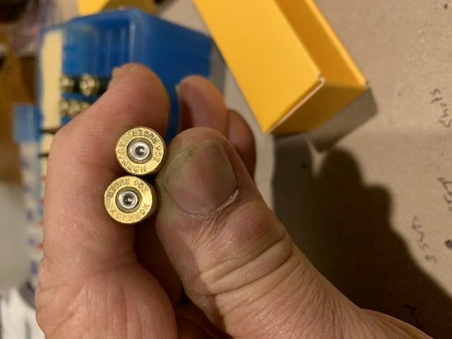

Any thoughts on these fail to fire? I didn’t think 2000 primers would be bad. firing pin strike seems very deep. Any issues with recals or bad CCI primers you know of?
This is my neighbors rifle but he has LOTS of experience reloading. (Like 50 years worth)
He said CCI BR primers bought in about 2000.
All fully seated. Primer pockets clean and flash hole deburred. The primers are old but were stored in air conditioned area, in the original packaging, and inside a vacuum sealed bag. These primers are part on a full unused 1000 box. First used out of that box.
I’m thinking more in brass prep phase than firing, like they got seated funky. Idk if those cases had crimped primers before but it sort of looks that way. Seating without removing the old crimp could have deformed the primers and the anvils aren’t seated correctly. Maybe his priming tool needs to be cleaned.
Many chemicals will kill a primer, w/ WD 40 being the worst. Those primers look to have been struck more than once. If the primer is not fully seated when struck the first time it will push them forward but not close the gap enough to have the hammer hit the anvil. If that happens most of the time it pushes the yellow cake out of the way an on a re-strick there is no yellow cake to go bang. To test take a hammer with the primer base up an with "proper precautions" hit the primer hard. If it goes bang then seating is the issue. If it does not an there is yellow cake in the cup it's been killed via a chemical in the storage or reloading A/O. Not all primer cup's are the same these days like long ago,...
Finger oils can kill primers. So if you flip them over in the tray by hand... That can cause it. Improper storage can cause it. I've had that same thing happened with Federal 210m, br-2. Best I can tell, my fault.
Without more info, I’d be rechecking the following two items:
  • Primer seating - either a pocket issue like a crimp not removed or seating depth
  • Bad headspacing - it’s been shown as an issue any number of times after re-investigating a primer no fire. Even by seasoned reloaders.
