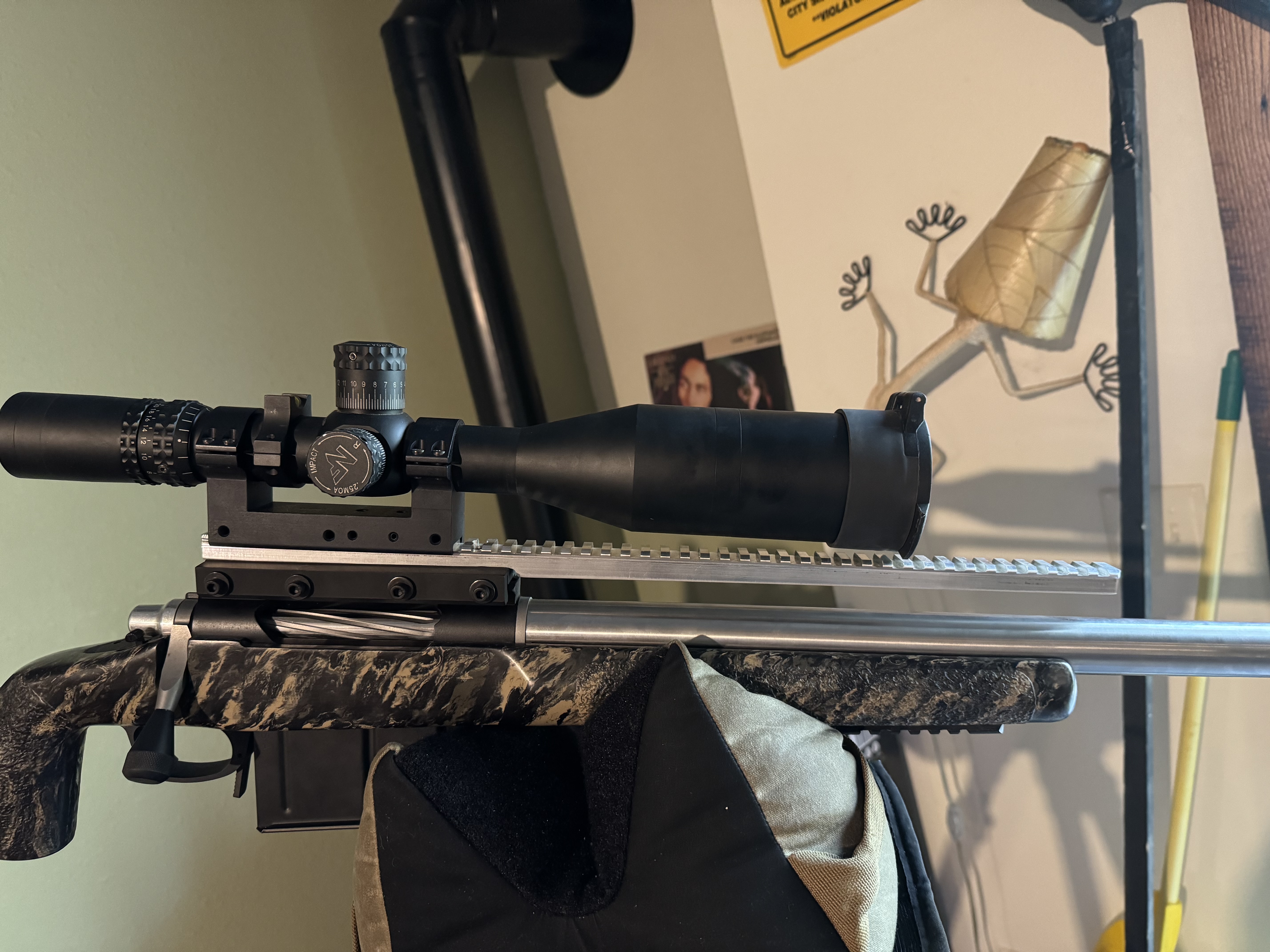

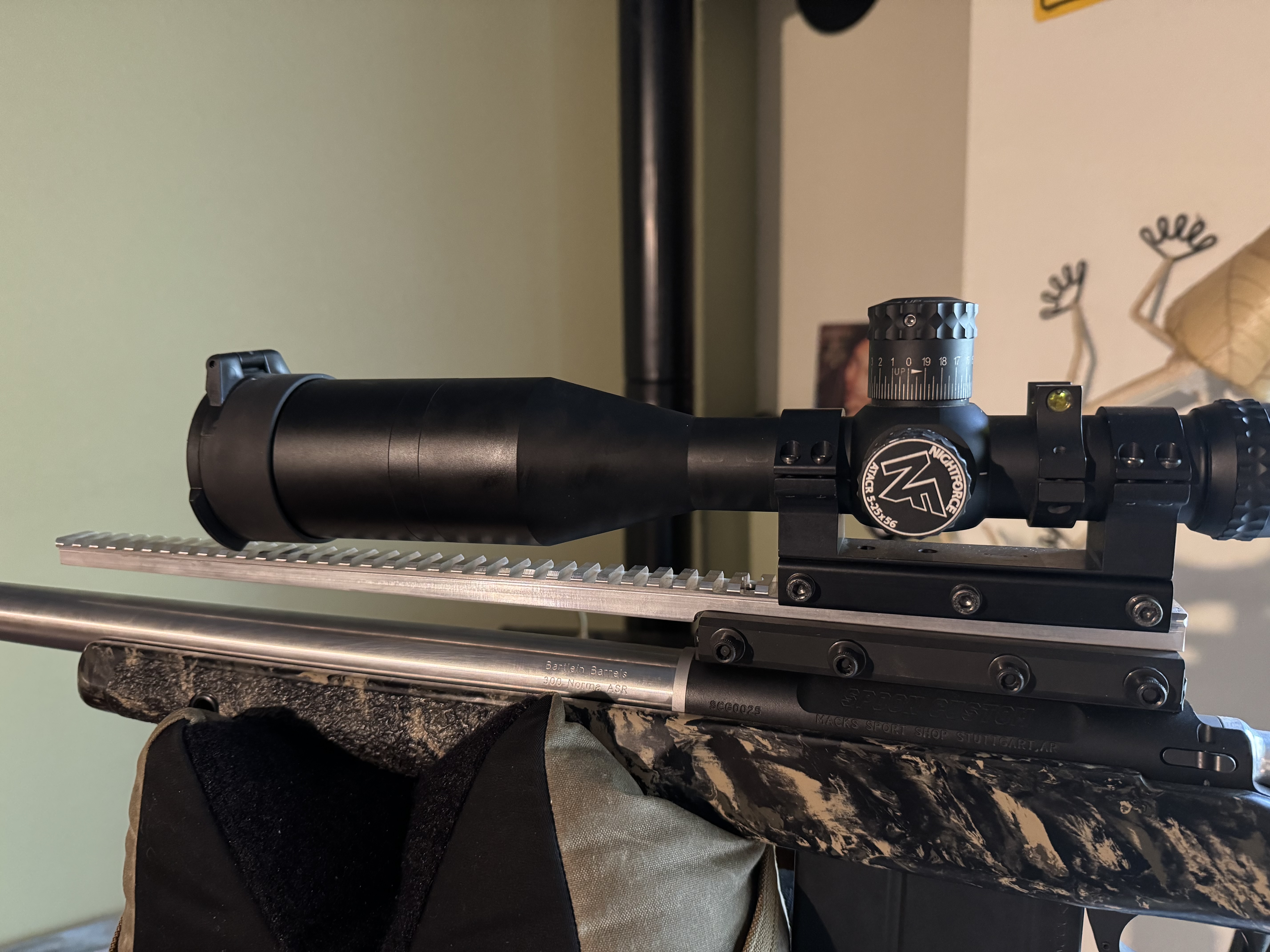

All of the forward rails and extended rails I've seen for wedge prisms, etc have been custom or special order. Does anyone have an off-the-shelf embedded front rail that works with ELR barrel diameters? Is there a clamp-on picatinny rail that's rigid enough to mount to my existing scope rail?
I have a Terminus Titan in a McMillan A6-7 Supermag. The barrel is about 1.4" where an EFR would go.
I have a line on an extended scope rail that mounts to the action. Trying to see all of the options before I choose.
