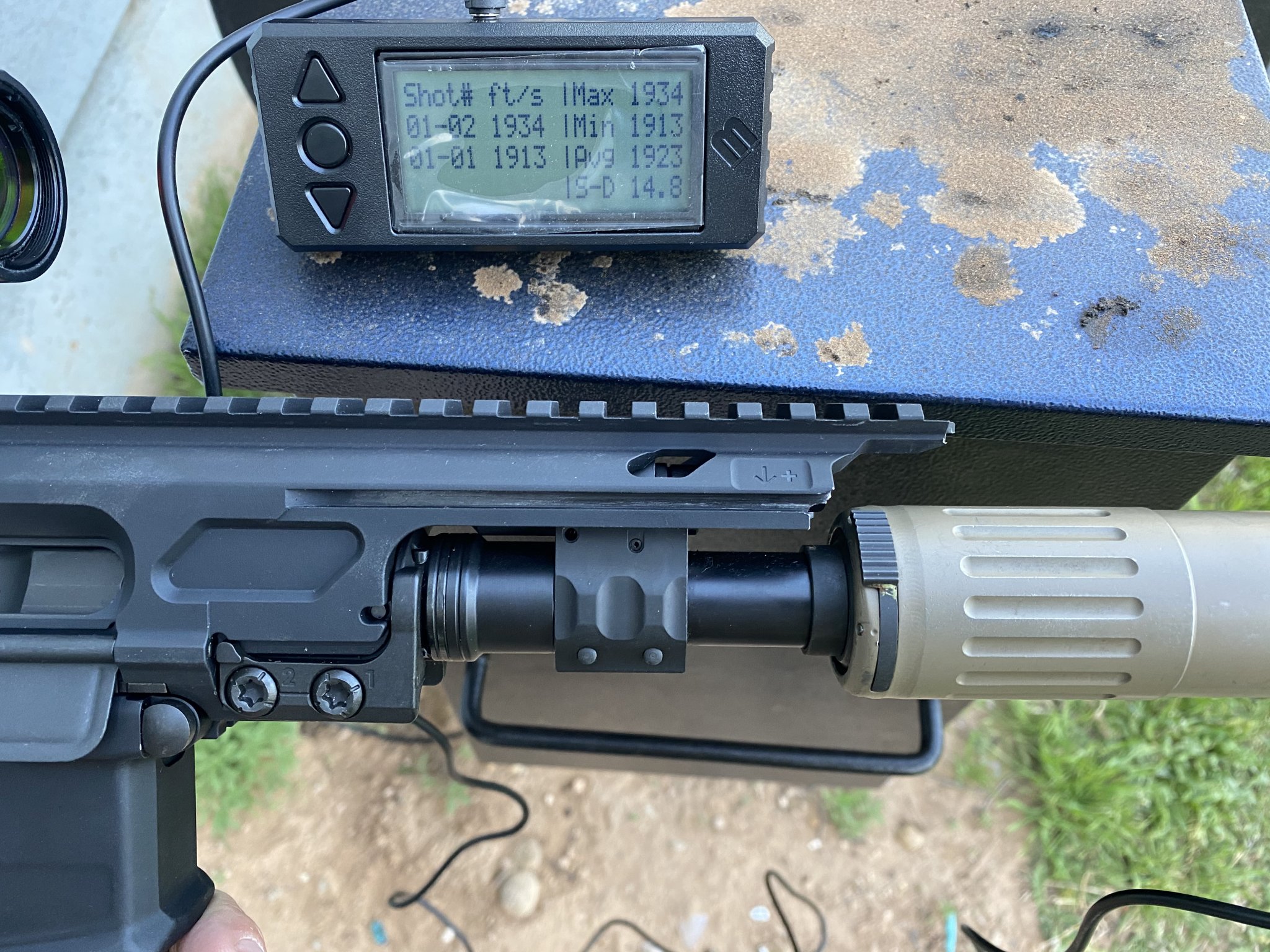

    Ok...so I took both my 300 Blk. guns to the range with my Magnetospeed to get MV for the two supersonic rounds I load in addition to two factory loads.
    The first gun is a DI SBR with a 10.5" barrel. It has a 1:8 twist barrel and was suppressed with an OSS 7.62Ti flow through suppressor. Second is the Sig Spear LT with a 9", 1:5 twist barrel. I did five rounds of each except for the Speer TNT's as I forgot to load 10 in the mag and only had five with me.
    10.5" Barrel MV Results (avg, suppressed)
    -Hornady 110gr. V-Max: 2259fps
    -Speer 125gr. TNT: 2071fps
    -Fiocchi 125gr. SST (Hornady): 2045fps
    -Barnes 110gr. Tac-TX-FB: 2261fps
    Sig 9" Barrel MV Results (avg, unsuppressed)
    -Hornady 110gr. V-Max: 2132fps
    -Speer 125gr. TNT: N/A
    -Fiocchi 125gr. SST (Hornady): 1950fps
    -Barnes 110gr. Tac-TX-FB: 2143fps
    The 10.5" barrel is nicely broken in and is a 416R stainless nitrided barrel. The suppressor adds a bit of velocity. This was the first time firing the Sig so as that barrel breaks in, it'll pick up a bit of speed. Being a pistol, it had no stock. It was surprisingly easy to shoot but having left the suppressor off, it was LOUD as my suppressor mount is a muzzle brake. It was loud enough to piss myself off.
    None of the bullets fragmented but I was only shooting 25 yards for testing purposes. My V-Max hand load is likely too hot for the Sig. It'd be fine shooting on a bench where the firing rate is fairly low but I wouldn't run drills or a class with them. The 125 grain Speer TNT load is borderline. The Fiocchi factory rounds will work and the Barnes will be just fine.
    I've already started to develop a load using the Hornady 110gr. CX monolithic bullets. I started to get pressure signs at 20 grains of H110 in the 10.5" barreled DI rifle. 19.8 grains produced an MV average of 2310fps. Best accuracy was at 19.6 grains with an SD 0f 4.3 and avg. MV of 2293fps. I've always struggled a bit with monolithic bullet hand loads vs. jacketed bullets.
    I inquired with Hornady on the 190 grain Sub-X and they stated it can handle up to 280,000 rpm and said it should be just fine out of the Sig at subsonic velocities. I've had no luck getting these to cycle problem-free in any gas gun so it may be a moot point.
    Lehigh says their 194 grain sub will do great. Haven't heard anything from Maker's yet.
    Have a few projectiles in hand, still waiting on the Barnes 120 grain bullets to arrive. But here's a visual comparison between the Hornady CX and the Barnes, both 110gr. Going by the cannelure, the Hornady should fill the case a bit more. Both are beveled which'll make seating them easier. Interesting to see the differences between them.

    What velocity are you getting with either round? That matters more than the number of bullets down the barrel because you could be within rpm limits of those particular bullets, especially on the Rattler with it's ultra-short barrel and lower velocity numbers.
    I've run a few hundred of the Speer 110gr. and the 110gr. Hornady VMAX (they don't make a 110 grain Amax) and so far no issues either. Still, if you ask Hornady or Speer what the max recommended rpm is, they'll tell you it's lower than what I'm seeing with my loads. Maybe there's a margin of error. Dunno. But even Bartlein has said I'm exceeding the safety margin of jacketed bullets.
    And that's why. You're on the cusp but on the safe side of the 280,000 rpm "limit". 1923x720/5=276,912 rpm. My 110gr VMAX round is a good bit faster (2100+) and my Speer round is just under 2000fps @ 70F which is why I am a bit more at ease using them. Now on a hot 105 degree Texas day? Dunno...
    The shorter Rattler barrel is keeping your FPS down to a safe level.
