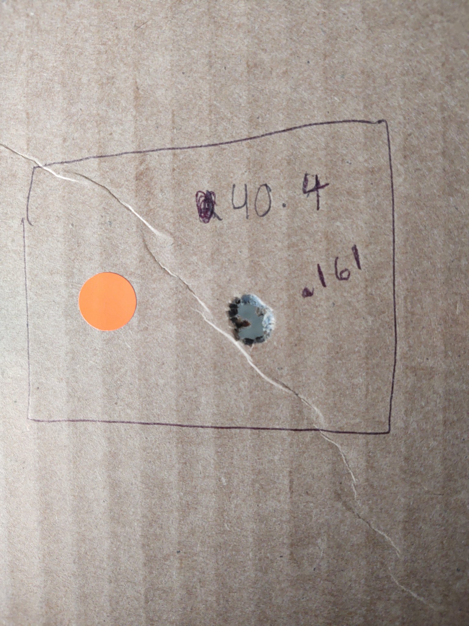

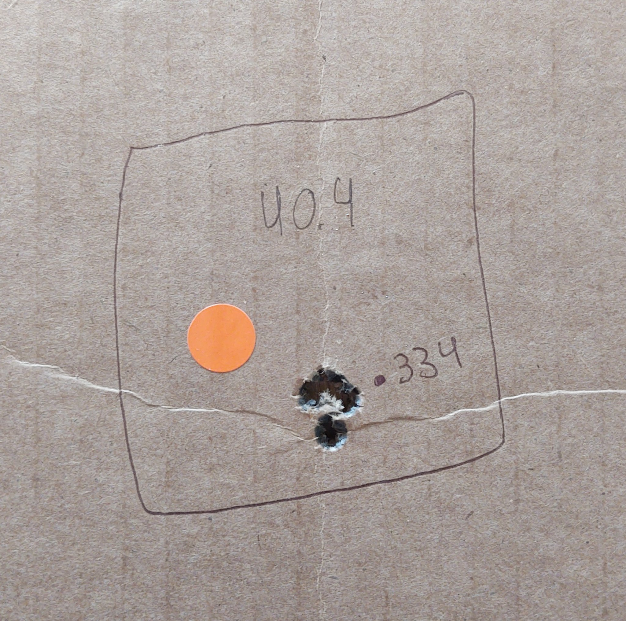

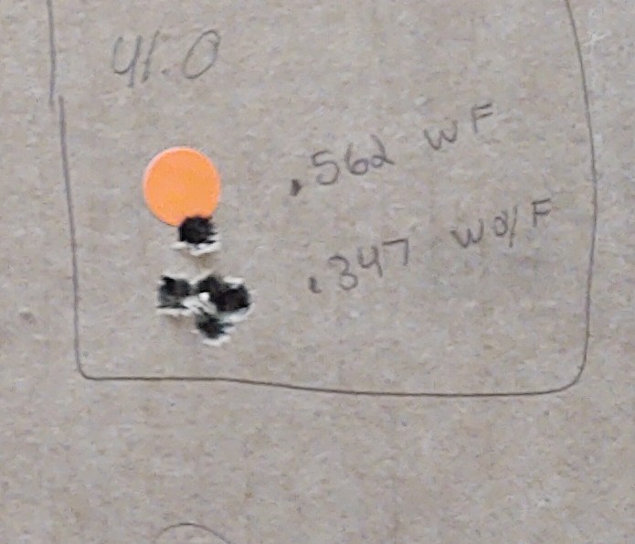

The 24" PRCF with the load of 41.0grs of H4350 is right there at the edge of showing pressure signs.
And the 22" Bartlein with 40.4grd is a relatively light load, I did shoot 41.0grs in it but it didn't group as well as 40.4 so I didn't chronograph it but I'd be willing to bet it would be the same as the 24" PFCF if not faster, the PRCF barrel is the slowest 6.5CM barrel I've ever had.
So to answer your question, no there is no real advantage I can see at this point to run the 24". However I just ordered a 24" Bartlein 6.5CM to test that very question, apples to apples using Bartlein blanks from Paul at Compass lake instead of comparing PRCF to Bartlein's.
Here are the groups from my SP10 with the 22" Bartlein, the two groups are pretty close so I'll more than likely run it again and check the data to make sure.
View attachment 8088472View attachment 8088473
The 40.4 load in my 18" Bartlein in the OBR was a clear winner and I don't see any reason to test any further.
Remind me in a month to update my findings, the new 24" Bartlein will be in my brand new JP LRI-20, I have exceptionally high hopes for this build.
