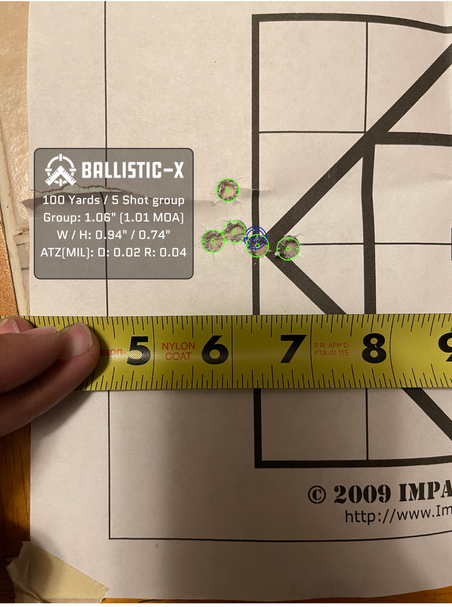

This is with out the can. 7 shots. I yanked the right one so I excluded it. not great but decent and consistent POI

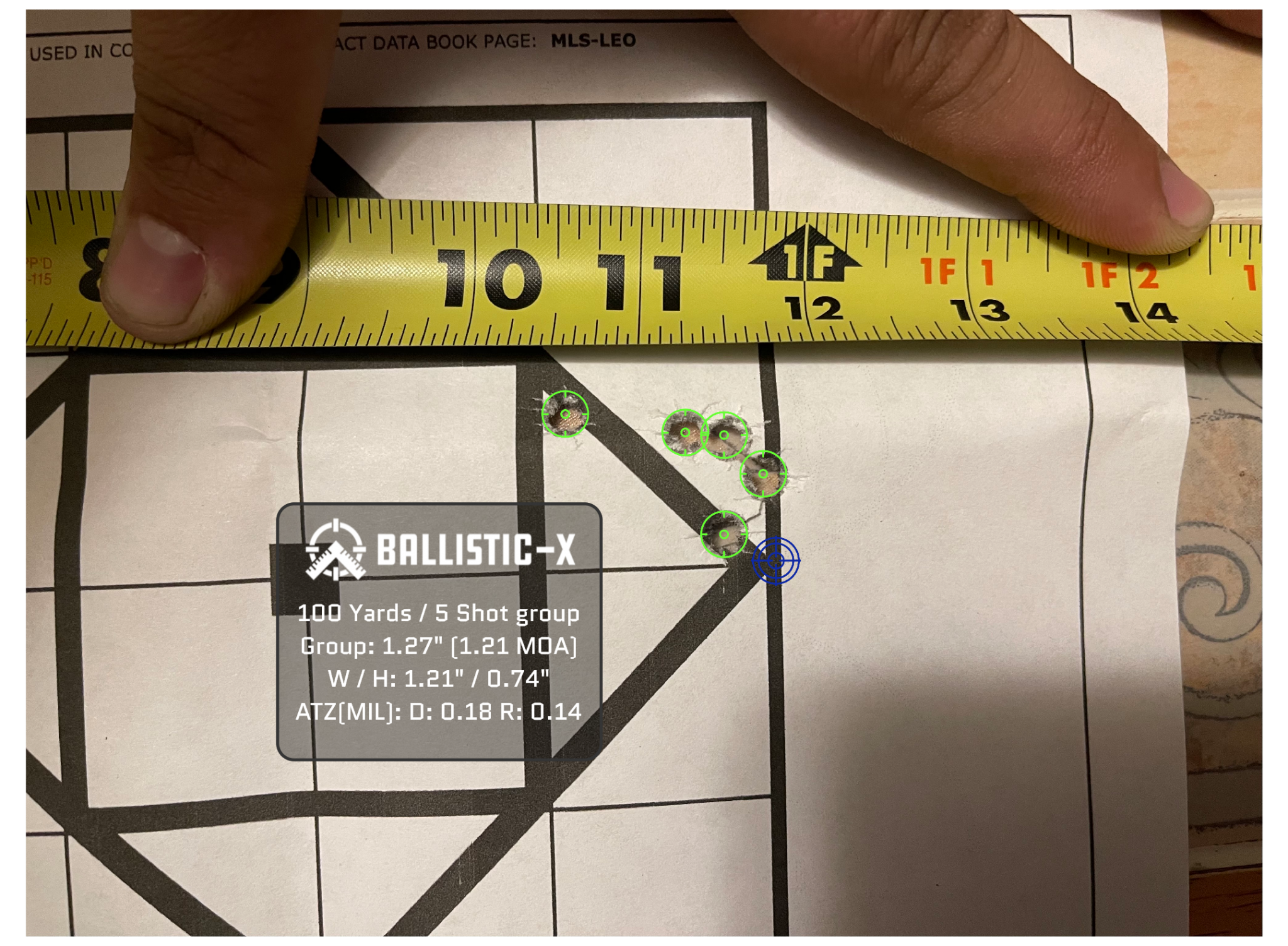

With the can. Terrible horizontal stringing and zero consistency. While it’s MOA it’s embarrassing. All of these were shot the same night after cleaning the chamber per my smiths recommendation with 3 foulers / sighters and then the braked group and then the two suppressed groups. Everything was tight and good. Shot with FGMM 168GR SMK’s. Got a response Monday, emailed them back, and haven’t heard from them again.
