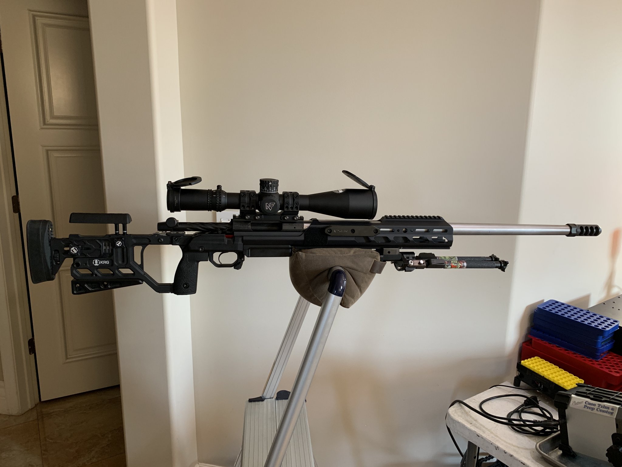

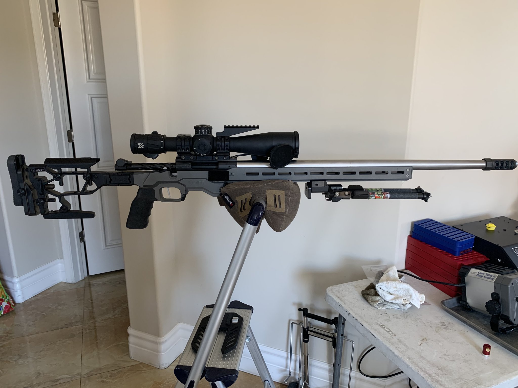

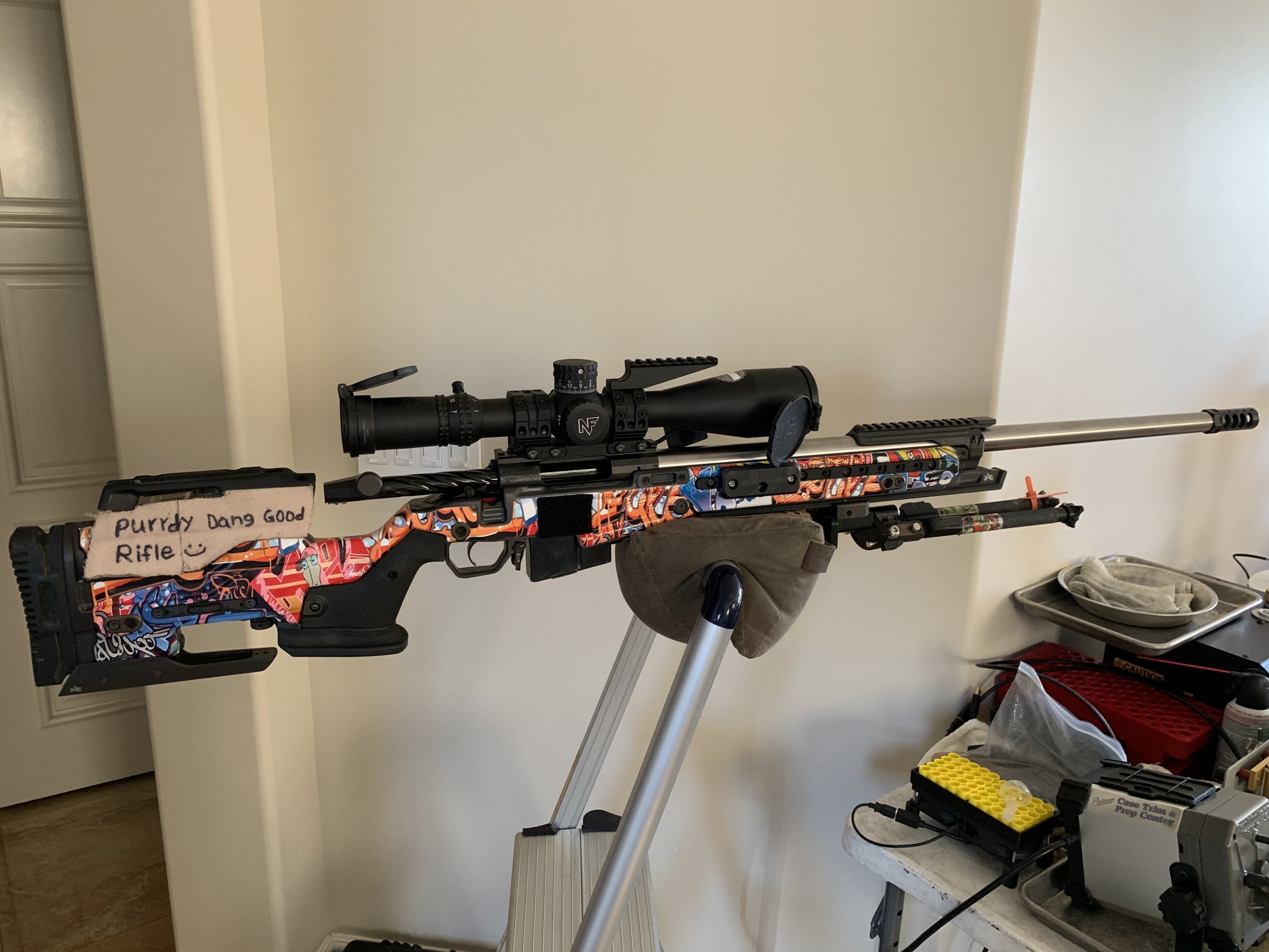

@Covertnoob5 can you elaborate a little more on finding and using the rifle balance point? Is it making sure the bag is under that balance point when position?
Thanks to Hide members who have responded so far.
Something like below in the pics is a well balanced rifle.
It’ll be much easier to maintain a stable position if you aren’t fighting the balance of the rifle.
All my rifle configurations will sit like that all day with no issues.
eta: the rifle should self balance just in front of the magwell.
View attachment 7333962View attachment 7333963View attachment 7333965
Thanks for those pictures. Makes a lot of sense now.
