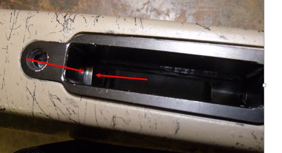

So I purchased a PTG rem 700 bdl "drop in" DBM with a 5 round AI mag thinking this will work for all i want to do but man was i wrong( running a short action 700 remage build 6XC manners T4). First off drop in required minor fitting in my manners stock, no big deal, then my very first try to chamber a round it got jammed on the feed ramp, this is where it all started to go down hill. Why did it get jammed? Well that became evident when i notice the system sat considerably lower in relation to the feed ramp than the internal box does, well this caused the bullets (105 berger hybrid) to hit on the lower 1/3rd of the ramp and just wouldnt slide up. Easy enough notch down the front of the magazine and it allowed it to tilt up just enough to feed 50% of the time single loaded. Then i noticed that the magazine sits under the feed ramp so every time a round is stripped off the top the round below tries to follow and ends up going under the bottom of the feed ramp (location as seen in the image). At this point it just is not meant to be ( towel thrown in). Giving it another chance i thought maybe because its in manners stock it may actually have the bottom metal slightly farther away from the bottom of the action (call me stupid but i was not ruling out anything), but wrong again as i found out the bottom metal was actually touching the bottom of the receiver. Needless to say i am less than impressed. I thought well maybe it just isint meant for a 6xc so i thought i would just see if my 308 rounds would function, i know there obviously not going to chamber but with the twist of a new barrel this would be a 308 so i wanted to just see if it was partially the cartridge fault, nope wrong again the 308 didnt fair any better, neither did the 243. Sorry to say but my experience was less than stellar, enough to never ever touch a ptg again.....just my opinion..............end rant......
Many people take a dremel (or use a mill if they have one) to remove that exposed section of the feed ramp scallop or put a notch in it. It's not needed for a DBM assembly.

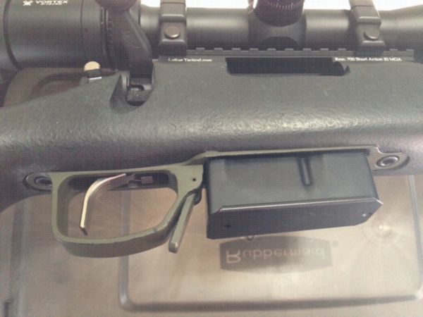

STI, does the mag sit at the proper location (high enough to feed properly) if the mag is held upward against the action? If so, PTG may be able to provide a longer retaining lever that seats mag higher in DBM.

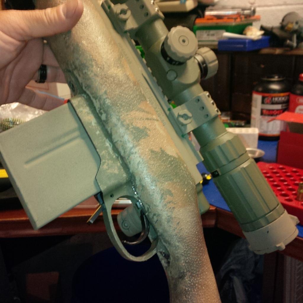

I purchased a CDI two weeks ago and ran into same issue on my Manners T4A. Mine would feed normally if I pushed/held mag upward into receiver while cycling bolt. CDI sent a longer mag catch lever and I am sure it would have worked BUT, I decided I didn't want to wait so I used a dremel with milling guide (like a router guide) and simply removed about a 1/16 of depth in the bottom inlet. Meaning I shaved the pillars and stock material so that DBI would in higher in relation to receiver. This solved my issue and no need for longer catch lever.
First thing to do is bolt the bottom metal up to the receiver with the pillars and make sure it feeds. If it doesn't than this is the time to make changes to the pillar length to insure the mag is at the right height. Almost all the mag systems will fail if the height is wrong and since the stocks vary so much in thickness its almost impossible to make a drop in setup. I've installed quite a few of the bottom metal which use AI double stack single feed type mags. All have worked very well and first time out because the pillars were checked prior to installing. I've done these for a number of oddball cals that have a reputation for troublesome feeding in the stock internal rem magazine. I suppose the key is not thinking you've got a drop in setup and insuring that it fits right rather than just bolting up.

No the mag did not sit high enough to feed reliably. I know i could have adjusted the inletting/lever arm and probably got it to work, but no matter what as it sit i would have an issue with the bullet tip going under the feed ramp. I am not about to remove part of the ramp as this just seems stupid to me, but i could possibly have machined a spacer to sit in the front of the mag and not allowed them to move forward. Maybe i expected to much but it gets back to the point of the product title "drop in". I understand there will be minor fitting and if there are as many variances with stocks as there probably is then the manufacture should know to label them as "possibly a drop in fit but doubtful PTG bottom metal". To me it seems a little odd to assume your product you are buying is incorrect and not as described and then still desire to purchase that product. My Opinion.
DID you ever get yours to feed. i got one that wont feed. also not high enough. looks like most of your help is trying to diagnose a m5 instead of the bolt in bdl. did your bolt in bdl come with pillars
No mine did not come with pillars. I never put the time and effort into getting it to work. Mainly due to the fact that it was marketed and sold as drop in, so when i was going to have to machine the stock and action, it wasnt worth it to me.

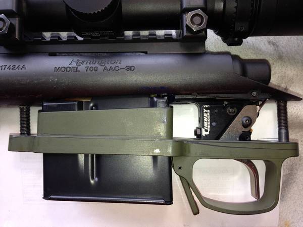

Front dimension: .725 from saddle of action inlet to bottom of floor metal inlet.
Rear: 1.075
When correct the rim of the case will overlap the swept arc of the bolt face by about .1. This gives you the ability to strip a case off the maglips without the case rim slipping under the bolt and jamming up at the web.
bullets will wiggle up the feedramp and itll just work.
.725/1.075. Those are the magic numbers. If your using a ptg stealth setup for ai mags ina M700 short this is all ypu have to do. SOMETIMES the m700s cause the rear of the magazine to hang up in the rear of the receiver. The center portion boss will catch. Its an intermittent issue. Some do, most dont. Milling the action needs to happen here.
an AI 308 mag has a workable cartridge length of around 2.900. Your COAL needs to not exceed this. Ive only had to relieve the feedramp when fitting for the AW mags. Receiver work on the sides of the mag mortises needs to happen too.
