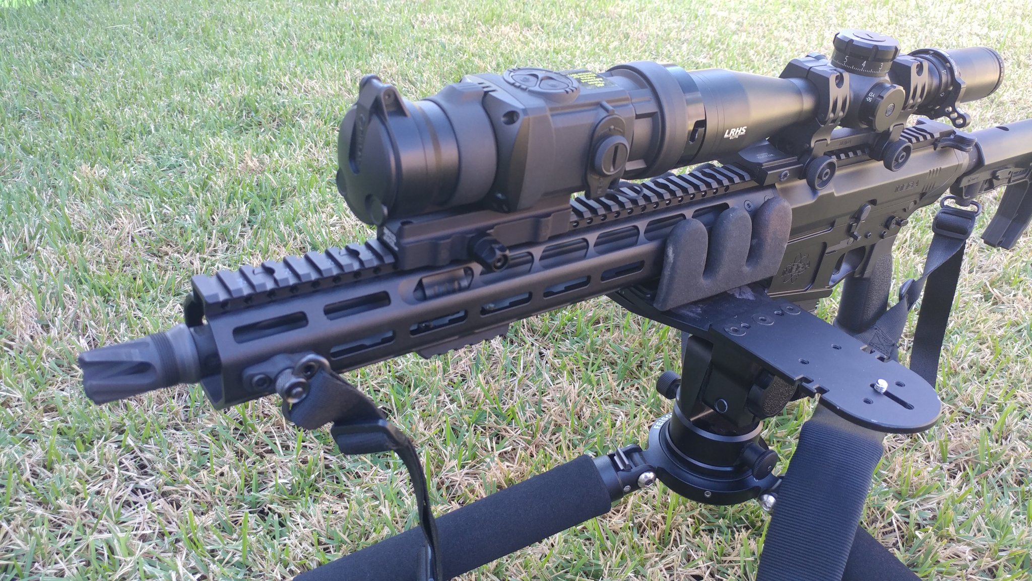

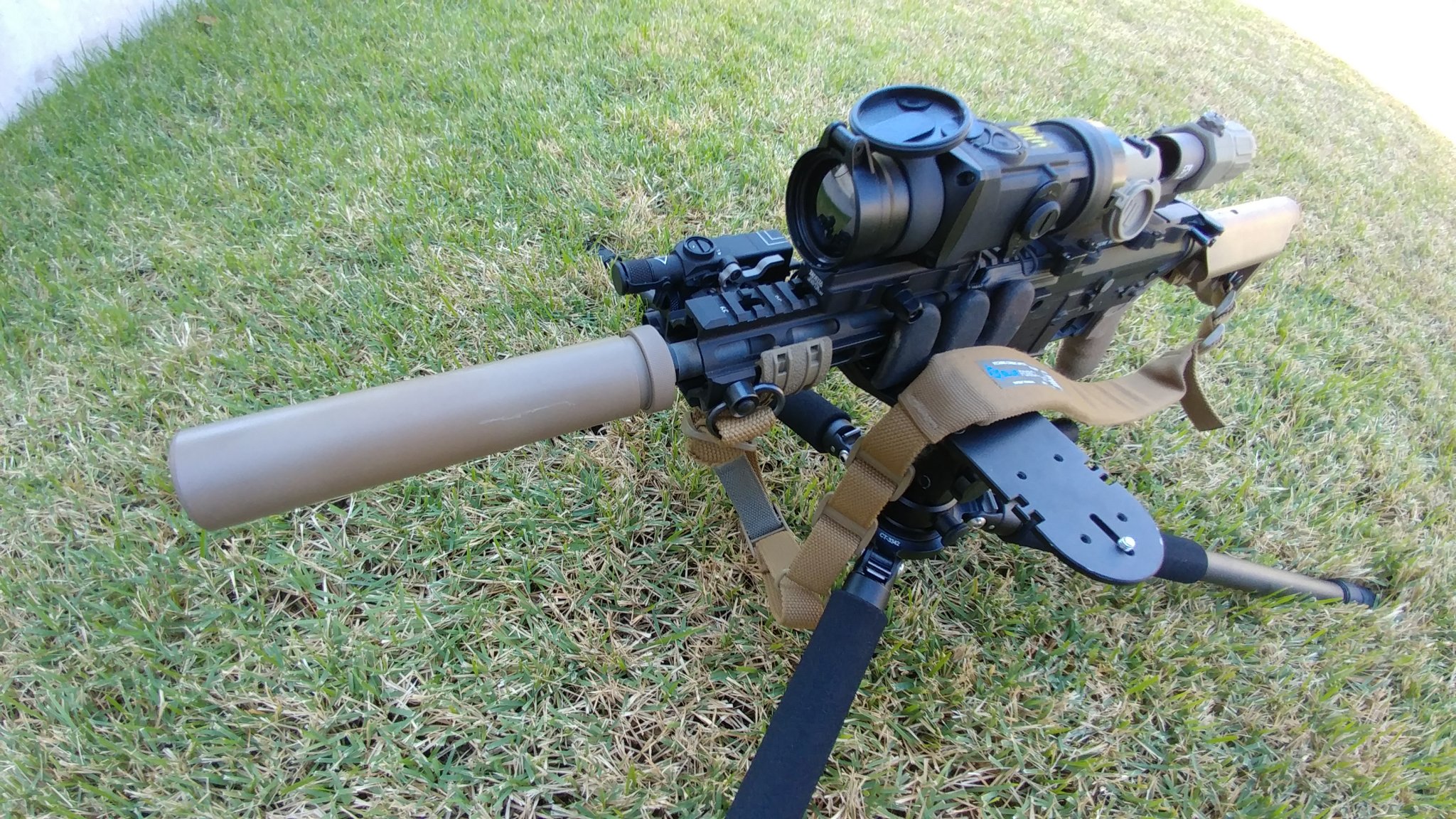

Have a couple nighttime items I am wondering if there are picatinny mounts for. Wasn't sure if this should go here or accessories, so someone can kick it over if it should have been there.
Pulsar fxq50. I know it's meant to attach to the scope, but is there a way to use the threaded holes in bottom to attach to pic rail?
Any of the pulsar mounts will work. Dloc is the best. Only trouble is you have to re cal display for shift since these are not meant for rail. and height above rail is 1.75. I use this setup all the time
You could do it that way. I only use it on one rifle right now and it is very repeatable. It is not a collimated optic due to the end of objective adapters it was designed to work with. Keeps cost down. Even with 1.6 inch rings it is very usable. The gun I use it on has a steiner 1-4 and it works extremely well at 4x.

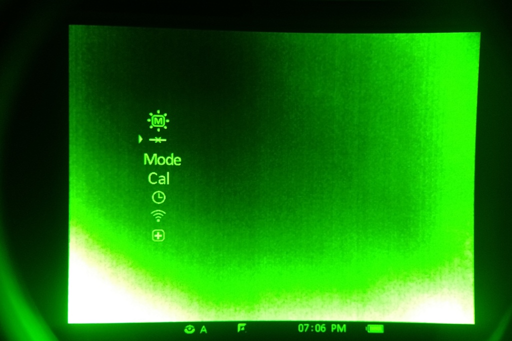

The menu that shows up on my unit has more options than the manual says it should I believe... And I believe this extra option is actually my display calibration... a cross comes up on the screen and allows me to move it around... BUT when I go into it I get the option to set to set Y axis but I can not change it to move the X axis... Nor does it seem to be doing much of anything by moving the Y axis up and down...
Forgive my attempts at taking cell phone pics through the thermal...
Here is everything on my menu, note the arrow is to the left of the icon I don't see explained in my manual
This is the mode that is opened by that menu option, for those of you with these units is this what your display calibration mode looks like?
I can still only adjust y axis here, no button on the unit will let me accept it or switch to x axis... It's just a cross I can move up or down

I just figured out why I couldn't pull up the display calibration. I needed to work the connection back and forth a couple times for the little magnet to realize it was attached to the scope. No problem since then, maybe I didn't have it completely in place.... Anyway, on and off three times now and it can tell the difference each time. So good to go for trying the rail mount. You'll have my order in for one a few min from now

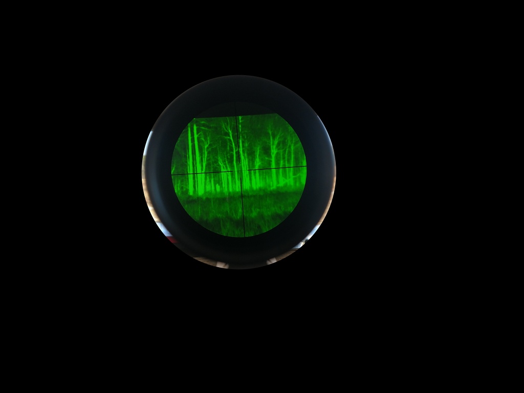

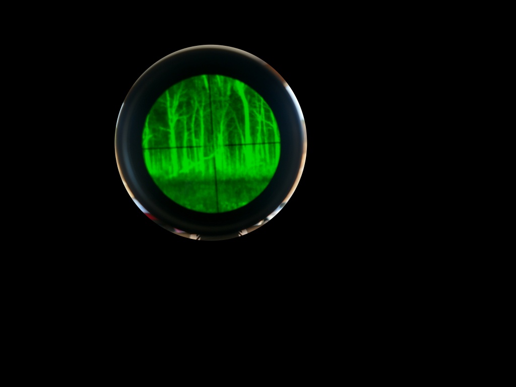

Here is my best attempt at explaining why I think you want the lower magnification so you can get the entire display in your scope on low magnification.
Let me take a minute to say, these pics are by a redneck with a cellphone looking through a scope and in no way show what you will actually see looking into a unit. So please keep in mind this is for FOV purposes only
Attached to a Burris xtr2 2-10 with a 52' fov on 2x
2x you can see everything in menu and the entire fov of the thermal

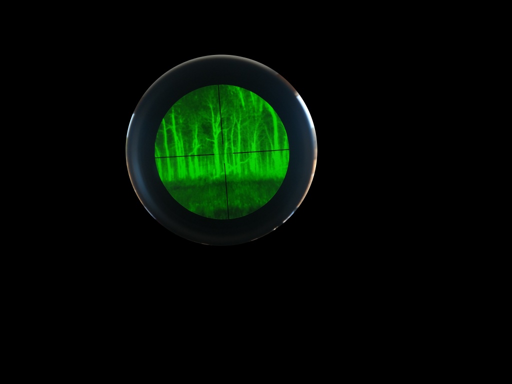

3x I can't see a couple of the informational symbols like my battery life, but still most of the fov for animals

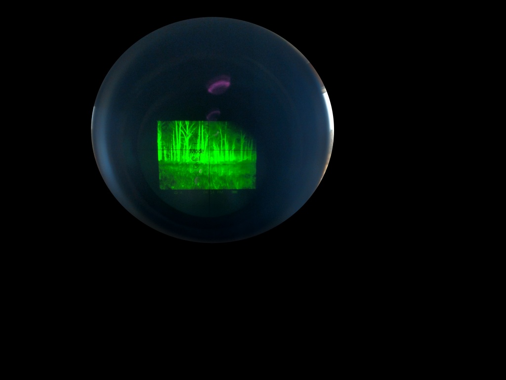

4x at this point I can only see to shoot and use the display calibration basically
5x
6x
