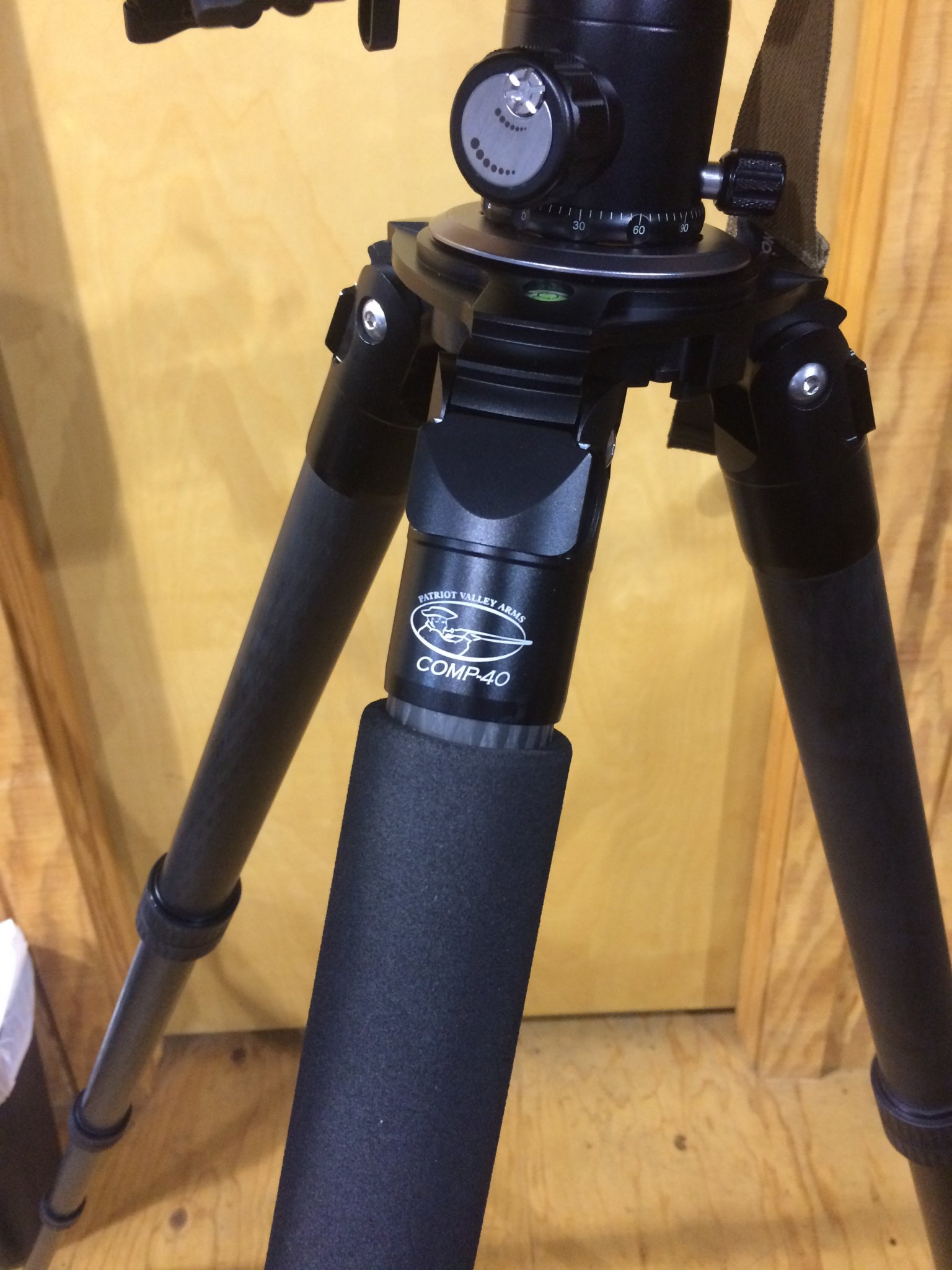

Josh at PVA sent me one of the pre-production samples of the comp-40. The first I did was extend the tripod all the way (this puts the pva ball head just over 66" above the ground) and put my full body weight on it. I knew the carbon legs would hold my weight (185 lbs), I wanted to test the clamps on the leg sections. The clamps all held and I was surprised there was very little flex in the system.
I tossed a bolt gun onto the head and started doing a little dry fire practice. There is a hillside behind my house that is 450 yards. Standing behind the tripod/rifle combo my wobble zone was about 0.5moa. The ball head feels smooth and locks up tight. The only thing I don't like about the head is the tension knob is a little low, I plan on having a buddy make me a kydex throw lever for it. From tight to light tension is just under half a turn so a throw lever will be perfect.
Overall this thing is super solid and for the price it feels like a steal. If down the road I end up not liking the ball head I can easily put a RRS anvil-30 on it and have a kick ass tripod setup for about $850. I think you'll be hard pressed to find a better tripod/head combo for $630. The only downside is it is a little heavy at 7 lbs with the ball head.
I plan on taking it to the range a couple times in the next 2 weeks. After doing a couple dry fire sessions with it I'm confident that if I miss standing behind the tripod its me, not the tripod.

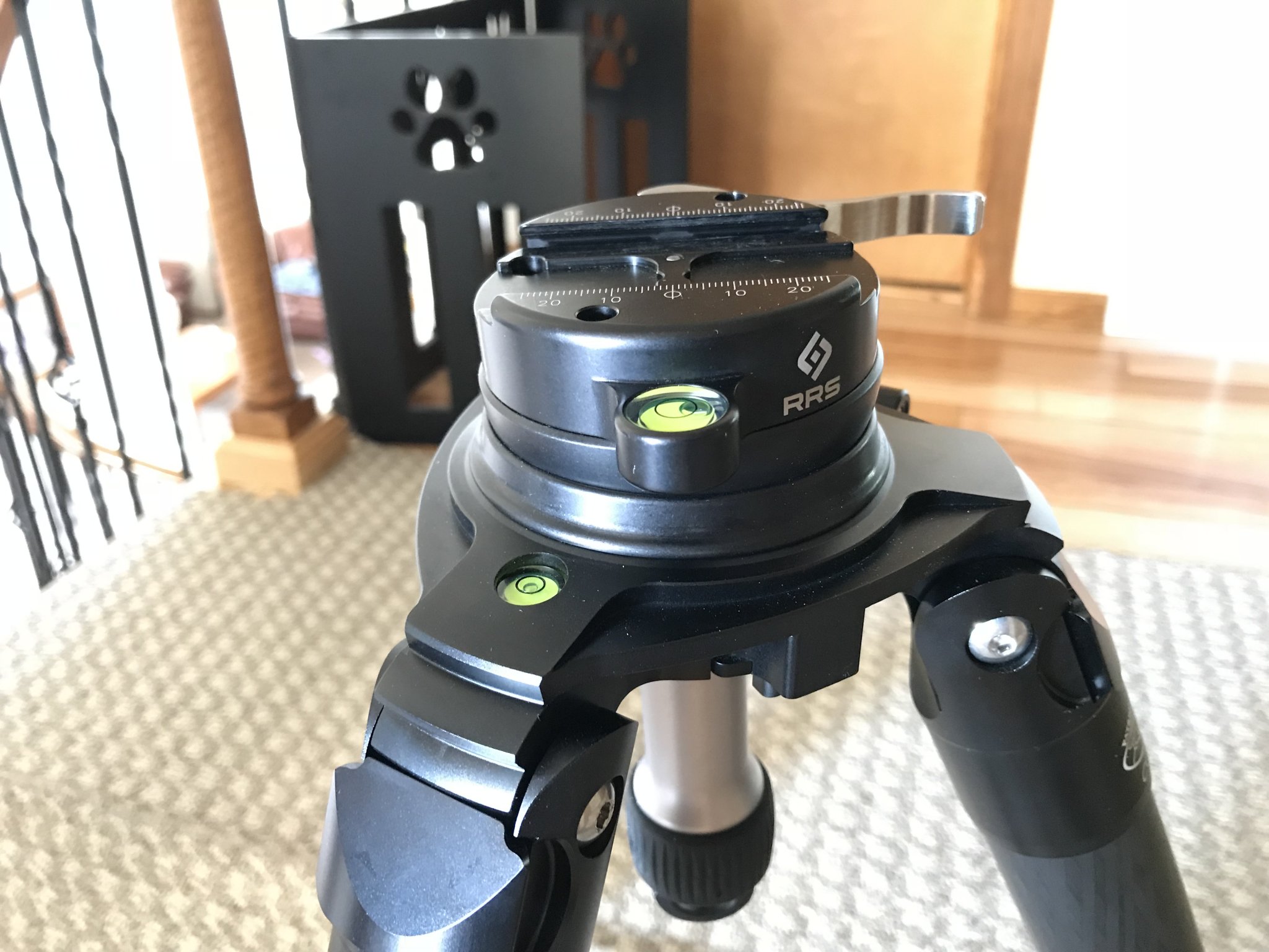

I can confirm that a RRS TA-3 leveling base fits into the tripod as that is what I used. In using it in the match it seemed just as stable as a RRS TVC 43 with TA3 that I have shot in the same match previously. Overall I’m impressed.

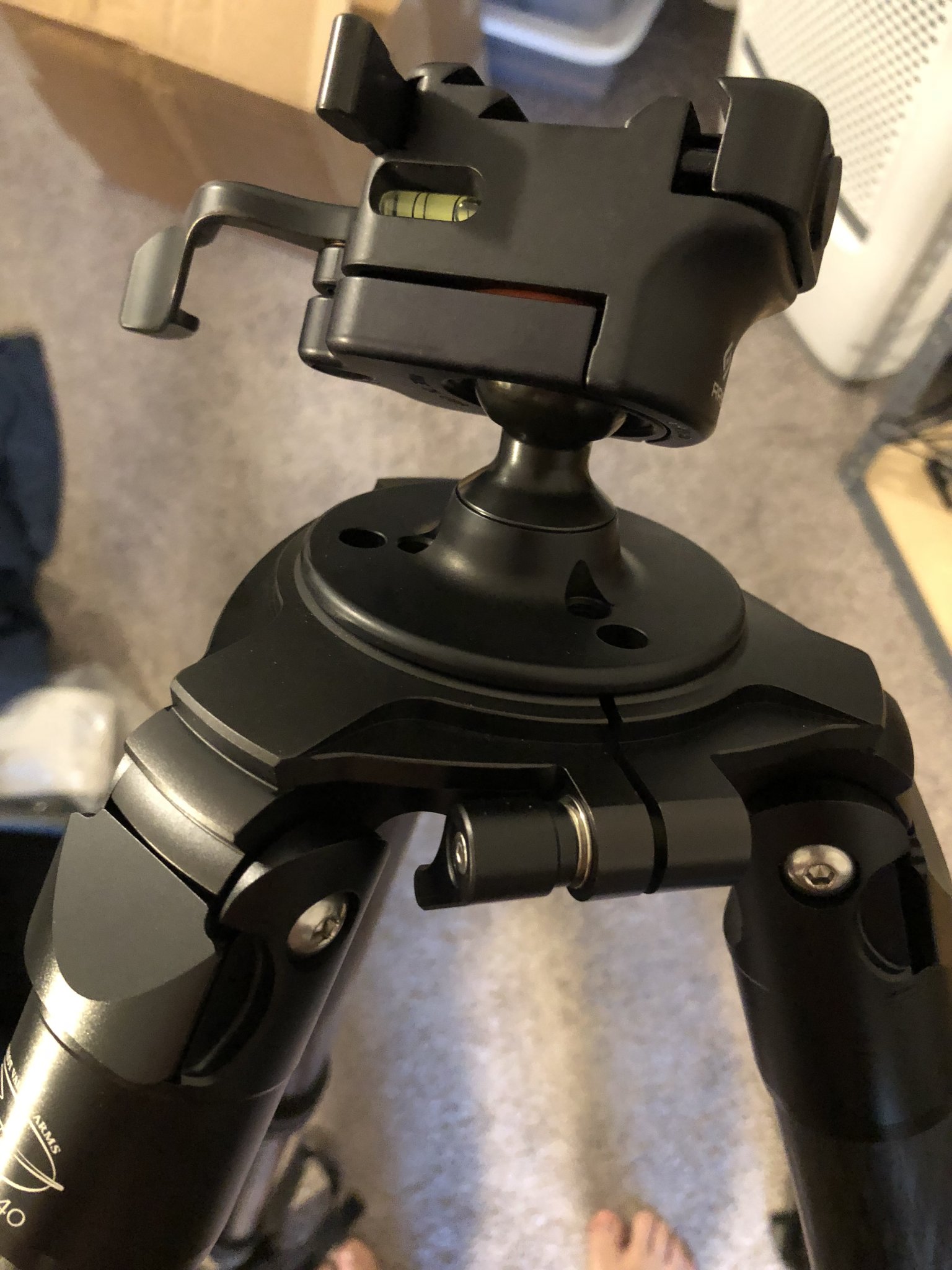

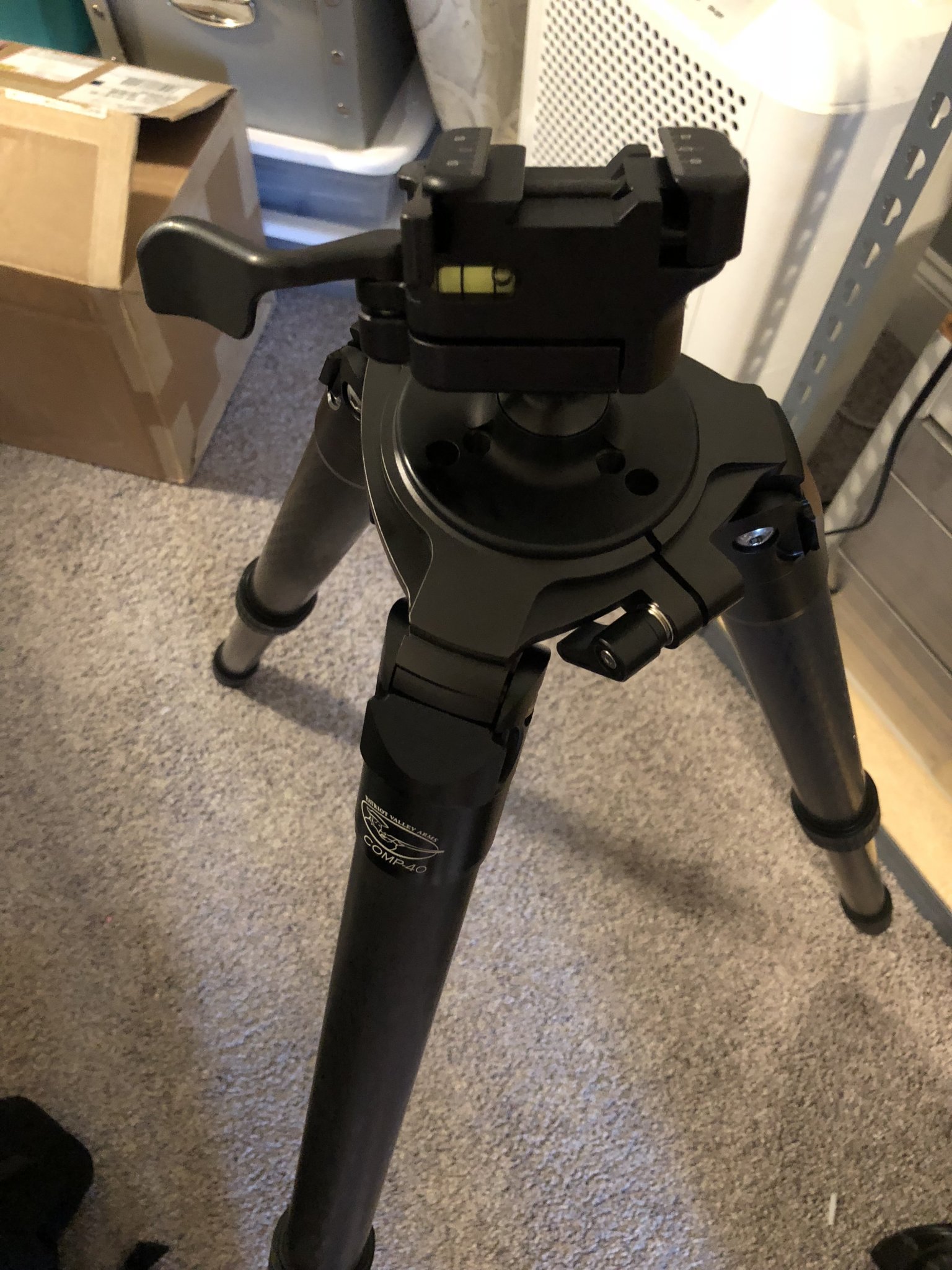

Photo showing the head of the tripod, at about 1 o'clock there is a small tab, this recesses when the button in the second picture (which is on the underside of the head) is pressed, this allows your base, ballhead, etc. to drop in place then you tighten it down with the pictured black tab that is spring loaded and goes around a bolt head.

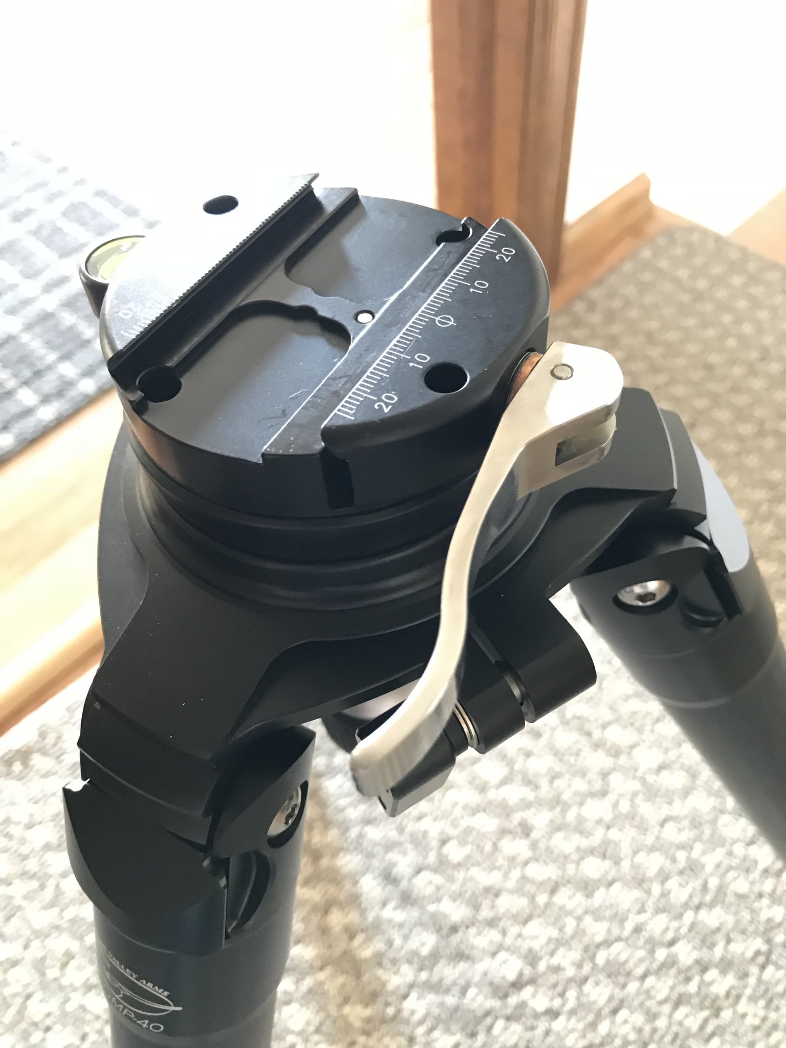

Replaces the plate where the screw is: very easy to do. Avoids screwing on and off as well as being a more stable attachment method.
