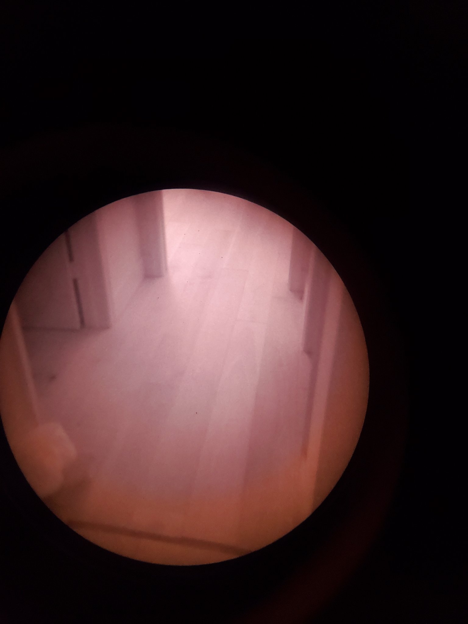

I have a PVS-14 that is tubeless at the moment so I'm using my MUM-14a. I have no idea if the MUM-14a and PVS-14 threads are the same for the filters but I plan to try to test the LIF with my MUM. I may need to tape it on and stay inside so I don't lose it. I'm expecting it early next week so I'll report back with pics.
I tried the LIF on the ocular side of my -14 last night, and I was impressed with the way it looked that way. It's definitely not white phosphor, but it does seem to give more contrast, and it's definitely easier on the eye.
So my LIF came in but it has a pinkish hue in it, not as white as other images I've seen. I'm not sure if it has anything to do with the lenses/coatings on the MUM-14 vs PVS-14, but definitely no green. I have a PVS body but no tube yet.
