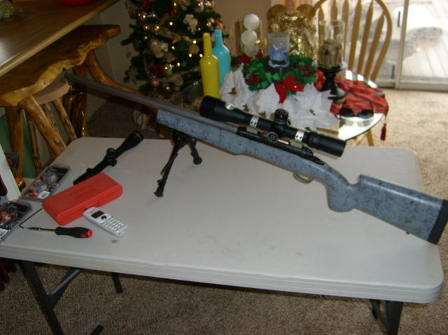

I built a 260 using a Stevens 200 short action that is a center feed. I put a Mcgowen 26" barrel with a 8" twist and can shoot the 140 bergers at 2.935 COAL and they fit in the magazine no problem at all. It is a build for the not so rich and shoots very well for me. I shoot rock chucks all day long at 500-700 yards with it. Some people seem to think they need a GAP rifle or an AICS custom that costs several thousand dollars to have a rifle that shoots well. I am here to tell you that is not the case at all.
Not saying these rifles don't have their place and if I could afford one I might buy one. My poor mans 260 is amazing and has given me countless hours of fun. Something to think about maybe. Here she is:
