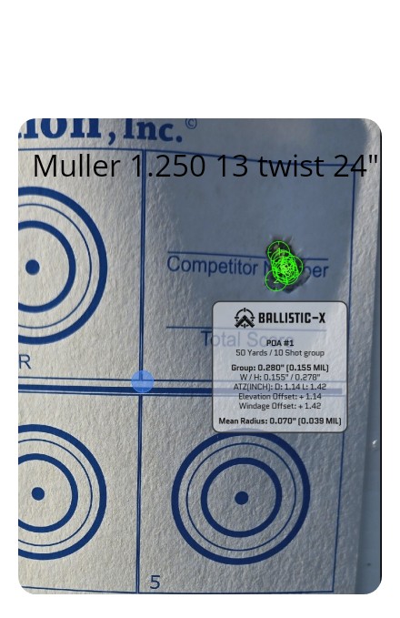

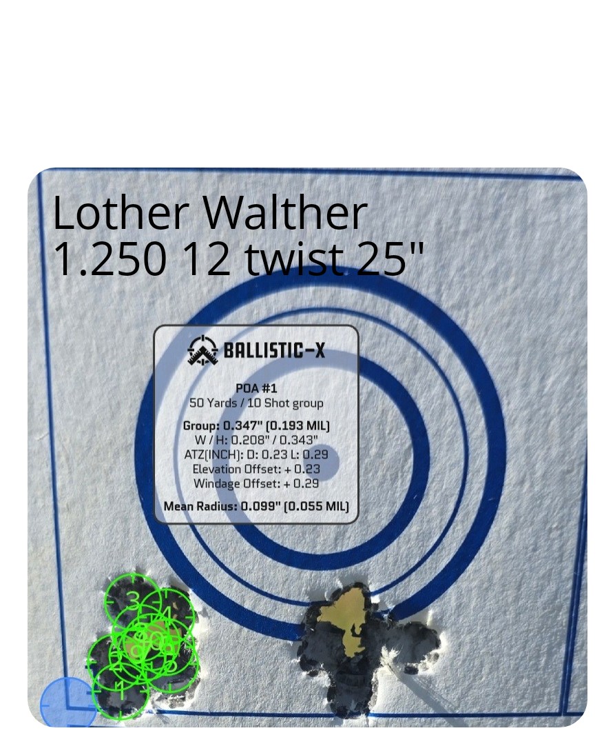

I have a few Muller 13 twist straights, a 13 and 16 ACE 1.250 straight (Cut) several Lothar 12 and 16 twist MTUs, if these move I may start offering CRB and Mullers on a on the shelf ready to ship basis.Maybe both? What blanks will you be using?
How are the CRBs stacking up?I have a few Muller 13 twist straights, a 13 and 16 ACE 1.250 straight (Cut) several Lothar 12 and 16 twist MTUs, if these move I may start offering CRB and Mullers on a on the shelf ready to ship basis.
