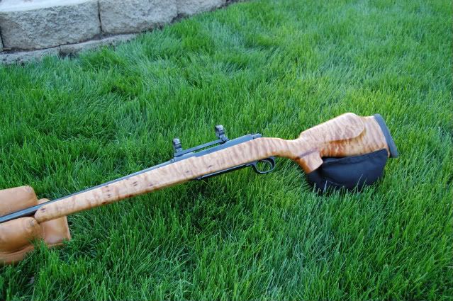

Here is a pic of one I did rencenlty in auto clear:

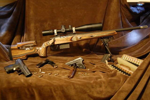

Here is one with water lox (spelling)
