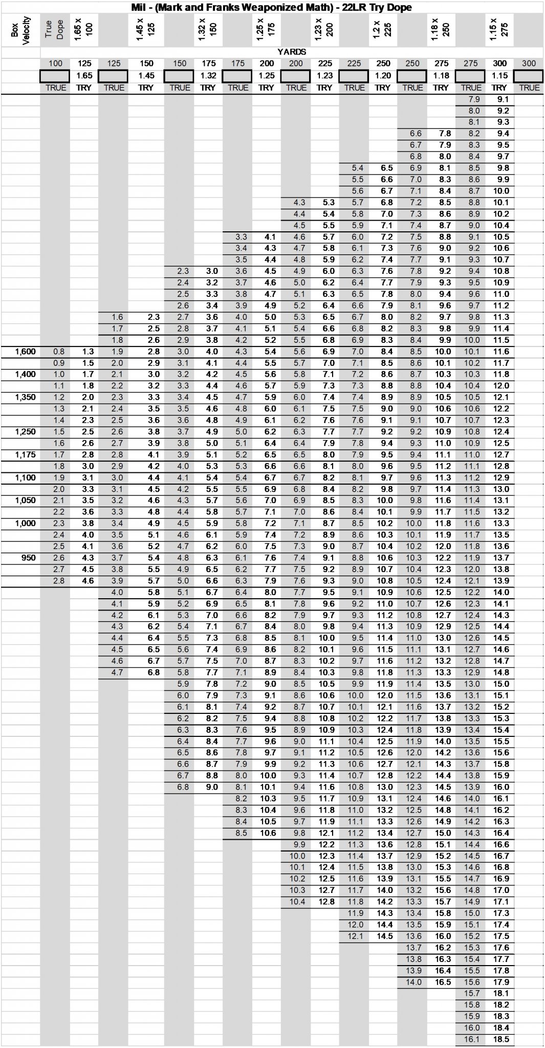

Here’s my backfigured weaponized math based on Sk @1087.
Or like @beetroot said, ignore the math and just use the drops.

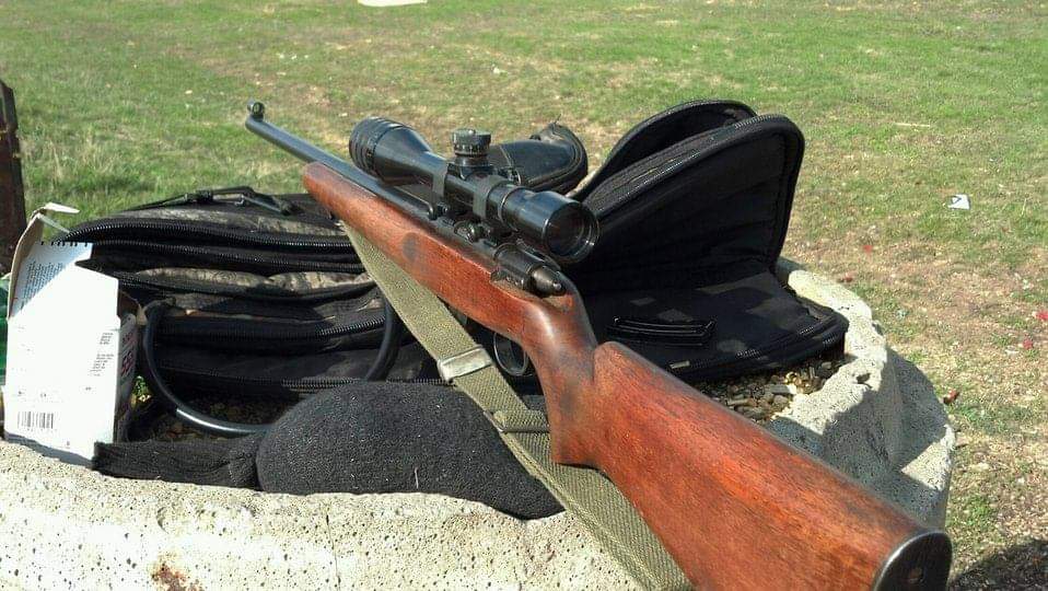

My old 1945 513T was a copperplated bulk ammo loving machine and has a bunch of sweet short and long range cold bore shots. Drop at 100 is 5.25 MOA. This gun can dial out to 365-ish yards. Groups out there are hardly amazing. 50 yard zero. No rail at all and a 1" tube 10X weaver.

Scaled for 22lr:
50 = zero
75 = 1mil
100 = SHOOT IT! (actual dope)
125 = 100yd dope x 1.75
150 = 125yd dope x 1.45
and so on...
It will get you a very rough estimate as is, but to take it to the next level takes a little more playing around than with centerfire as 22lr drops so darn fast. Depending on barrel/ammo you might need to adjust increments slightly. For instance 30yd increments instead of 25yd actually lines up nearly perfect every time for my setup. So there is a bit of trial and error if you want to really get it dialed in, but once you figure out your increments it's amazing how well it works.

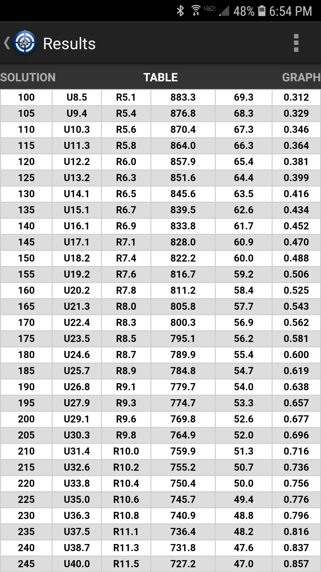

I put the data in strelok and go. 2 minutes ranging targets and writing it on the card. 1-2 minutes to type it into the calculator and write down the output.
