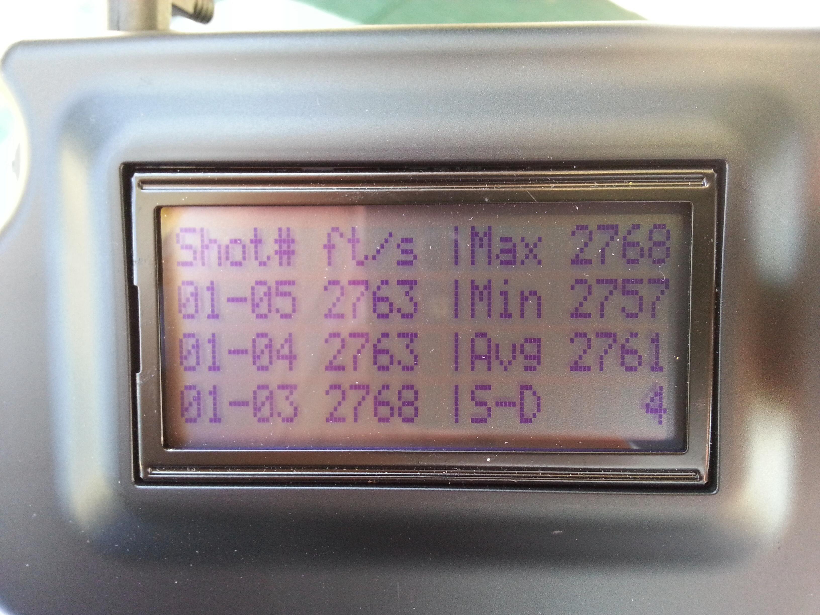

43.5gr IMR 4064 lapua brass 185gr juggernaut. I load out to 2.87oal and I am getting 2750fps and shooting bugholes.
