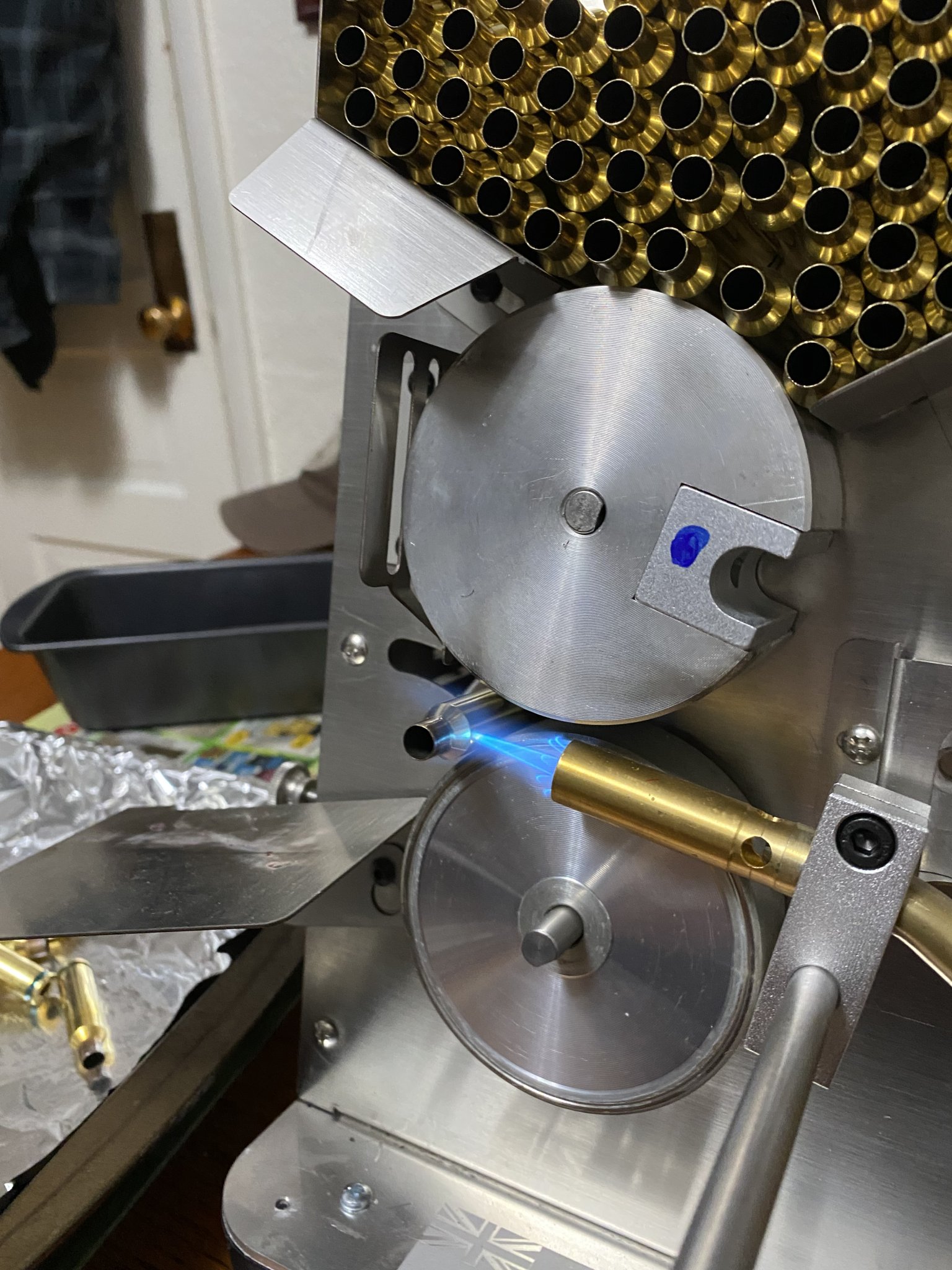

Try 10-12 psi. Propane is about double that of Natural gas 4-7 Psi . Torch is most efficient and quiet .

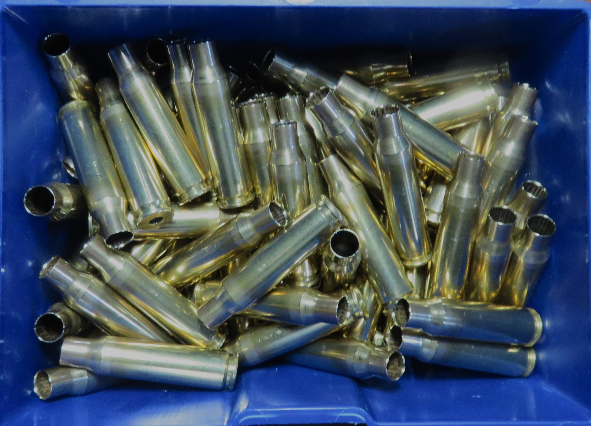

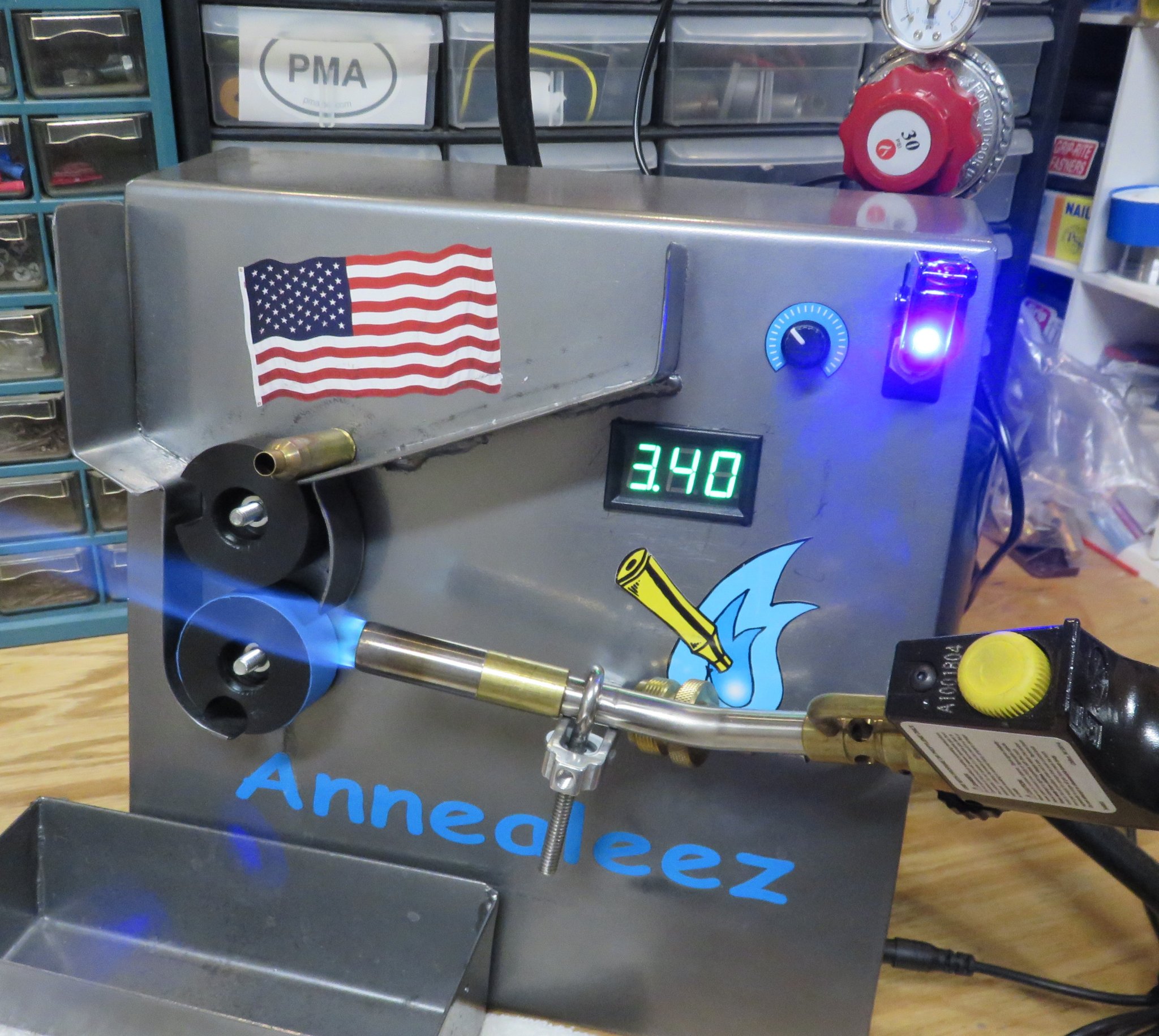

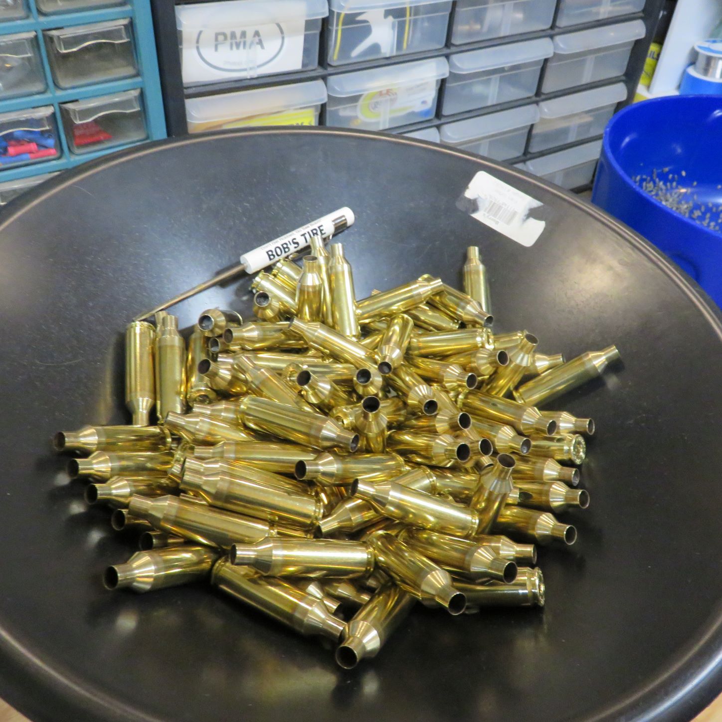

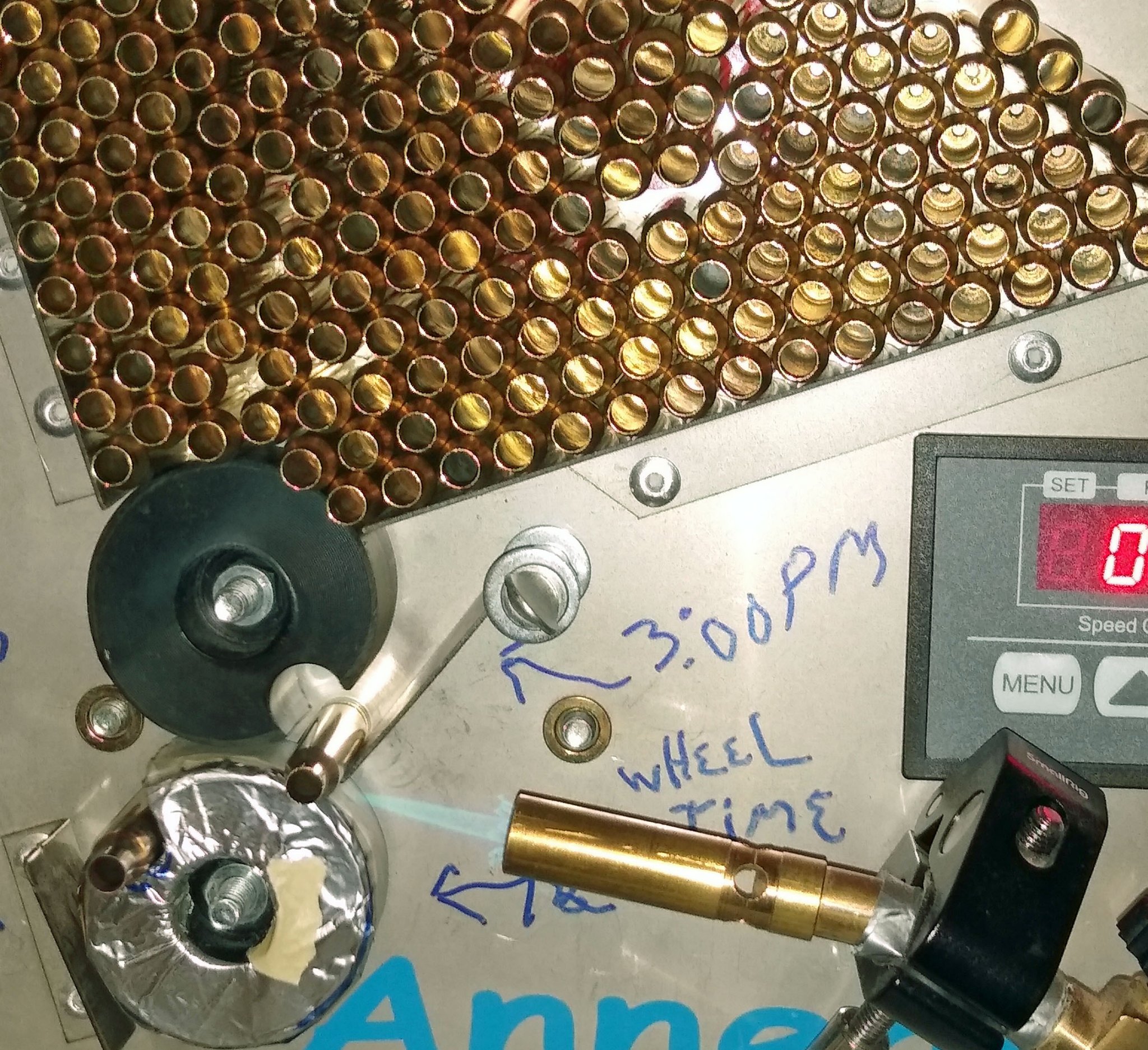

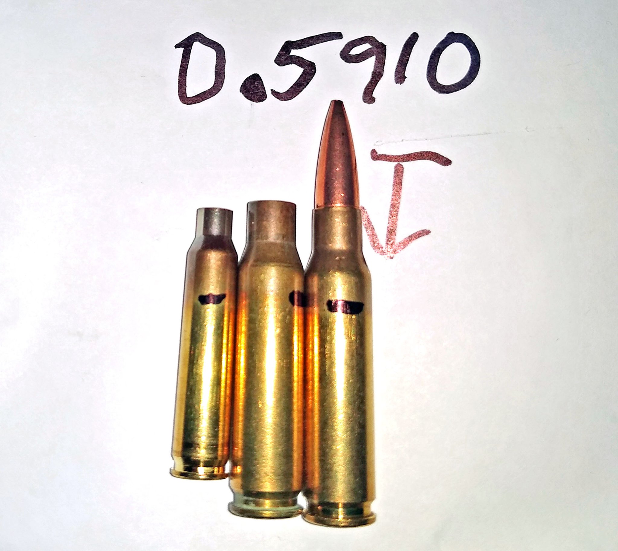

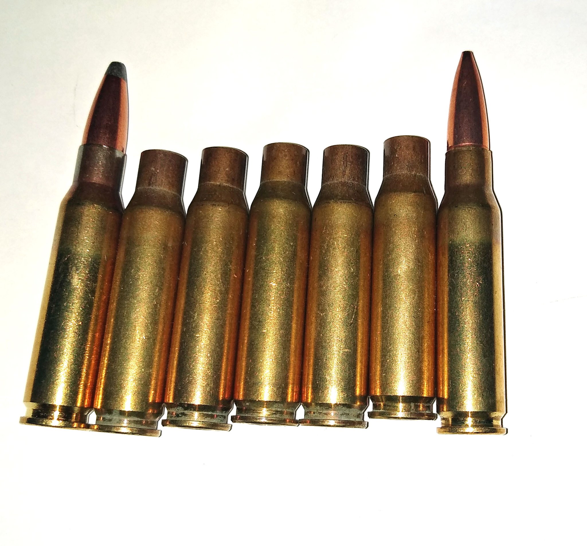

This setup works just dandy and budget minded . I match the witness marks of Lapua and haven't lost any cases do to split neck and all seem to seal in the chamber just fine . .222 , .223 , 5.56X45 ,7.62X51 , 7.62X63 ,6.5 CM , 7mm RM, .338 WM , .338 LM , 7.92×57mm and 9.3X72R .
I do em all and they come out just fine . I run each case after #3 firings ,Not every firing . I'm Not BR shooting either :

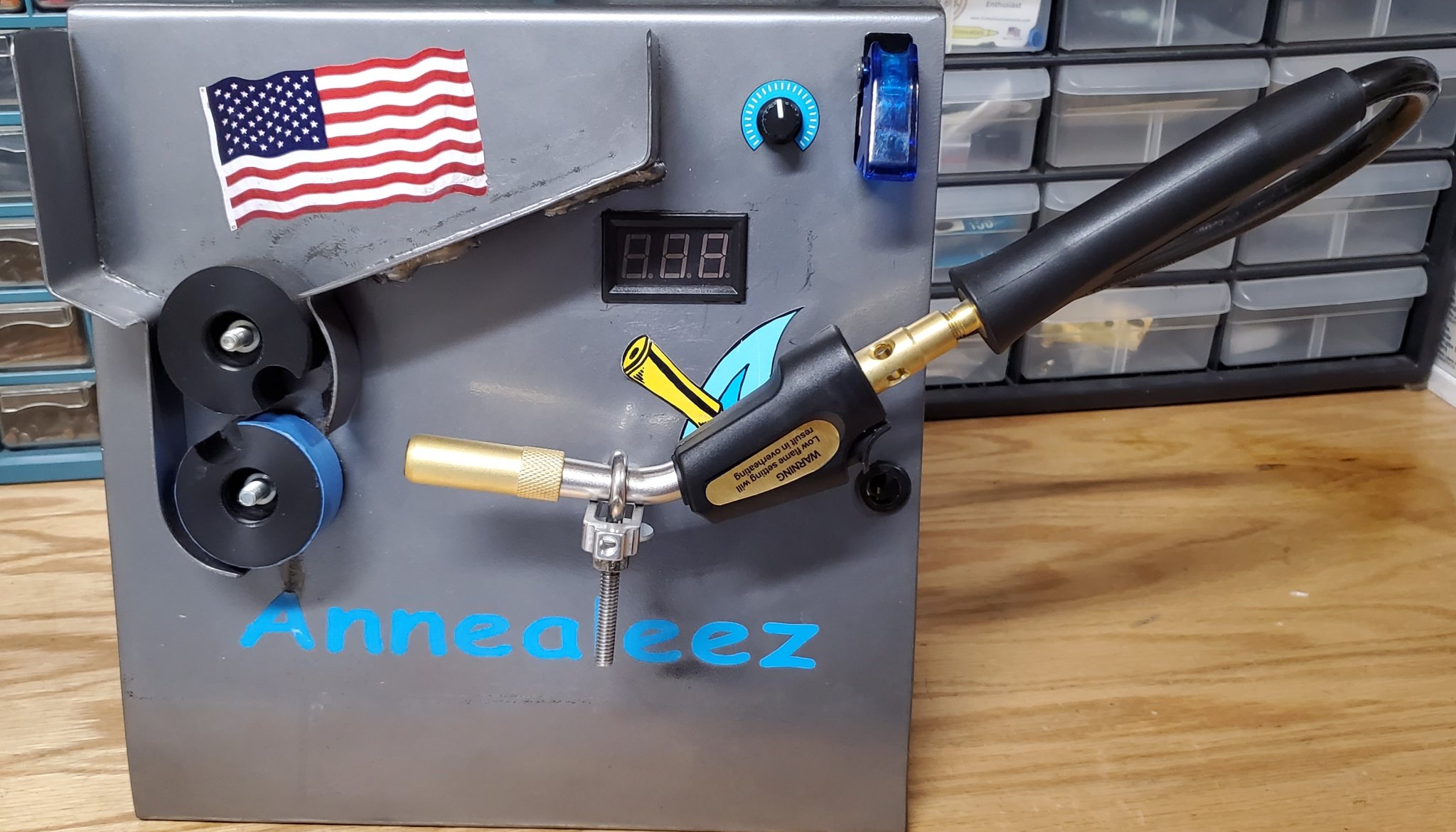

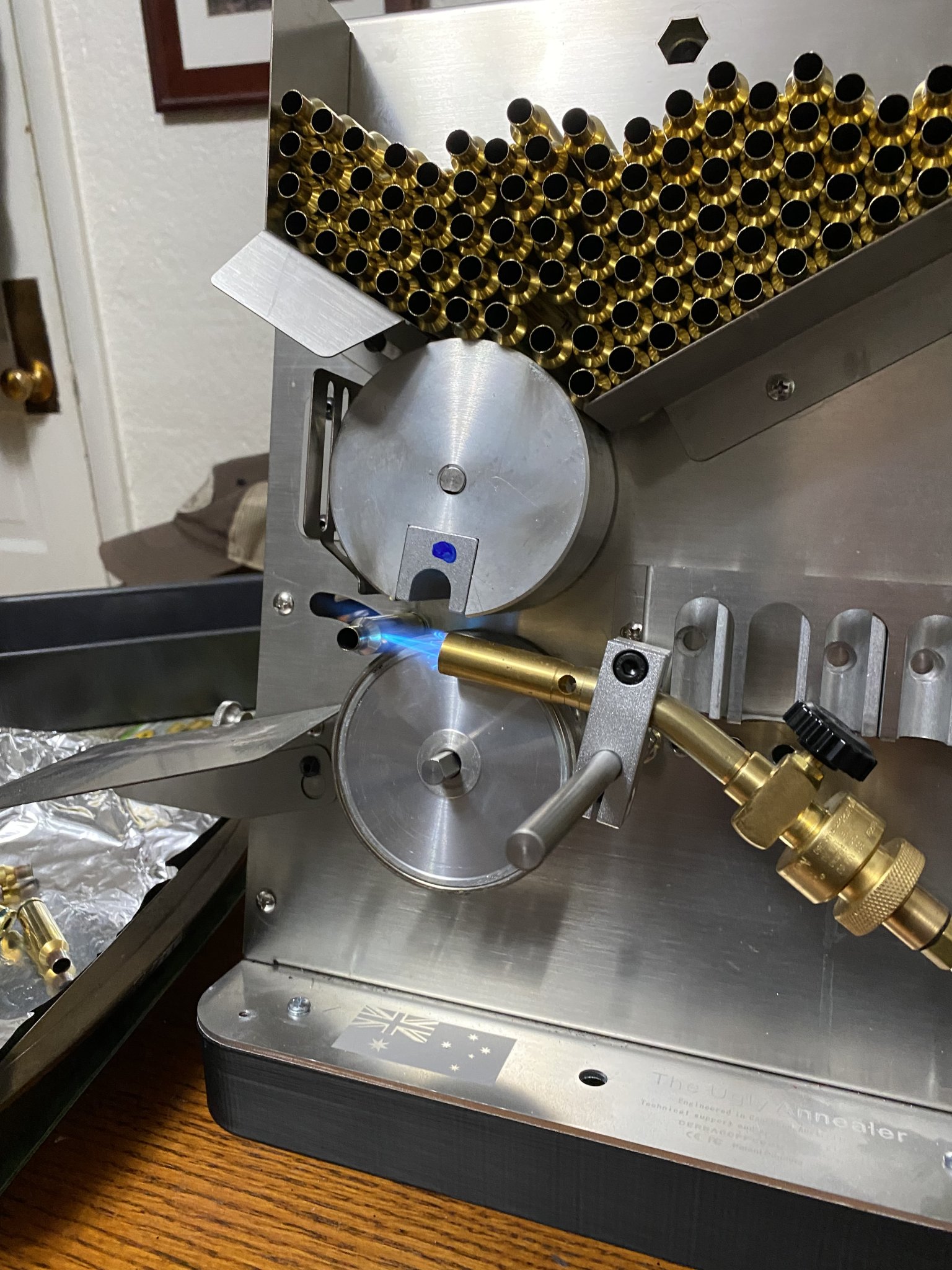

I use a very similar set up that's been working quite well for me. My Annealeez is one of the older models that I've had for years which I've upgraded a little:

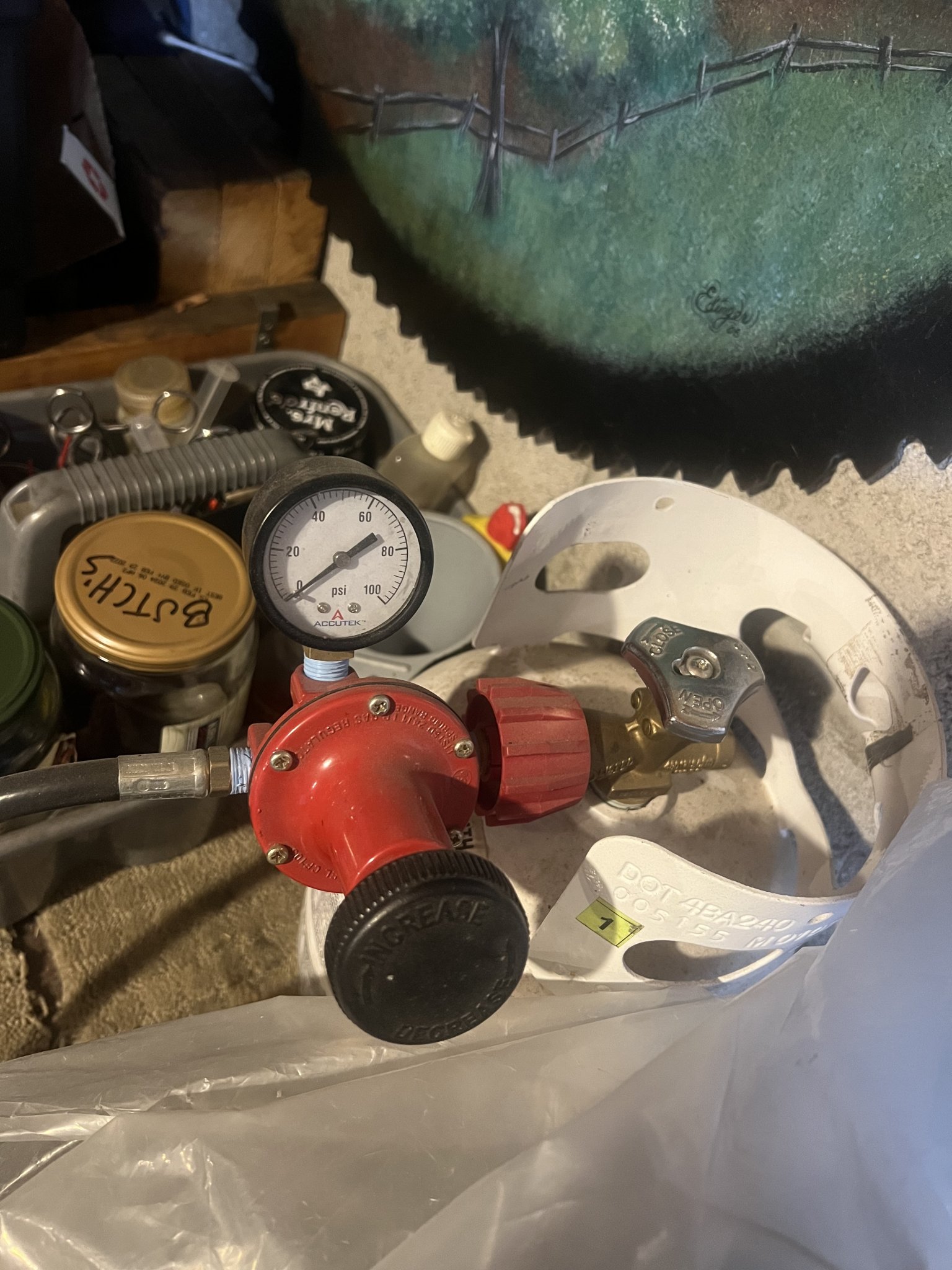

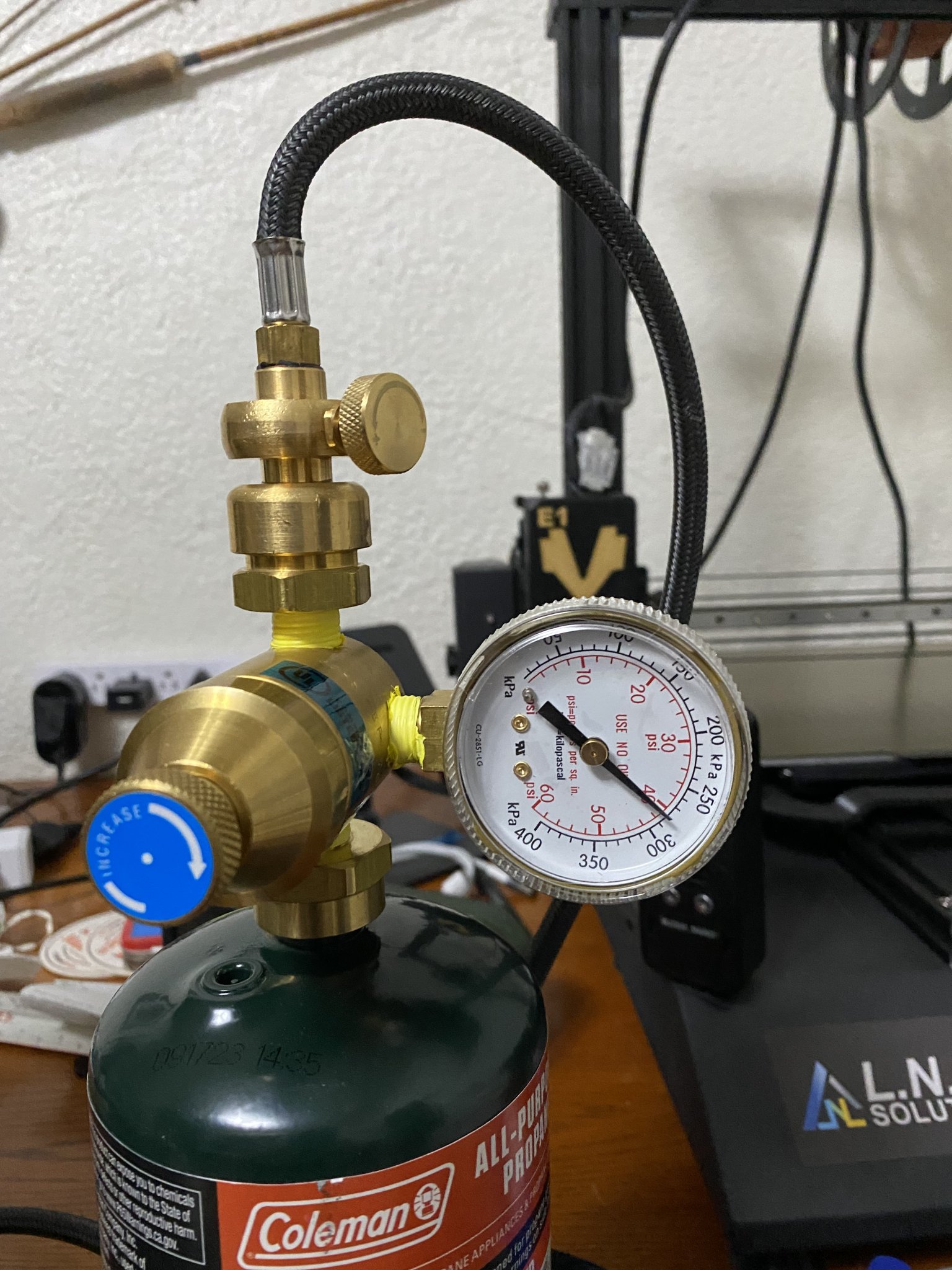

I don't know if a certain pressure range is more stable, but I use 20 PSI.
I'm using whatever torch head came with Giraud. Don't know if that matters either. It doesn't seem to be anything special.
You using a 20#/4.7 gallon tank?
No I’m using the 1lb bottles.

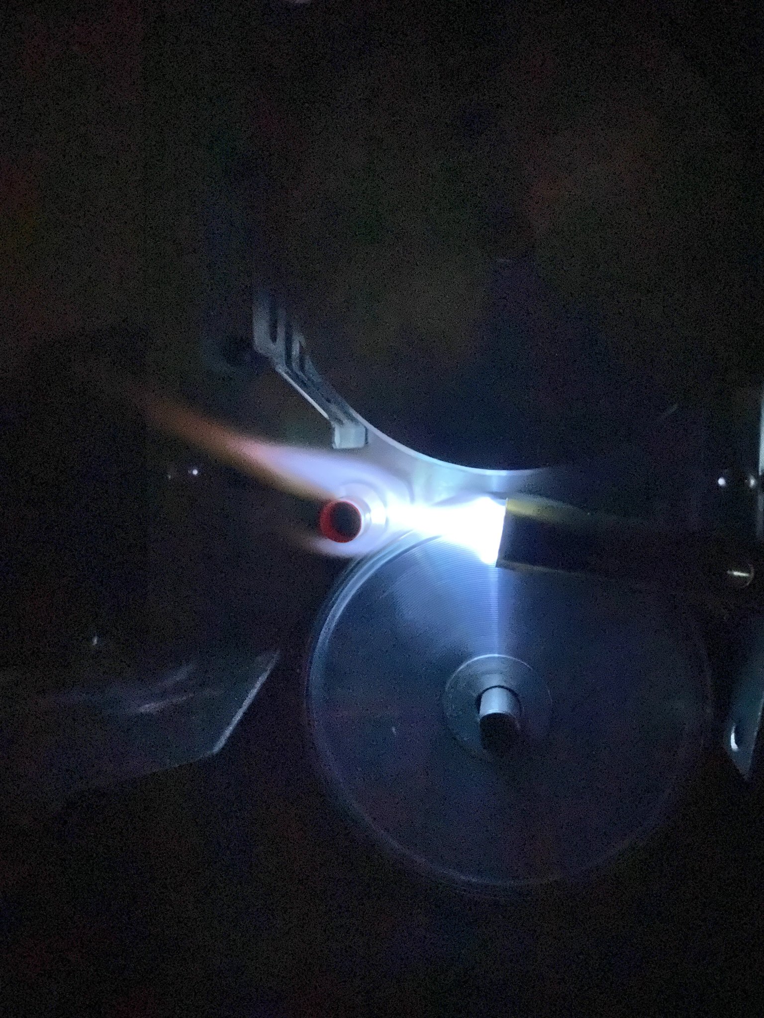

For some reason I am up at the 40+ pressure range using the ugly annealer torch. I end up having to increase a bit over time to maintain the same flame. I was hoping the regulator would eliminate the need for that. It does aid quick set up though.

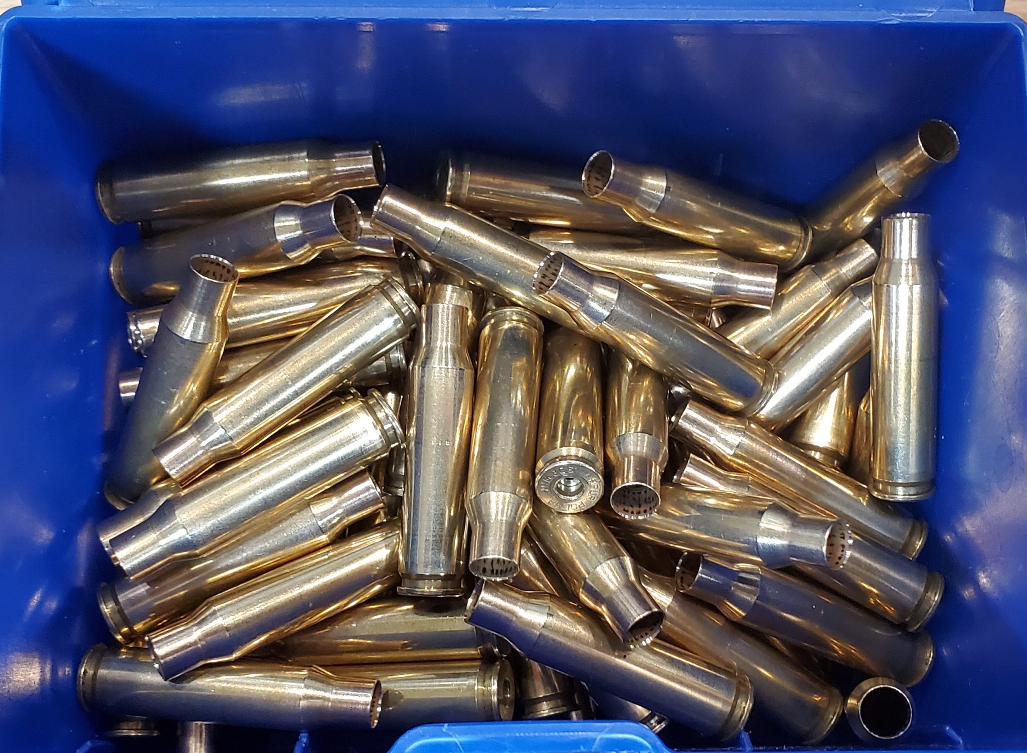

Reactions: straightshooter1

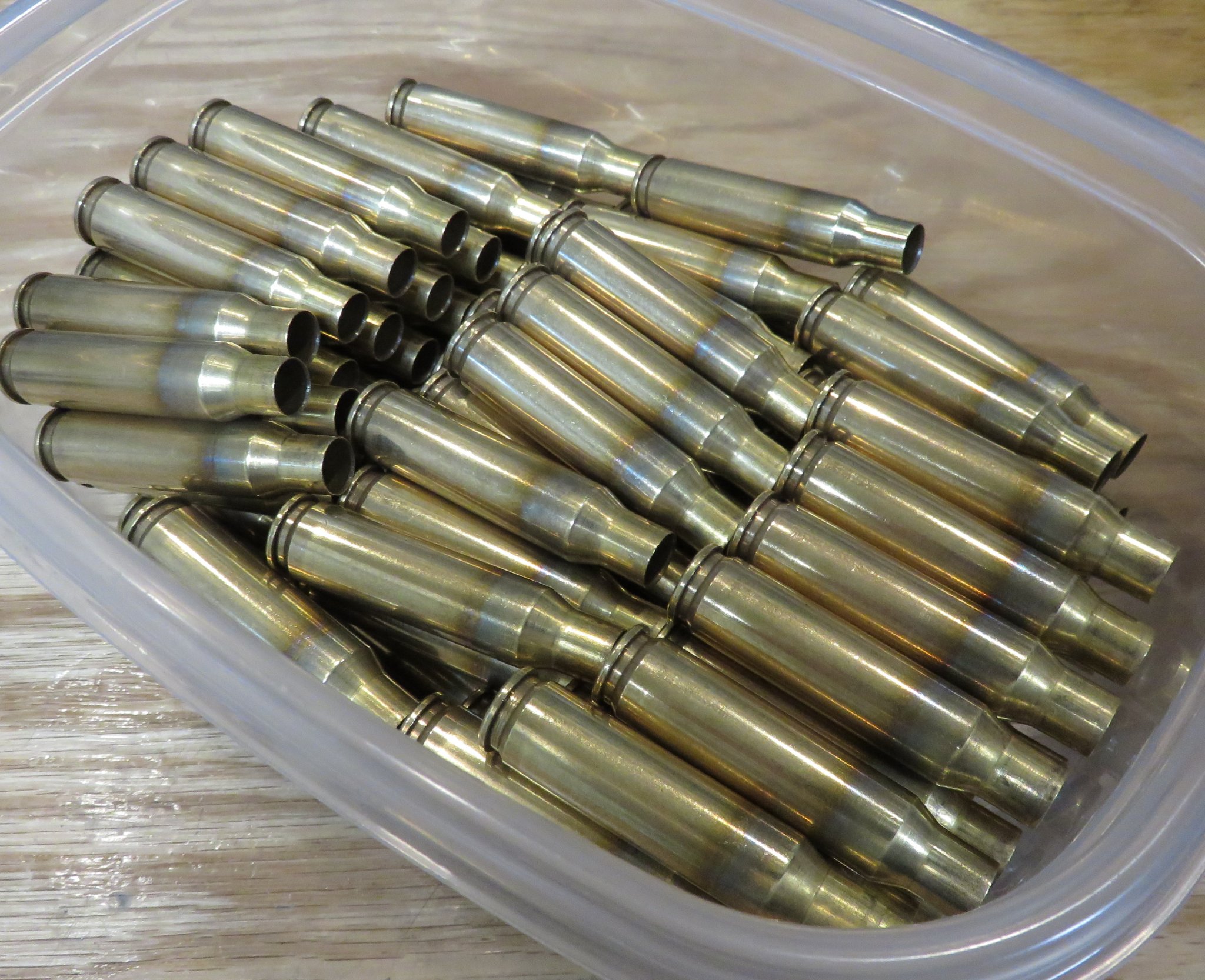

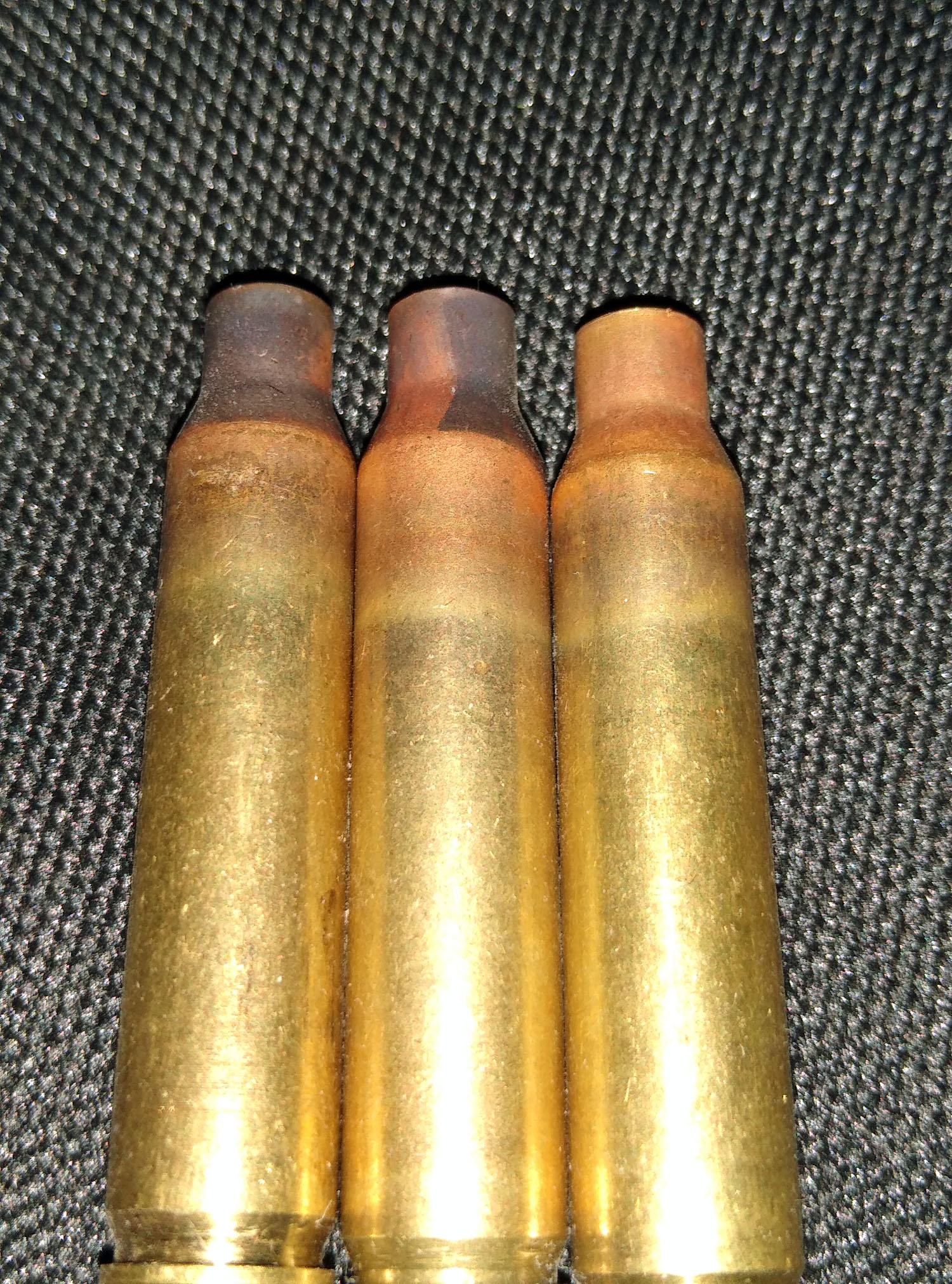

My file case is never have that discoloration unless I bake the shit out of them red hot
Is that because you clean them before you flame anneal? And if so, what method of cleaning?
When I get brass very clean, like when wet tumbling, they too will not have much discoloration.
Otherwise, you many not be "annealing" as much as you think"??? Not that the discoloration really matters in any way about the state of the hardness from the annealing process. ;)
Those cases in the pic above are right after my annealing process, which is my fist step after firing (other than depriming), then I take steel wool to the necks to remove the abrasive oxidation layer from the necks and shoulder in prep for sizing. After sizing and vibe tumbling to clean lube off, the finished cases will look like this:
If you monitor the temperature on the bottles you'll see they are getting colder when the pressure drops. The large tanks can go much longer before that is an issue.
Yeah, dude, you definitely need to step up to a bulk tank
Yes I have noticed that. I suspected that was the culprit. So will larger tank fix that?
Thx🙏
What size is that one? Will the larger size be more consistent? Thx 🙏
I have that one that is like a 1 gallon and it’s the smallest bulk tank you can get. I also have a 2 1/2 gallon. I used them for my camper van, but then realized the size is very convenient to sit on top of the bench for the annealer or underneath it or whatever.
They’re like $80 but it’s like a buy it one thing
Reactions: Holliday
Awesome the 1 gal seems like the ticket.
Reactions: secondofangle2

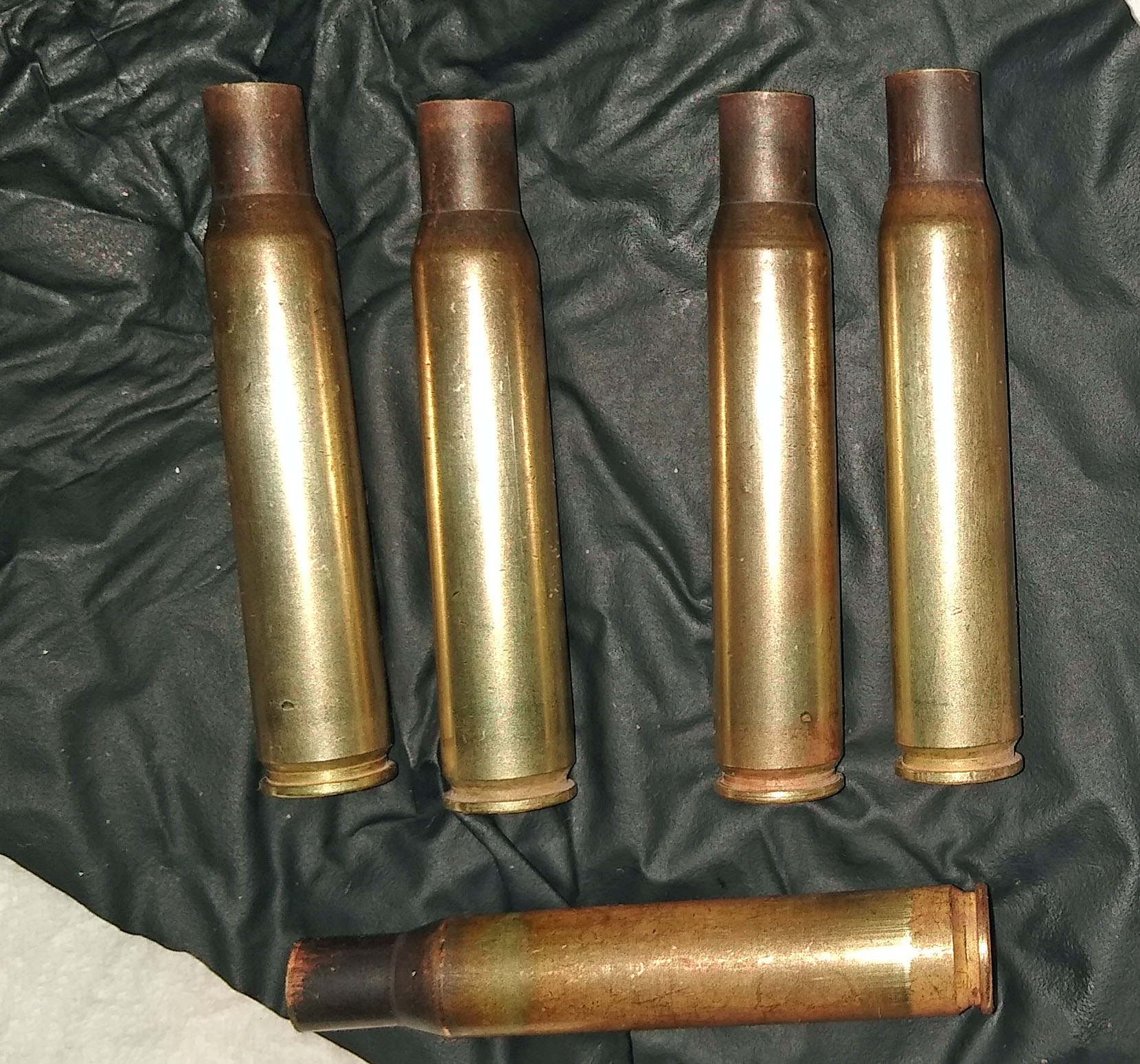

My flame cases never have that discoloration unless I bake the shit out of them red hot

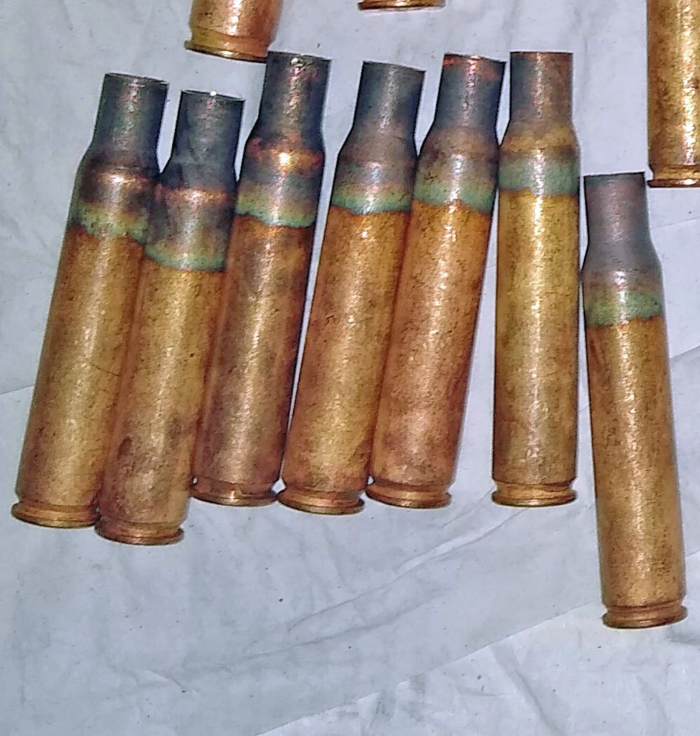

The idea is 1200 Deg. F. at the neck tip about 950 Deg. F. at the shoulder and less than 225 Deg. F. down at the base . That's using the Annealeeze doing around #150 cases per load. Now 5.56X45 perhaps #225-250 ?

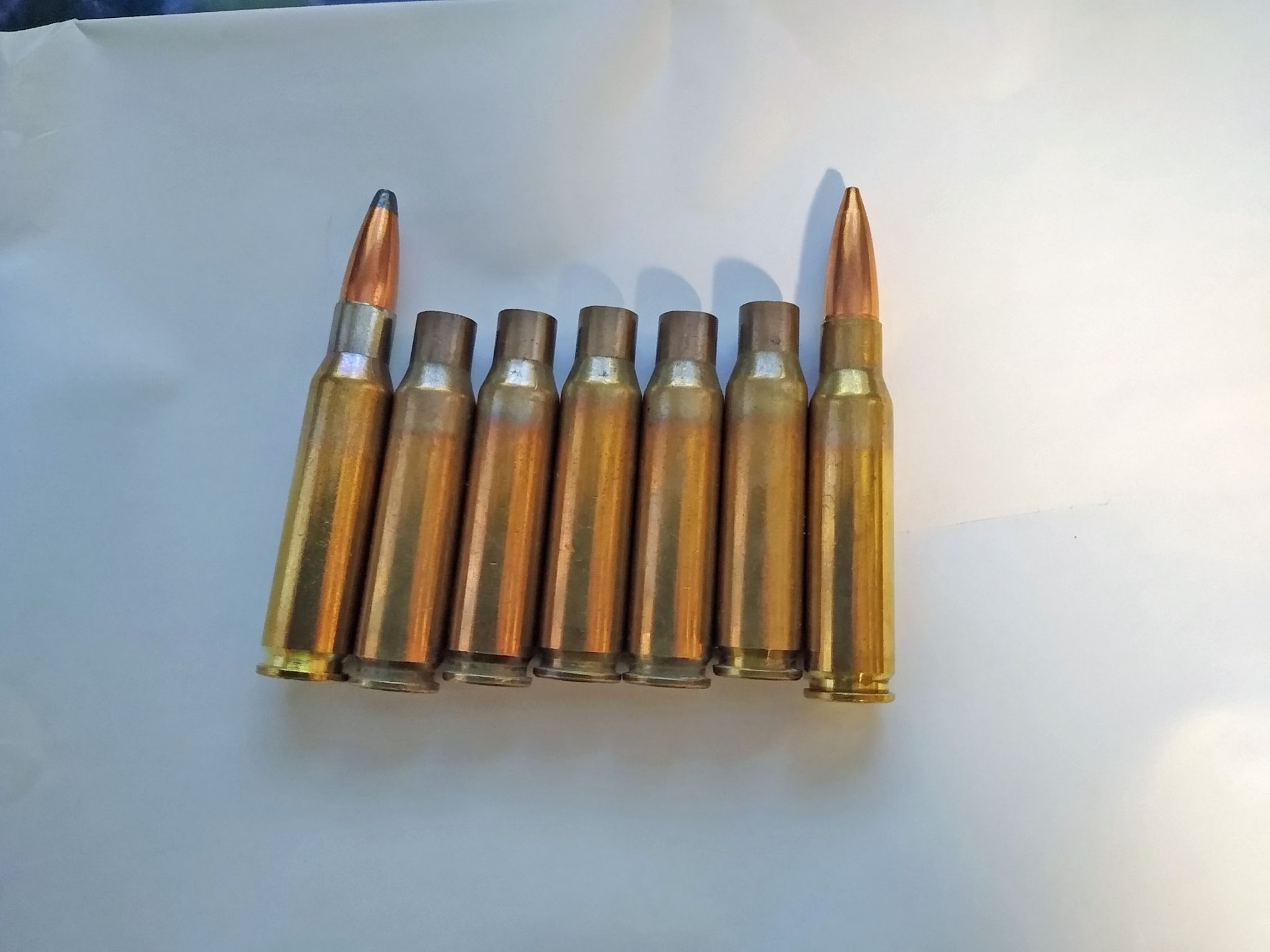

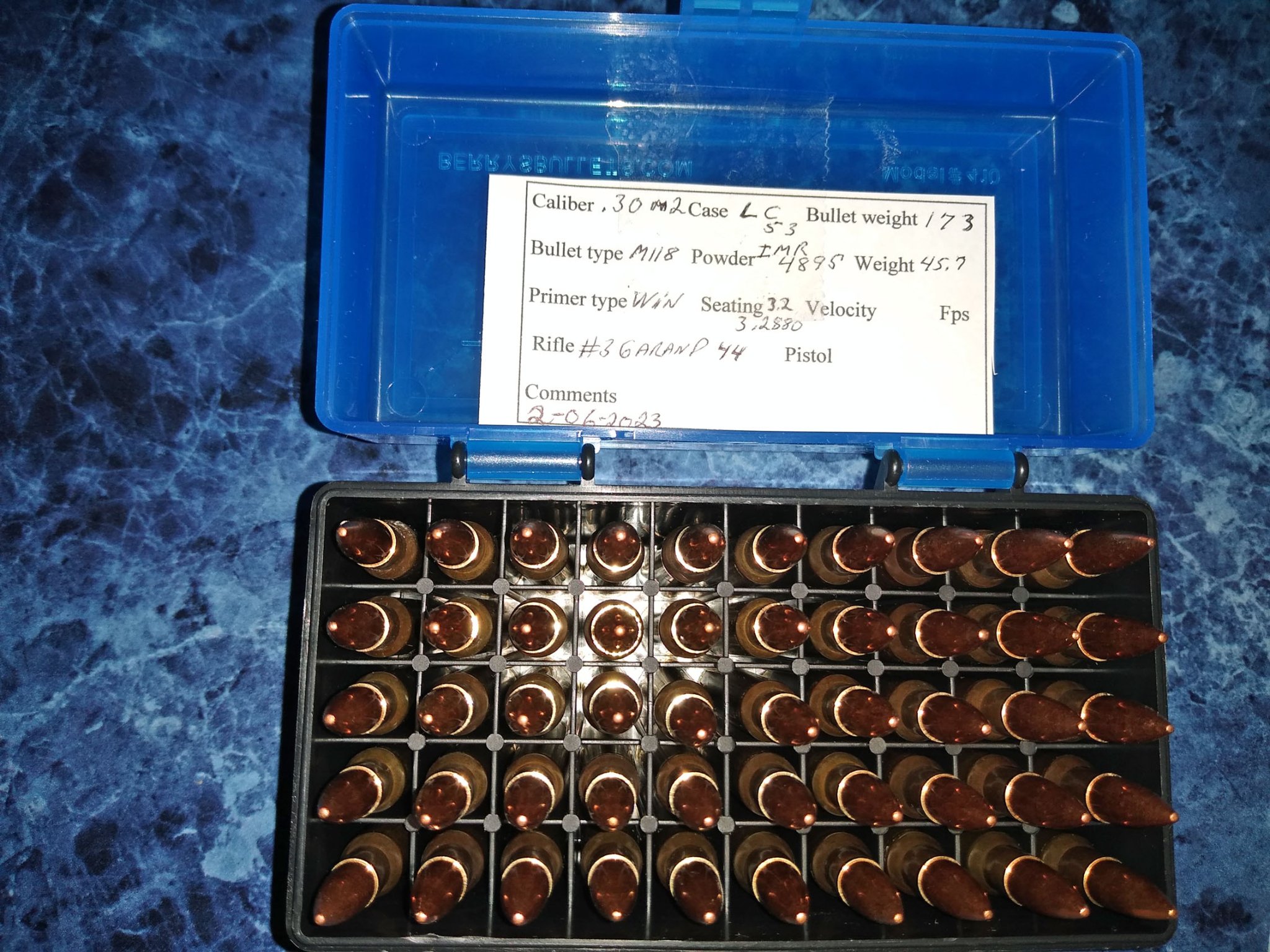

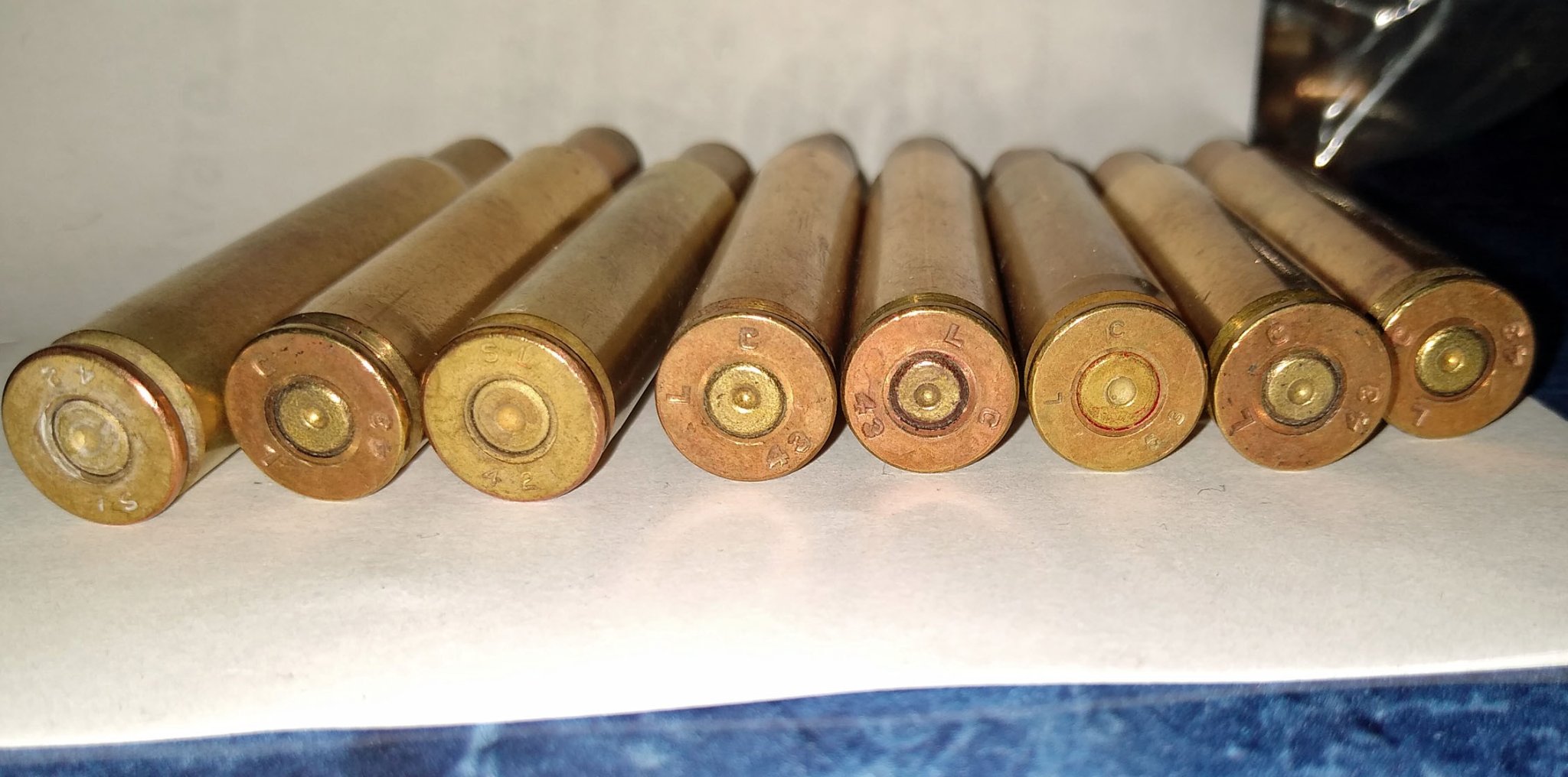

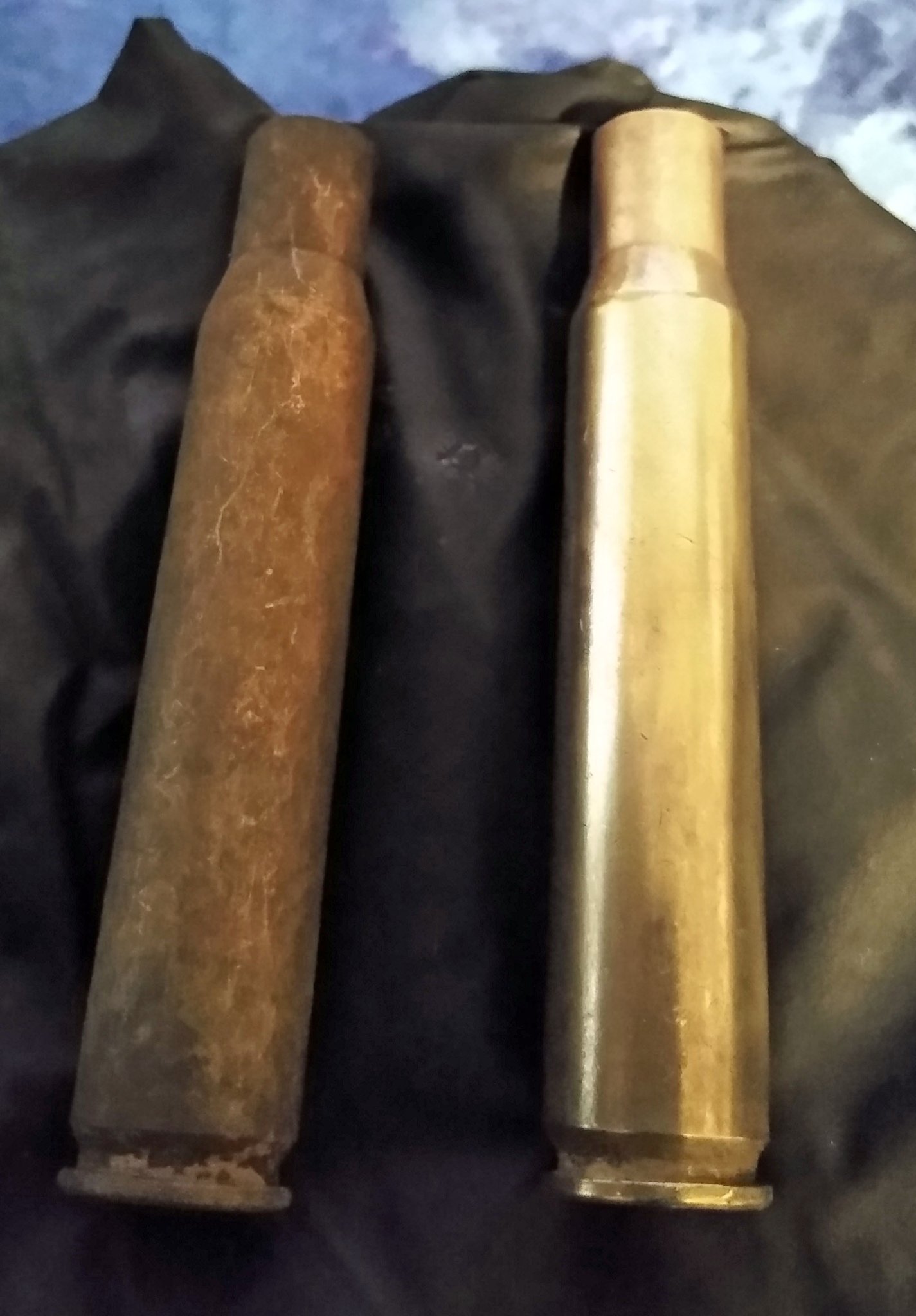

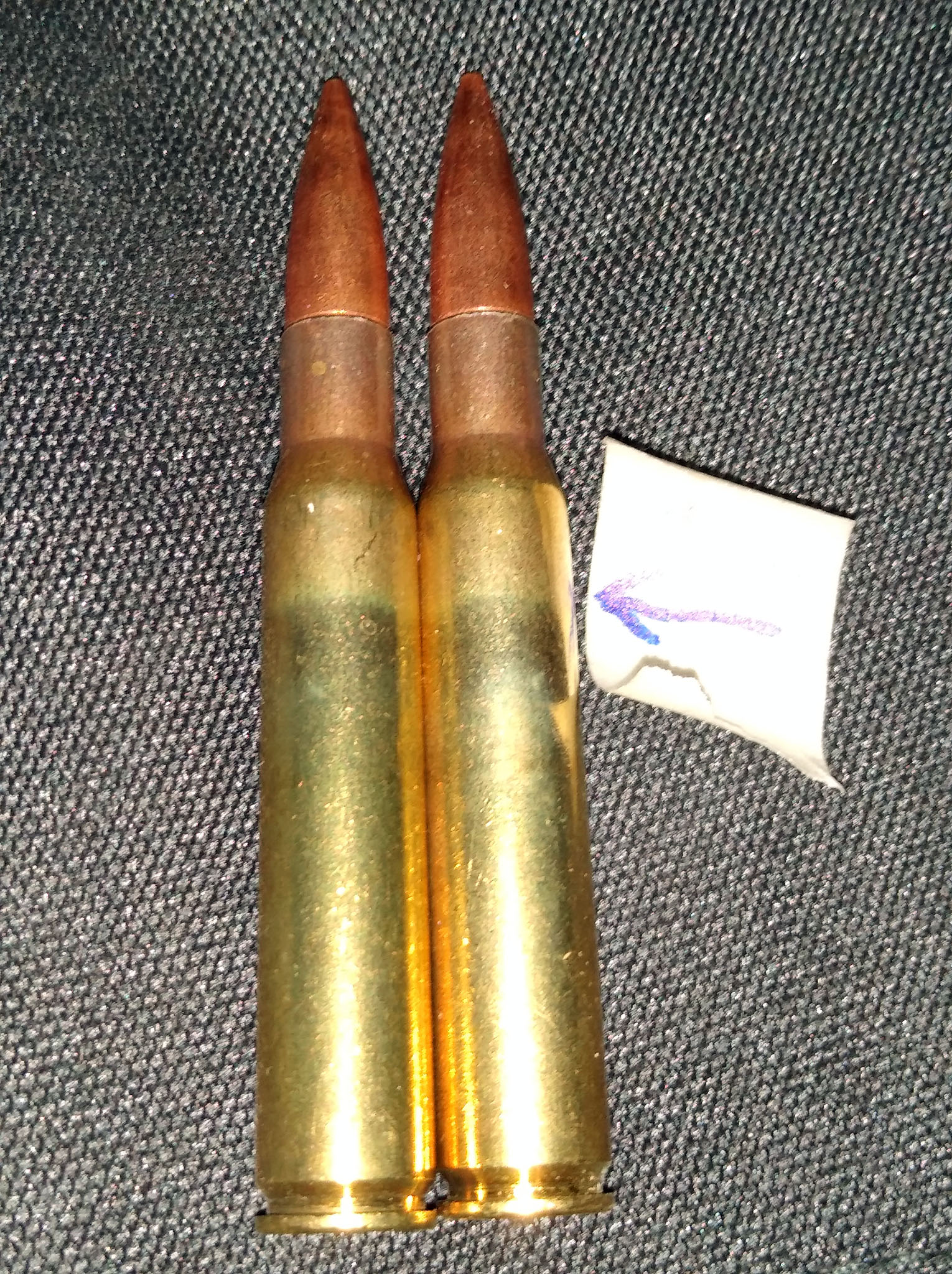

I just today completed # 50 firings on 1942-43 , 30.Cal M2 once fired cases . I lost #2 cases because I cut them so as to measure wall thickness at #45 firings . All loads were loaded within 1 grain Max. charge for M1 Rifles . Never split a neck or tore a rim and that in itself is damn remarkable ,as M1's aren't gentle on extraction . I will now single fire until failure ,as #50 firings is a shit load on 30/06 cases and don't want case separation auto load slam fire scenario .
Fyi: I've since fixed the stripped pinion on My beater Garand and am now able to move as in lower or elevate rear aperture . All #8 are right there at 165 yd. using original sights off sand bags on My bench . I don't fix what isn't broken . ;)

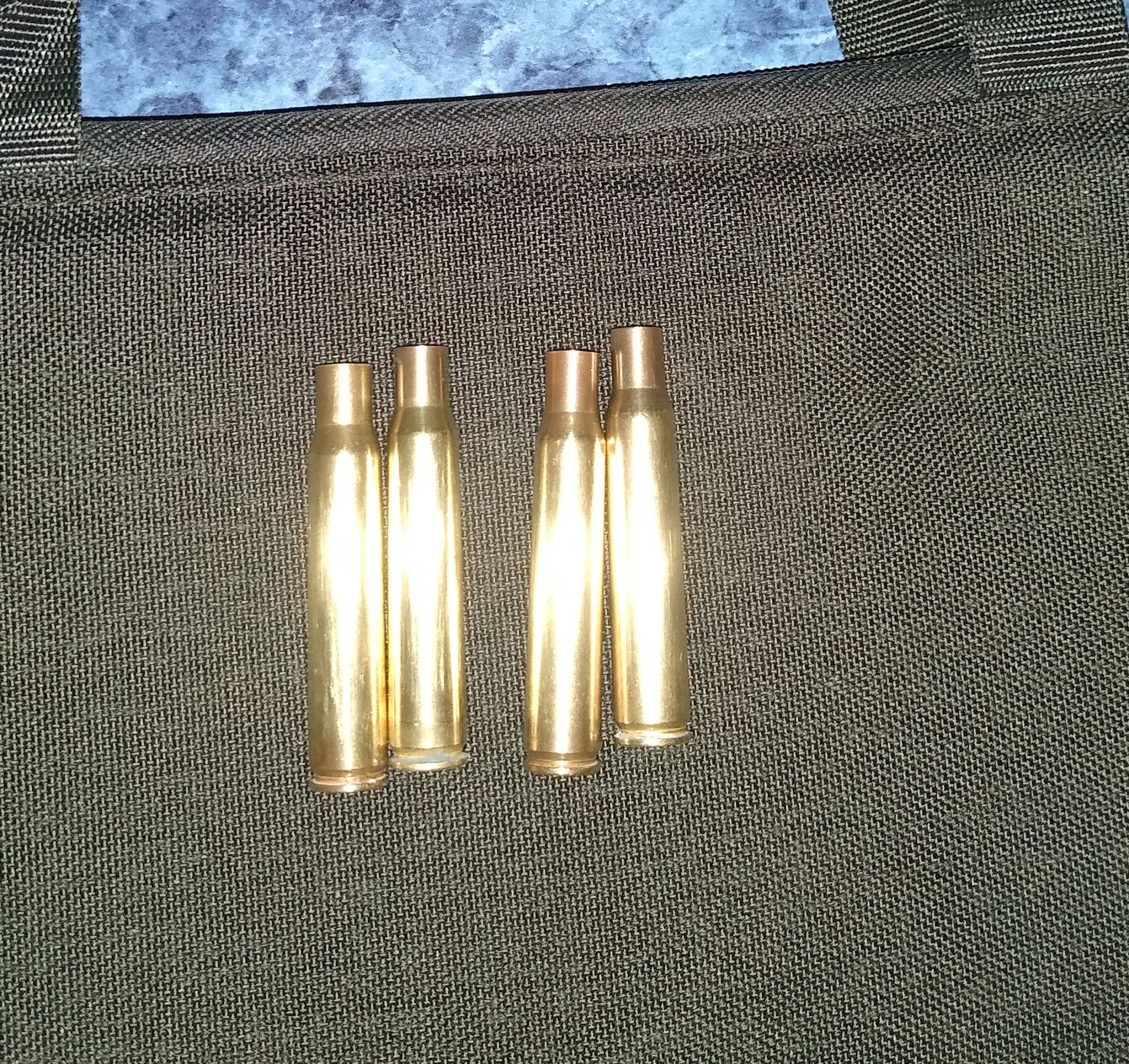

Yeah I go for the “glow” and drop. I never get discoloration …..

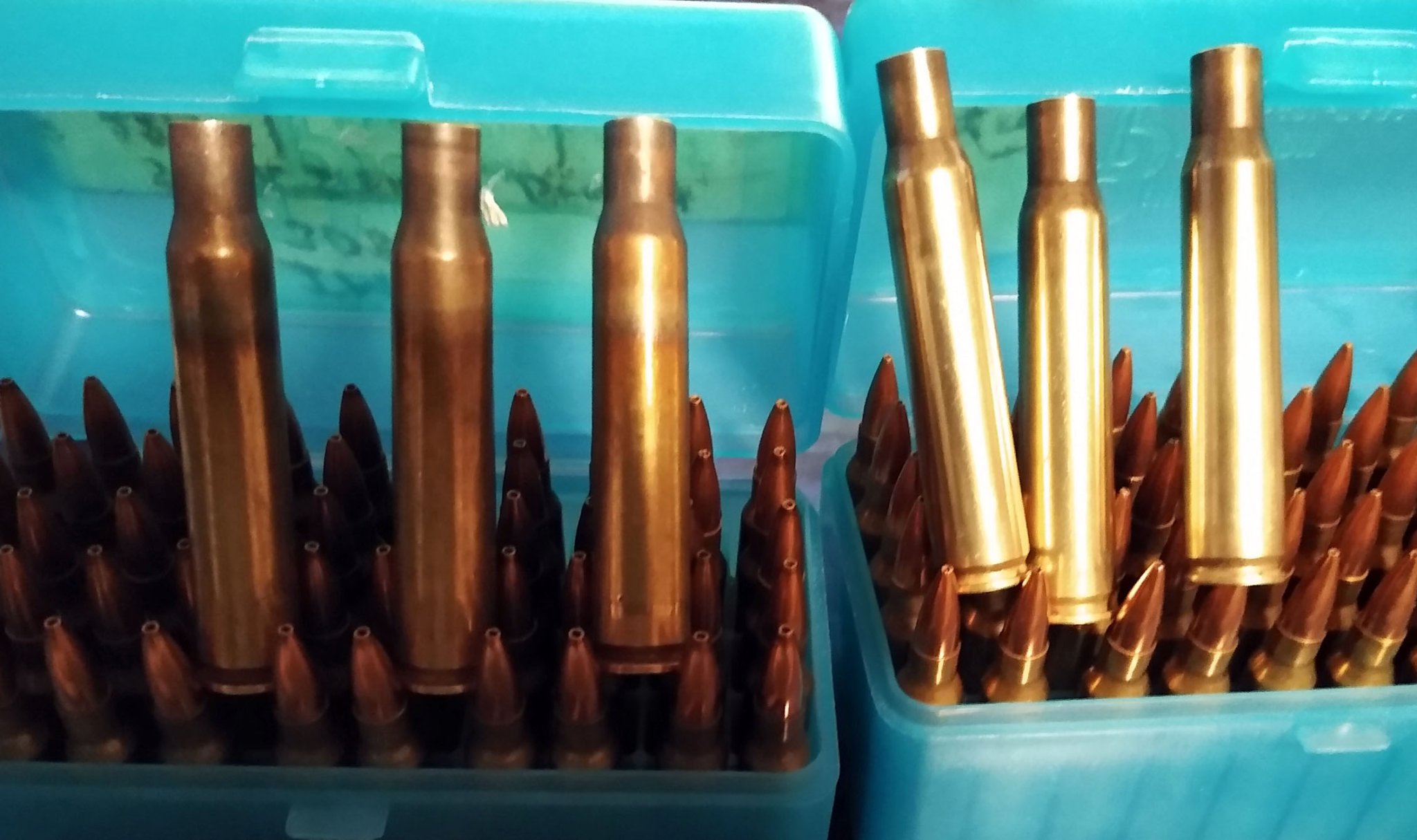

Hate to burst your bubble but if your brass isn't discoloring ,it's NOT HOT ENOUGH !. ALL brass even Lapua LC whom ever s brass discolors . I'll assume you DON'T have the means to check hardness ,as in a micro-Vickers gauge ,so You're only guessing .
I've been at this for over 58 years and worked in Aerospace Engineering ,more importantly had access to ALL necessary equipment to test near anything . One CAN'T soften cartridge cases without HEAT and High temp does it best . Temperature MUST exceed 850 Deg. F. and you would need to leave it at that for 3 minutes MINIMUM ,in order to soften the neck . So 1200-1300 Deg. F. works in seconds . You can polish 90% of discoloration out of brass if it bothers you . I could careless on mine ,it just needs to be clean .
In the photos you will see cases discolored from heat ductility restoration , one of those cases is Factory Lapua ,the rest are MY cases .
Note how MY witness halo matches Lapua near perfectly . It's Not by accident .

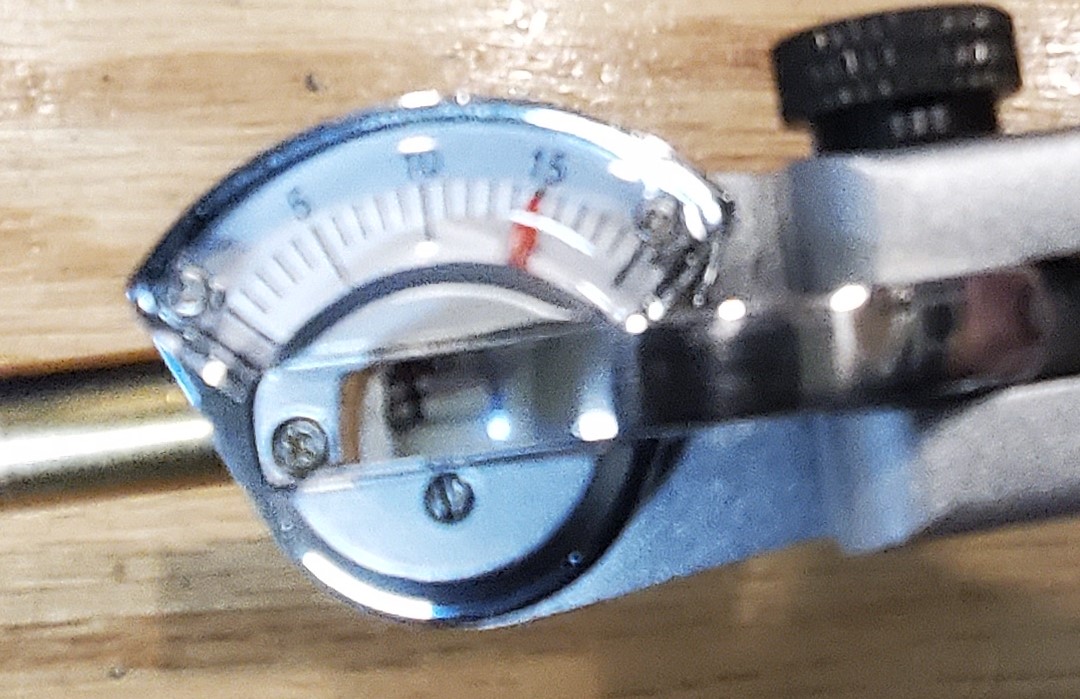

So why the change in seating pressure and the change in consistency of seating pressure?
I don’t run gauges but as my brass ages, I have to fiddle with the dial on the seater to get a consistent depth to Ogive. I usually will mark a range with pieces of blue tape and seat 2-4 times to get the desired cbto within that range. I have come to fear that this seating multiply varied times is causing a variance in neck tensions.
After annealing, for at least the next couple of loadings, the variance is gone. I set the seater and run 100 pcs without changing it. The pressure that needs to be used is also less as the bullets seat outside (before) the blue tape range, so they are discarded. Now just one piece of tape.
Fyi: I do not lube the necks as I have found with graphite, it does little to nothing and worrying about one of those little ceramic balls making into a case and taking out my can is not worth it. It also seems that my sinuses are pretty sensitive to breathing that stuff.

When cases start out ( General rule of thumb ) they measure 100-120 HV in the Neck area ,as one moves down the case HV increases significantly until reaching the base , which again generally is over 200 HV . Firing a case increases HV in the neck primarily but also begins to increase in the shoulder as well . Hence the necessity to restore ductility .
Magnum cases along with Bore Burners , aka larger cases small projectile suffer the highest increase in HV . Powder charge and type also account for a % of increase as well . Hotter faster powders ,slower powder higher pressure all affect case measurements .
Hope that answers your questions .
Once fired Military 5.56X45mm and Brand New , OLD , F.N. 7.62X51mm cases and ammo respectfully .
Please NOTE discoloration on Brass ,even though they've obliviously been polished at the factory . Note WHERE the witness marks are as they travel down the case past the shoulder . All I can tell any of you is ; There's a reason it's done .
I clean MY Brass with an ultrasonic ,as it removes ALL debris oils carbon and leaves Brass naked . IF one spends enough time polishing their Brass , you can certainly diminish the witness mark but highly doubtful it will perform any better and will most certainly wear your Brass faster .
Ever polish a paint job ,until you've removed the pigment . Same principle one is removing oxidation and also some metal along with it .
Some people will try and dazzle you with BS ,while others simply present the FACTS as Science . I'll leave you to decide which is which .
Annealing experiments were conducted on a number of the cold worked specimens. Figures 5a and b show color etched images of the specimens cold reduced 50% and then annealed 30 minutes at 500 and 700°F. No difference in the microstructure is seen in the specimen held 30 minutes at 500°F while a very small amount of recrystallization is observed in the specimen held 30 minutes at 700°F. Figures 6a and b show color images of 50% cold reduced specimens held for 4 and 8 minutes at 800°F while Figures 6c and d show 50% cold reduced specimens held 15 and 30 minutes at 800°F. No change is observed after 4 minutes at 800°F, while a minor amount of recrystallization has occurred after 8 minutes. Holding specimens for 15 and 30 minutes at 800°F revealed partial recrystallization after 15 minutes and full recrystallization after 30 minutes. The grain structure is relatively fine but is not uniform in its distribution.

Ever measure shoulder set back ?. Does Your compartator gauge always read the same ?
Yes every single time with a SAC comparator. They maintain .001 deviation. Usually it is something like .0025-.003”
after firing rounds out of MY Gas guns gauging measurements varies on several spent cases . Yet MY chamber is the same dimension .
Yeah, I don’t conflate brass from “gas gun” with bolt guns w/ match chambers. But that’s me…….
I thought we were talking bolt guns here, so mea culpa…..

You've got this under control ,just be sure the necks are sufficiently softened so as to give consistent neck tension . After partial annealing sizing begins cold working once again ,which is a GOOD thing . I fire MY brass #3 times before partial annealing and have not seen any evidence presented which suggest ,it's more beneficial to do it every single firing . Yet admittedly I'm NOT BR shooting anymore ,so whatever works ,one should do it . (y)
Quiet Torch is a HOT torch . IF any of you have ever used Oxygen / Acetylene torch ,you know Oxy is for clearing melt but Acetylene is low pressure compared to Oxygen and light mixture is HOT .
Same principle with partial annealing torch ,Fine pin point flame aimed properly saves a shit load of fuel and does the job faster .

I started a thread on annealers mainly between QA and amp but haven't really got any feed back on the QA. How are you guys liking it and any info on them is appreciated
Without a hardness tester, you'd be hard pressed to tell a difference in the end result between any of them as long as the time to anneal is consistent, whether it's induction or flame. They're basically digitally controlled time cycle induction annealers, although AMP's time settings are predetermined and in the form of "codes."
The predetermined time settings (AMP) vs the you have to find the time settings yourself (Quick Annealer, Annie Annealer, homemade induction annealer, flame based annealer, etc) and it's whatever you feel comfortable with in terms of operation, and price is really what you need to figure out whether the product is right for you.
I like my QA, but I use it like a flame based annealer and I make sure I sort my brass before using it, so I completely ignore the case anomaly feature (one of the features QA advertises). Work flow, the QA is still faster than an AMP since it's just drop case in, wait for case to auto-eject, then drop another case. For hands free operations, out of box, flame based annealers with case hoppers/case feeders will be cheaper, but QA and AMP have add ons for that.
Reactions: Ex E6
The QA also has the feature to determine how long to anneal your case just like amp? I'm torn between the two. Flame like annealez seems faster but not sure want to deal with flame and setting up where the QA seems to be consistent time after time like amp
QA is manual time set method (watch neck glow) and then set time based off that, but the QA has a test/timer function on it so you don't need an external stopwatch to keep track of time. In test mode - first, turn off room light, then you hold the button down until case neck glows, then let go of the button (case auto ejects). Time will then be displayed.
Write that time down somewhere (I subtract 0.1 seconds to account for reaction time) so you know what time is for which brand/caliber case then manually set the time after that in the auto mode and off you go.
This is after you manually adjust anneal height. One of the features I like is the manual adjust height feature, so whether you bump shoulders 0.002" or 0.006" and your case is longer or shorter (fire formed vs almost fire formed), you can adjust the anneal zone so that it isn't lower than where you want it to be. Also beneficial because you don't need to buy pilots, so if you want to anneal a lot of different caliber cases, this QA is cheaper.
Reactions: biggershooter
