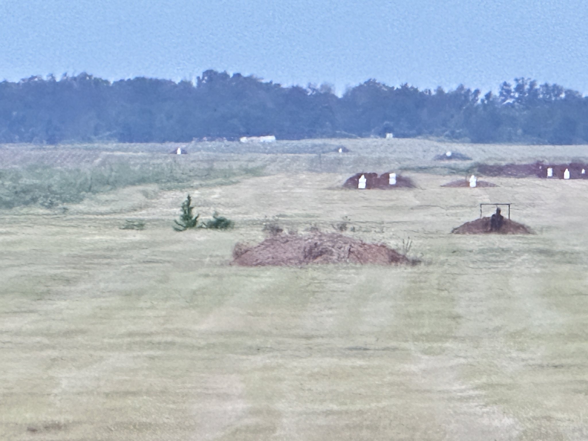

I went to a range in GA Arena Tactical and I shoot out to 2540 yards with my Barrett MRAD 338 NM and 300PRC. It was 37 mil hold over using the One shot adjustable base. 2890ft/s 300g bullet.
Still going 990 ft/s on impact. Not the most stable round but still doable.

I was there this past weekend, but only shooting a 7PRC using Berger 190s at 2920fps. Since I started out with really no dope other than 100 and 300 yards, I only got to regular hits on 1953y on Sunday morning. 21.9 mils at about 1048fps, so in transition. But that was good fun.
You must have been shooting from the shipping container tower to see the 2540. We were shooting under canopies on the right side and could see any targets past 2300y.
It was a a nice event.
