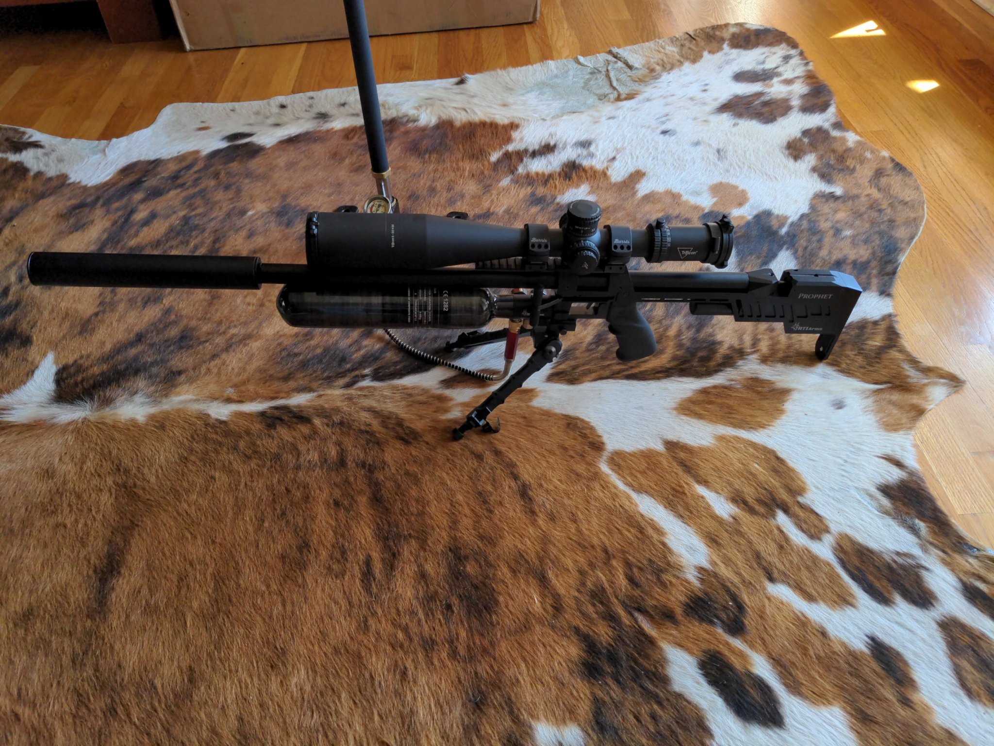

115 yds, even more reason for an airgun. Pick how much energy you want @ 115. Mine is an RTI Prophet Performance in .22. It's an 80 ft/lb gun, but is optimized with a slower twist barrel for pellets instead of slugs, which have worse BC and might not be enough energy at 115. An FX in .25 with a slug liner would probably be enough. Hatsan if you're on a budget. Just go up in caliber if you want more energy - the cost will be shots/fill and the difference in projectile cost. Here's my little .22 that shoots right with my Tikka 22lr.
It's not a firearm so no permit / license needed for the suppressor. Does NY State regulate non-firearms?

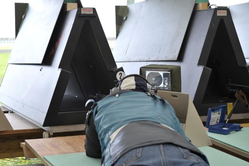

If you're regularly shooting from stationary position, ie balcony or blind, you could build a "shooting tunnel". Used with a muzzle brake, even a half decent one will lower the noise considerably downrange.
I prototyped one with some 15 inch pipe, 6ft long and wrapped it with some acoustic wall insulation, and wrapped again with chicken wire. Looks like absolute dogshit but made a 300wm sound like a 223.
It fell apart pretty quickly though but proof of concept was there and I'm drawing up something that will take that sound level down to rimfire level.
(Why not suppressor? My overlords/nanny says no. But this has its advantages too. I can sample/test any rifle without attaching a supp.)
Love this idea, and I mostly shoot from a seated position, often in a blind. Of course I cannot attach any kind of muzzle device, in fact I cannot have barrel threads accessible. But if I can build some sort of box to shoot through, which won't immediately catch on fire from the muzzle flash, then I'd certainly give that a go
I drew inspiration from this. I'm actually thinking of incorporating a magnetospeed in there as most of my centerfire use on my range is just data collection and development.
I would line the areas where the muzzle ports are with some corrugated roof sheets.
I also found that placing a small wall (about 6ftx6ft) about 10ft in front of the tunnel, with an appropriate size cutout, further reduces the noise downrange so I'll be making that out of cinder blocks.
