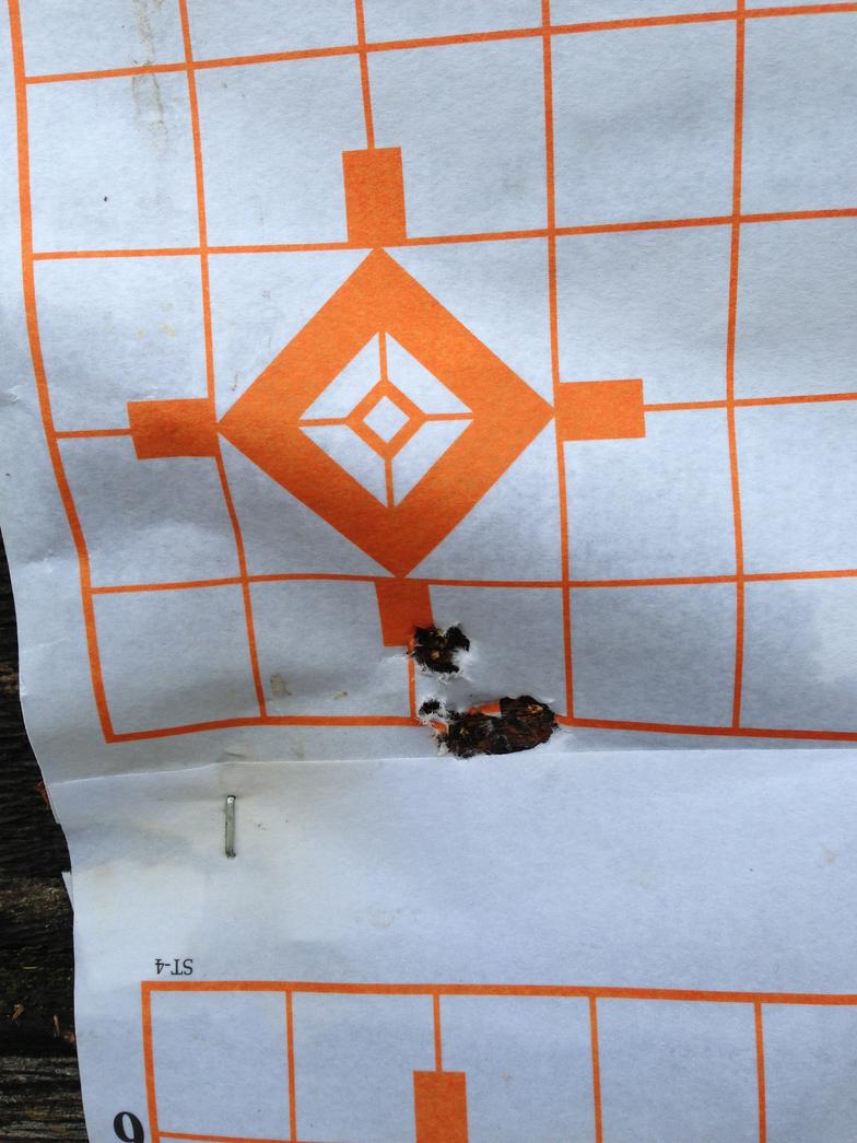

I had a chance to shoot my recent LR-308 build where I used a Rainier Ultra Match, .308, 18" with mid-gas. I utilized a Geissele SSA-E, PRS stock, and IOR 3-18 optic. As the rifle sits without loaded ammo it is 13.5 pounds. I was concerned about the barrel's performance due to a recent thread, but I believe it did well. After searching info on the .308 ultra match, I found many people who communicate, "their good", "they shoot sub-moa", "they shoot moa", but I thought I would post an image. Only had limited time, so I sighted the rifle/adjusted the gas block, and shot one group.
This rifle was shot by me from a bench at 100 yards, no wind, 85 degrees in the morning. I initially adjusted the Seekins gas block, and cycled FGMM 168 grain, Hornaday Super Performance 150 grain SST, and some 147 ball. With a few adjustments, all now cycle flawlessly. Disclaimer: I showed up at the range without my rear shooting bag so I fisted-up to support the PRS stock. I was not rock solid and had just a little bit of movement using my fist. I used a Harris 6-9 bipod and 18x on the IOR. I shot a 7 shot group waiting around 10 seconds between shots. (when you have a 20 round mag, 3 shot and 5 shot groups are not enough for me) The flyer was called on shot three. I did not put a ruler on it but it; but without the flyer, the Rainier Ultra Match shot around .75 moa. I truly believe with a rear bag this barrel will be closer to a .5 - .75 moa rifle with FGMM 168 grain. Further testing to come.

Looks like its doing pretty well! I have a similar setup to your rifle. What ammo did you shoot the above group with? Im assuming the 168gr GMM? I didnt get much performance from the 147gr surplus stuff, but didnt expect much from it either.
FWIW, I've had good results with 175gr SMK's with about 43.5gr of 8208 or Varget through my 18" RAUM barrel. Not sure if you're a reloader...
Im also from SW-MO and that target looks familiar...Andy Dalton? Busiek?
