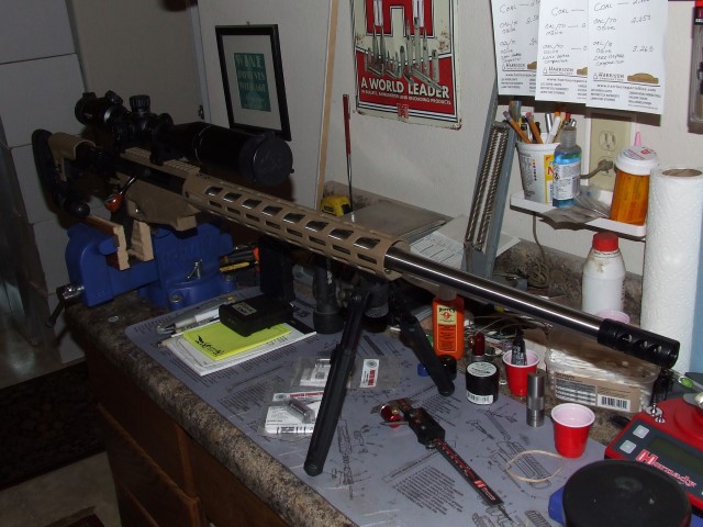

I just re-barreled my 6.5 RPR with a 27" S.S. Bartlein 9 - 8 Gain Twist 6.5cm barrel, chambered and finished by Greg at Southern Precision Rifle. What a work of art. Added a PVA Jet Blast muzzle brake, and looking forward to a range session soon. Very easy install with the right tools. Magpul wrench, Anarchy Outdoors RPR action wrench, go/ nogo gauges, and a good bench vice.......

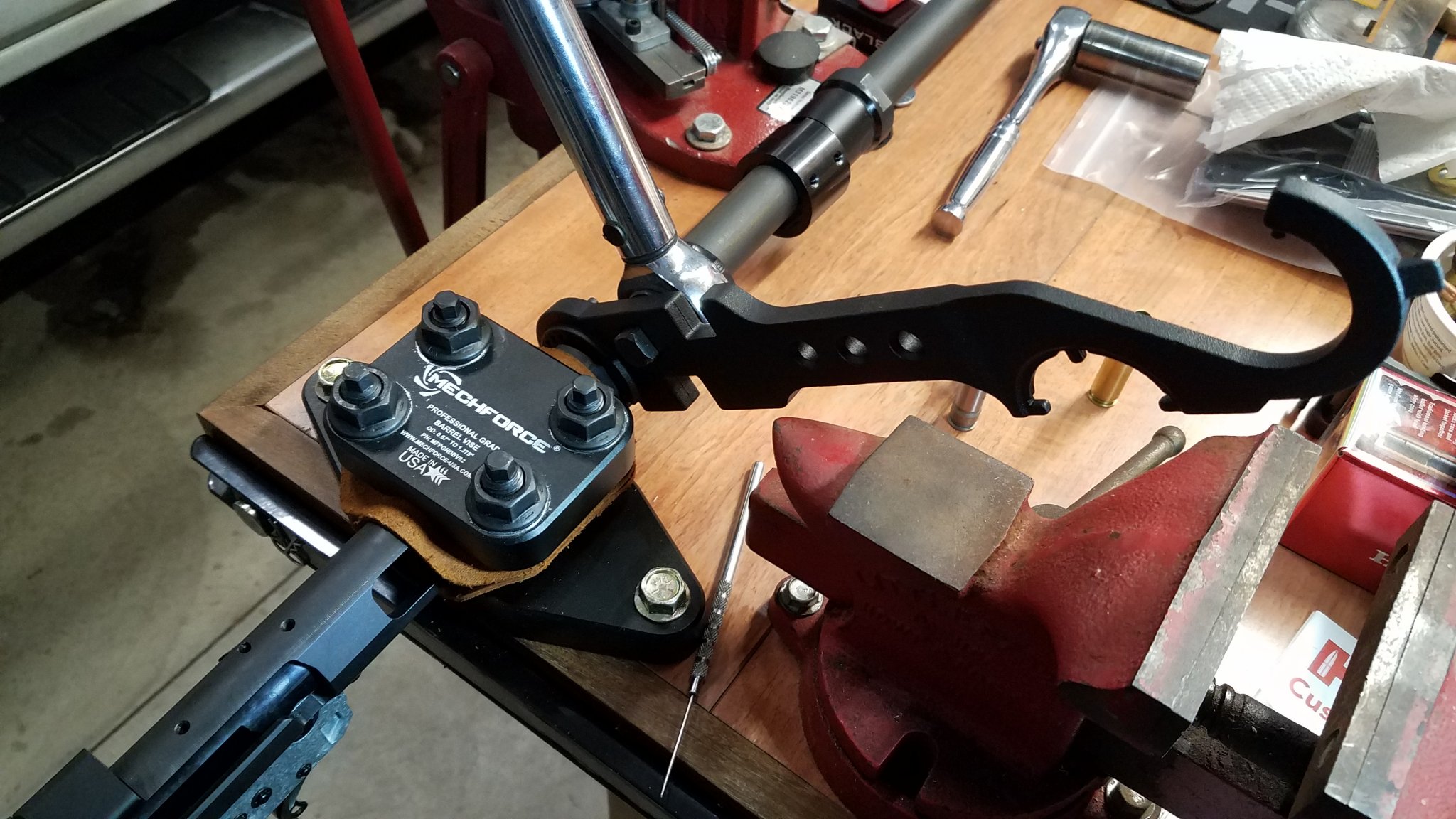

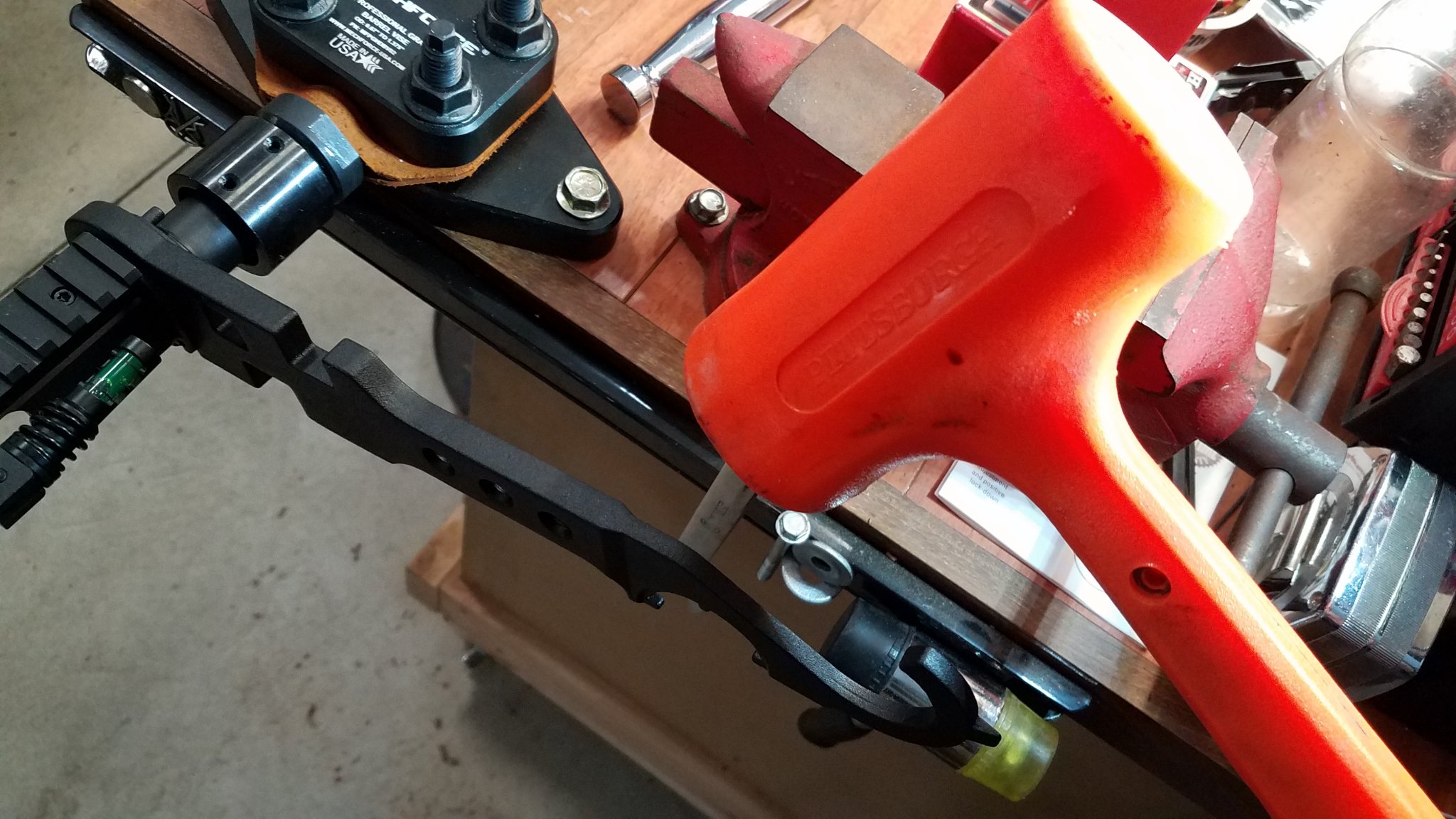

How much muscle did you need to break the bbl nut loose? I've read that that can be a b**** to get done.
LGS5CM,
I didn't need any muscle. I don't even own a barrel vise. I put the Anarchy Outdoors action wrench in my bench vise slid the action of the RPR onto the action wrench and my Magpul armorer's wrench on the RPR nut and tapped the wrench twice very moderately with a 16oz hammer and the nut loosened. Blunt impact force always wins the day over constant pressure.
