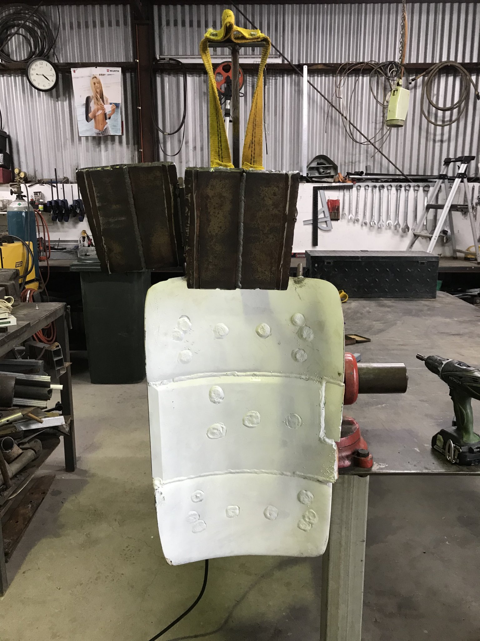

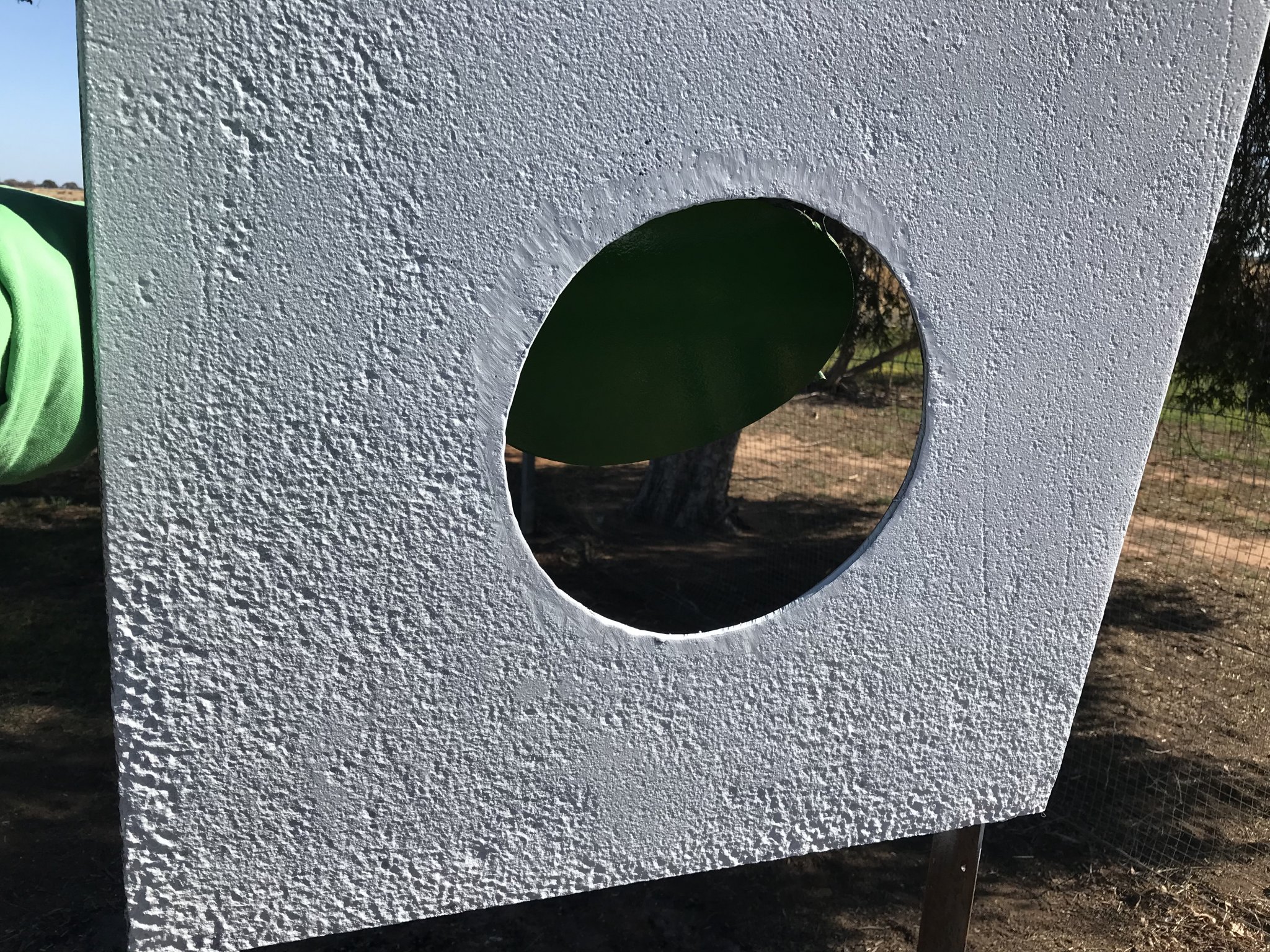

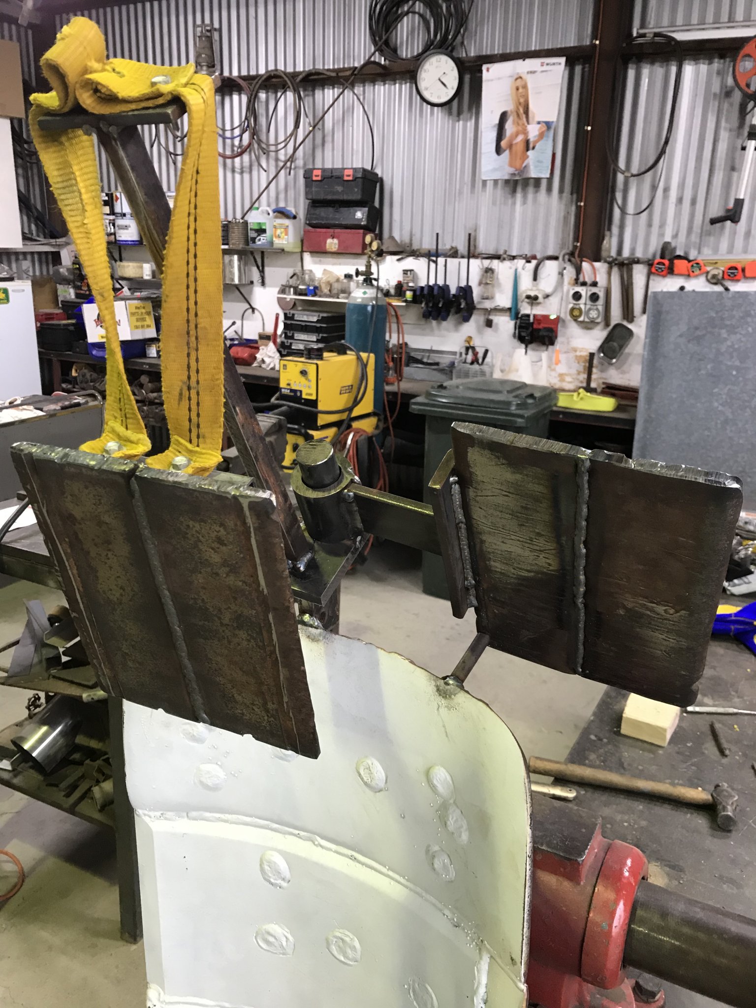

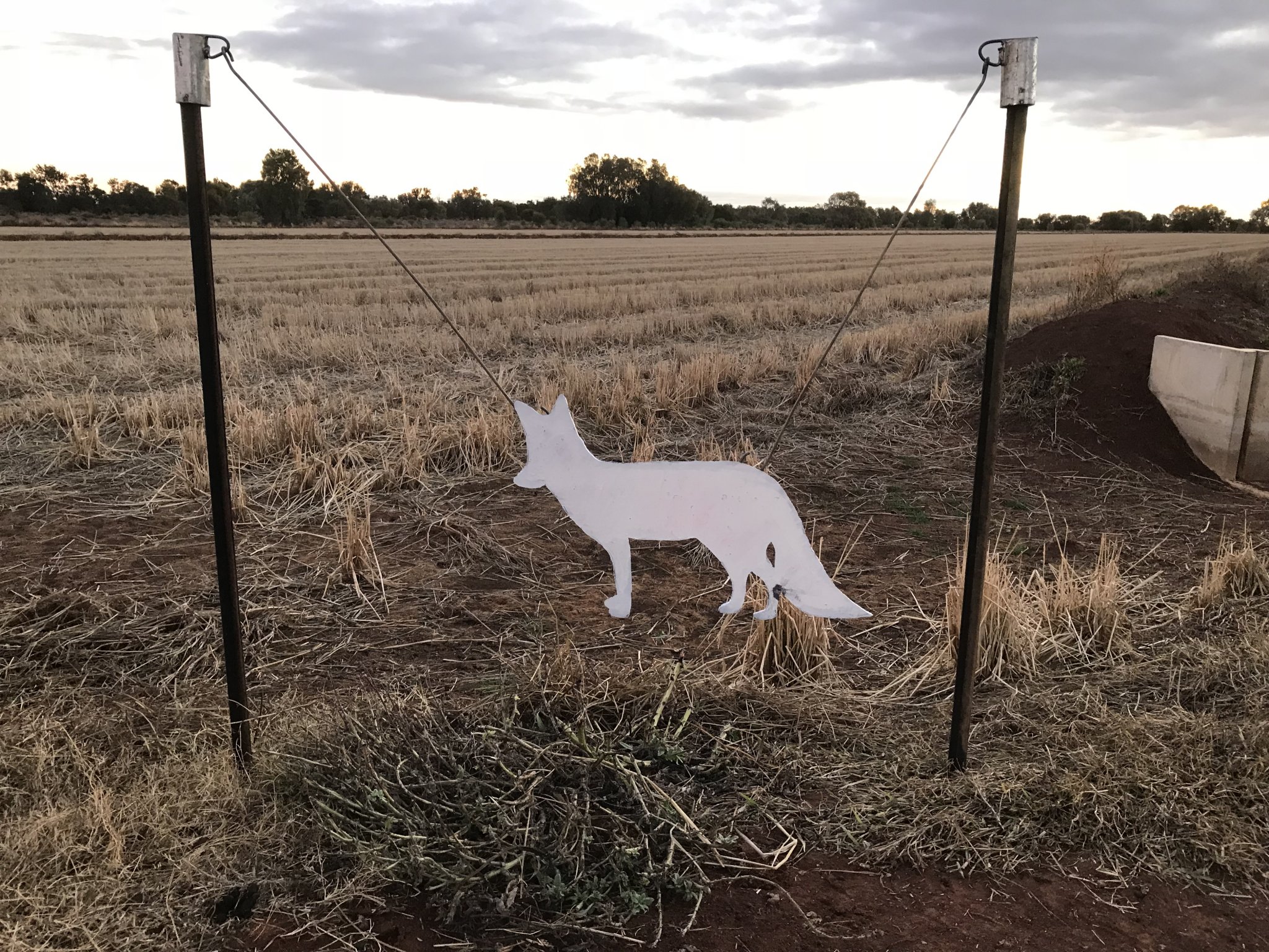

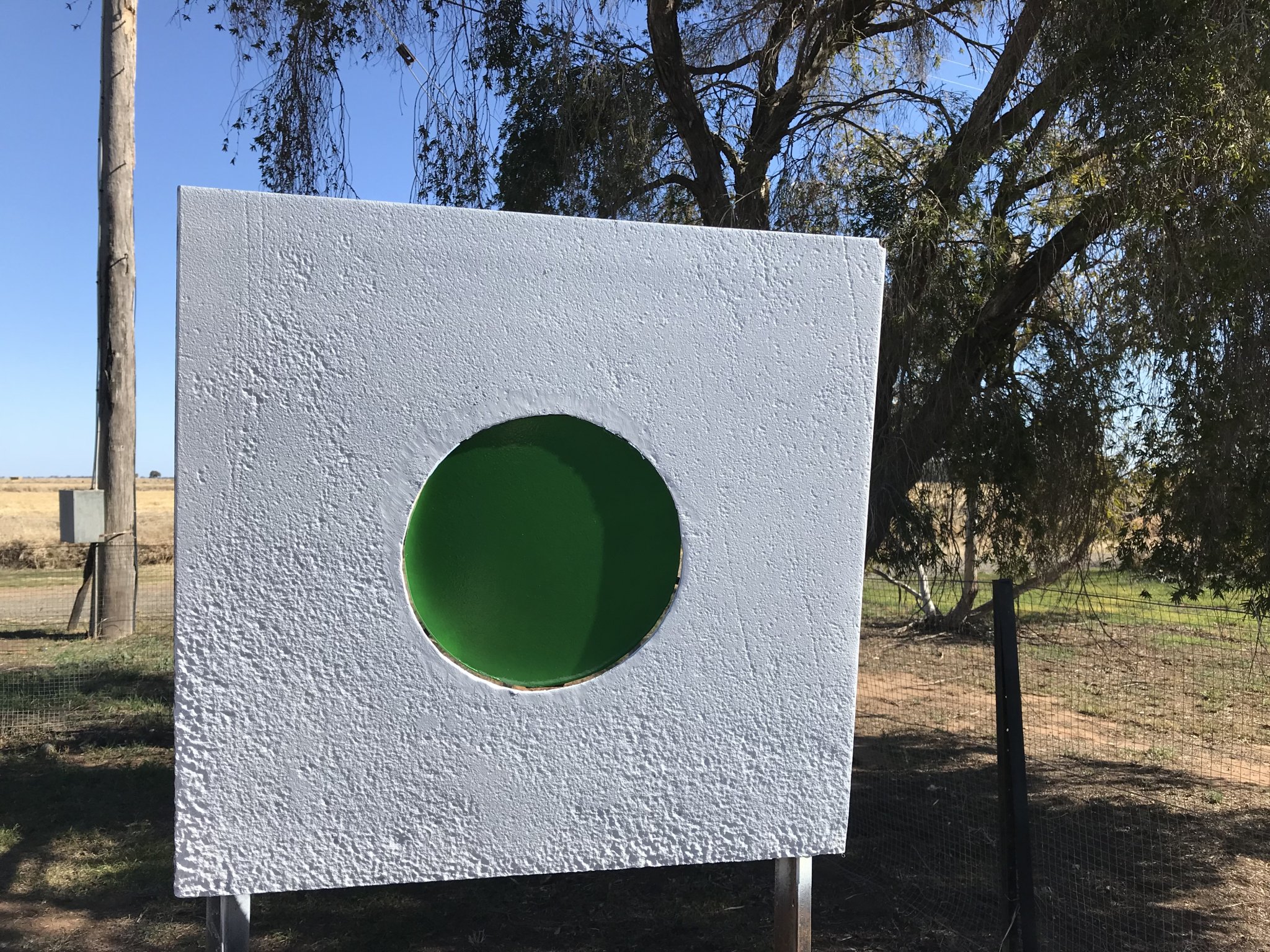

Here are a few I have made, the fox and bullseye flapper are mild steel and ok to shoot out past 500m with my 243win, the bullseye flap is attached by bolts and a rubber strap, it mounts on posts on a slight angle to ensure the flapper resets into its hole. The hostage target is made from road grader mouldboards and cutting edges so is hardened steel. 018C281F-2BD9-465F-A1E8-3B6773733CC0.jpeg08FB302A-94F8-49F7-BF86-37D91CA0012E.jpegF243A908-7C56-4A6E-B6AF-D95F9A69455A.jpeg1D34A1C3-4C74-4AF6-ABB9-94DC9254329B.jpeg4ECBFE7F-28E7-4DDB-8C85-0242D8E5E031.jpeg

Here are a few I have made, the fox and bullseye flapper are mild steel and ok to shoot out past 500m with my 243win, the bullseye flap is attached by bolts and a rubber strap, it mounts on posts on a slight angle to ensure the flapper resets into its hole. The hostage target is made from road grader mouldboards and cutting edges so is hardened steel. View attachment 7050607View attachment 7050603View attachment 7050604View attachment 7050605View attachment 7050606
That's the ticket for me right there

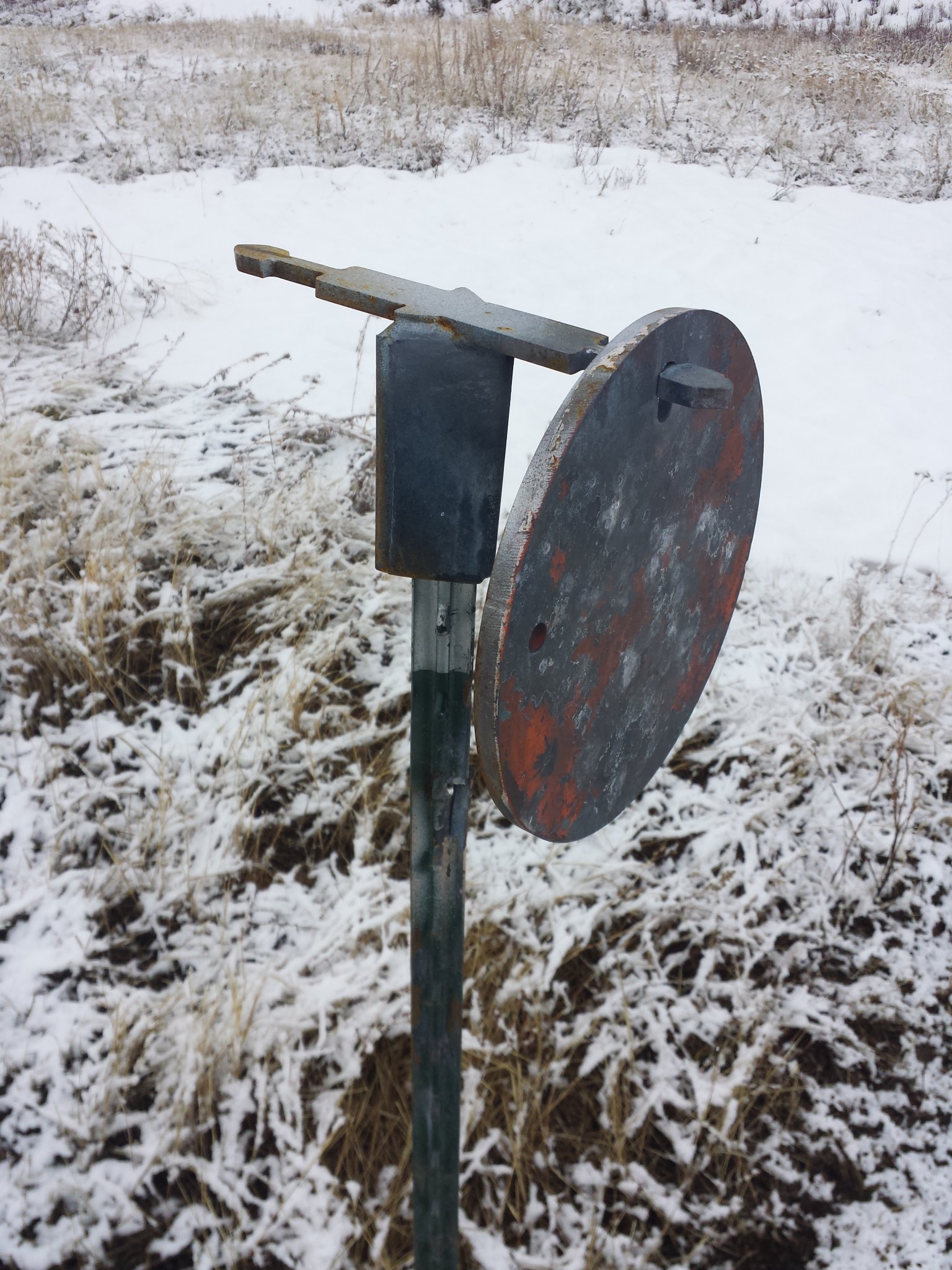

Don't know who made this target that showed up at our range one day.
All you need is a place to drive a T post. Really like the plates oval slot that keeps the plate in place yet keeps it loose. Harmonics and movement give great feedback. One of the best targets I've seen yet it couldn't be simpler.
