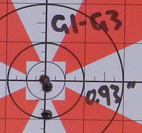

This one is still in development. Last year the only powder I could find was Norma 202, I got several pounds. Not a lot of data on it but the 700 seems to like it:
Lapua once-fired
Fed 210
178 AMAX
N202 41.4
2.883 COAL
Velocities (per prochrono) were 2534, 2564, 2569...I don't think this is consistent enough? Wondering if the low shot is the slow one?
1/4 MOA at 380 yards (pic: G1-G3)
I will try to validate this load with multiple 5-shot groups and post updates

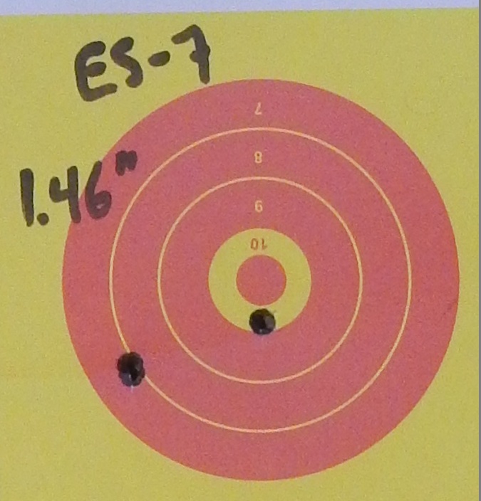

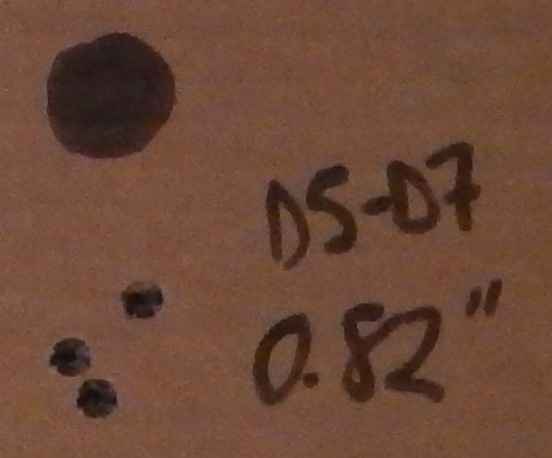

More Norma 202/178 AMAX development (still under construction):
FGMM cases
210 primers
N202 41.9
178 AMAX
2.882 COAL
Prochrono velocities: 2599, 2619, 2624
.22 MOA at 380 yards
pic: D5-7

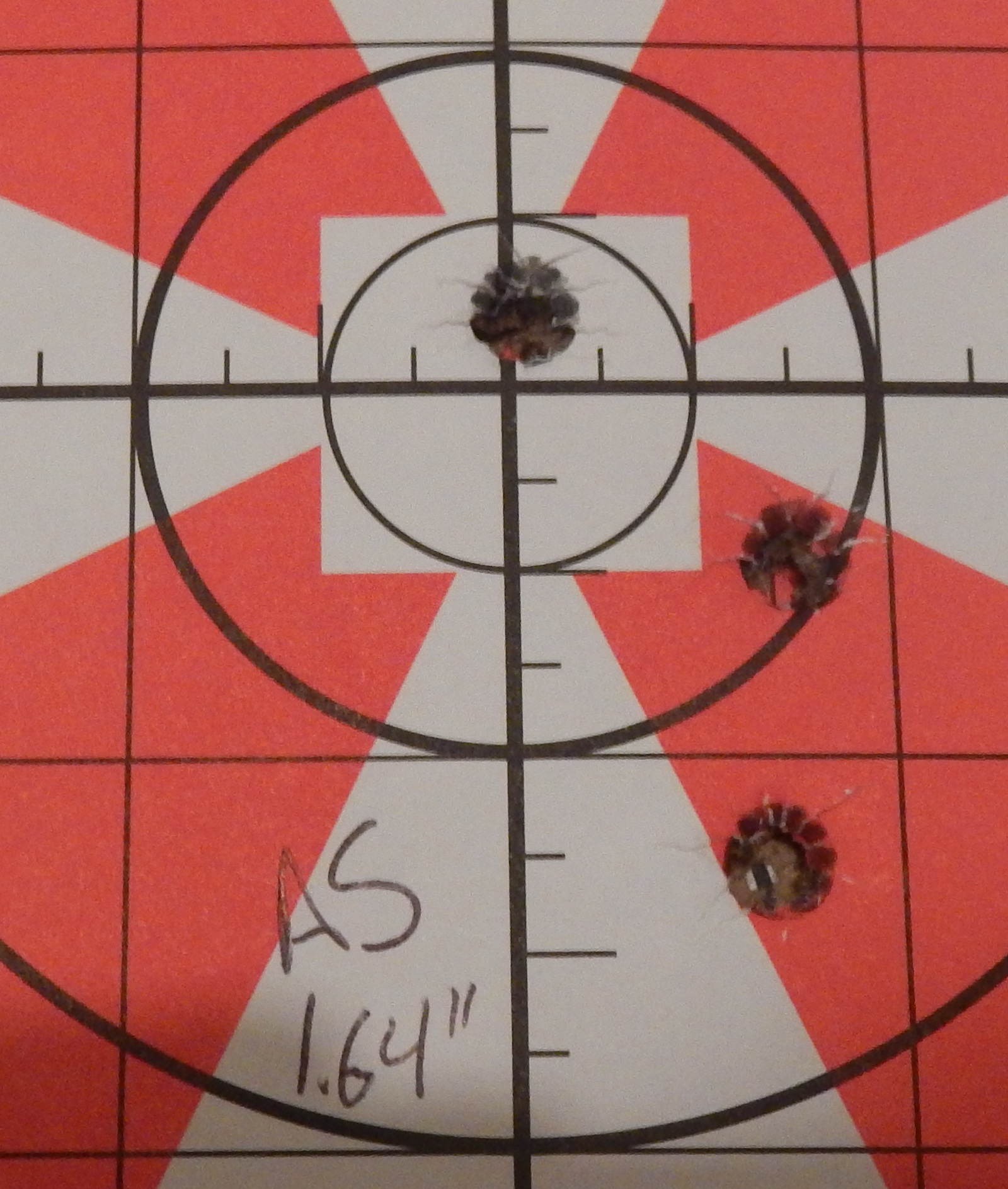

42.0 gr
2.882 COAL
m/v 2604, 2609, 2624
.38 MOA at 380 yards
pic: E5-E7

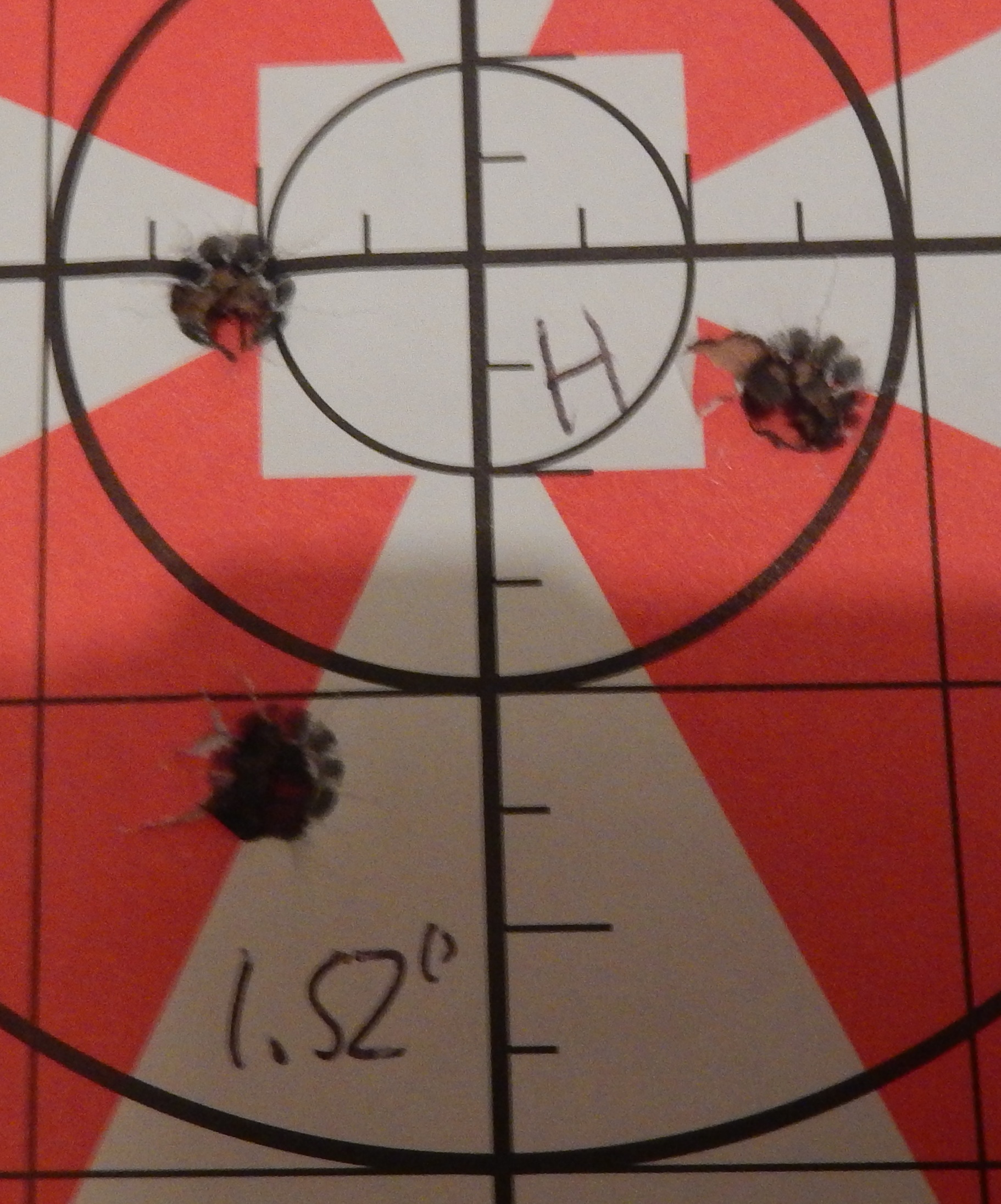

42.0 gr
2.90 COAL
velocities unknown
.4 MOA at 380
pics: H, A5
Will try to validate the 41.6-42.0 node with GMM/FC cases

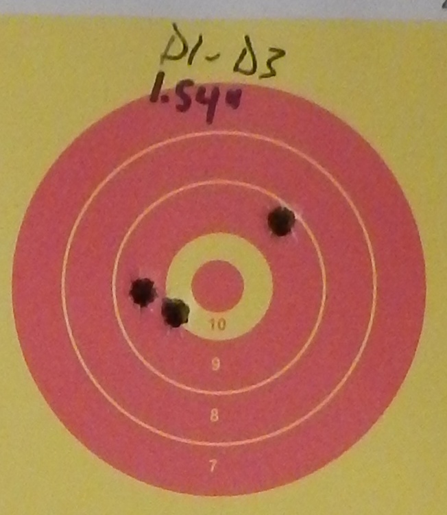

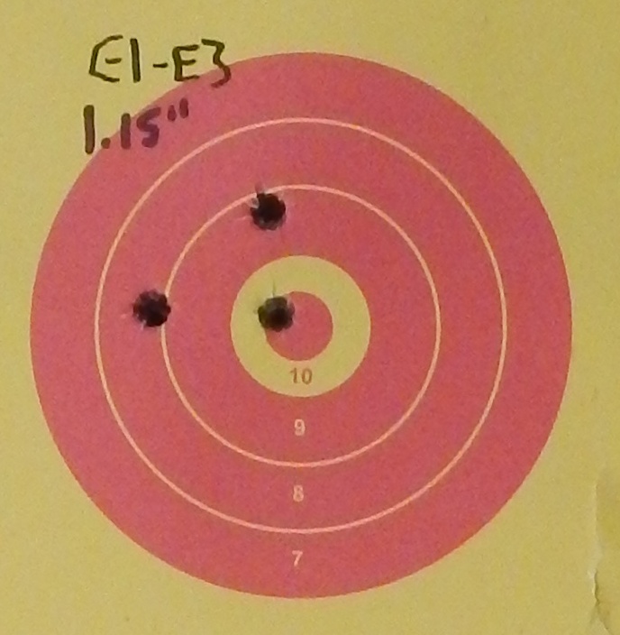

Had to share a good one from doctordoctor...my only complaint is that the 4064 stunk like a fart every time I shot. My buddy beside me said it "smells like dog shit" lol
43.1gr 4064
175 SMK
Fed 210
new Lapua
I worked up from 42.5 (not a great group, could have been me) but got .42 MOA at 42.7, .41 MOA at 42.9 and .30 MOA at the recommended 43.1. Right on!
I seated at 2.85 COAL.
Pics: E1-E3 is 380 yard group with 43.1gr, 1.15".
Prochrono put 43.1 MVs at 2650, 2677, 2677 (gotta get a magnetospeed)
D1-D3 is 42.9gr, 1.54" at 380. M/V 2661, 2629, 2656.
I might just call it good at 43.0
