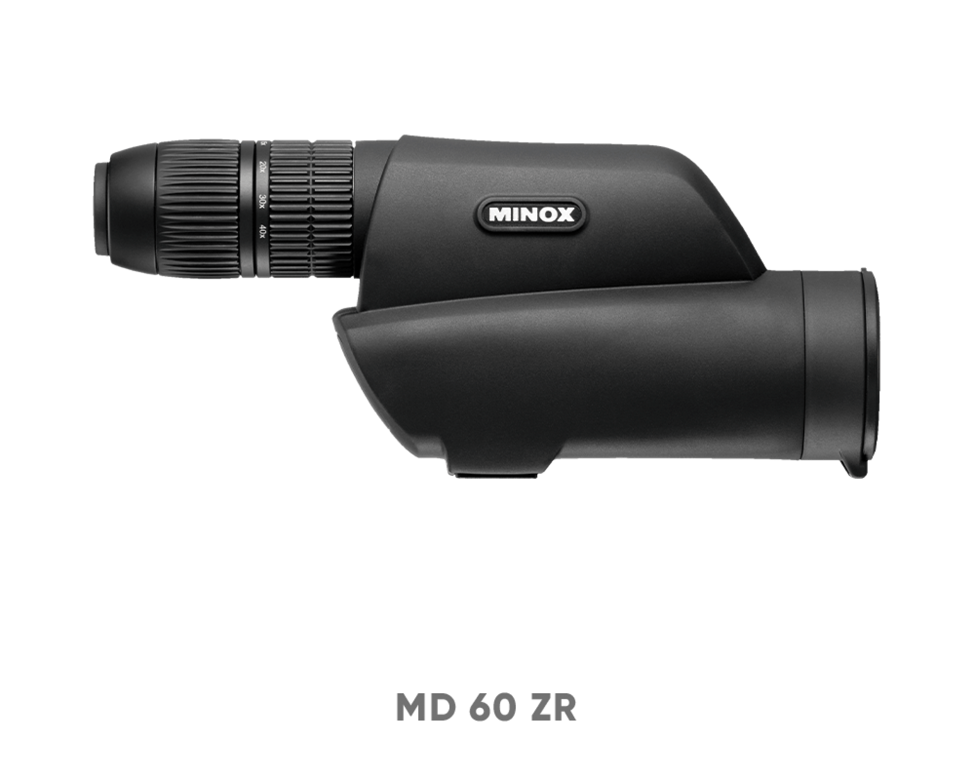

    I have a Minox MD 60 ZR (12-40x60) with MR2-S reticle and it's very good optical instrument, one you cannot go wrong with.
