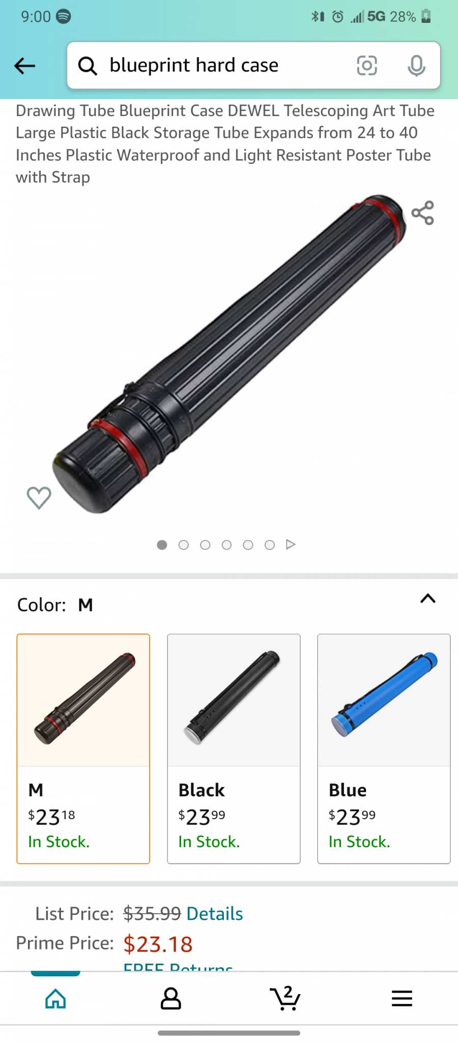

I haven't found the need for a hard case for a barrel but i imagine you could use a blueprint hard case you can find them pretty cheep on amazon
