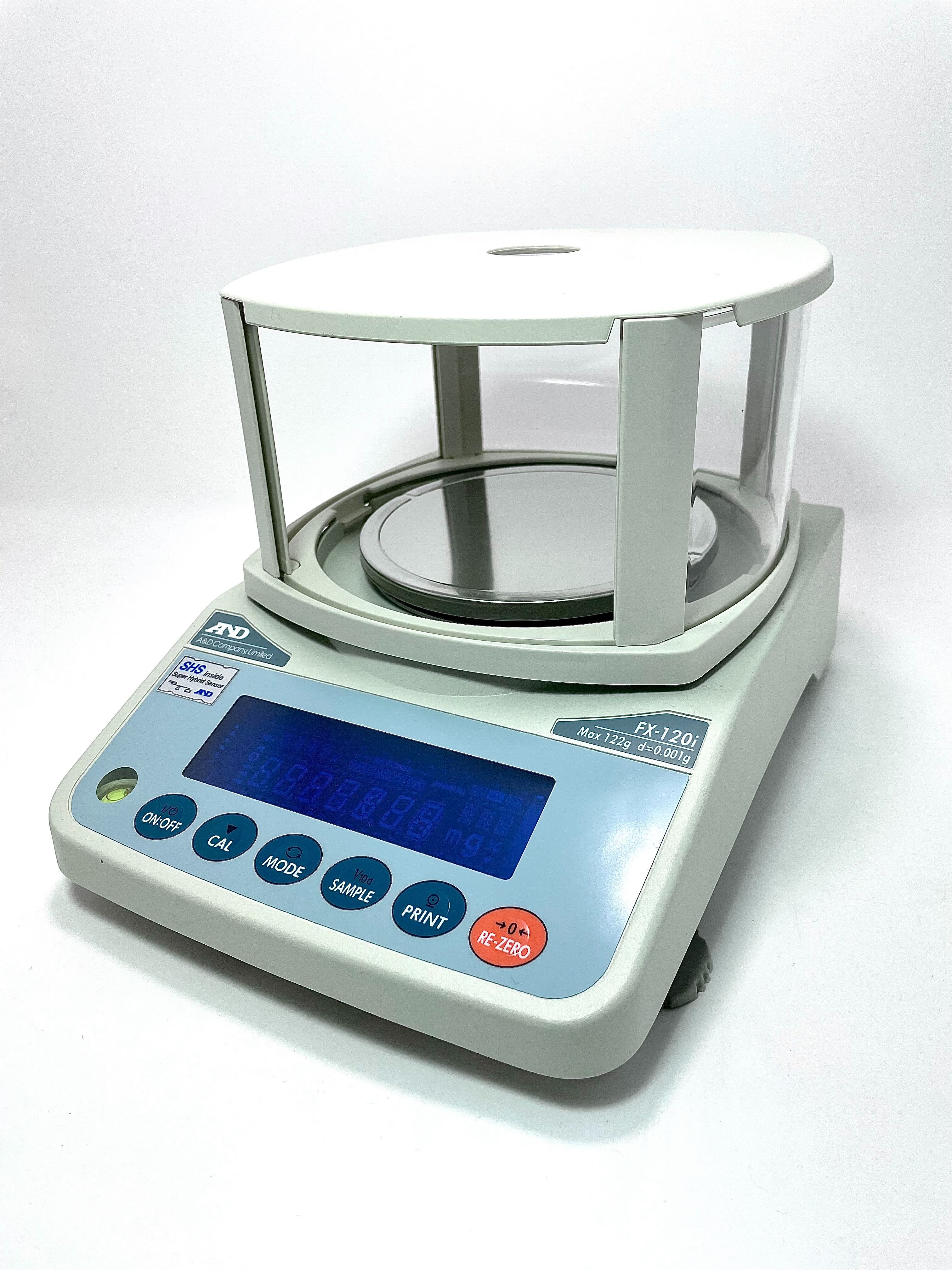

    I have been looking to get a new digital scale. I have had the original RCBS digital scale since sometime in the early 1990's. I am starting to question its accuracy. I been looking and I don't think I have to spend a lot of money to get something accurate. I been looking at this but looking for first hand knowledge about the company and scale before I buy. I would entertain other suggestions too as long as the price isn't over $250.
    Generally speaking, you are fighting an uphill battle regarding getting first hand experience on scales like that. The first says it uses a load cell and the second doesn't specify what technology it uses. My guess, it's also a load cell based system. If your doubting your current load cell system, why get another that is likely to have the same issues? I have never heard of either brand, but that is just me.
    Your upper end of your price scale is right at the threshold for something like an A&D 120 which has many advantages. It uses force restorative technology, there is aftermarket support for it, be it Area 419 accessories or a full blown Autotricker setup and lastly the community knows the A&D scale, so you will find help available for it. Most who are willing to spend your budget, spend just a bit more to go with a well known and understood solution.

    I found the A&D EJ-123 for $326.00 shipped, the FX-120i is $485 shipped.
