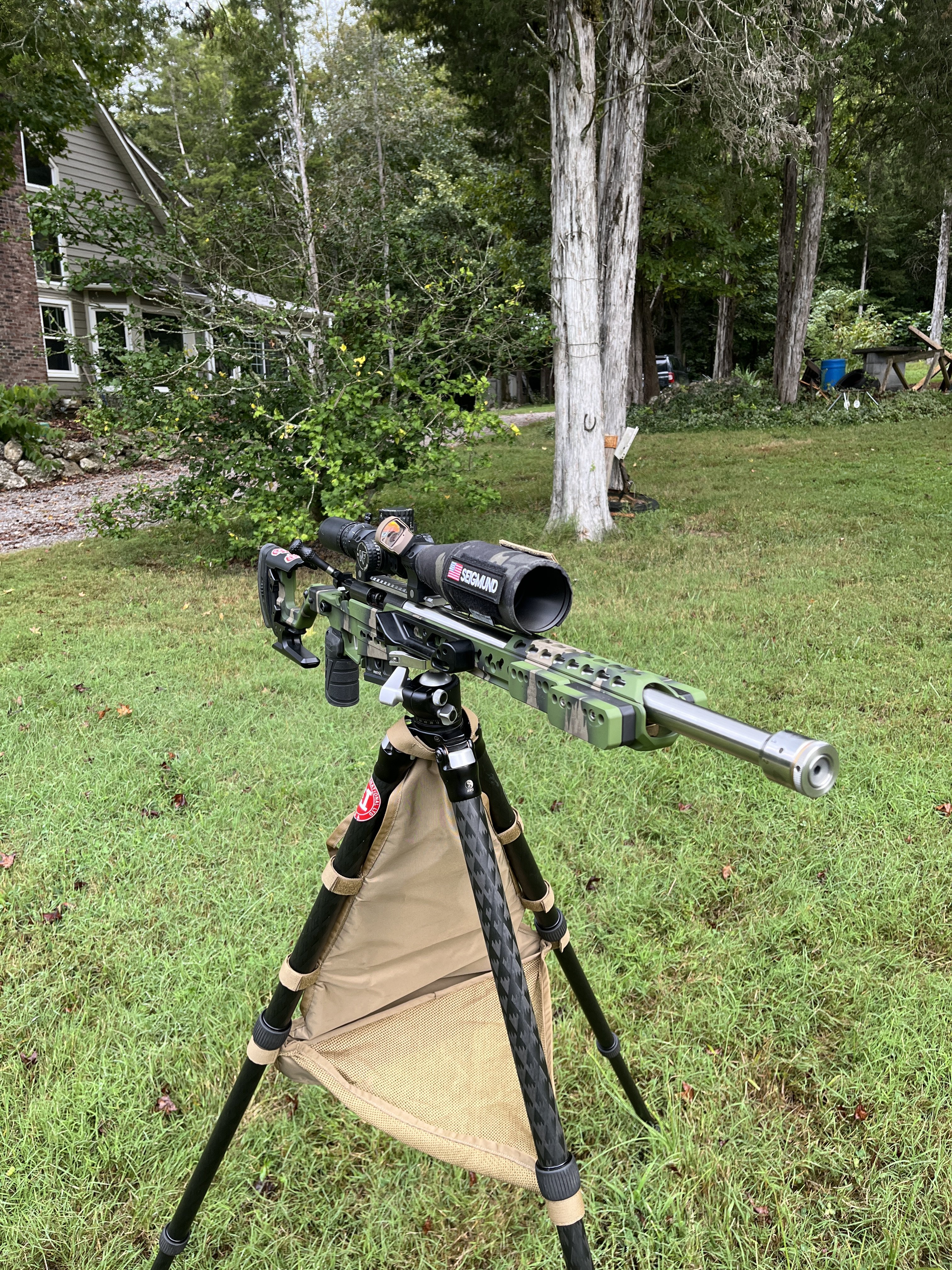

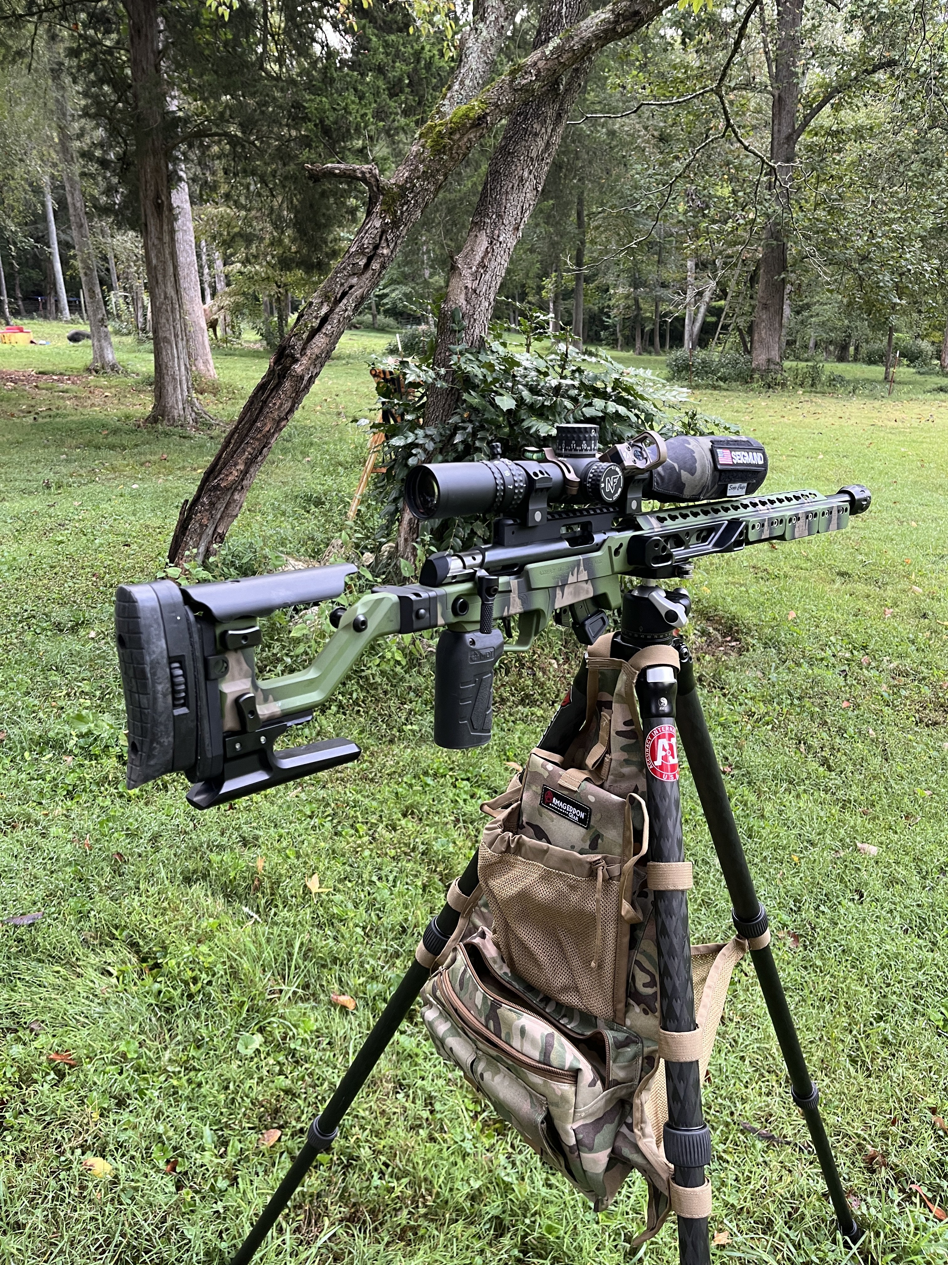

Vortex Razor red dot on top, in front of a elevation turret on a diving board.

Using a cheap red dot on top of a diving board on a MPA BA mount. Working great. Point the dot at the target and target is in scope field of view even at a higher power.

My red dot of choice is the Vortex Venom. Having the dot right over the top of the turret allows you to drop right down behind the scope. I do not like the offset ones personally as it it less natural for me to come in from the side. You can your optic at much higher power for spotting impacts when you use the dot.
Venom red dot on printed diving board to get the exact height I wanted. Not as needed in rimfire for my blind ass, but still there because it’s basically a clone of my dasher and I wanted it as close to the same as possible.
