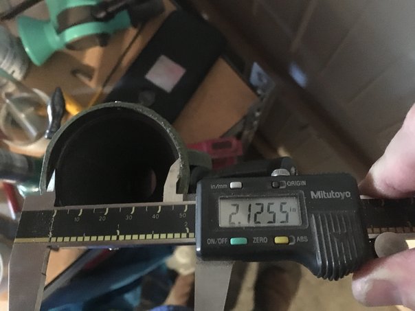

If you own a Redding 3 measure or one their 10X measures, I need a favor.
Can you measure the ID of the measure where the hopper would go in?

What is it they say, " a picture is worth a thousand words"?
It was hard to hold the calipers and take a picture at the same time but you get the idea.

Haha, I was a total dunce, it was too easy, thought you meant hopper size. My measurements mirror yours. If looking for replacement or larger hoppers, Midway sells them.

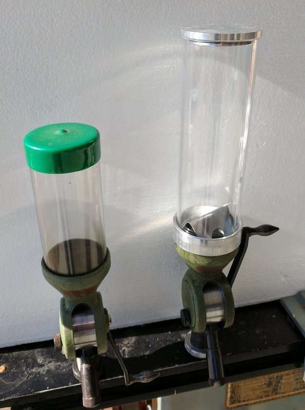

I make replacements using Pyrex instead of plastic and trying to verify the dimensions. I actually get a measurement of closer to 2.160 when I don't have to balance the camera. lol
Are you saying you get a measurement of 2.130" ?

i make replacements using pyrex instead of plastic and trying to verify the dimensions. I actually get a measurement of closer to 2.160 when i don't have to balance the camera. Lol
are you saying you get a measurement of 2.130" ?
2.134" 10x
2.132" br-30

2.150 (not on the screw side) to 2.153 (screw hole to screw hole) on 30BR with no movement - the original hopper tube is 2.145 - and put me down for one :)

Thank you guys for your help - it seems that Redding has made two different sizes.
