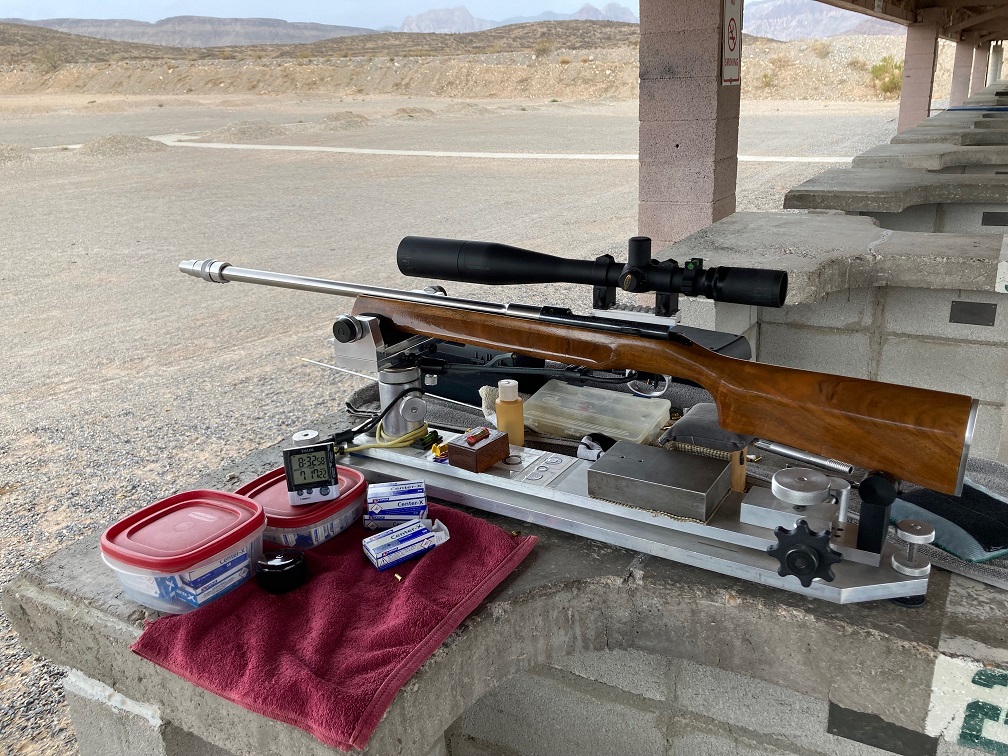

I'm shooting a Vudoo V22S., ARA Unlimited at 50yds. is my game. I'm not a world beater...just having fun. :)

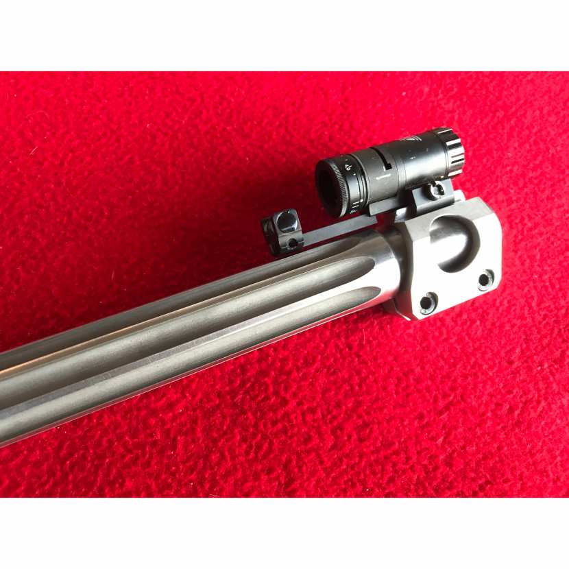

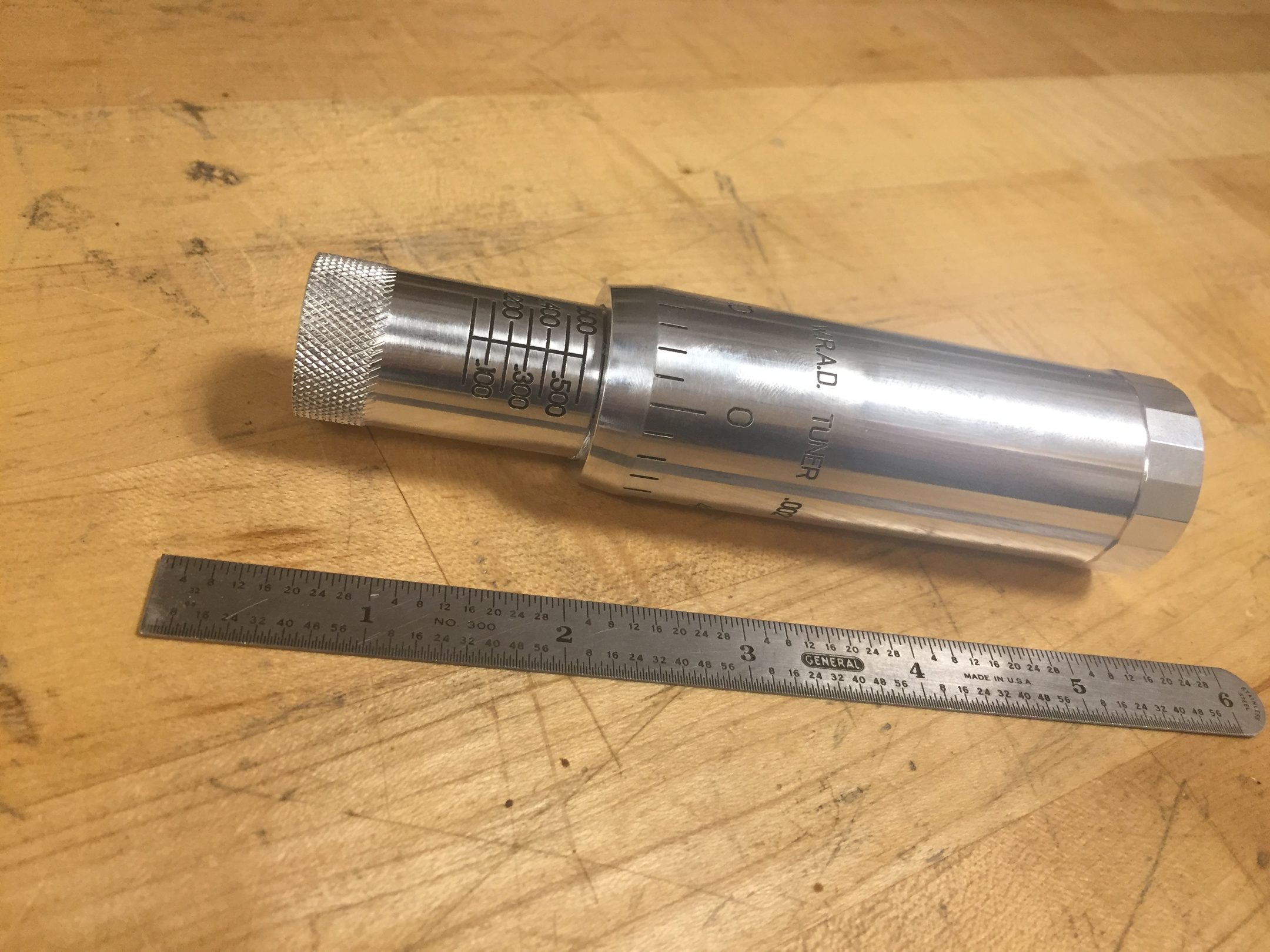

I shoot a rifle with a heavy reverse taper barrel. the best score RBA target is 250-22X shooting CX bought blind. I won 6 consecutive club championships with this very rifle. the tuner I have on it is a modified Harrell lightened to 4.25-oz. I assure you it does not dampen anything. it times the exit of the bullet, so it is near always at the top of the barrel rise.
