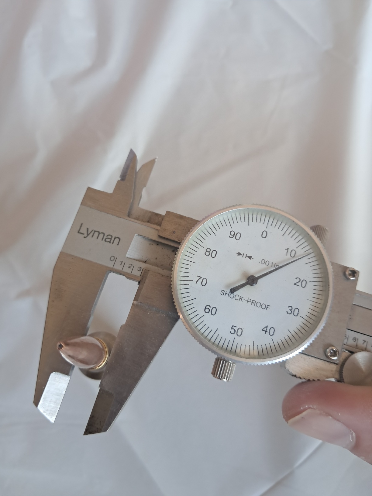

So long as the neck thickness is the same. I necked down 308 to 708 then had to turn the necks for clearance.
I suppose one could definitely end up that way, depending on reamer and perhaps brass thickness.
Zero issue with my Manson reamer at .319. My loaded rounds come to .313. Fired cases measure .318.
