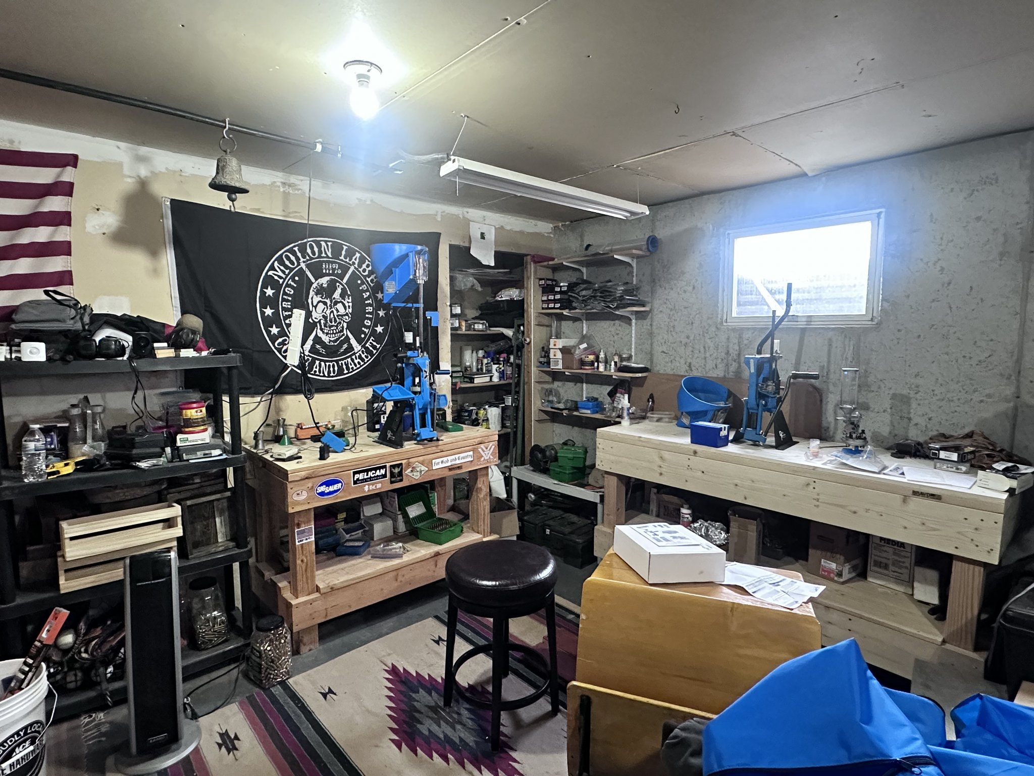

I am about to order a full 750 Setup with 2 toolheads per caliber to reload. Trying to make things easier quicker than now with the turret press. Bulletfeeder, case feeder and all the upgrades. Here is the proposed workflow.
1. Anneal with AMP.
2. Clean/Wet tumble with brass cleaner
3. Dry in dehydrator.
4. Lube brass then dump into Case Feeder
Brass prep Toolhead
1. FW Arms decapping Die
2. Size brass
3.Mandrel Brass
1. Clean Wet Tumble, then Dehydrate.
2. Run Brass through Henderson to Trim, Chamfer and Debur
3. Dump brass into case feeder
4. Dump bullets into bullet feeder
Loading/Prime Toolhead:
1. Prime.
2. Powder through Die to drop charge from Super Trickler
3. Seat Bullet
1. Mark Brass and put in container for match.
Any issues or thoughts on the process? I just ordered a 2nd super trickler to keep downtime at a minimum since that is my limiting factor with loading. Will probably upgrade to an autodrive down the road to make it even easier/faster, but want to flesh out process first.
