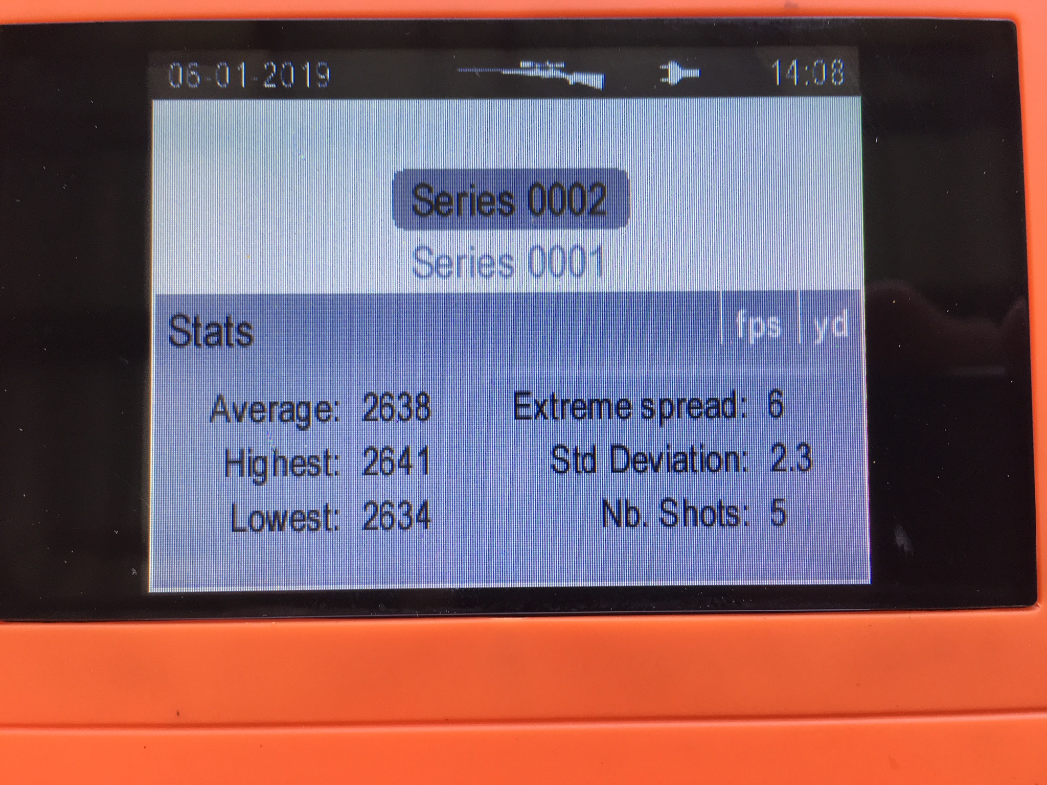

I am curious, did you chrono the loads? Between the BH and your crimp vs non crimp?
Not that a difference is always present for accuracy. But was the sd better on one or the other?

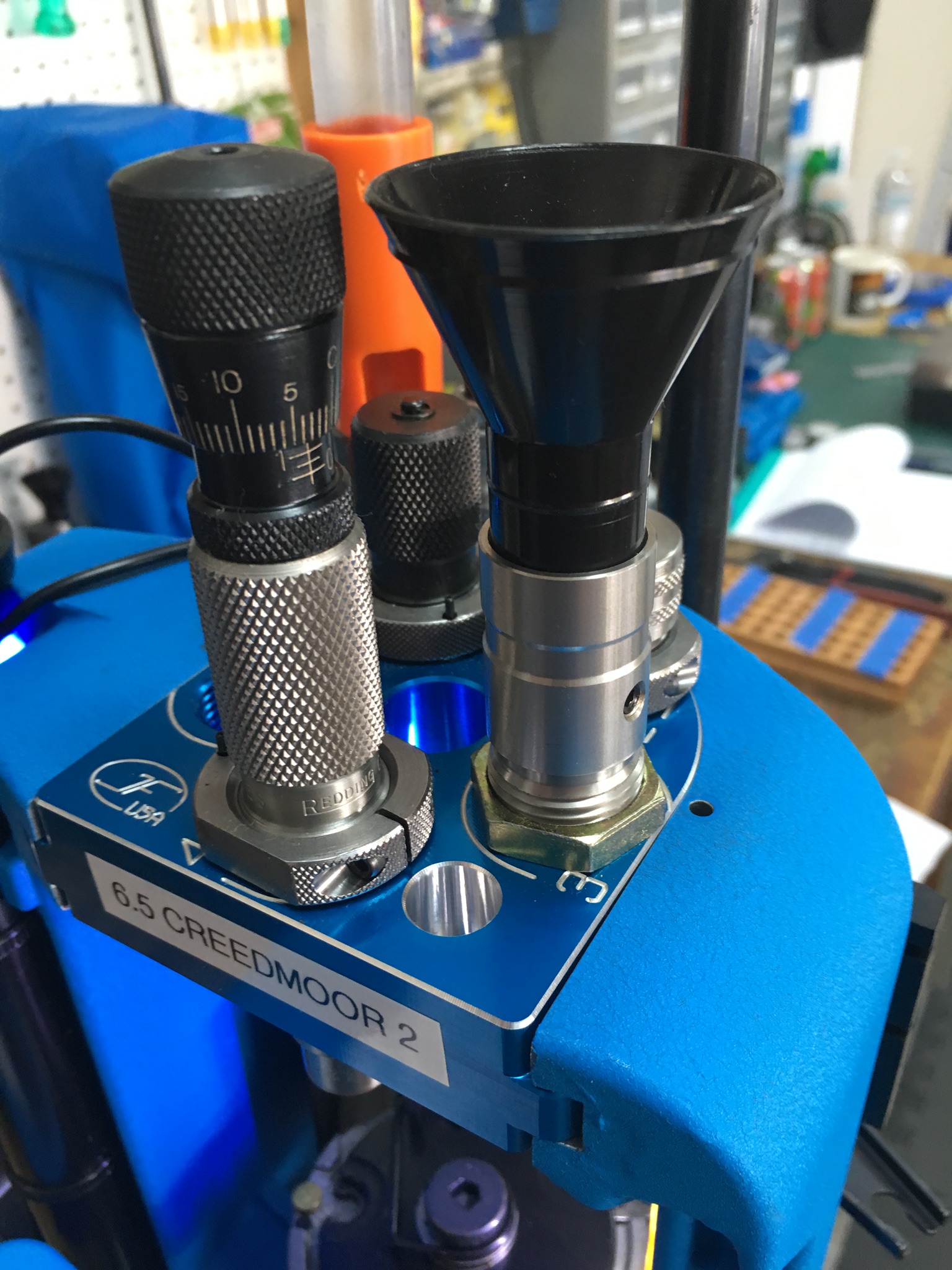

Years ago I was in the same boat, asking about reloading precision rifle on a Dillon 650, below is the process I’ve decided on….. for now. I’m always looking for ways to be more efficient with this process. Could this process be shortened some, probably, but I’ll include text below for each step explaining why I’ve settled on this setup. It seems like a lot but really it’s quite fast.
Feel free to substitute your own ideas etc., and we can all learn something.

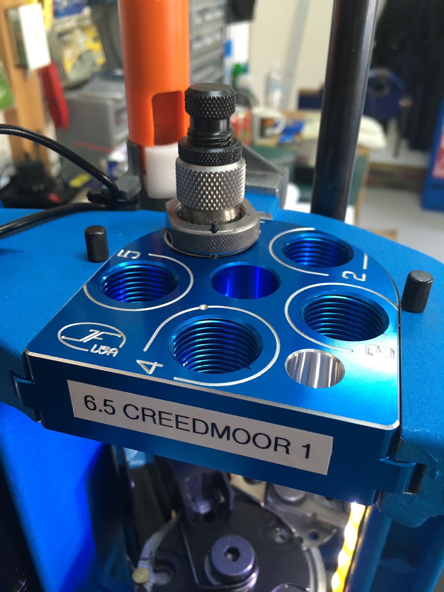

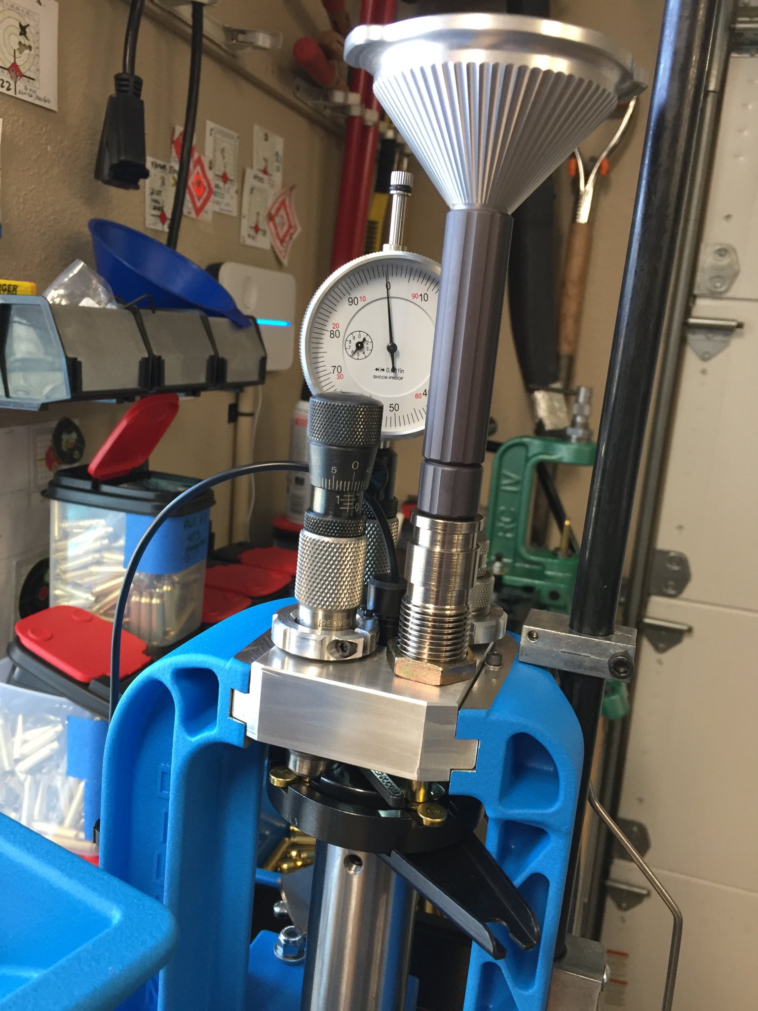

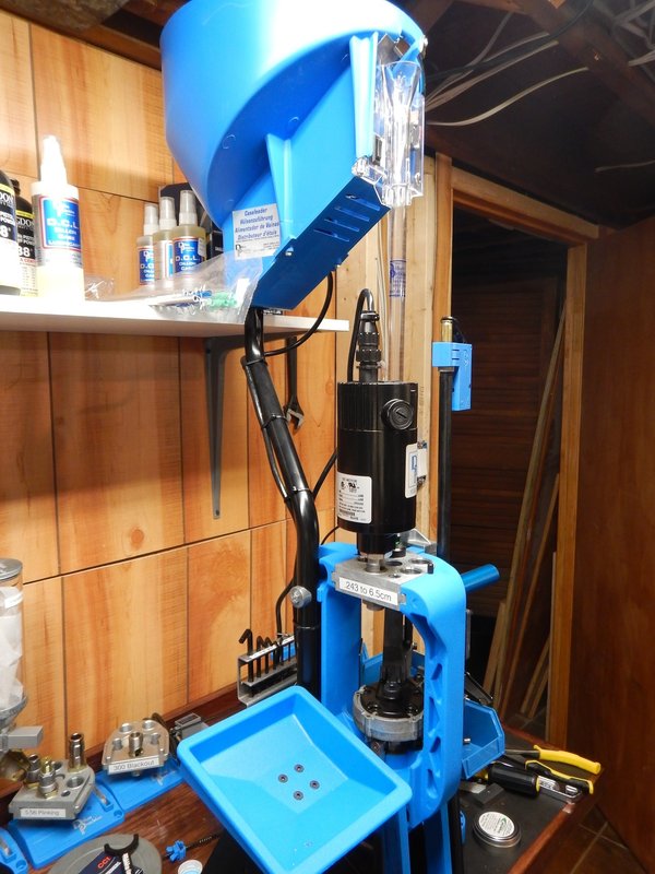

I did purchase 1 of the John Whidden Dillon 650 Floating Tool Heads, but then I decided to modify my own tool heads to float the dies so I never used the Whidden tool head (It’s for sale if anyone wants it). To modify your own tool heads you’ll need to go to your local hardware store and pick up some of those little roll pins, I think I got the 1/16” diameter pins. You will also need a drill and bit which is slightly larger than the pin diameter. I found the Hornady Die Lock Rings to work the best for me. I can make a separate write up if needed explaining more about the process if needed.
Someone above mentioned using the case feeder on the 650, hell ya use it, makes this so much faster! I couldn’t imagine not using it.
Also someone above mentioned using a bullet feeder. I have the Mr. Bullet Feeder for the 650 and use it for .223 and 9mm. I’ve thought about using it for the 6.5 Creedmoor but then decided NOT to use the bullet feeder because I didn’t want to take a chance of damaging any of the bullet points, I shoot Sierra 142 Match Kings, they are not plastic tipped. If I was shooting a plastic tipped bullet then yes I might use the bullet feeder, because it would speed things up just a tad, but then we add case flaring and flair removal into the mix.... The more I think about it, nope not going to go down that rabbit hole with precision rifle on the 650, it's so easy to just manually place a bullet.

Line 3: In tool head 1 position 1, Redding Universal Decap Die - The Lapua 6.5 Creedmoor cases I use have small rifle primers, the Redding universal decap die is designed to handle these small flash holes. Load up the case feeder and goto town… In my case, decaping 200 cases shouldn’t take you more than 10 minutes tops. (The reason I decap is sometimes the primers crater, thus preventing the cases to sit flush for the next step, annealing. They need to sit flush on the case heads).

Line 10: Now on the 650, I load up tool head 2, position 1 with a Redding Type S Full Length Bushing Die. Install your bushing of choice to set the desired neck tension, also setup the die to bump the shoulder if you want. I bump my shoulders .001”. For the bushing size, I use a bushing that yields .002” neck tension, meaning .002” smaller than the outside neck diameter of a loaded round. Load up the case feeder and resize them all...
Lines 11 - 14: nothing installed in the tool head 2 positions 2 – 5.
Line 15: At this point we have lubed and sized cases, we need to trim. Run the cases through your favorite trimmer. Personally I use a “Trim-It 2” which trims, chamfers, and debirs all in one step.
Line 16: Debir and chamfer if your trimmer doesn’t do that in the previous step. I skip this step because the Trim-It 2 in the previous step takes care of this.
Line 17: I throw the cases back into the tumbler with walnut for 1 hour to tumble off the case lube and clean any metal bits / pieces from the trimming process.
Line 18: We must separate the cases from the media. When we tumble the cases in the media separator there is a chance that the case mouths will get dented / dinged up in the tumbling process, we will address this later with tool head 3.
Line 19: Load up tool head 3, position 1 with a Redding universal decapping die –I use this to make sure the flash holes are not plugged with tumbling media or debris. Load the cases up in the case feeder.

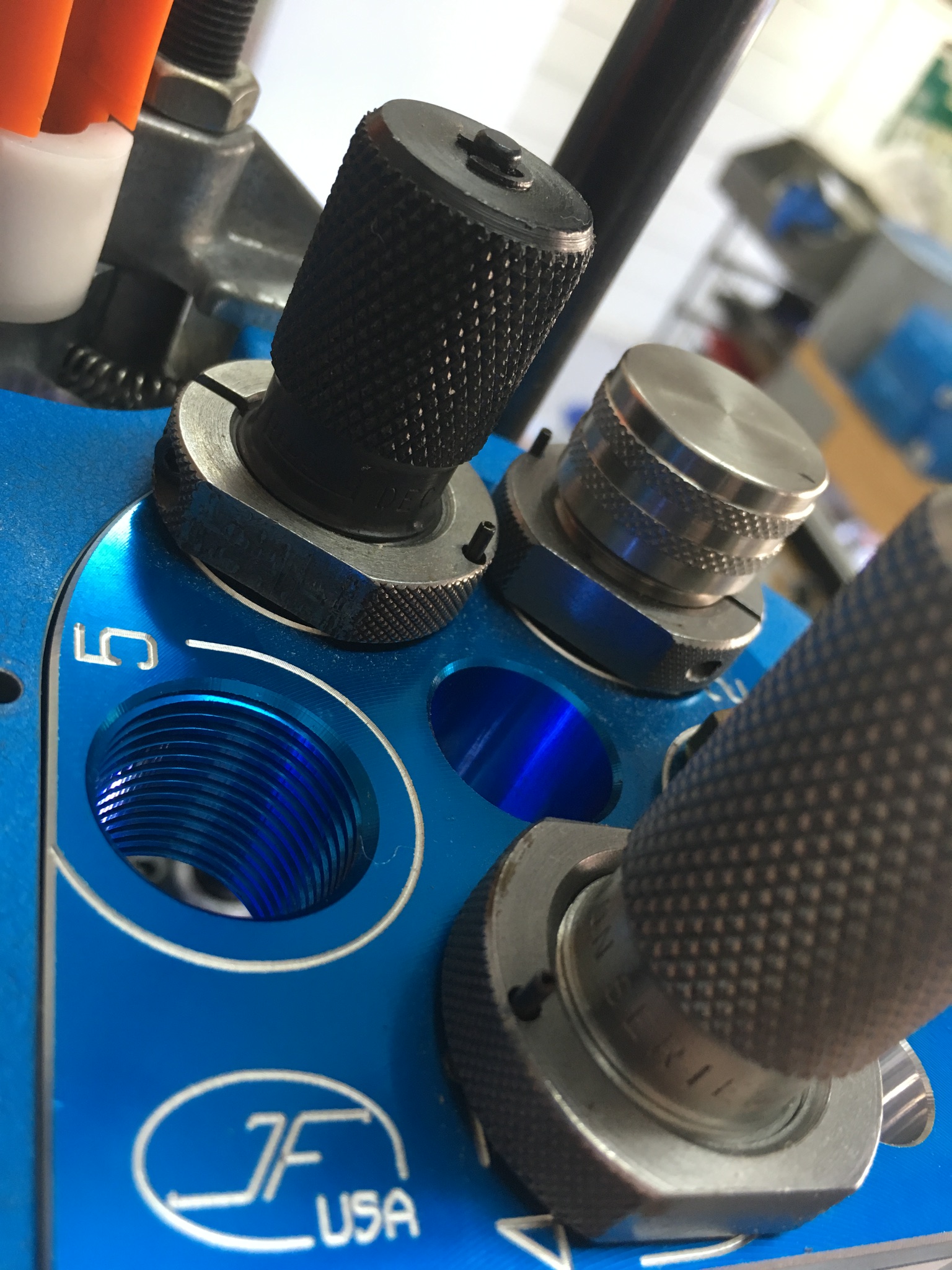

Line 20: Tool Head 3 position 2 - I install a Sinclair Mandrel & Die. This mandrel is .001” larger then the bushing size. Meaning we are going to expand the neck .001”, this gives us a finished neck tension of .001”. Remember when I said the case necks might get dinged up in the media separator (lines 2 & 18), this mandrel straightens out any dings. Here we also use the priming system on the Dillon 650, seat a primer.

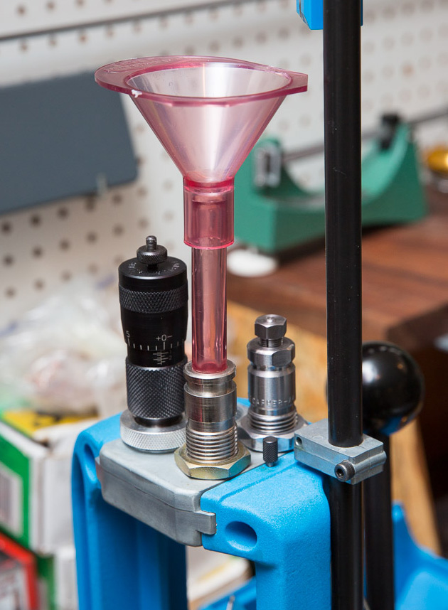

Line 21: Drop powder into the case. I use a Dillon powder die with funnel. Raise the 650’s ram, grab a test tube, flick off the tube cap with my thumb into a box, dump the powder in the powder die, and replace the tube into the rack.

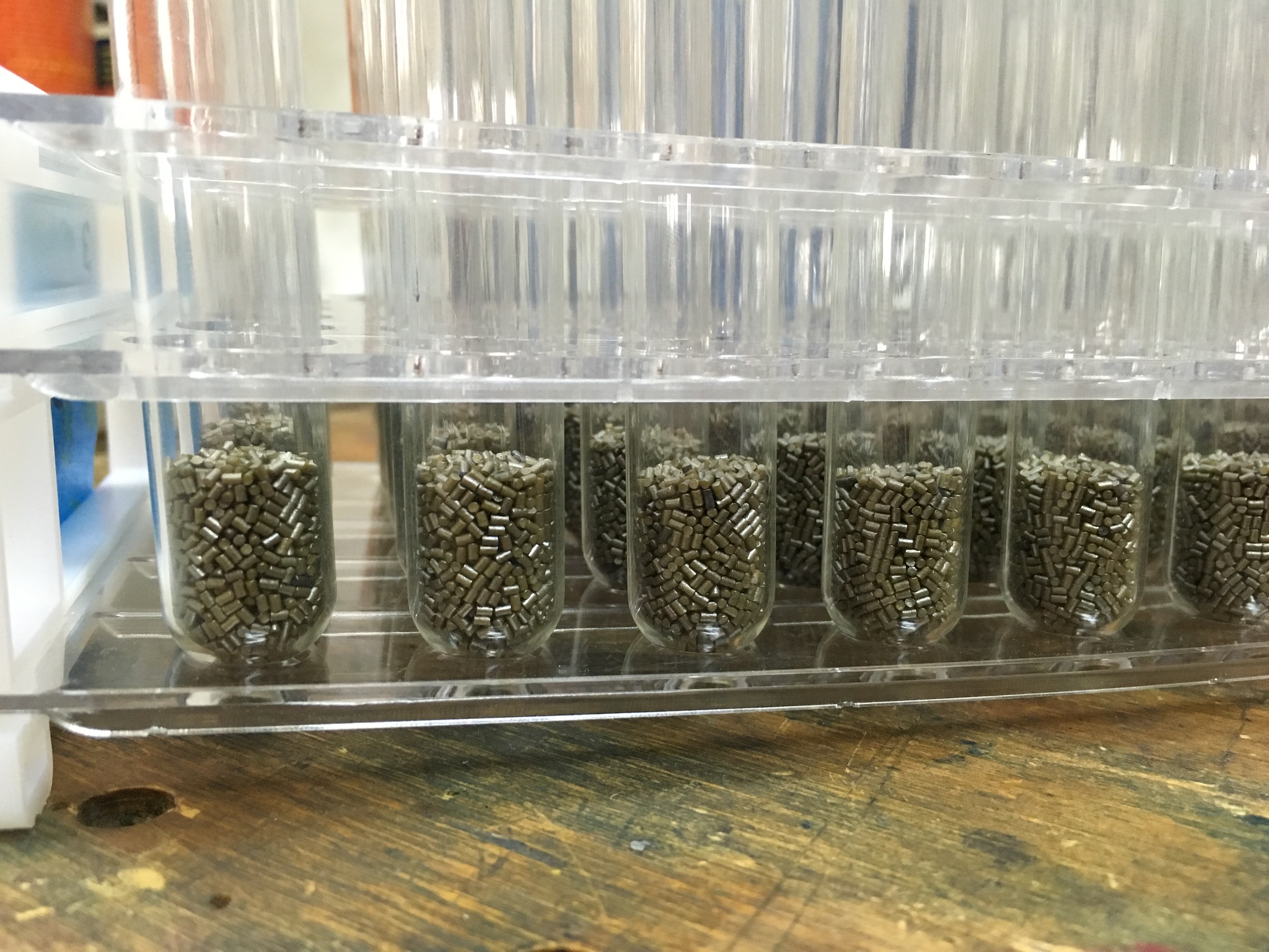

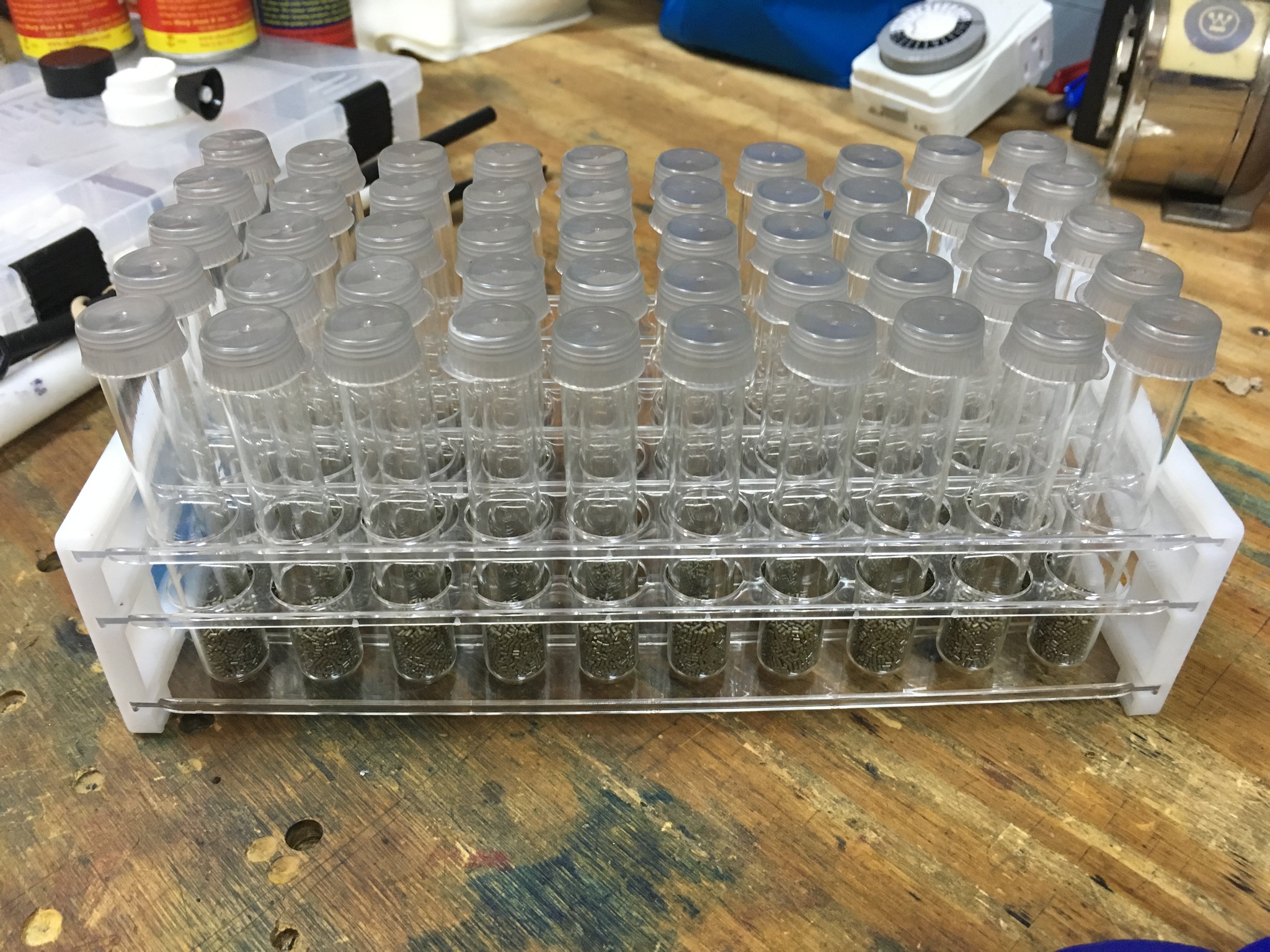

Background info: To weigh the powder I use an RCBS Charge master, but I’ve found it isn’t accurate enough for my liking to get really low ES and SD numbers on the chronograph. I also use a Redding beam scale I had Scott Parker tune up; holy crap is that scale accurate, and a Little Dandy two speed electric powder trickler.
Also I weight my powder inside the house in the cool A/C, not out in the hot ass garage, so I need to have a place to store the weighed powder charges, because the cases will be in the case feeder... Glass test tubes with caps and a tube rack are your friends.
For me to weight 200 charges with the charge master, trickle up, and then dump into the test tube and install the cap, it takes aprox 2.5 to 3.0 hours’ time. I have ordered an Auto Throw / Auto Trickler V3 setup, but that won’t be here until closer to the end of the month. The Auto Throw setup should cut the powder weighing time down to about 45 minutes, and be just or more accurate than I am now.
Line 22: Tool Head 3 position 4: I installed a Redding competition seater die with the appropriate seating stem for your bullet profile. Manually I grab a bullet from the 650 bullet tray and place it onto the case mouth, then pull down on the 650 handle.
Line 23: TH3-5 – none
Finished case! Yea!
Now to give you an idea on how long it takes me to assemble my 200 rounds starting at the point of Tool Head 3 (Lines 19 – 23) is………….. 35 minutes! Remember the cases have already been prepped / sized, powder weighted, etc…. Just 35 minutes to expand the necks, seat primers, drop powder, seat bullets.
Now you are wondering about bullet run out etc. Since I floated the dies, when I measure the run out it’s .001” or less. I’ll take it!

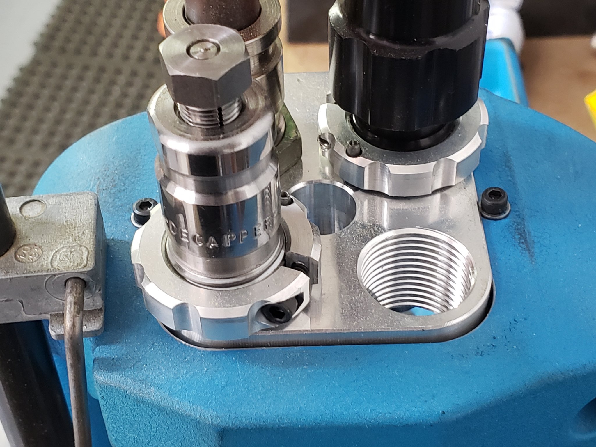

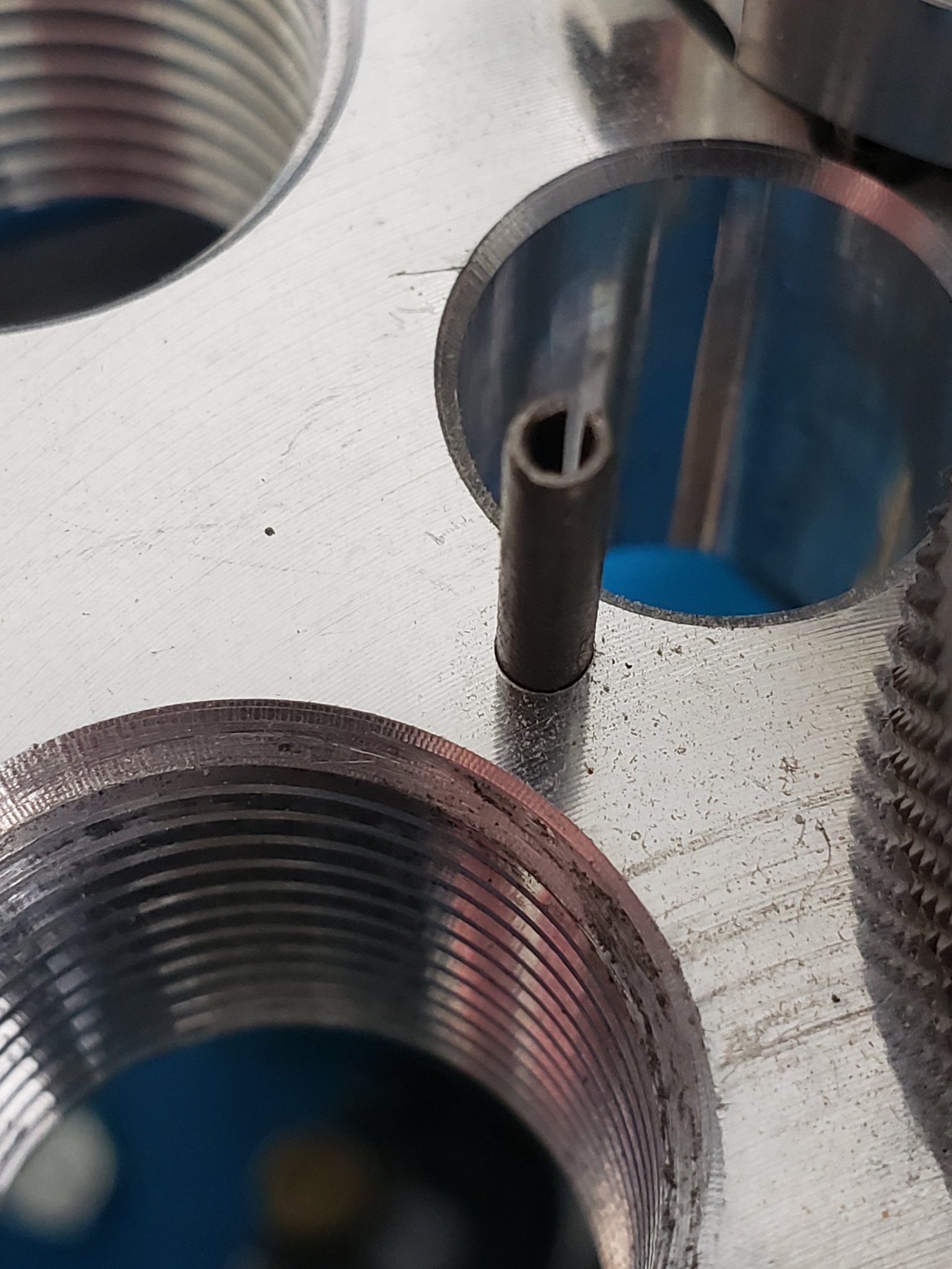

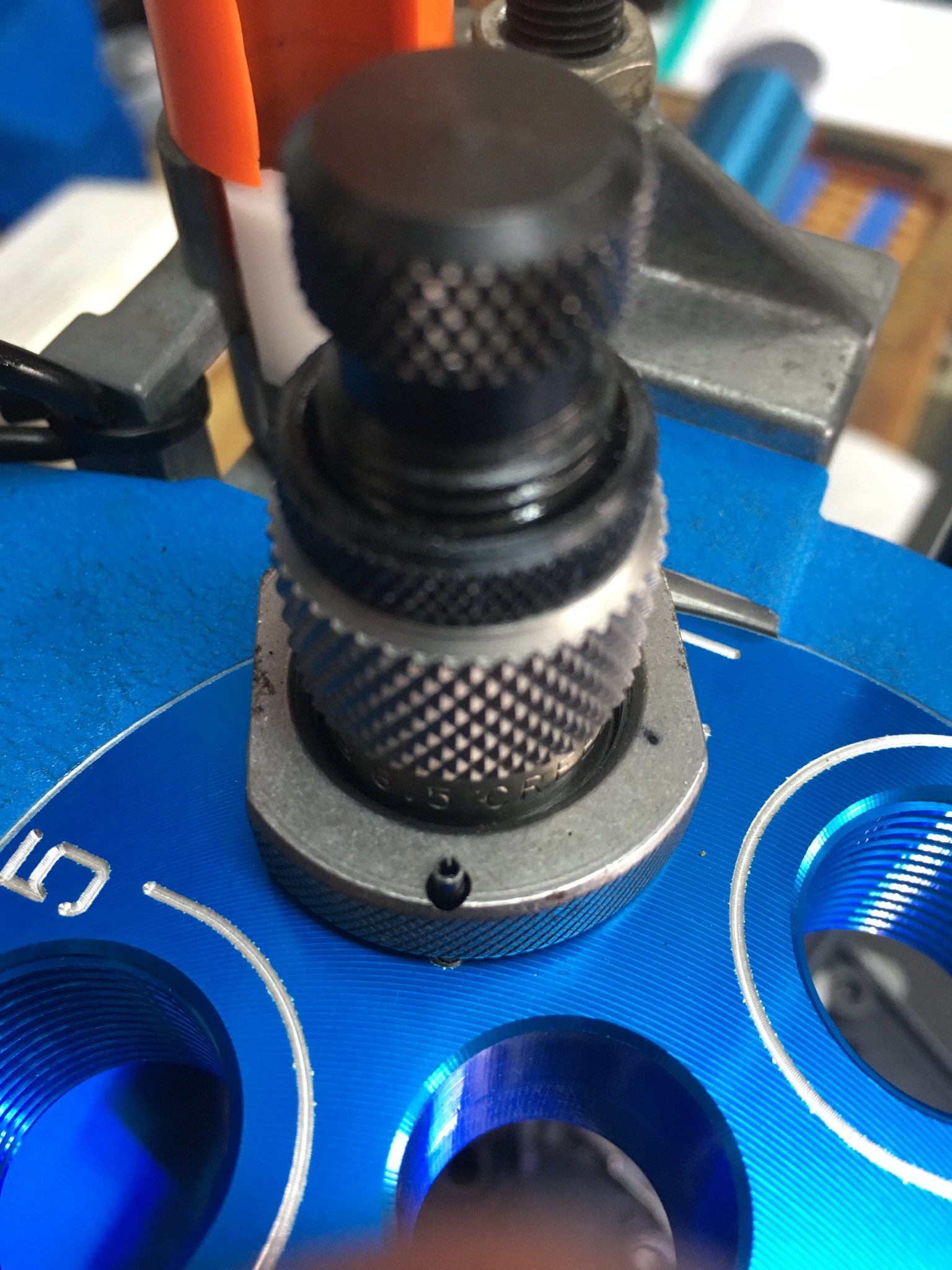

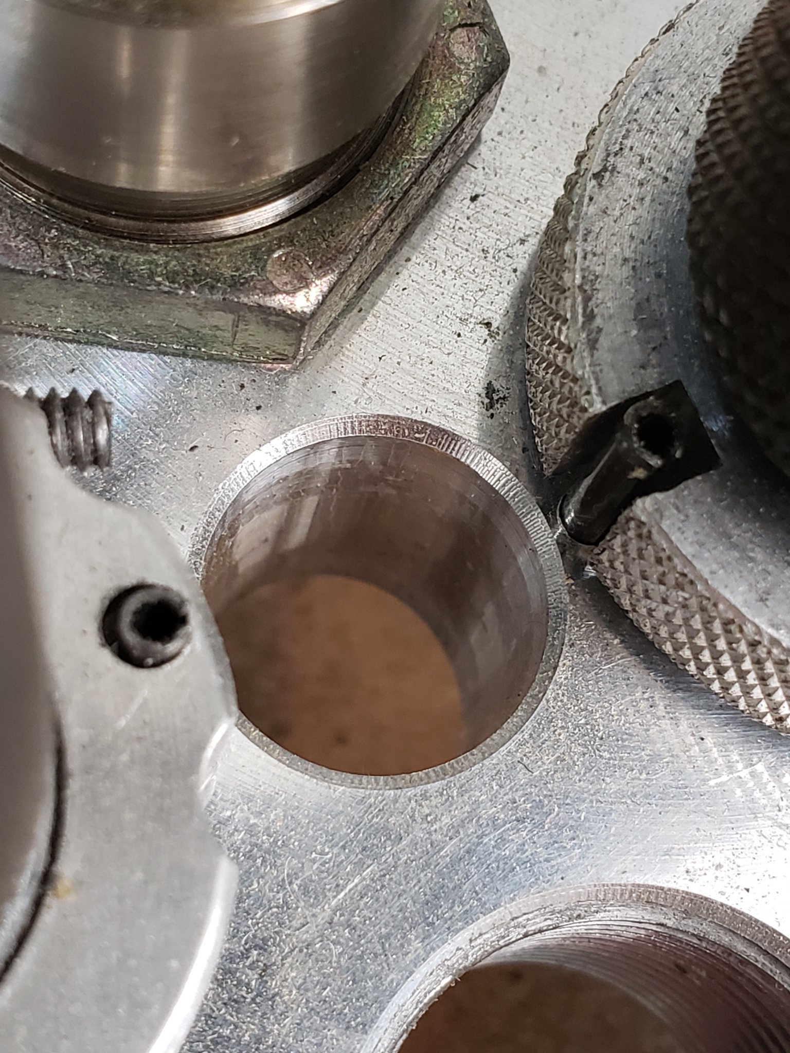

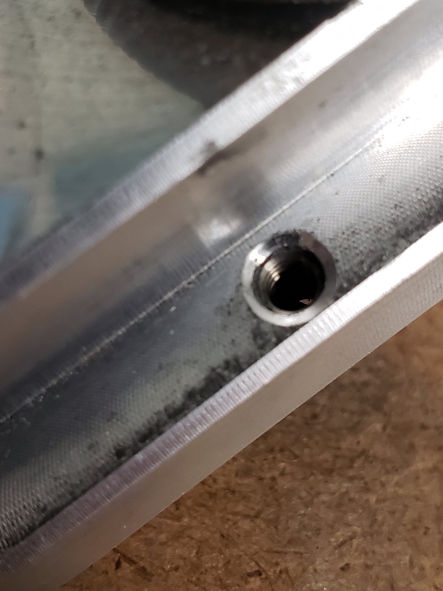

Another point is alot of us drill and tap roll pins into the dies to keep them from moving but leave them loose enough to float on orings under the dies. Huge hassle pulling those and setting them up again once they are set.
Hadn't heard of that before.........mind posting or PM'ing a pic or two ? (y)
Not sure I'll do it though. If installed horizontally and perpendicular to the die in the toolhead, it sounds like a one way trip for the roll pin, correct ? Oh, and not sure what you mean by drill "and tap" roll pins.......I'm not gettin' sumptin".......:unsure:
@jetsurgeon posted pics up in post #119 that shows the drilled holes for his pins. His are much much prettier than mine ?.
I drill and tap a hole for a set screw in my die lock ring to set HS die length etc into the tool head. I then drill a hole for the roll pin that goes through the die lock ring into the tool head itself to keep the die from moving. This allows all my dies to float and run out is just as tight as my single stage press.

Look over on Whidden's site, under 'floating tool head'.
The concept was, AFAIK, first popularized in one of Tubb's books on High Power Rifle competition. Essentially, you put threaded inserts in the locator pin holes in the tool head, and then use jack screws to lock the tool head in place. Then you have small holes drilled into the tool head adjacent to each die station, and inset a small roll pin - say 1/10" - sticking up just enough to engage corresponding holes/notches in the die rings.
The theory is that the odds of having dies in all four holes end up perfectly aligned, particularly with the factory mass-produced castings, are vanishingly small. Instead, you let each die float inside it's own hole, so it can self-align to the case and shell plate under it.
For a period of time, Uniquetek sold a kit for modifying the factory tool heads (edited to add: it's still available). It included the appropriate sizes of drill bit, tap, handle, helicoils and insert tool, along with the correct screws, to do the mods to the tool head to be able to lock it in place. If you wanted to float the die rings though, you were on your own. Fairly simple with a drill press, though. Never tried it with a hand drill, myself.
Later, Whidden started offering a combination setup, including modified Forster lock rings. Essentially, it looked like they took a batch of them, clamped them in a mill and ran a slotting cutter across them. I still have a few of those kicking around.
More recently, Whidden sells complete kits, with holes and pins already installed, along with the hardware for locking the tool head into the press frame. There may be other people doing similar things, as the use of CNC machining in niche markets has expanded greatly over the last 5-10 years. FWIW, I believe Uniquetek now (re)sells the Whidden tool heads, already set up and ready to go.
To add to my above post, in my XL650 with the billet toolheads I am using Forster Ultra Micrometer seating dies and Forster FL Sizing dies for rifle cartridges (expander removed and 21st Century TiN expander mandrels for .002 neck tension) and Redding Competition Micrometer pistol seating dies. I was getting higher but acceptable runout with Dillon dies.

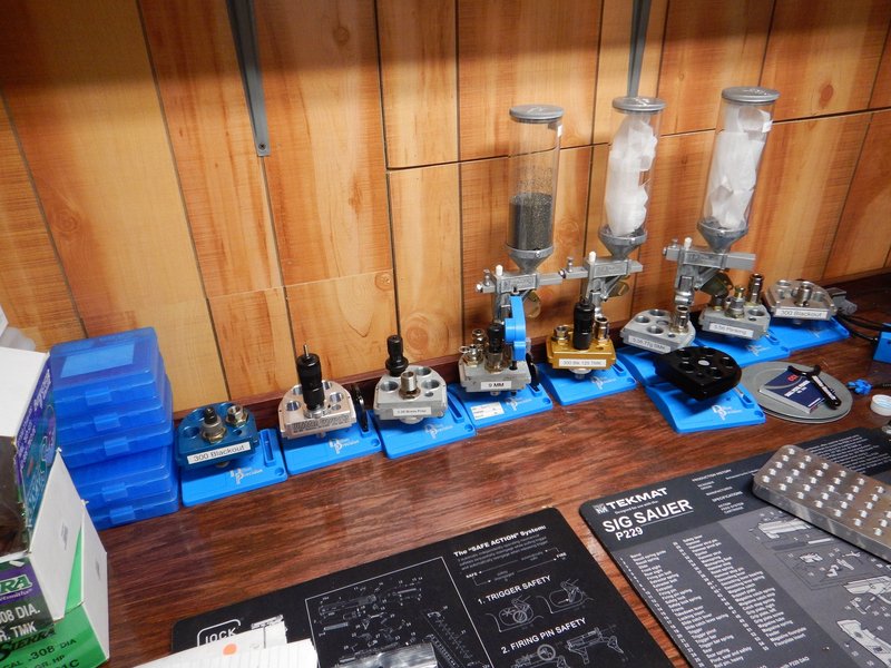

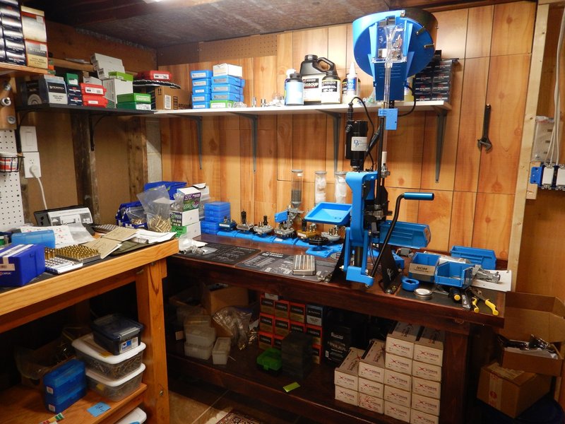

Also, for those that are interested. I do not process brass and load all on the same toolhead. I have separate brass prep and loading toolheads for each caliber (except pistol cartridges). I run all my LC 5.56, LC 300blk and 6.5cm semi through a brass prep toolhead that deprimes, bumps shoulder, trims (Dillon RT1500) and mandrel sets neck tension. I prep brass in large batches of a few thousand at a time over the winter months. I then SS tumble, debur the case mouth and store in large plastic bins.
I dont have to prep brass at all for these calibers during the shooting season. I have more than enough brass ready to load.

I have the Area 419 setup (with the Dillon adapter) and used both the 3” tube and double stack. It’s an attractive and functional setup, but with H4350 I have had numerous incomplete drops due to unnoticed bridging. First time I noticed was after several consecutive drops, enough powder had bridged and hung up it resulted in an overfill on the last, when it eventually broke thru.
(Granted, my setup on the bench puts the funnel above eye level, so I don’t regularly stand up and look down into the funnel to ensure its empty, especially with the double stack.)
Without a see thru funnel (or bottom tube), I’m never certain every kernel is making it into the case - double stack or not.
Thread resurrect! I have the same setup and the same issue with bridging H4350. Actually caused me to get a squib load that jammed a bullet about 2 inches down my 6.5 CM barrel, which really sucked to get out. Wondering if the little vibrating motor would resolve this, gotta be careful searching those online though, lol.
That's one of the benefits of the cheap MTM funnel. You can see through and watch the powder drop, and catch any bridging. I've never had mine bridge on me though.
I use the Area 419 funnel and 3" extended drop with a Dillon Powder Die..... Never had any bridging problems with H4350, guess I must be lucky......
I've been running the same setup for YEARS without issue....until last week with 4166 loading 22BR.... I think the small 22 necks and amount of powder and kernel size is the perfect storm as I got tons of bridging. First time ever.....never had this issue with 223rem, 220TB or any others.....
