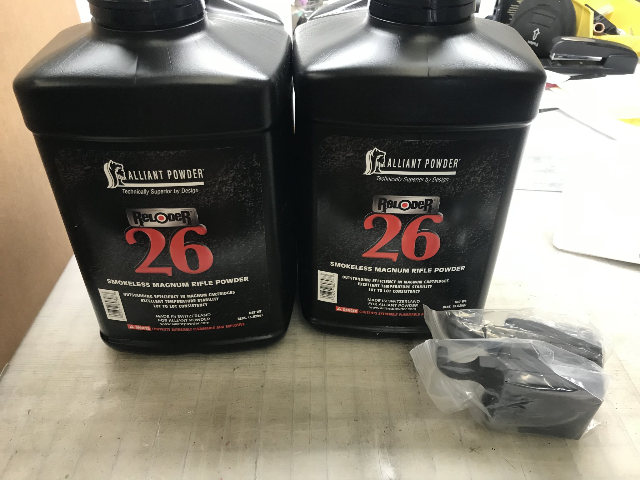

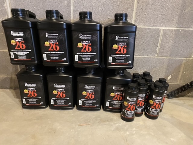

WHAT!!!!! Geeez...I can't get home from work yet and you guys are buying all the Unicorn Farts on the market. Hopefully they make a metric crap ton of it.
I felt kinda bad buying 16#
Now I don’t feel so bad.
