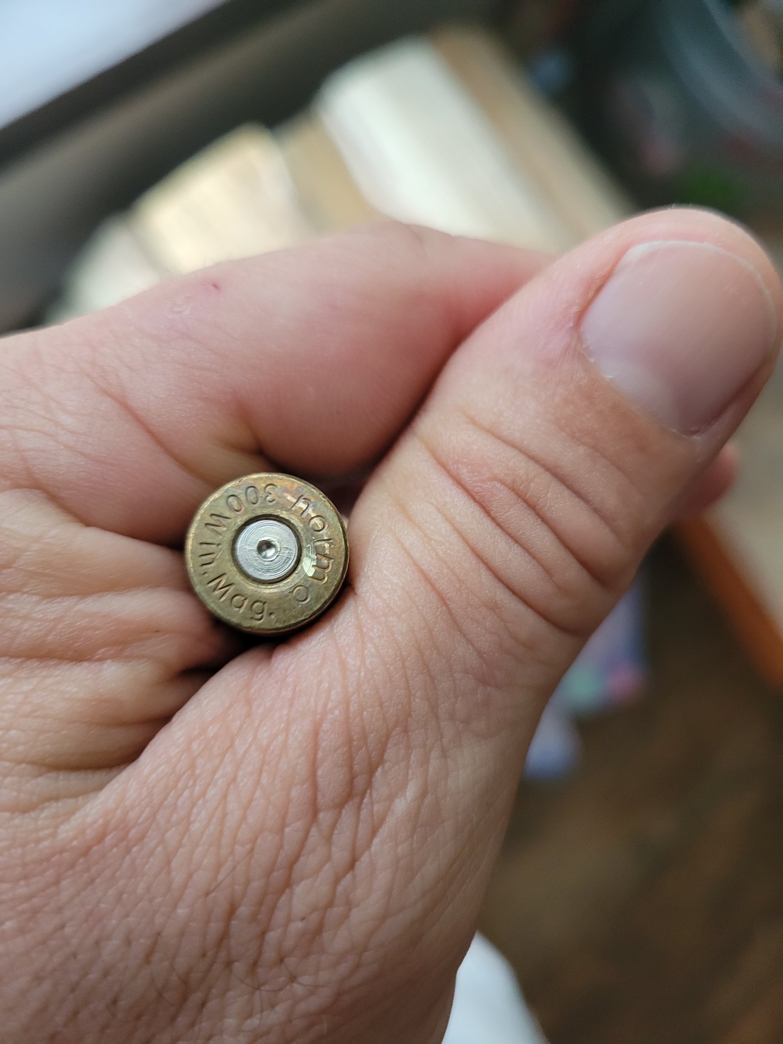

Last pic was 79.0gr and was a tad spicy as seen in the pic. Sticky bolt lift, pretty good ejector swipe. So we backed off a little.
I'm thinking 77.9 what's everyone's opinion ?
The jump in velocity surprised me from 77.3 to 77.6
Settled on 78.0 for a nice round number.

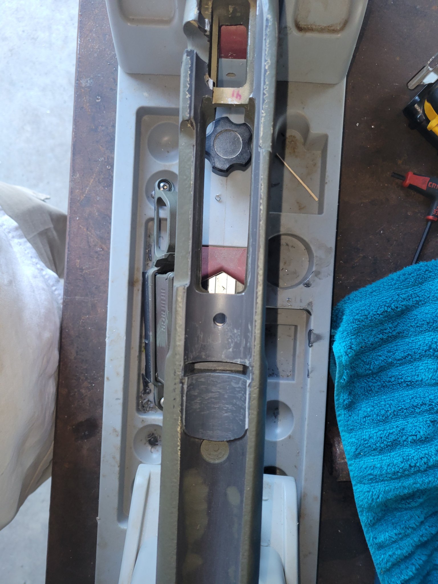

I found out later that that all that was done to the action was that the face of reciever was squared to the od. It wasn't trued to the centerline of the reciever. Bolt face was cleaned up in a lathe and fritz at black canyon said he lapped the lugs slightly and put a holland .250" thick recoil lug on it when he did the barrel job this time.
Action is torqued to 60 in-lbs.
Stock is an hs precision that was bedded with brownells steel bed but I had to redo the area around the recoil lug due to the new one being .250" and the old one was .180" I think.
Pic of my bedding work. I like a little support in front of the lug and in several of my other rifles it's never been an issue. What are your thoughts on this ?
I shoot off of sandbags with a rear bag for support.

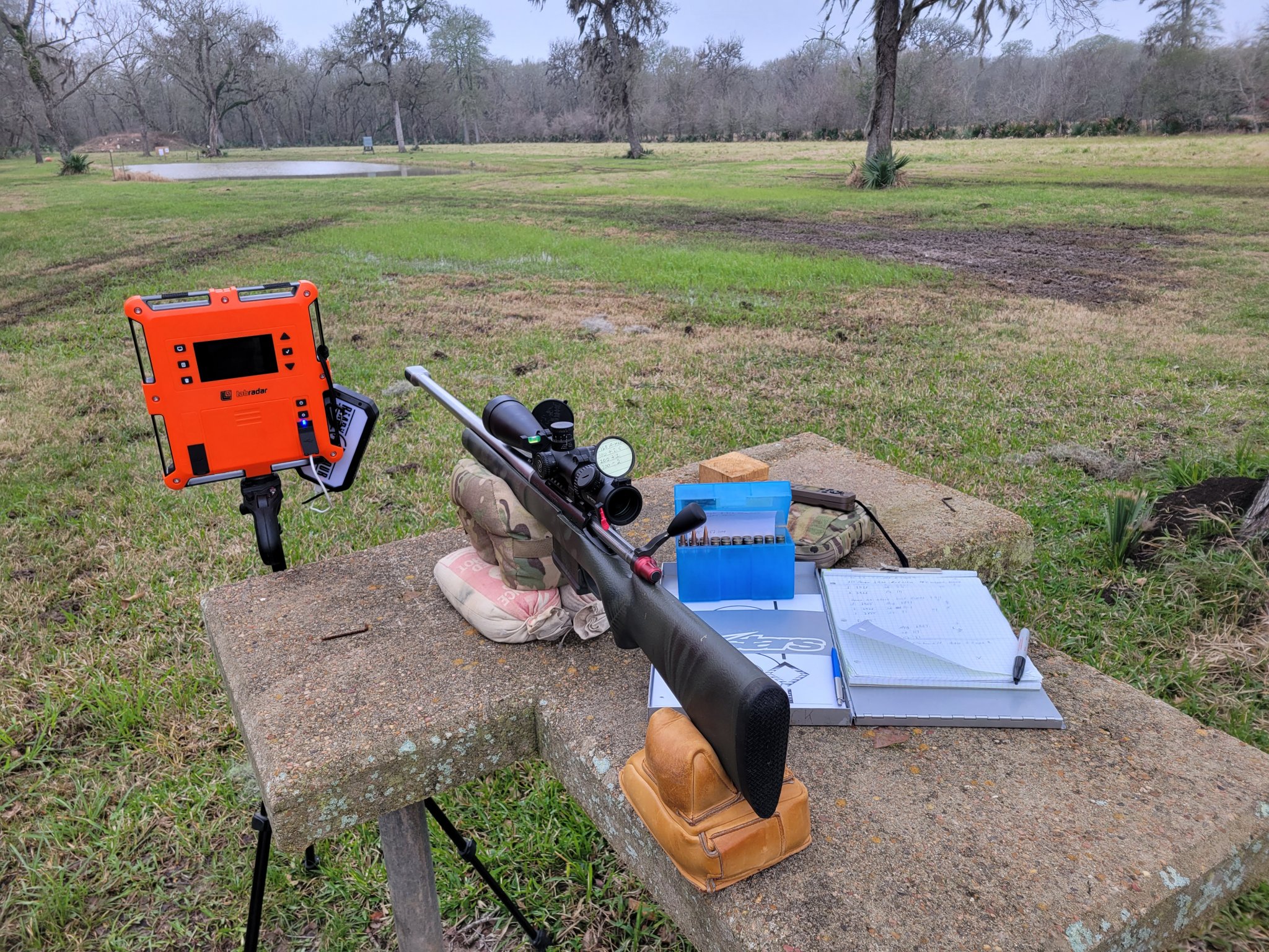

Is all this testing being done with a magnetospeed attached to the barrel?
I've used a magneto speed and a labradar and it really doesn't make a difference. All the stuff I posted with the 215's was done with the magneto speed.

All recent load development was done with Labradar.

We'll push it back a bit more and see what comes of it. May take me a couple days. Just started raining here and it's supposed to rain all day tomorrow. Low 40's and rain. No thanks. And I may be going hunting this weekend.
I could probably setup on the kitchen table and open a window but the wife may not be a fan lol.
I wonder what that 300 would sound like in the kitchen 🤔
Before my time my dad and my grandfather would shoot their muzzle loaders out of the kitchen window. So I guess it would just be in keeping with tradition.
Well I've been away from this project for a while but I got a day off today and I actually got to do a little shooting.
I tried a couple of the loads suggested with h1000 and the 215 hybrid and they were really good loads. But, they were way to slow for me to want to do anything with them. Here they are.
I finally found a decent load with magpro and the 215 also. Not real fond of the es in this load but it's just a shade over half moa and I'm running low on hybrids so (48 left) so I'm just going to load it and kill stuff with it like it is. Here's the target.
Being that I'm running low on 215's I found some 212 eld-x, so I picked up 200 of them to try. I recently watched the Eric cortina podcast with the guy that came up with the ocw method so I started fresh using this method. I didn't think I would care to shoot it round Robin style but I actually liked it. Kind of takes the pressure off making that last shot of the group. The h1000 load was testing his theory on the 3% increments. In my case, the 76gr h1k loaf plus 3% coming out to 78.28gr. Didn't really hold true for me. I may ad 1.5% to it as he suggests and try again. I've got just enough h1k to load three or four more rounds so I'll probably just save my bullets. Anyway, here's the target of the ocw with the 212's. I think I know where I'm headed but I'm curious to hear everybody's opinion on it. I probably won't pursue the 76.2gr load, it's getting a tad warm. Ejector mark on one case and the extractor bumps pretty good. Everything else came out with zero effort.
