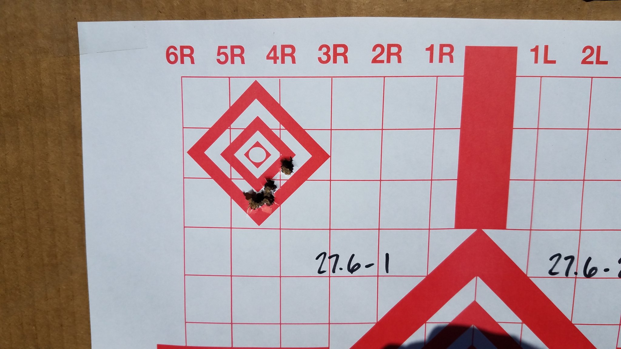

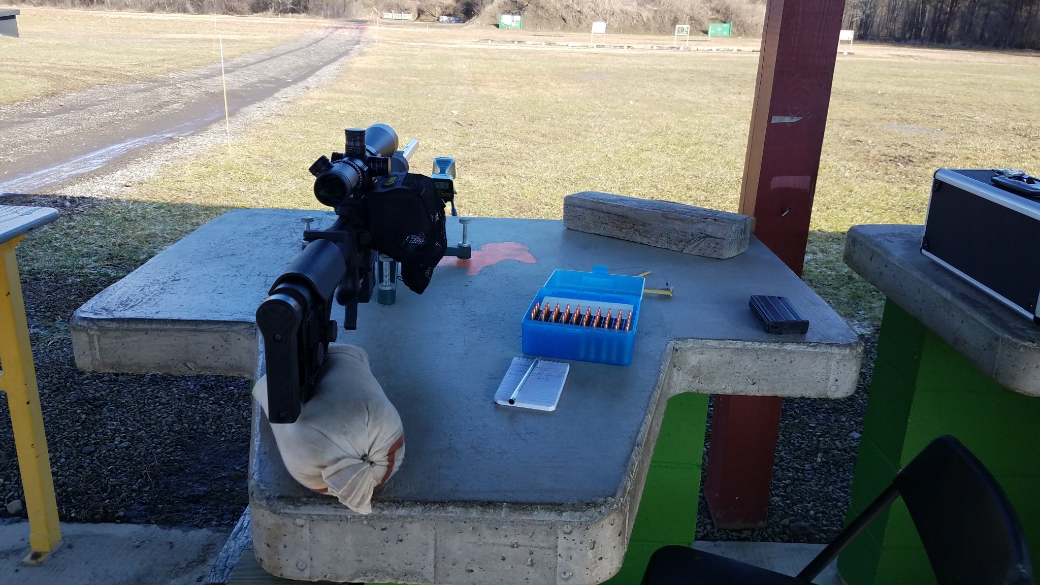

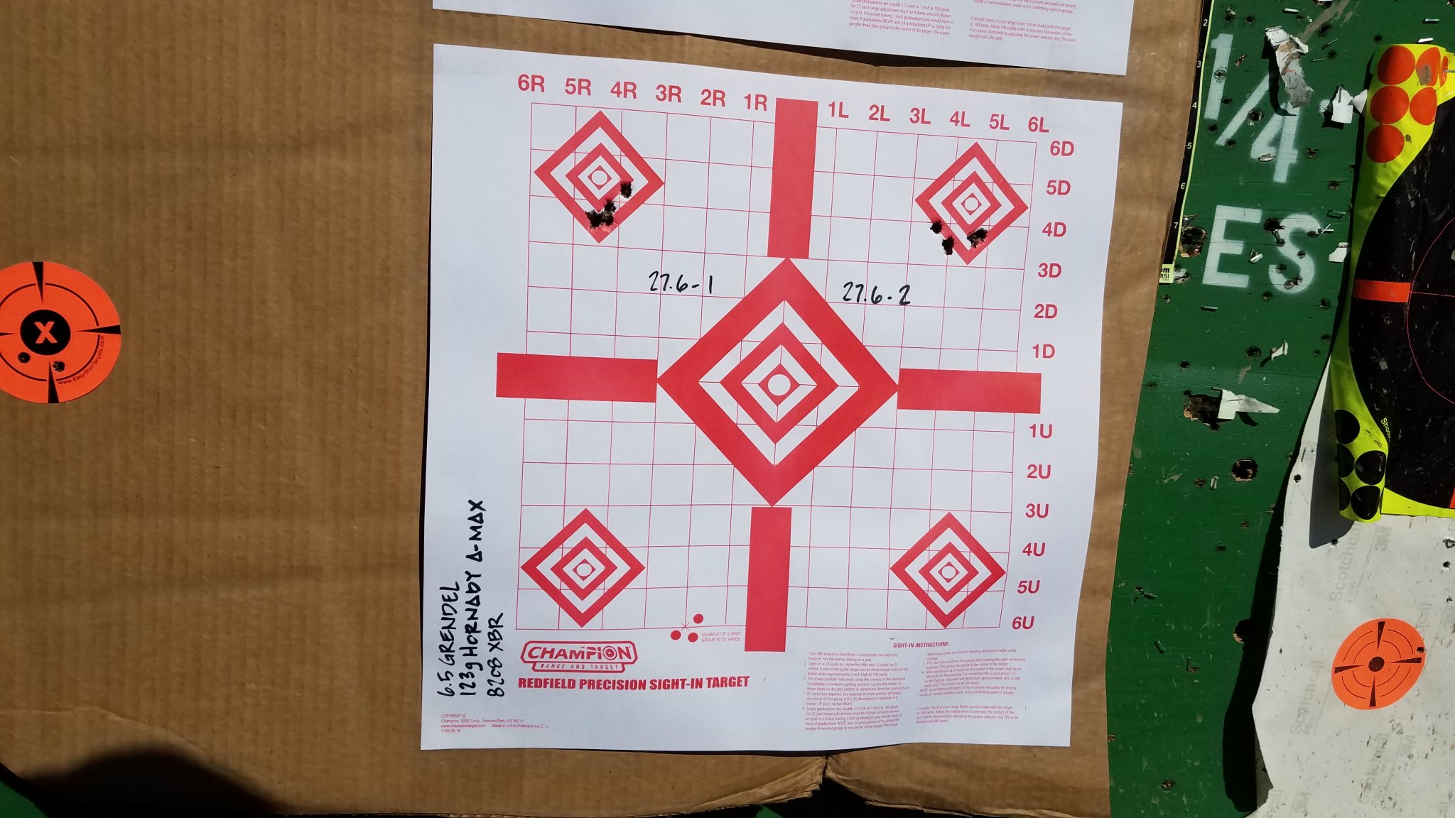

Finally got some ladders built and snuck out to the range today. Started at the lower end of the scale and will maybe try a 2nd ladder going up. Looks like the mid 27g load might be the key so far.
6.5 Grendel, Vortex Viper PST Mil
Rise Armament trigger
24" ER Shaw bull barrel, 1:10
Hornady AMax 123g
XBR8208
CCI450 Magnum Small rifle primers
Hornady once fired brass, full length sized.
100yds, 38°, Light-mid tail winds.
2520fps (average)
Reactions: elfster1234
