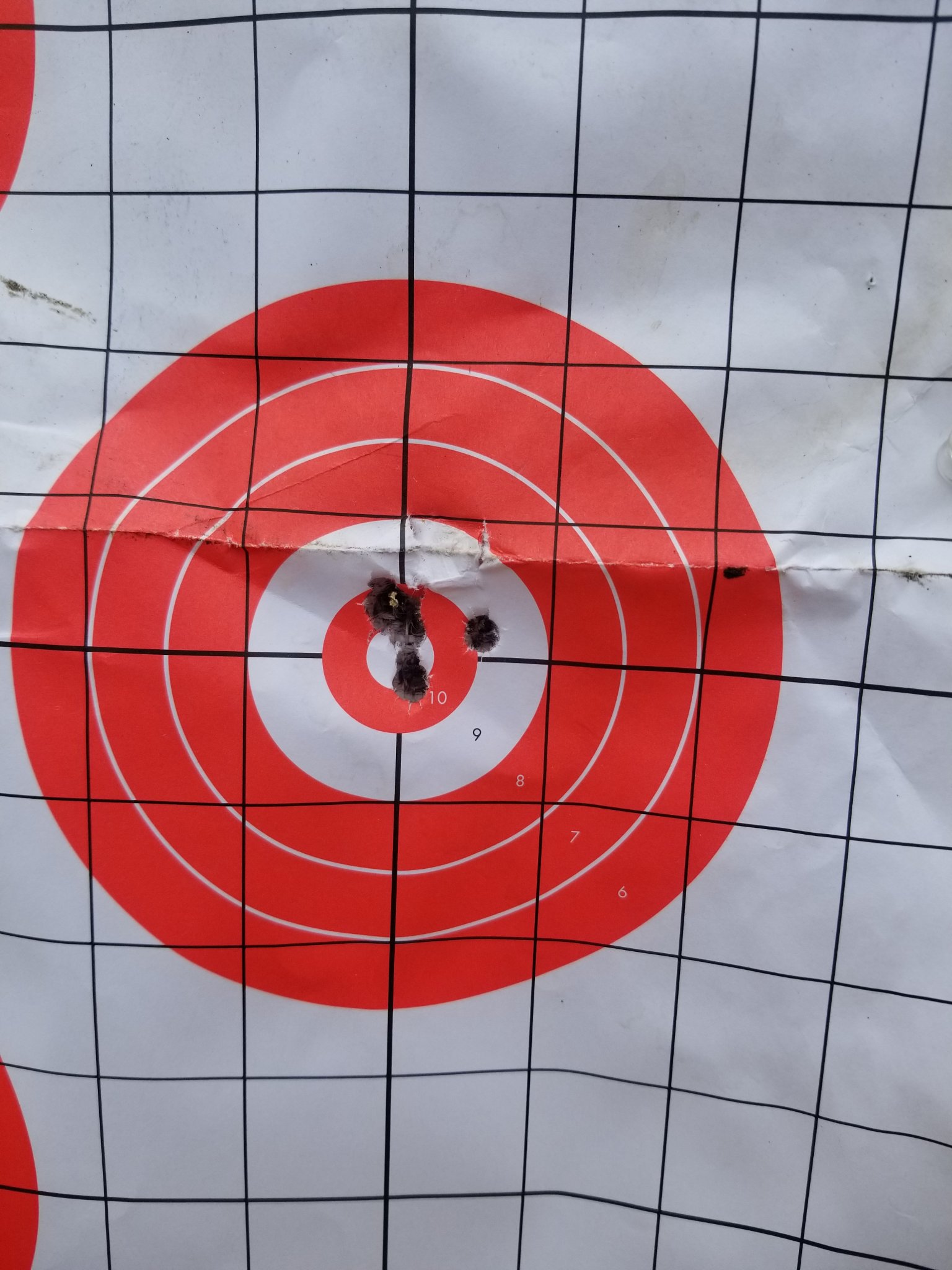

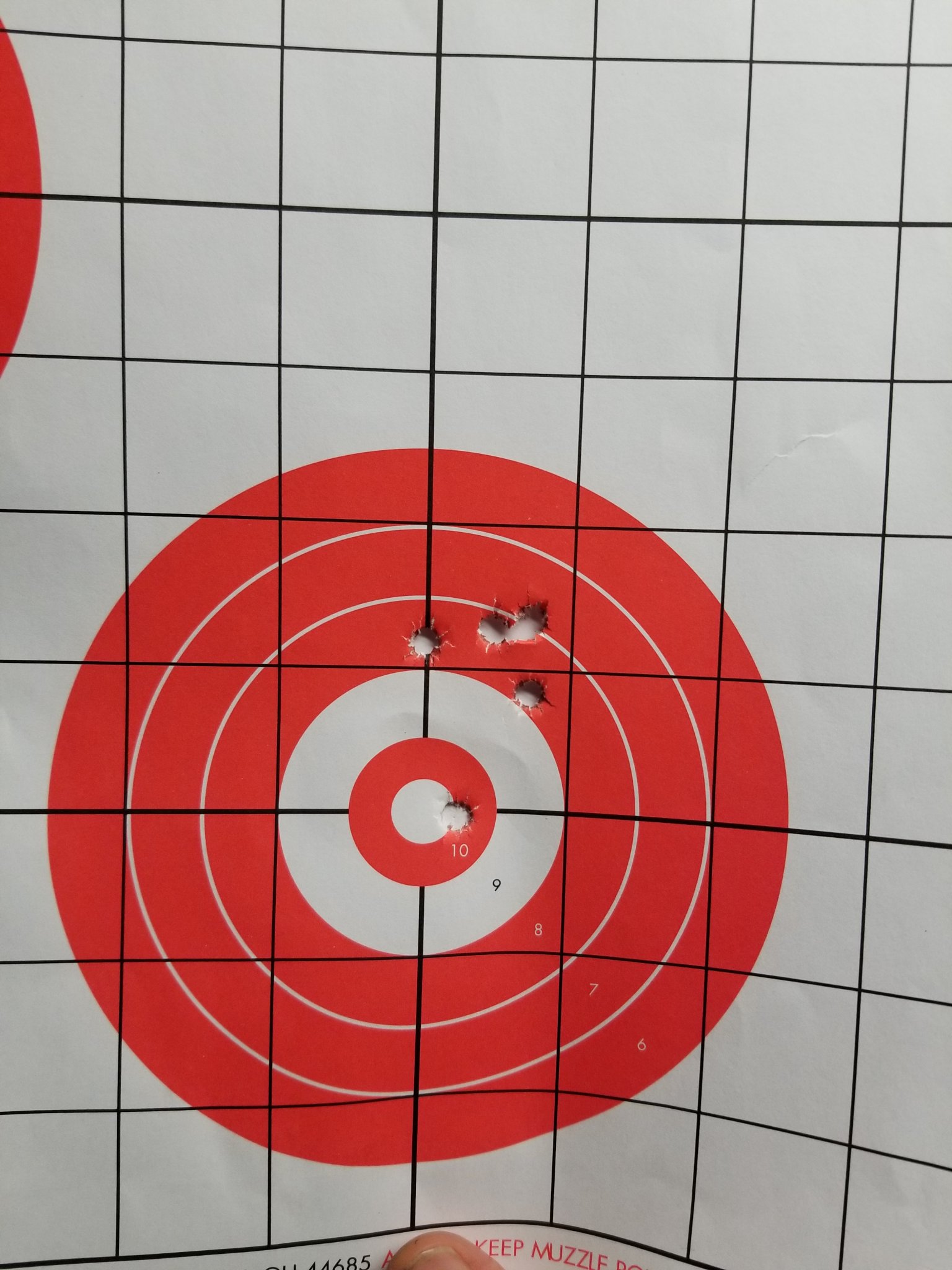

I think i finally figured it out, went ti the range with 20 rnds spit into 2 groups of the same load and shot 10 rounds which is the far 2 right top red dots with my swfa 10x42 scope, results were the same as before. Then i switched scope and front and rear rest and fired the lower far right dot also and again same groups. So out of frustration i grabbed my torque wrench and tightened my action screws to 65 in lbs. Which i thought was to much but ohwell, try it i thought. I fired the group on the lower black and green target. Group was fired with a warm barrel and didnt exactly take my time as i was frustrated but landed 4 shots right at .750 moa with one flyer..... i cant believe this whole time my actions screws werent tight enough. I followed the reccomendations of 45 in lbs. Guess it needed more.

Now i just need to find a different bullets, with my 7mm using a max and now using 90eldx in the 243, with both bullets i got random fliers like this... i always used hornady bullets but after the last few boxes i think they need to look into tightening up qc or something...
Looks like things are coming together , congratulations, I was going to send you some ammo to try out, fed blue box it has always shot well in my Remington 243's let me know if you want to try it.
After finally figuring out my problem a fellow snipershide member has helped me out and this group was shot with factory 80gr soft points, measures right a .500in. It was a 5 shot group. Now i am excited to finally be on the right track!!!! Thanks Again OG10!!!
The fix was the torgue spec on the action screws , correct ? and your welcome on the ammo its cheap and it works out to 300 yrds very well . Good luck.
Yes og10 is correct, action specs were off, i previously torqued at 45 in lbs. Accuracy suffered greatly until i torqued to 65in lbs that accuracy became what i was expecting.

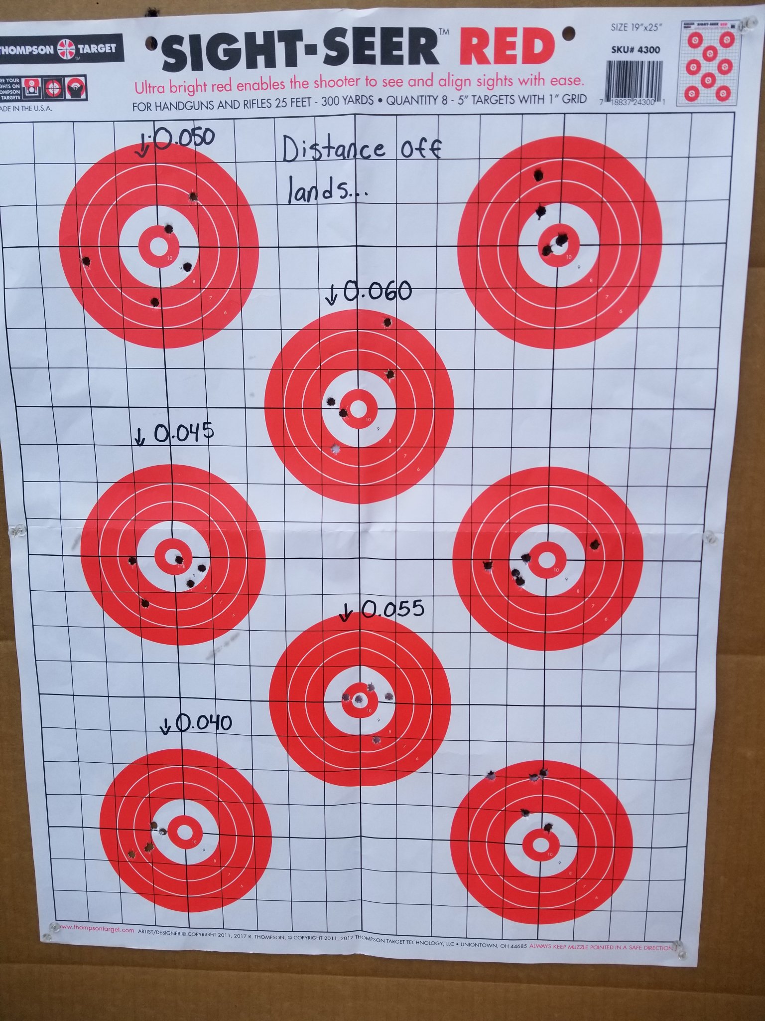

Well went to the range today finally got to try out my Sierra Game Changers, one of my 1st 5 shot groups looks very promising. They were set .010 off the lands with a mid range load of H4350. Had one flyer what caused it i have no clue. Any opinions? Not sure if i should stick with the same distance from the lands or adjust powder charge... what say you?
I havent seen any muzzle velocities posted. I dont think its the rifle. If I put factory 100gr 243's in my 700 it shoots 4" groups at 100yds. It puts 5 in a quarter with 87gr bergers handloaded. 2 major things needed for data collection is groups and MV's. If your MV's are spread 60ft/sec the gun will most likely shoot bad.
Ok, lemme get this straight. You started hand loading, but just picked some random charge weight and immediately started with seating depth?
That first 5 shot group doesn't mean dick, beyond the stars aligning for 5 shots. The remainder show lots of vertical stringing. Looks like you found the cause, but I'm not sure your hand loading venture did anything for you other than cost some money.

Hlee, no i shot a few different groups. This is the only one i posted. The other groups were very similar but these were slightly better. No i picked a charge in the middle of the reccomend powder charge weight so i would have some adjustability if my seating depths were off or i needed to adjust my powder charge. I been loading for 18yrs so i am not new at this trust me. I always start with the seating depth first as it usally gets me the best groups. Once i find that i tune with powder weight. I aint looking for so much as group but what gets me the best vertical alignment then ill start adjusting powder to bring the group in.
Maybe try backing the sierras off to .015 and see what that does if you haven’t tried already. My 338 would show some vertical like your. I was able to eliminate it 2 ways, backing off .005 and bullet sorting. My 300 gr smk appeared to be off 2 machines as they measured in 2 different lengths. You could also sort out 5 and load to current length and see if that improves it

OCW, ladder tests, Newberry, Satterly- all have one thing in common. They use charge weight to optimize the velocity (vertical dispersion) before optimizing the seating depth. There are a lot of areas in life where you can do your own thing and just be a bit eccentric. Load dev is a science. There is an order of operations. You appear to be doing it backwards.

Clif notes- Minimize the variability in the velocity with charge weight (vert dispersion), then tune the group size with seating depth.

Hlee, i will try the methods next, how can you adjust oal if its at factory specs? I mean you can go longer but if you go shorter it will be under sami specs...
I suppose seating depth is something of a chicken or egg proposition. However, bullet manufacturers tend it have recommendations where to start. Barnes, for example, recommends starting 50 thou off the lands for their tsx bullets. SMKs are supposed to be jump tolerant. And, I haven't had any issues with 6.5 ELD-Ms loaded to 2.800. Truth be told, all but one of the rifles I load for are constrained by a short action box magazine (AICS or pmag), so I don't do much with seating depth. I load my 270 win way beyond Saami spec for oal. If you are running a rifle with a blind mag or hinged floor plate, you have a lot of room to maneuver. That said, if I've found a factory load that shoots well, I start there with the oal. A Hornady ogive comparator can make comparing different bullet loading easier...
I'd let the rifle tell me where the seating depth should be, and not be overly concerned about saami specs.

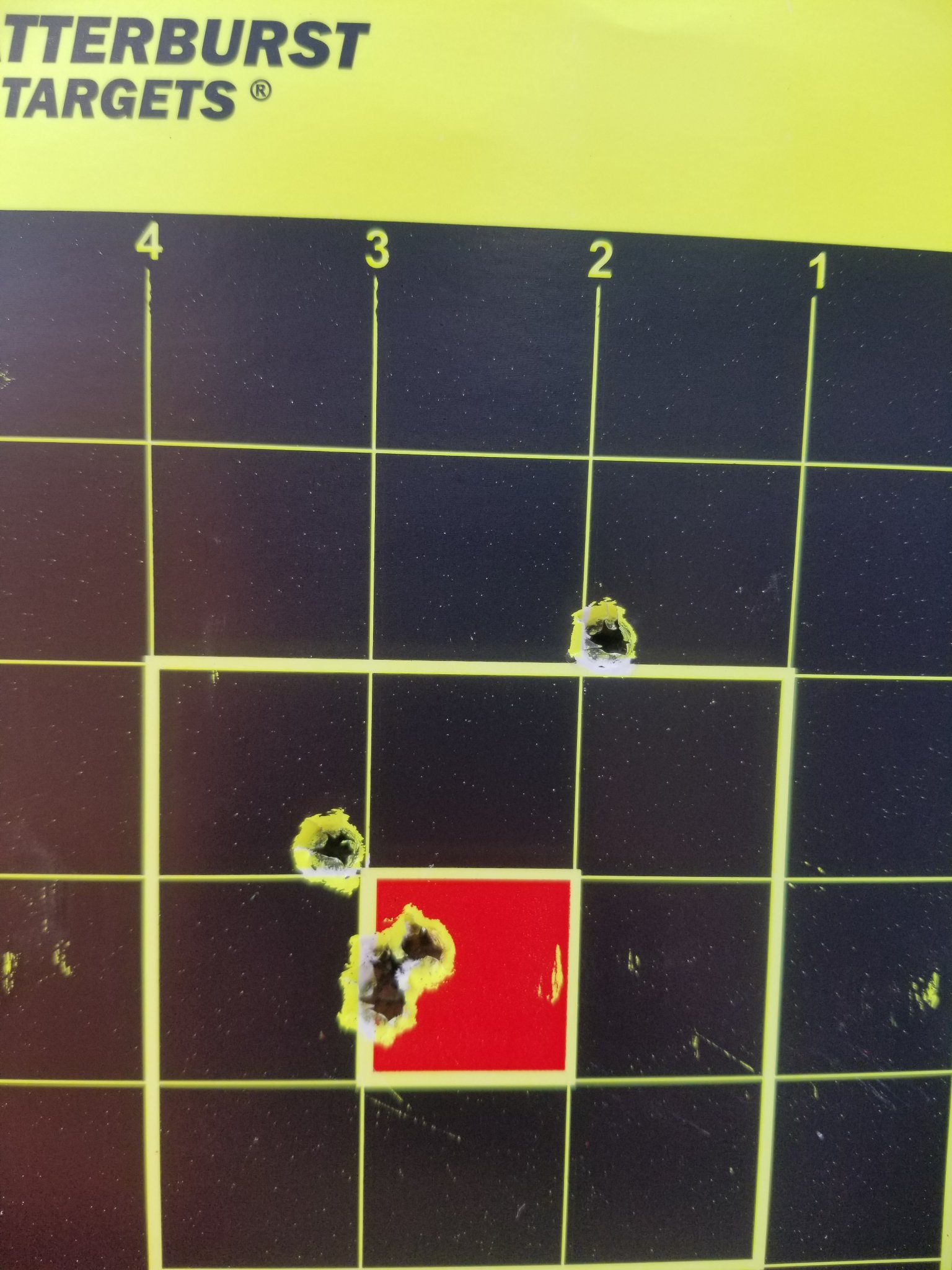

i shot all my sierra game changers, they shot ok, most were moa groups but i want better. The factory core lock was 5 shot 3/4 group. And factory federal 80gr was 5 shot 1/2in group. But they are soft points. I want to try a different bullet. Thinking maybe i should go lighter like 80 grains or so. Kind of hard to find something that doesnt cost almost 40.00 a box. Accuracy seems to be best around 3000fps. Any suggestions?

I dont think hornady or berger has a reccomendation. Berger only really gives you their lands test thing which is a similar test to what i use. I guess i could give both a call and find out. 87gr v max looks good so far and the coefficient isnt to bad. My farthest range is 500yrds. I have a gew different ones im looking at. Yes i do have a hinged floor plate. I might load oal to just fit then start with powder charge. And if need be ajust aol to tighten. But its gunna prob be a month be4 i will be able to shoot again till i get paid.

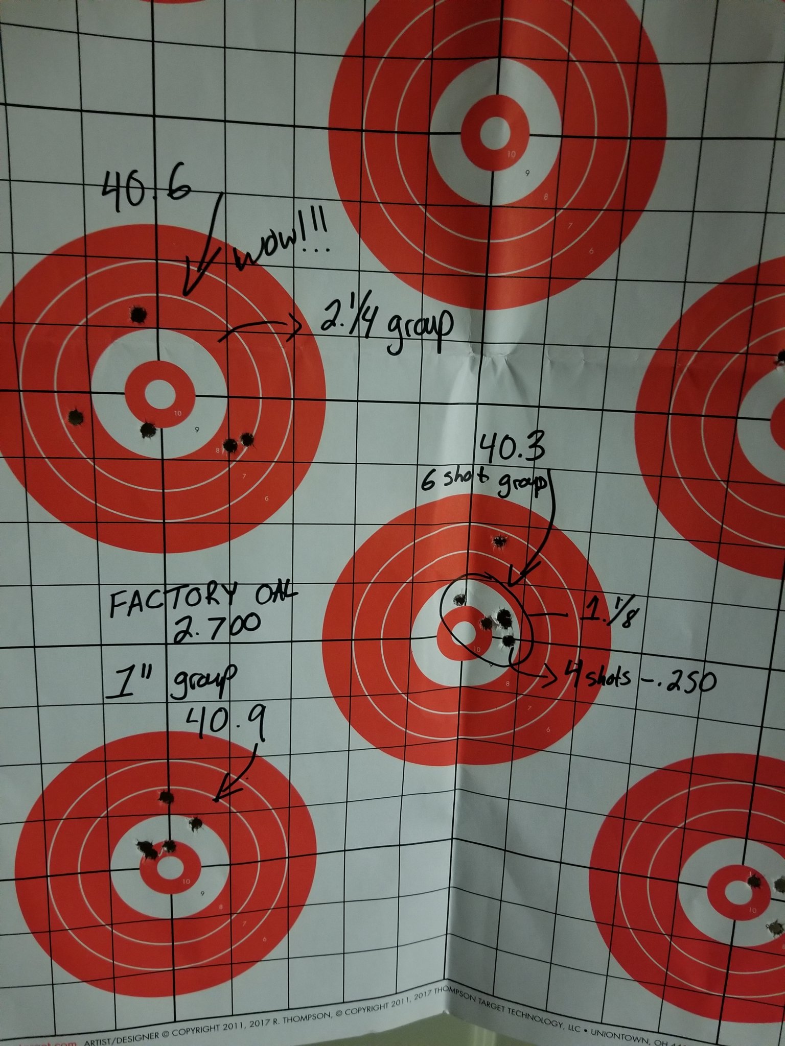

hlee, i tried loading the last 16 rounds i had left just to experiment with. All were loaded at factory OAL, just changed the powder charge by 3 tenths at a time. As you can see in the 3 target circles above it worked ok. The last group was prob the best. The one i have marked 6 shot group. Wish i could figure out thoes random fliers. There was 2 in that group, one was way off. But it put four in about 1/4 moa. So i might retest this when i can get more bullets. What do you think?
